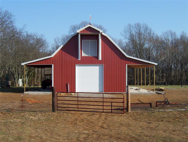

A little tin is on.

/ BARN going up #82
All the old dairy barns around here are giving up the ghost and falling by the wayside. Most of the replacements look so industrial, like a California mini-mal.
Your building has real class and craftsmanship, I would like to have that building with my window-view. (I would NOT want most outbuildings to share that view with.)
Congrats on a job exceptionally well done.

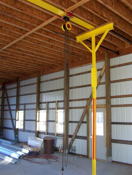

#84

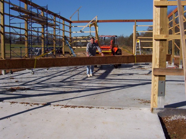

Way back when in this post I installed a 16' x 8" Beam to install a trolley and chain hoist on.
Here it is!

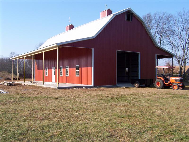

#85

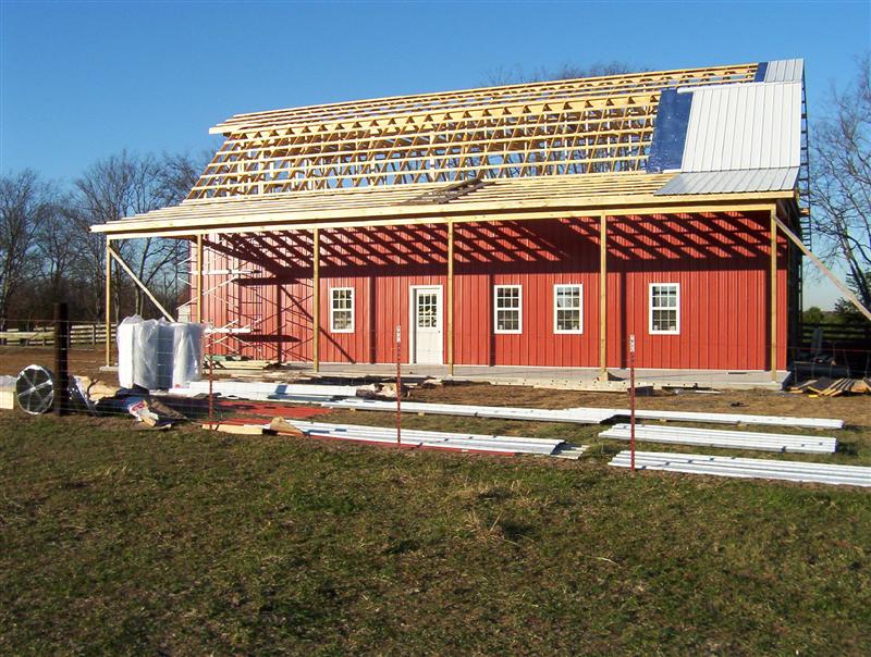

Shot of back of barn. Hole at top for a ventilation / exhaust fan not yet installed.

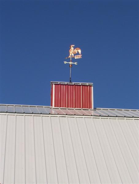

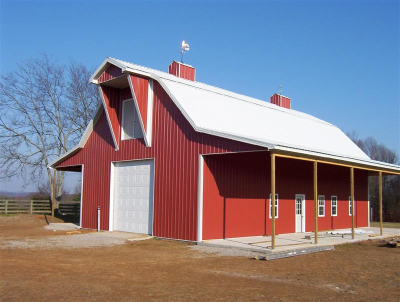

#86

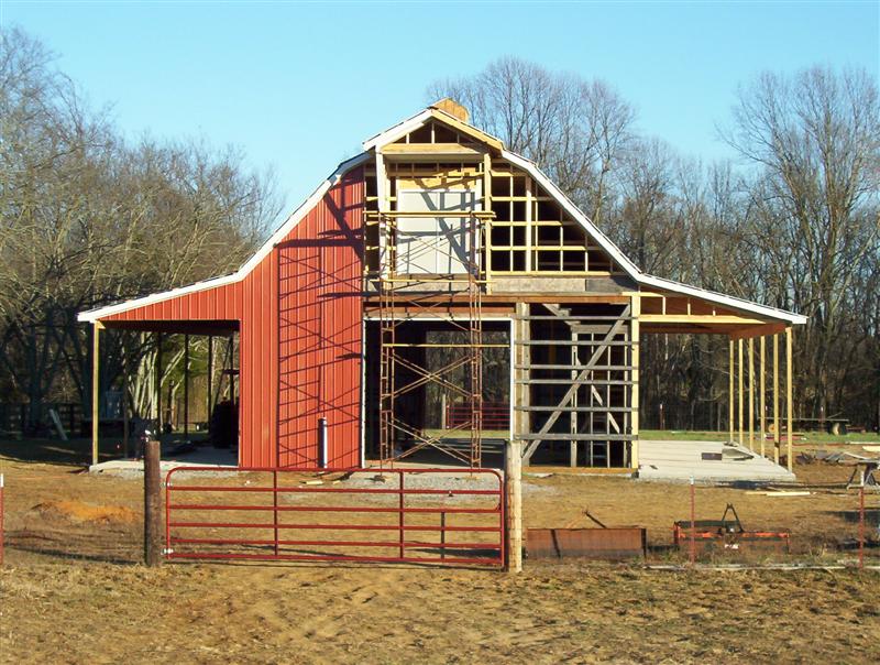

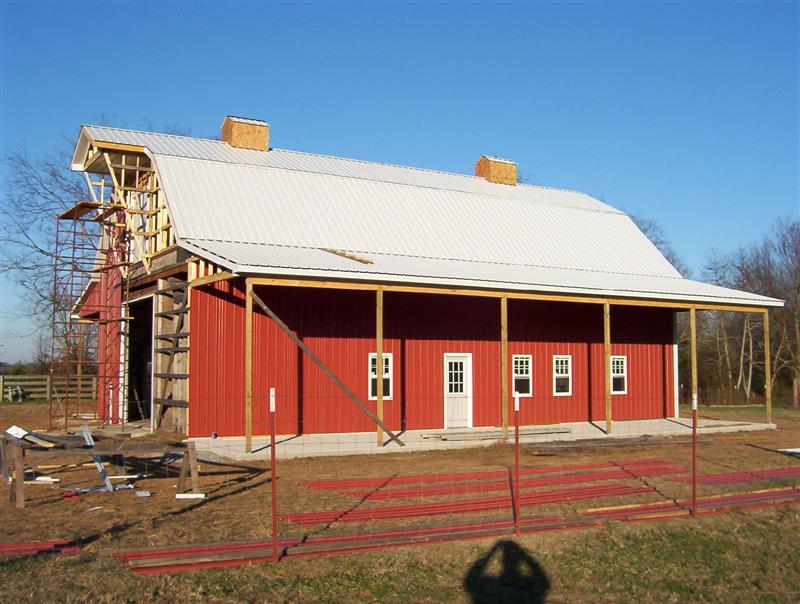

Pic of the long side with Cupolas of my own design. Can't wait to see the weather vanes mounted.
Also pic of front.

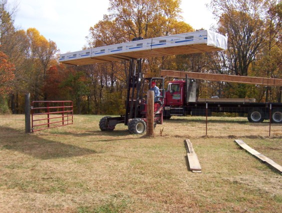

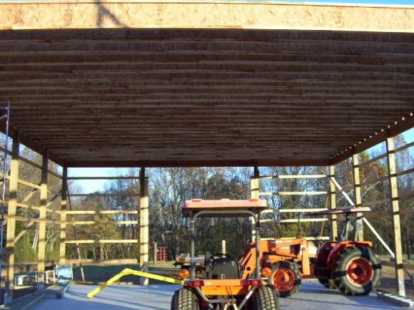

Wood I beams for loft floor joists are - 16" deep X 32 ' long , Georgia Pacific WI-60 I beams.
They are 16" on center.

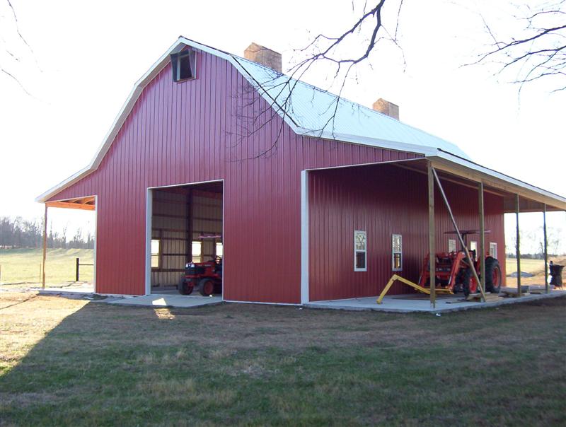

#90
Time to close this one out I suppose. Don't see anymore progress , or dramatic pics coming. Barn is essentially finished. A little paint, some wiring, install a sink, etc. All dull work that really does not warrant pics. Possibly some pics when I get work benches, shelves in??
Thanks for all the kind comments , hope some have been helped in like endeavors by this post.
