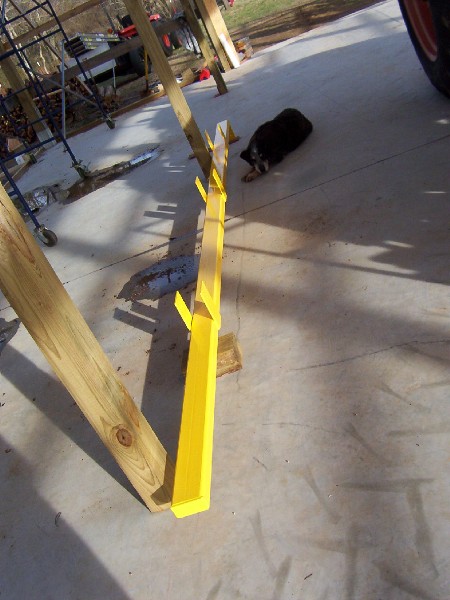

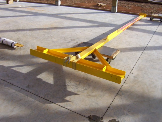

Floor joists & subflooring being delivered. Now to see if that FEL boom pole I made will hoist those 32 footers in the air to set on top band 15' up in the air. Pics of that to follow.

/ BARN going up #44
I got the measurements from you and built a fel boom pole like yours. I hung 7 30' trusses 12' with only slight problems. First problem was figuring out how to attach the truss to the pole in a way I could get it off when the truss was set. The next unresolved problem is my wife alleging she got stretch marks from tugging on the rope that was tied to the end of the truss for guidance issues. That's a nice design you have and thanks for the help making mine. Didn't have to hire anyone and could work at my own pace.
/ BARN going up
#45
regor66- Glad my design/dimensions helped you with your boom pole.

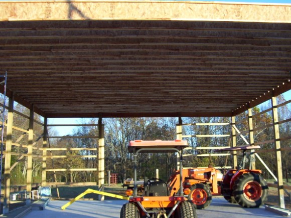

Got about 2/3rds of em up.

Another joist shot from above.

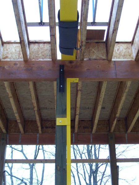

8" x 8" Wide flange beam, 610 lbs. just have to get it 14' in the air. No problem

#55

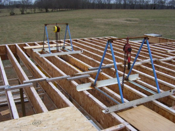

Stuck these little "A frames" together out of some scrap, chain hoist on either end, and lift er up into position.
/ BARN going up
#56
Beam up and nestled between joists.

#57
Support Post on one end up. This one was actually hardest part of all, but me and chainsaw, my partner in crime, got er done.
/ BARN going up
#58
Support for other end attaches to 4"x6" post. This one was not so bad to get installed.
That completes Beam install. Now on to subfloor, roof, etc. Next message I'll show you how me & Chainsaw hustle plywood subfloor up on top.

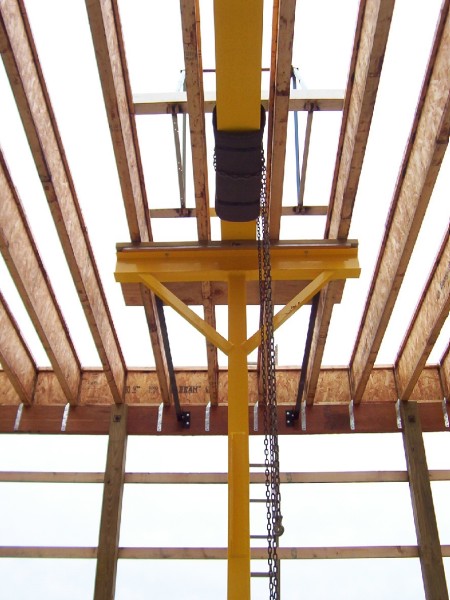

/ BARN going up #59
dullpain,
I like the A Frames. Very clever!!!
I'm guessing the beam is for a chain winch like used in auto shops, but that's just a guess. Am I correct???
Thanks for the updates, it looks like your moving along nicely.
Eddie
/ BARN going up
#60
Thanks, the Aframes worked great, and you guessed correct. If you look at the Aframe pic , I'm going to put the yellow chain fall (furtherest one away) on a trolley for hoisting items. Got 16' of travel on beam, and about 12' of lift . Have had a smaller version in my shop for years and it has been so handy thought I just couldn't do witout one in the barn.
