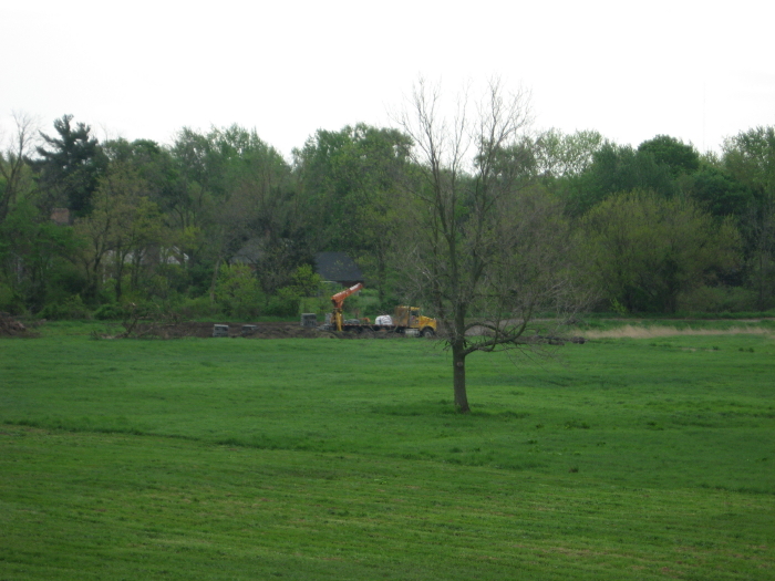

/ Barn building with tractor help?
#9
Well, the footer got poured. Yes they poured using the dirt as walls. I have heard reasons to and not too. It has stayed wet since pour with only a dusting of dirt on the surface. At its smallest it is 25" wide by about 8" deep. One portion is just about 48" deep the other is about 22" deep (below ground level. Frost level here is 38" per zoning. The low( 22") spot is being filled with dirt on both sides almost another 2' so all will be well below frost level.
That may seem a funny way to do it--pour then fill, but I have low level muck soil and this is the only place for a barn. so I want all higher than surrounding grade and need to add some fill on the low side. I can also add an extension later for animal and be sure their feet stay dry.
The picture that looks like the footer is on grade is deceiving. The bottom of the footer is actually about 2' below the surface--just doesn't look that way in the pic.
Now I will try this photo thing. I have done it before but now have new camera, new program, and new computer!!

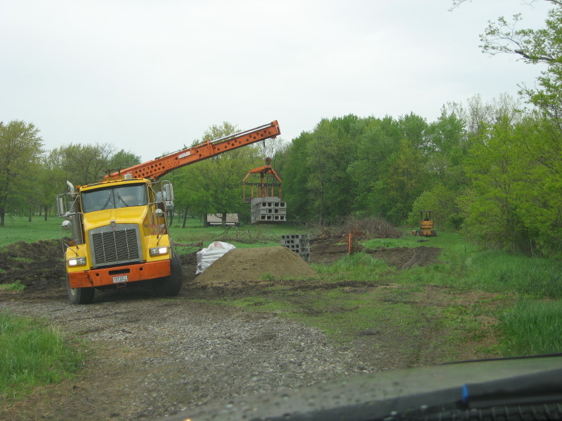

Hey it worked! And it automatically did the "thumbnail thing." The nice brush hogged area is the work of my wonderful wife...not me. I guess it is fair the share seat time.

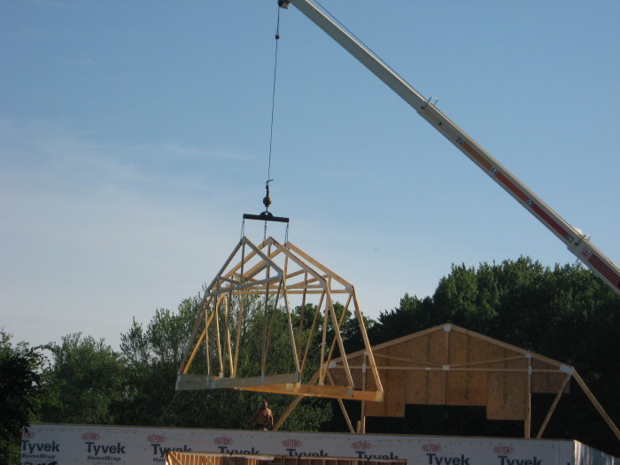

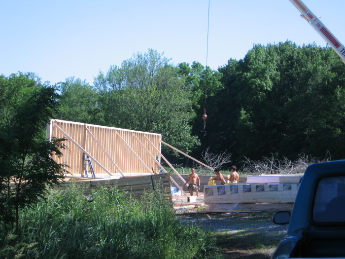

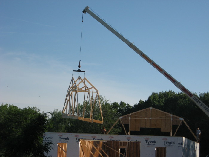

#20
OK, a lot has been happening.
The crew came out and set the walls on day 1 and the trusses on day two...done...well worth the money. I cold never have set those trusses and a crane would have cost me more than this guy's crew doing the whole thing. Couple pics of that happening.
I then got the decking up to the truss floor. That was a bear. I put two boards from the ground leaning at a slight angle up between two trusses. I then put the tractor bucket below them. Then the boards went in the bucket leaning on the boards. I lifted the bucket up as high as it would go...about 8'. Then I had to climb on the trusses and pull those sheets up...Nearly killed my back. After the first one was up and nailed down they got easier...but heck I am a small guy!
I then marked and dug my holes for the posts for the shed extension for animals. I dug my holes with the backhoe to about 42" and then mixed two 80# sacks of concrete per hole for about a 20"x24" pad. I didn't use the PHD since I only have a 12" auger and I wanted a good pad and to be able to adjust the posts so they line up well. I know I am not that good with a PHD.
I set one post today . Those 6x6x16' posts are HEAVY! I have to give 100% credit to one of the recent pole barn posts here on TBN. The guy showed how he put a board in a hole then used the tractor bucket to lift the other end of the post until it dropped in the hole. I forget who it was but tell him THANKS for me if you guys remember. It worked like a charm. Once the post was in the hole it was not too bad to move around and get plumbed. I then filled the hole with gravel (1.5" to fines--compacts really well). I compacted it with a board in 2"-3" lifts.
I also have to give credit to my 8 year old helper...he is a HARD worker. He went around and hammered any proud nails on the decking. I am so proud of him. He climbed up a 13' ladder to the deck. I know I was more scared than he was!
Well that is my recent progress. We also did a little grading and putting foam board against the foundation. It is fun have my children out there when it is safe enough...but I am always scared for them.
Any suggestions please let me know....my "plan" is a loose idea in my head and can change!
