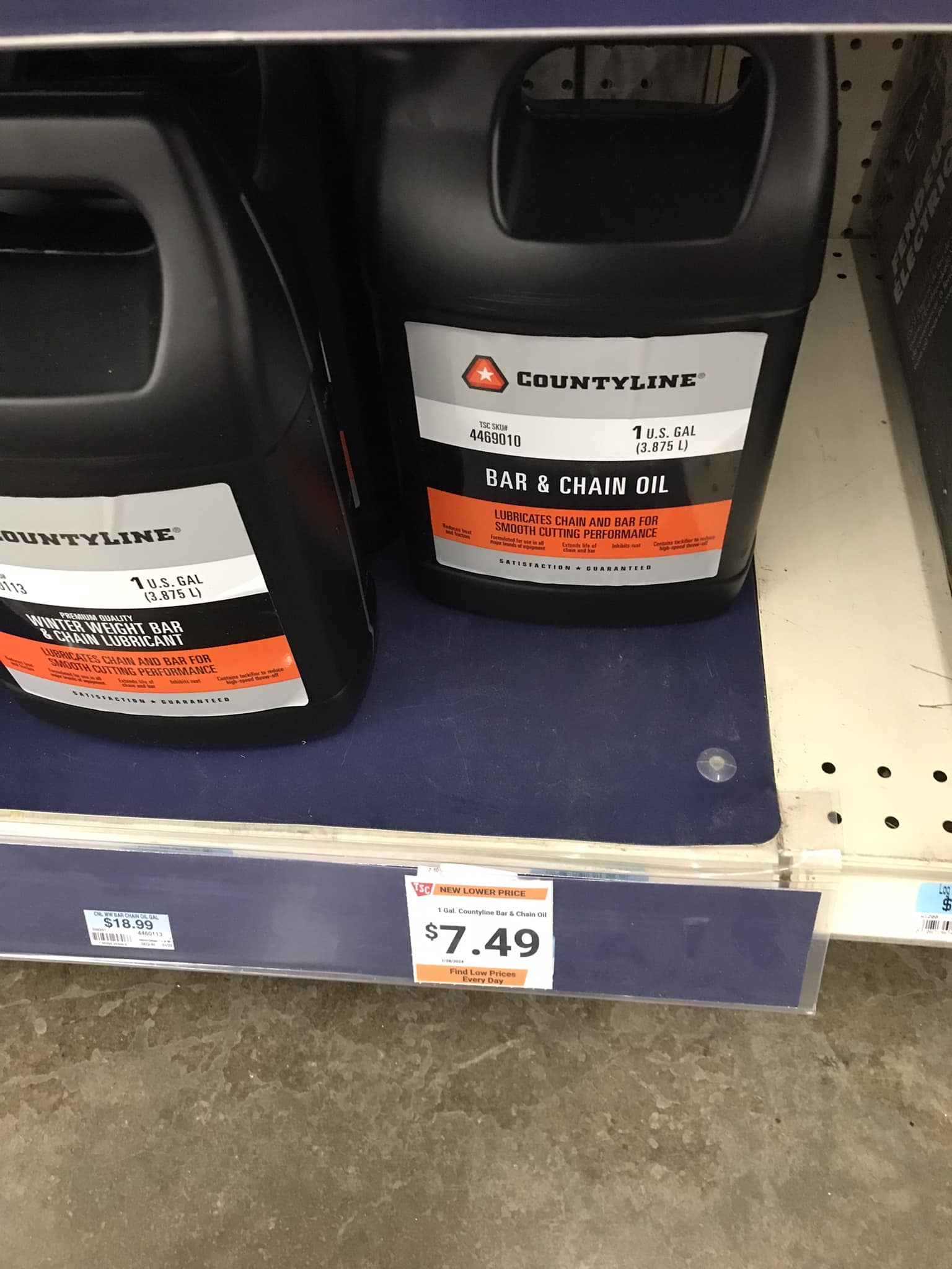

I use County Line bar and chain. I can say I’ve never had that issue with this brand.
