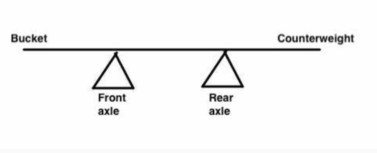

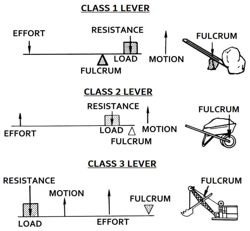

Traditional lever diagrams are wrong for a tractor, which has two "fulcrums."
Bruce
Exactly my point from above. And we both have enough education and experience to understand your illustration is significantly different from those posted earlier with one fulcrum.

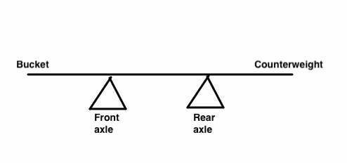

Seems to me. . .
allow me some assumptions in a make believe case.
Given
The distance from the bucket to front axle is 3', the distance between axles is 5' and the distance from the rear axle is 3'
If your counter weight was 0 and the bucket weight was 500lbs
There would be a moment of 3ft * 500lbs or 1500ft-lbs around the front axle
To offset that, the rear axle down force required for that moment would be 1500ft-lbs / 5ft or 300lbs would be relieved from the down force on the rear axle.
Don't believe that? Keep adding weight to the bucket until the rear wheels come off the ground (essentially putting 0 weight on the rear axle)
Putting counterweight on has exactly the same effect on the front axle.
Hey, I've been out of school a long time, I could be wrong but I don't think so.
