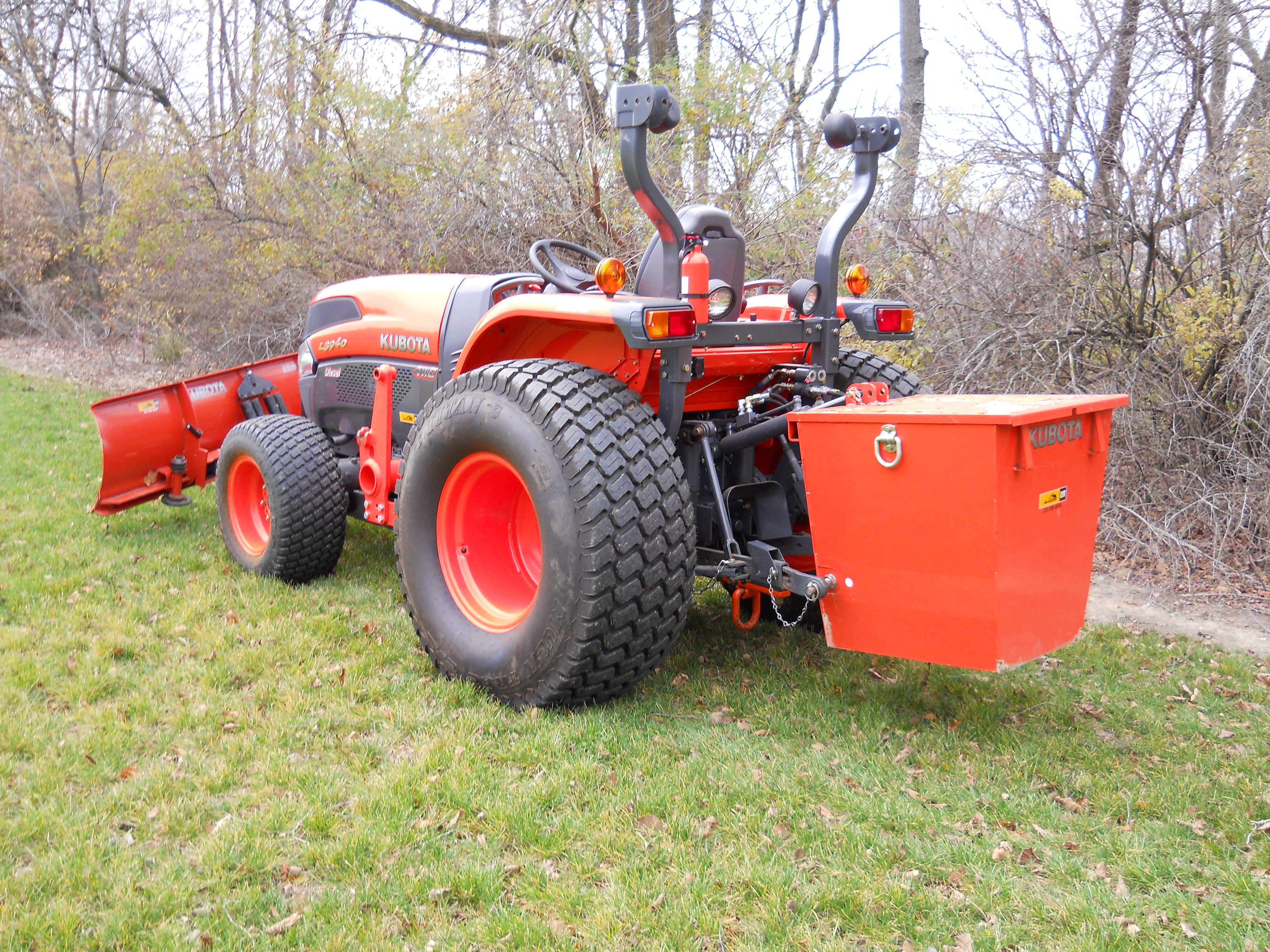

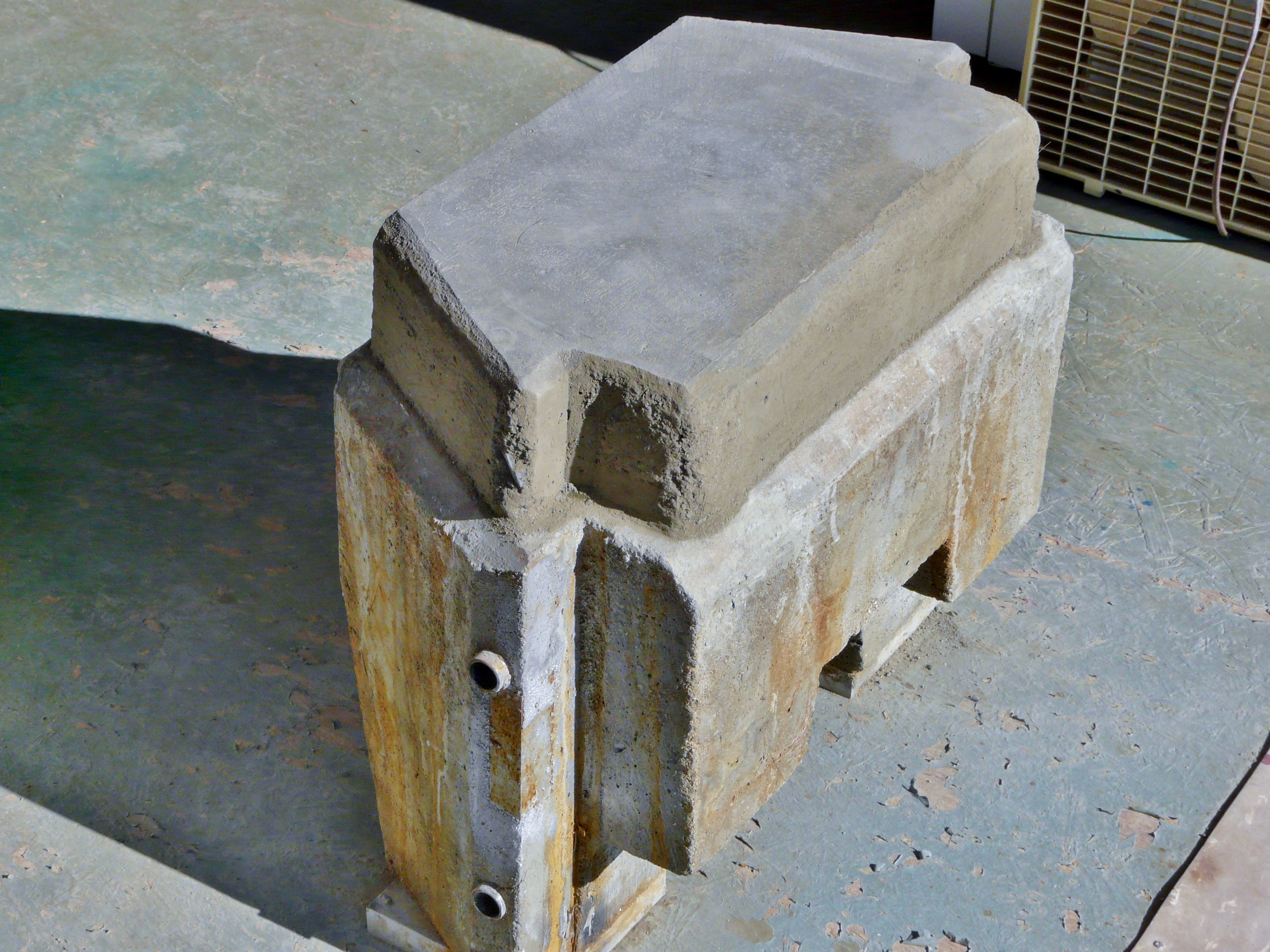

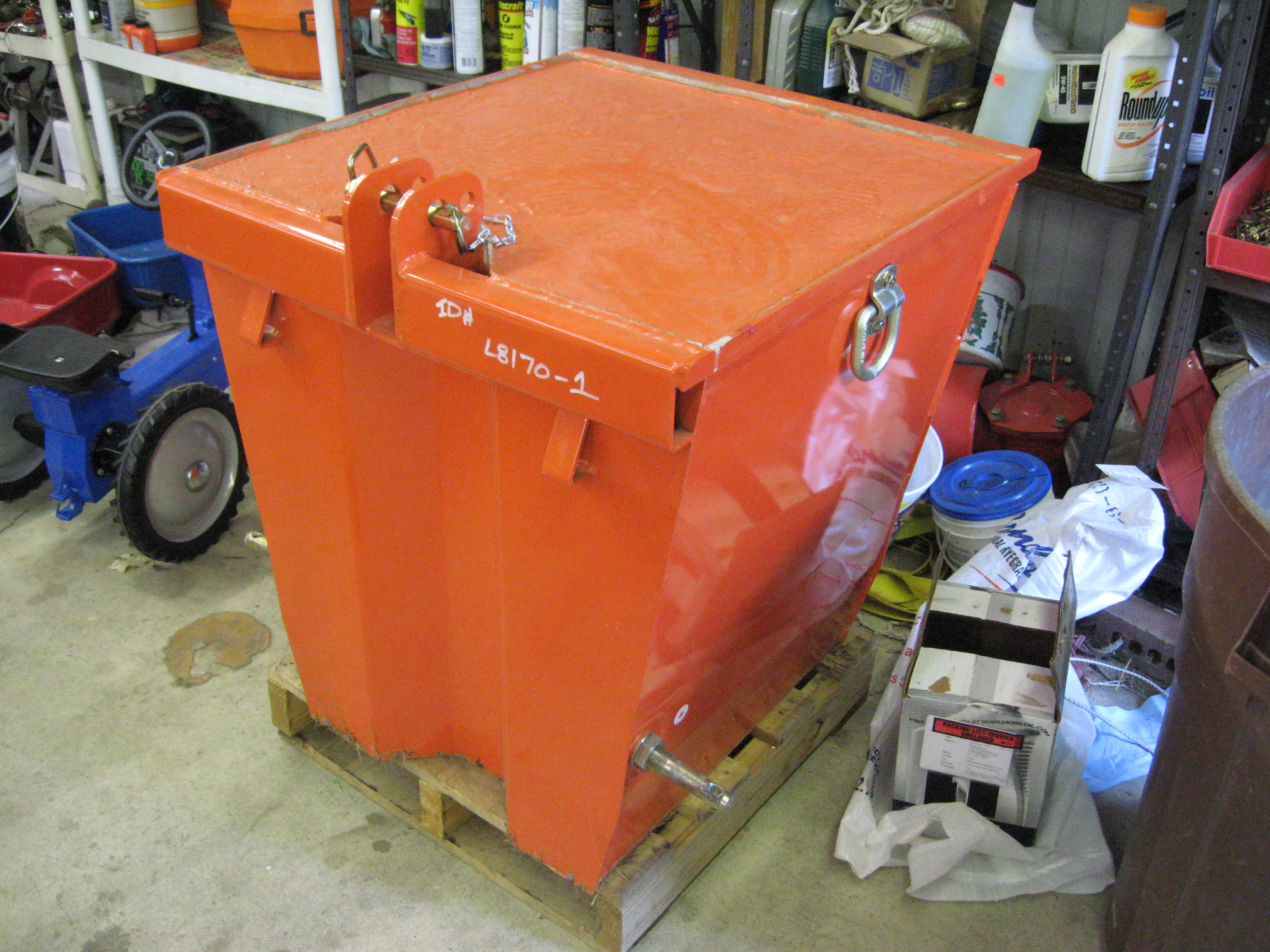

I filled my 1250# ballast box with concrete in October 2010. No regrets in 6 years ;) When I need it, all the weight is there, stable, and ready to go, takes less than 5 minutes to hook up with telescoping side links and hydraulic top link. Philip.

Many fill their ballast box with sand, then add water to set weight for each chore. Downside is increased humidity if stored inside, rather than outside.

I favor removable weight in my ballast box, rather than permanent concrete... I figure it's about 600 lbs with a full load of rock, which is enough for my purposes. A bigger box would hold more, obviously, if needed. The small, close box doesn't create problems when maneuvering in tighter spaces, like a rear blade or cutter might.
