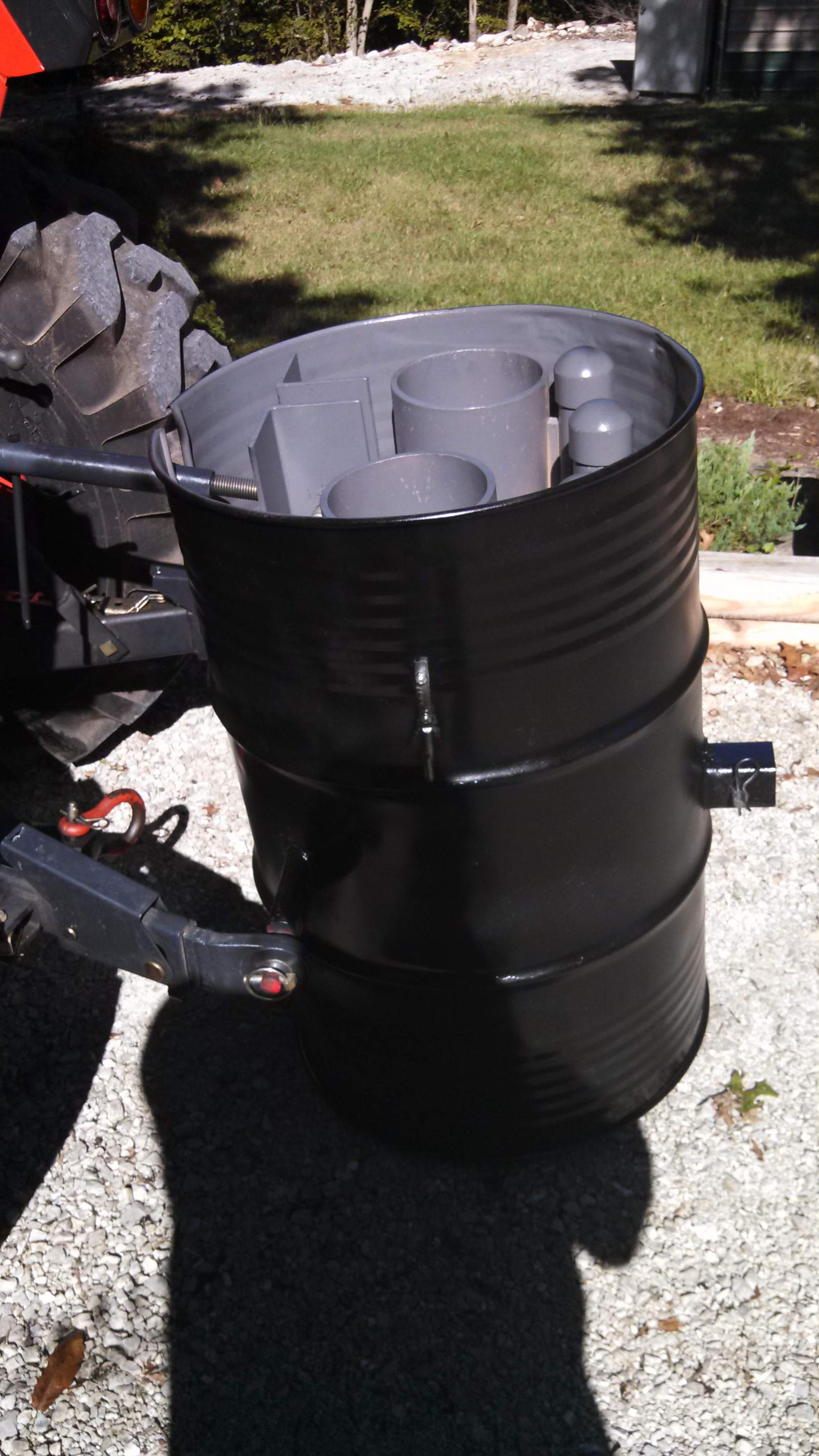

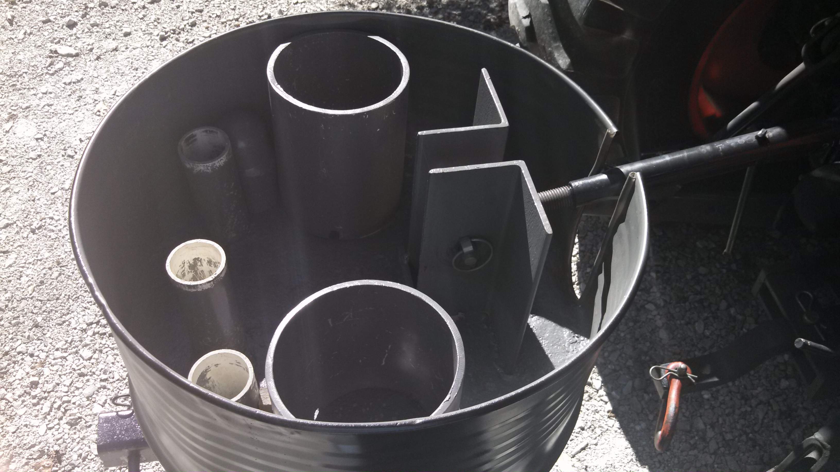

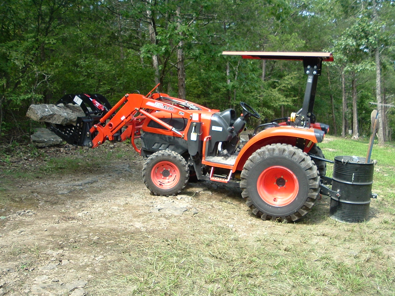

I have a nice metal 55 gallon drum. I was thinking about welding on 3 pt hookups to that with a "frame" extending into the drum and then filling the whole thing with concrete. Would that make a good ballast weight for my tractor?

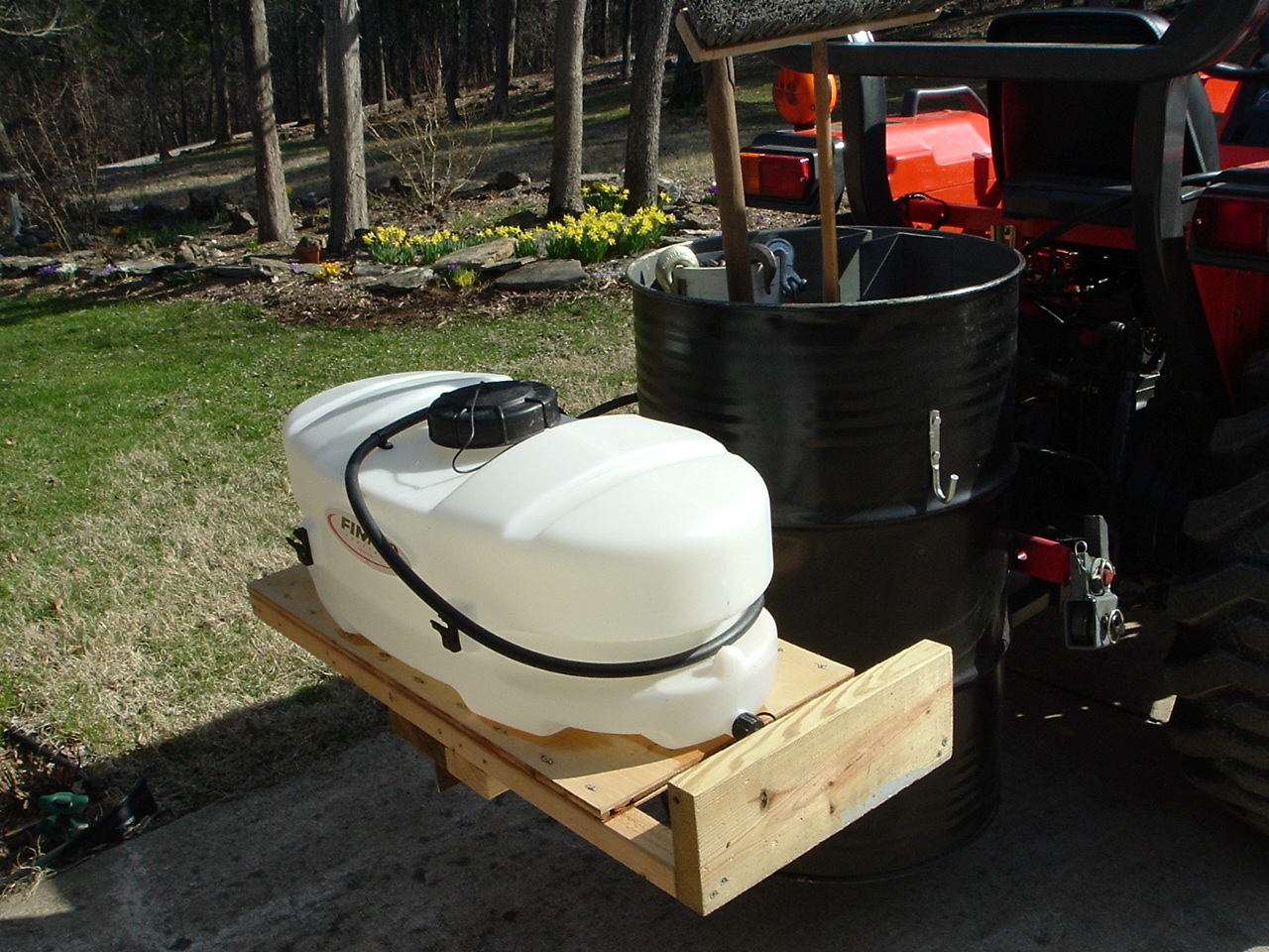

This is what mine looks like... abut 750 lbs.. I keep several chains and a digging bar in it. so over 800 lbs total. I use the 2 inch rear receiver to carry my sprayer. You could put a bunch of steel pieces or lead wheelweights or something heavy in the mix to increase your weight. I put 3 pipes in for handle tools, I wish I had put in 4. and I wish I had put in some old nuts and bolts or something to make it even heavier.

I could cut one section of a metal drum off, weld it to the top of the other drum for a taller height, and fill that all with concrete. That should put me at about 1500# of concrete and barrel weight. If I lay the drum sideways, that leaves me almost one foot of space on either side of the tractor for maneuverability and keeps the weight low.

I really like your setup. That is just so handy. Is there a slot/scabbard for a chainsaw bar in there too?
I just put my saw head in the space between the 6 inch chain holders blade up. But it would not be any trouble to mount a scabbard on the side or back even now. I just don't need the saw all that much so I never did it.
If you put one of those fold up SUV 2 inch receiver carriers on the back on the 2 inch. you could strap all kinds of stuff on the back of it if you were making a day of it in the woods or something. Cooler, water jug, chainsaw, fuel etc. I use the 2 hooks on the side to hang my short chain draped around the barrel, and also for 5 gallon buckets hung on them for tools etc. The idea of the short chain is to leave it hooked up as you move around when you are pulling trees then hook your long chains to the short chain to keep from having to go under the barrel each time to hook to the clevis. just hook to the short 6 foot chain.

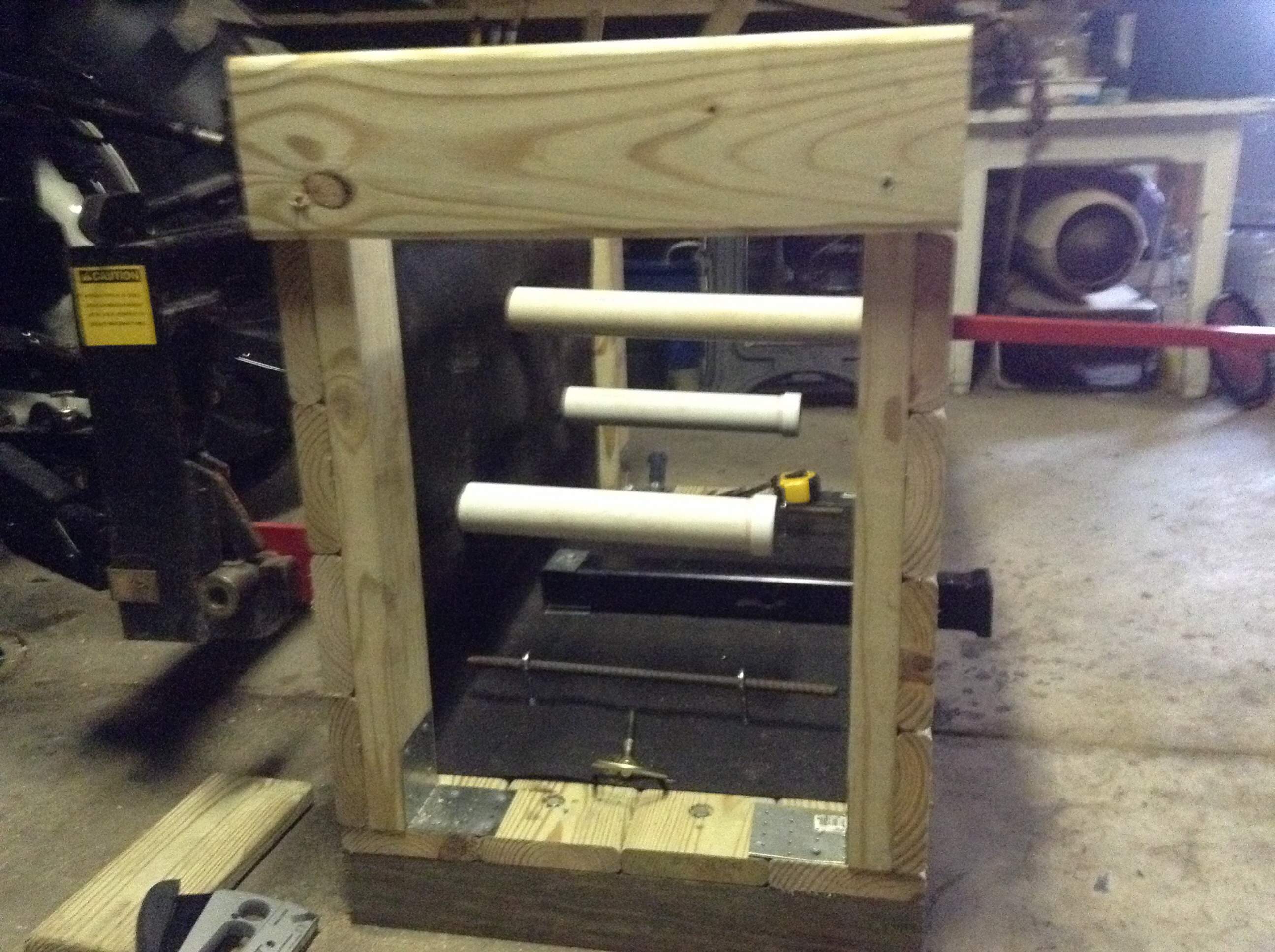

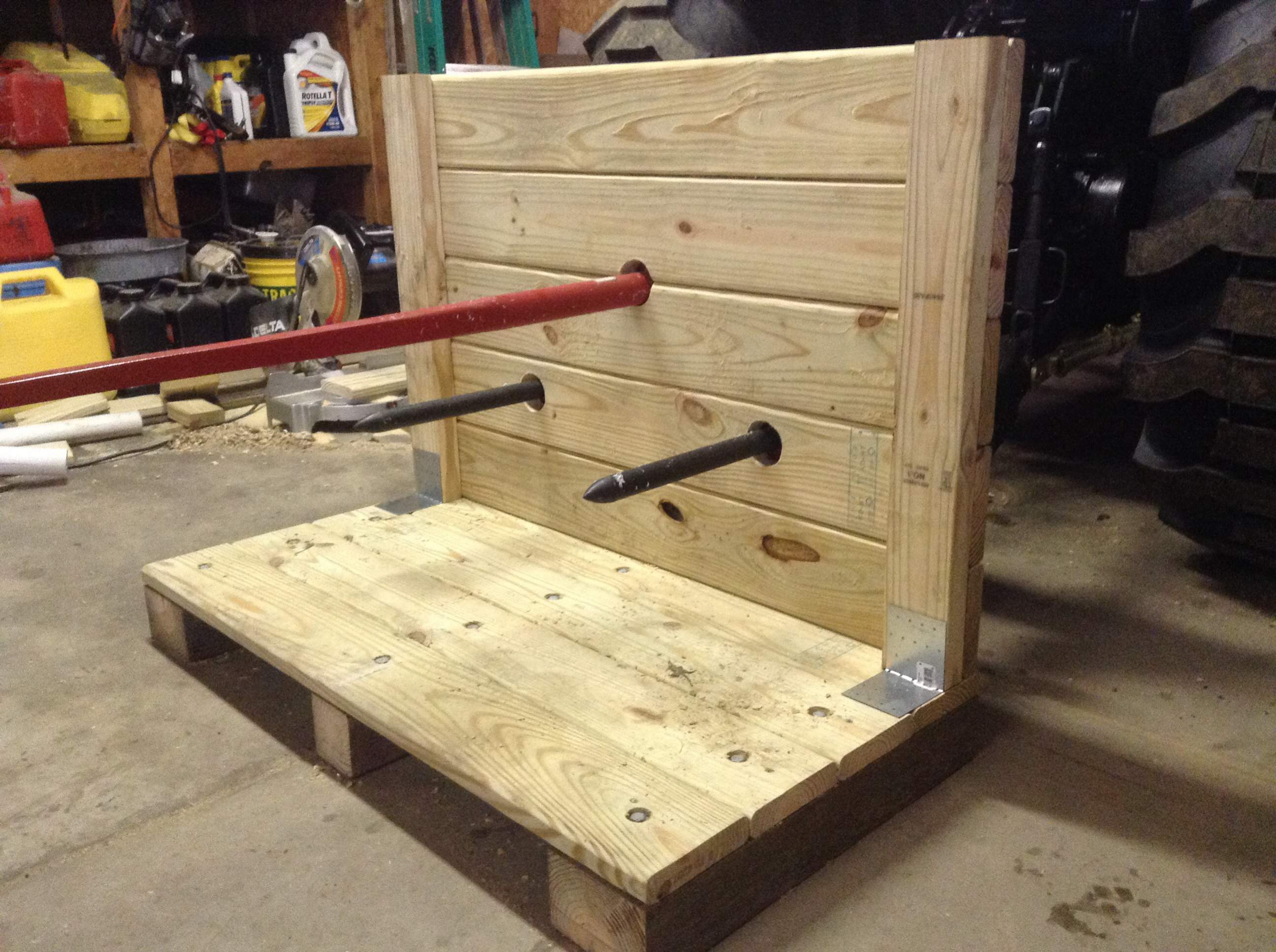

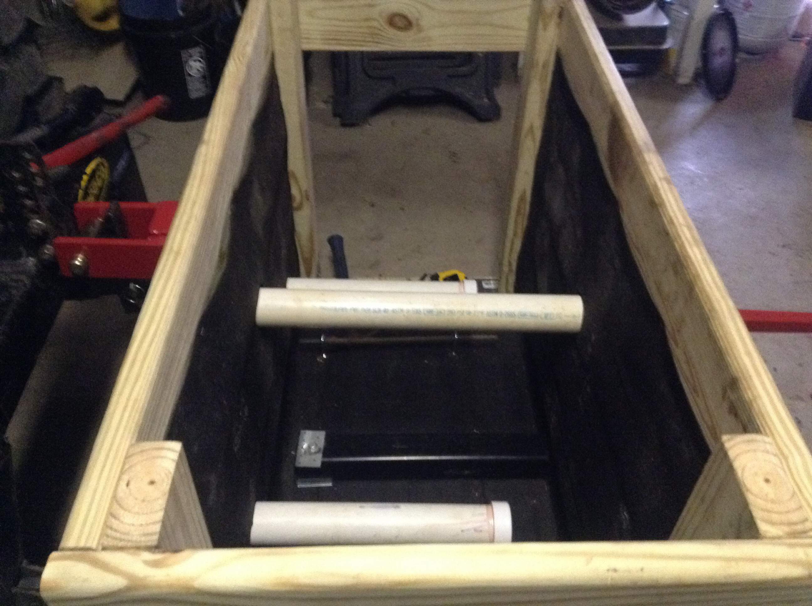

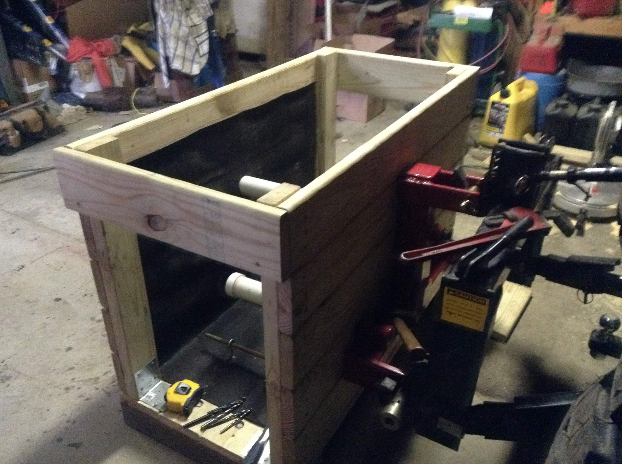

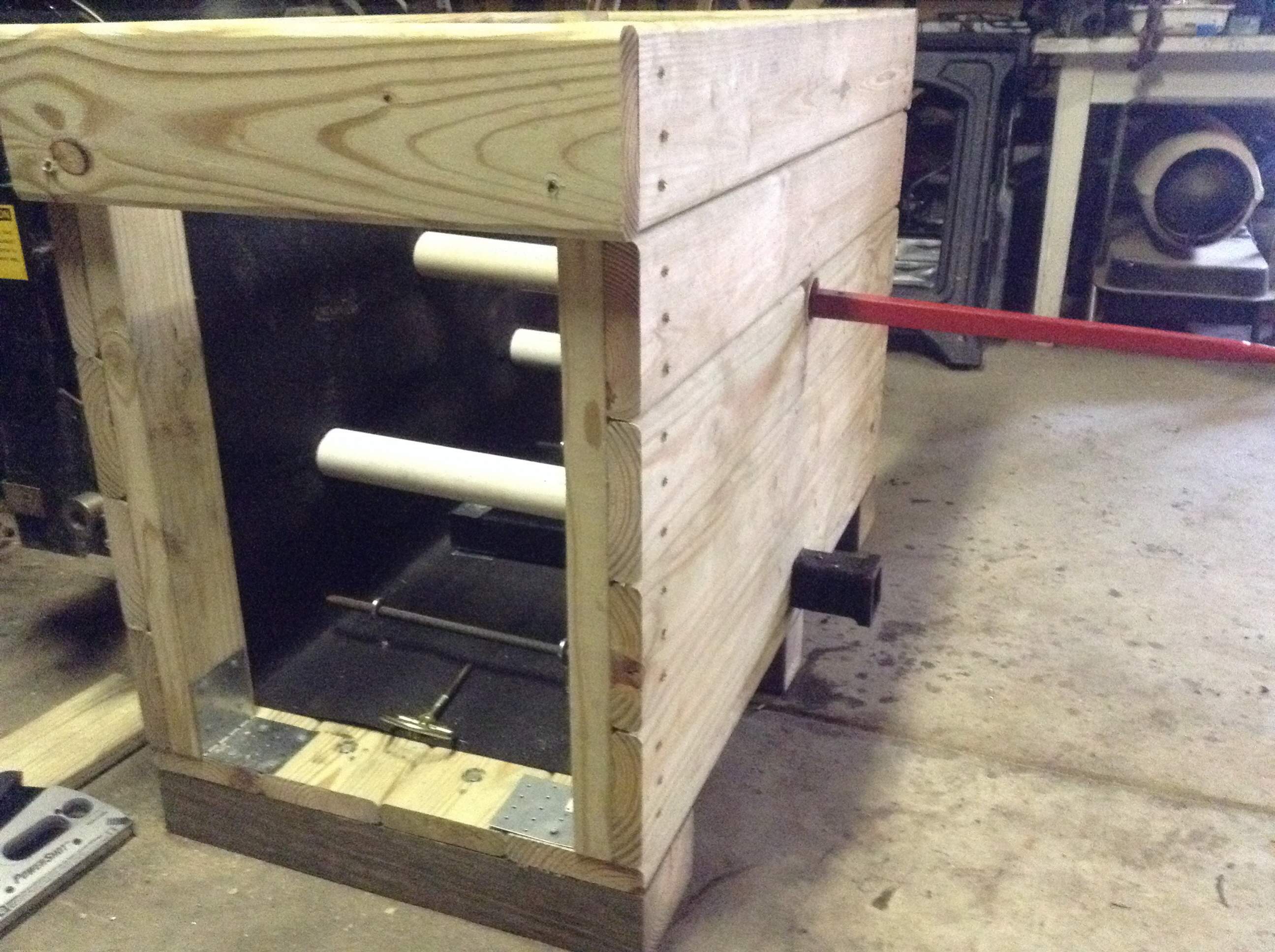

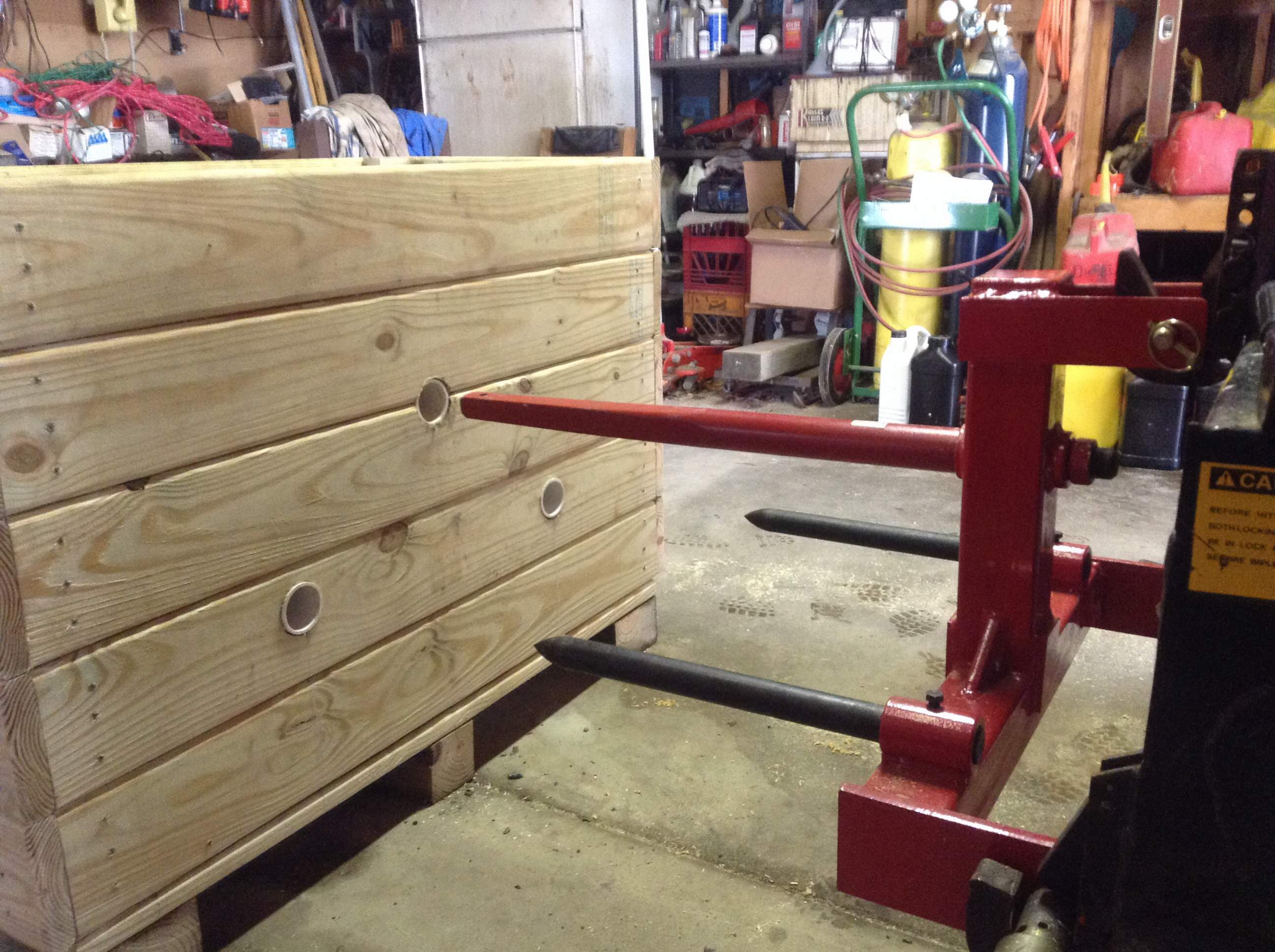

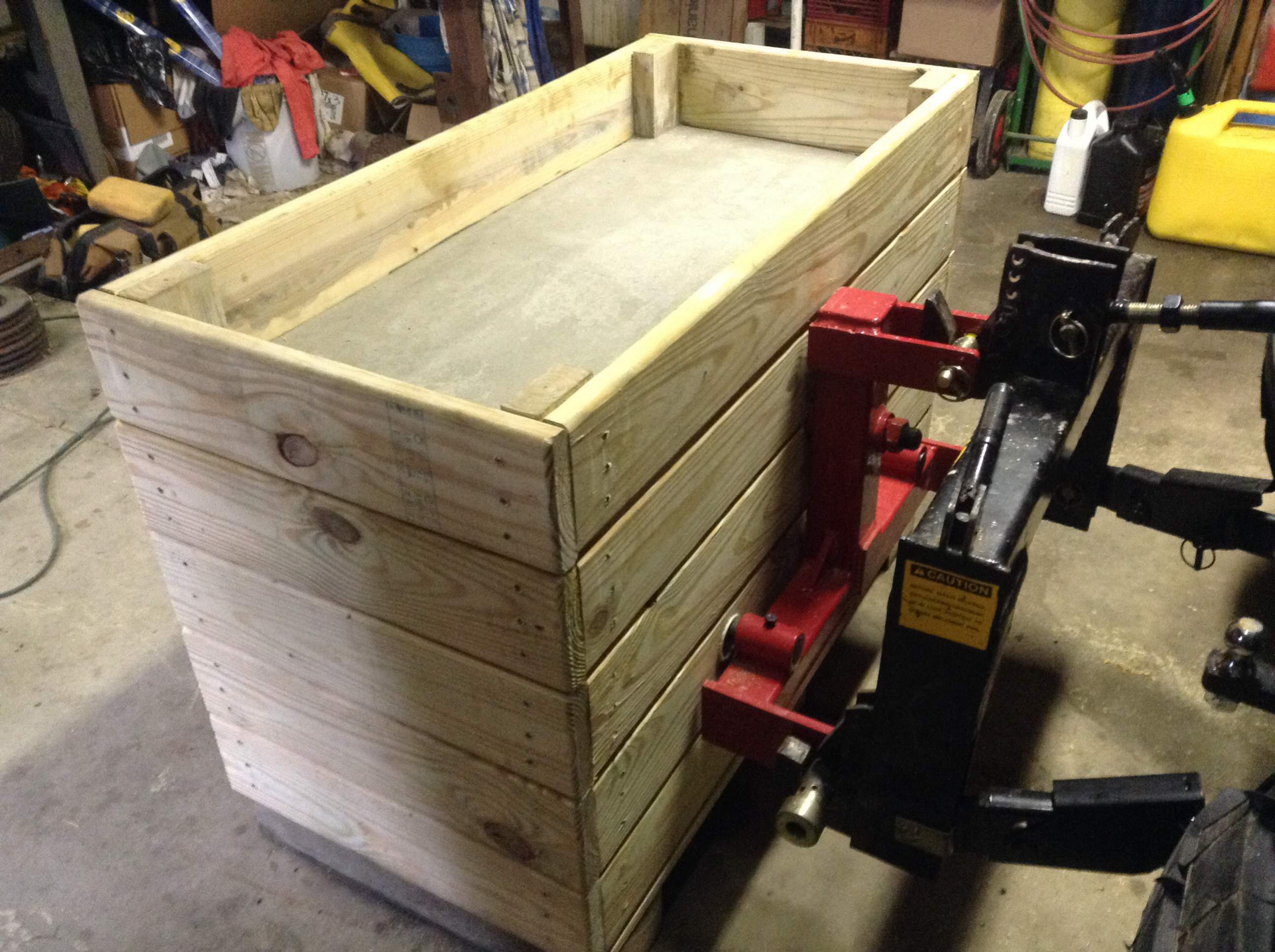

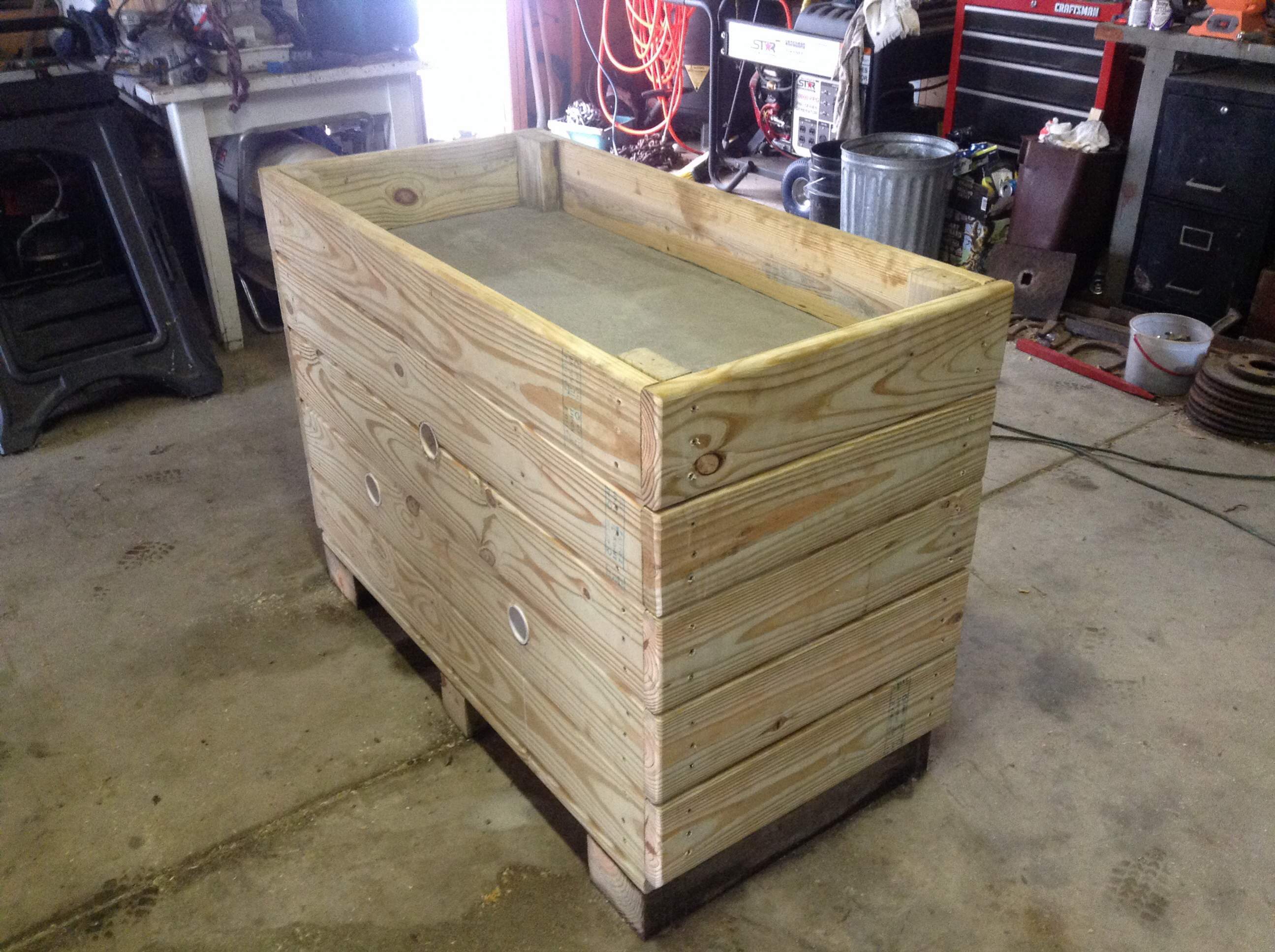

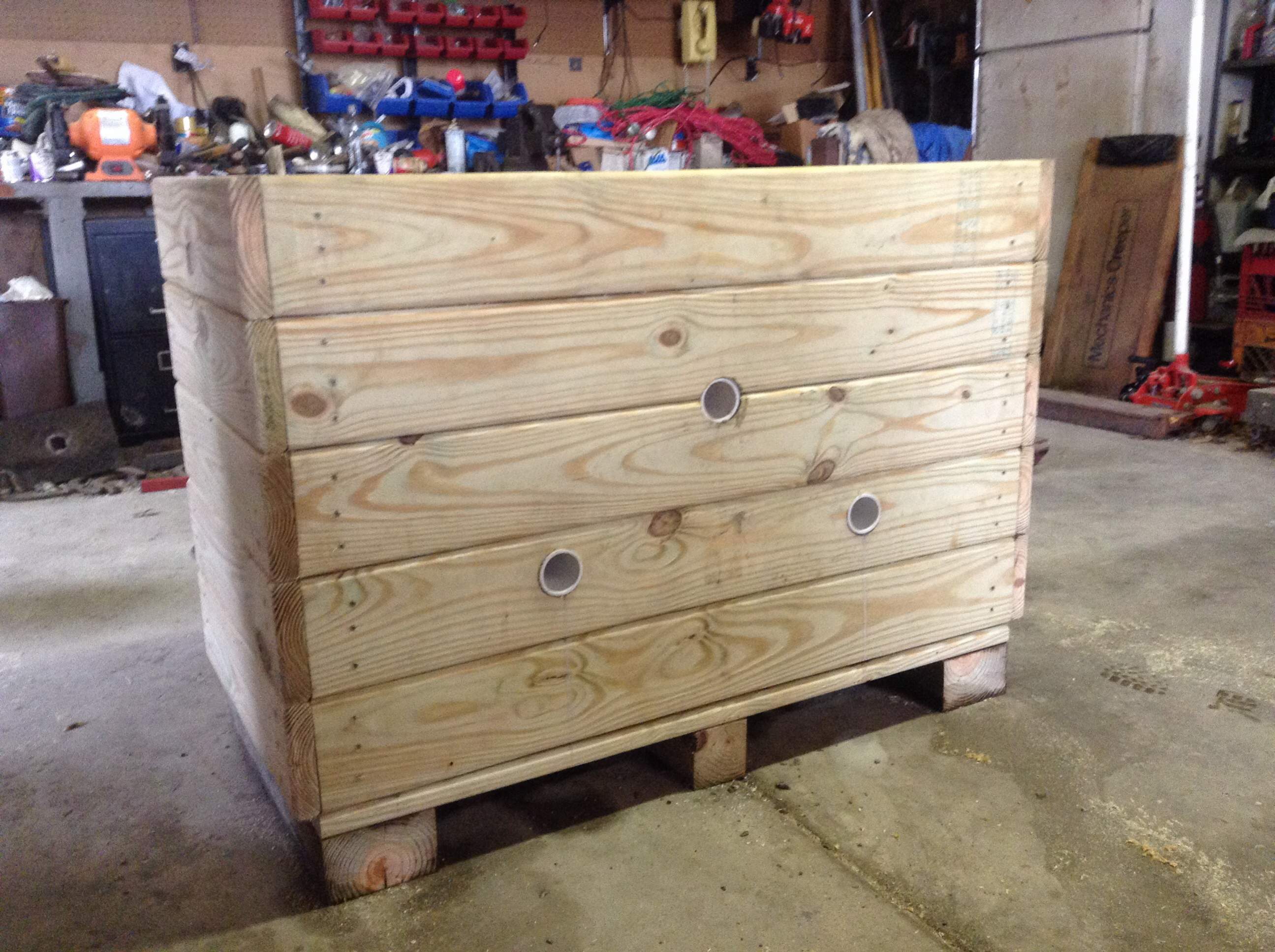

I am in the middle of building one with a 3pt bale spear ( Titan - $169. ). The spears will slide into PVC pipe so the spears can be pulled out if need be. I will be cutting the center spear off and putting a hitch pin thru it to keep block from sliding off. The concrete level will be down 5" from the top so I'll have a storage area. I will be leaving the wood attached. The inside dimensions of the concrete block are 20.5" W x 44" L x 22.5" H (approx 1600#)

NICE!!! Very NICE!!! Your weight is carried a little farther back off the 3 point, so you will get a little more leverage out if it. Should perform well!

Just remember them little spikes don't hold weight very well . The break and bend easy .

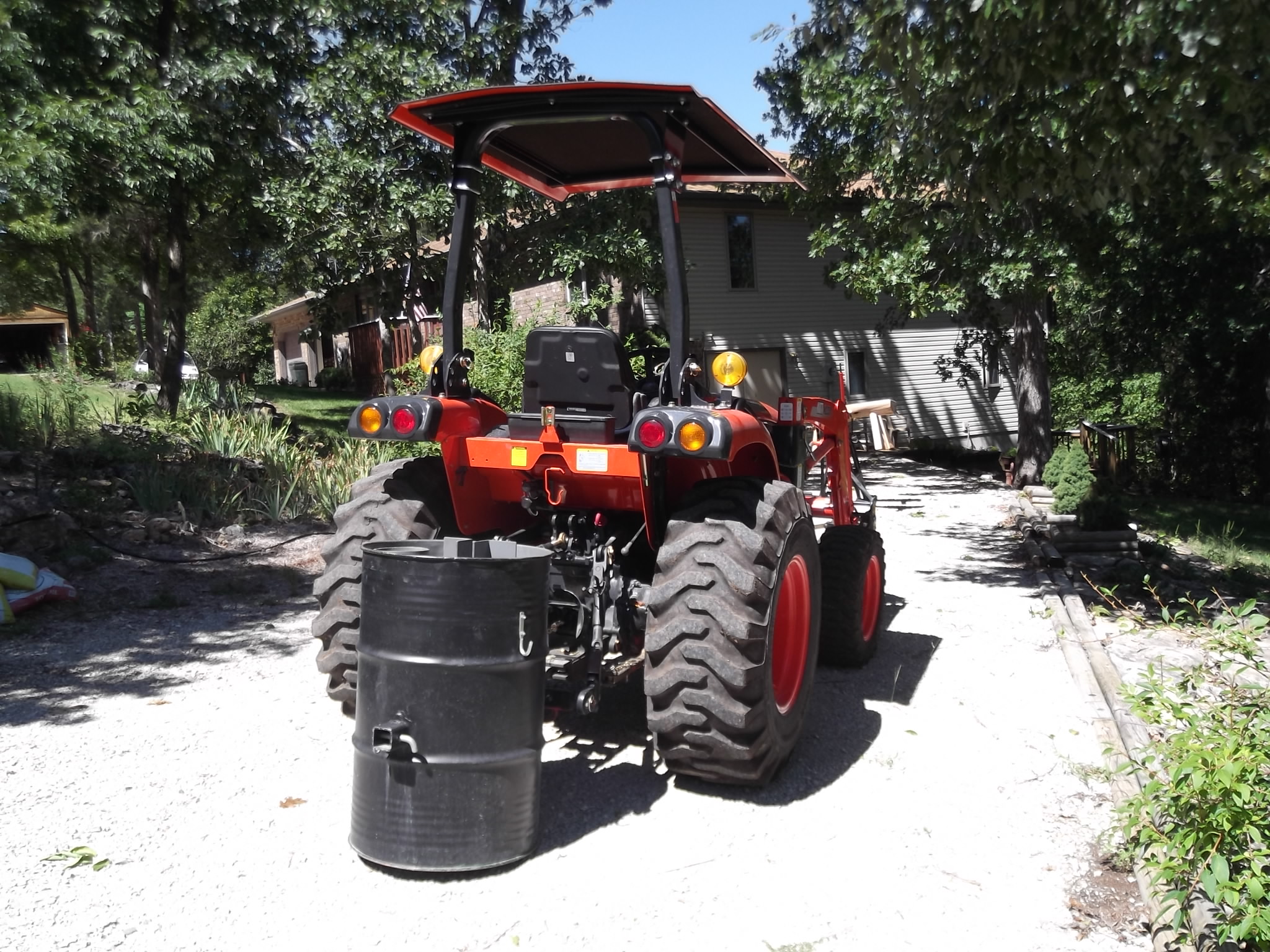

My barrel makes an effective bumper. This is quite useful while tree shearing when maneuvering for a good angle is tough. The plastic is tough enough that I don't mind it touching down on my Sandy soil.
It I had it to do again I'd have built it horizontally with a detachable base stand so I could carry it lower still.

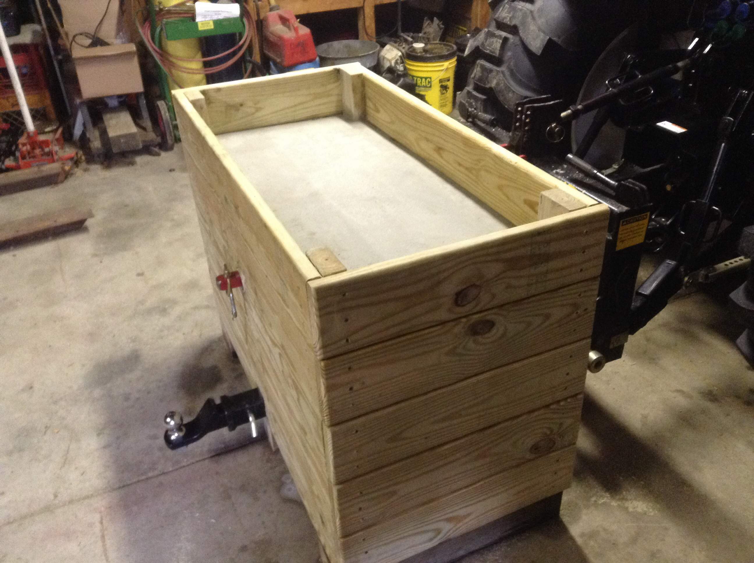

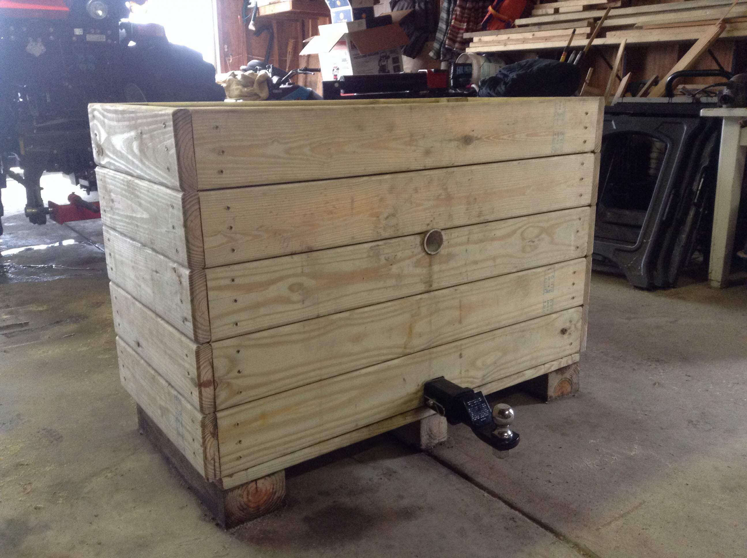

Finished my ballast box today: concrete weight is 1600# the wood box is approx. 200#. The total should be real close to 1800#.
