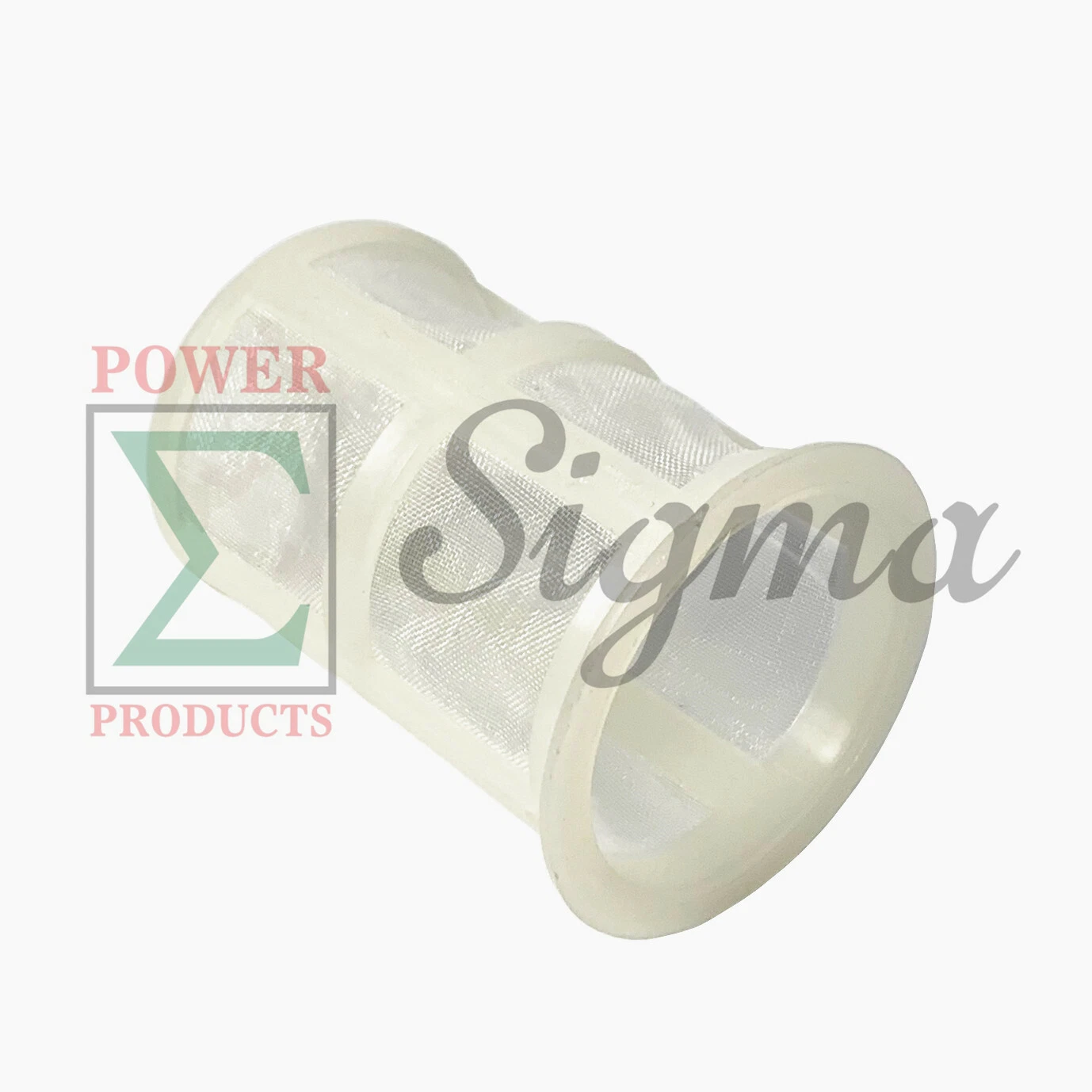

Yeah. I always pour fuel into the Yanmar inlet strainer. Photo below.
I think the mess I have now is bacterial growth subsequent to filling the jugs in 2024. The blobs like black cotton in the strainer this week are new. And now there are some down at the real fuel filter. That gas station must have had a batch of bad Diesel.
Running 20 gallons of fuel polluted with this crud - even if the biocide had neutralized it - would have likely been bad for the injector system.
