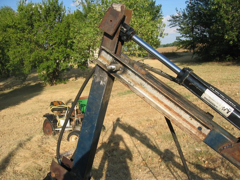

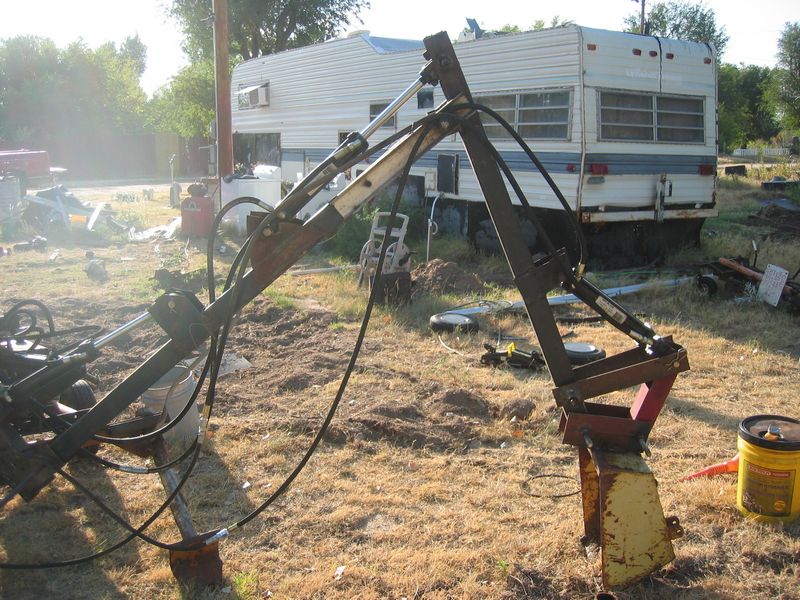

The day before yesterday, I crawled under the Kubota backhoe, which is sitting two 100' 10 AWG extension cords out in the field. I bought some 2X2X1/4 tubing to fit into the slots for the lower 3-point arms. Though the slots measured two inches, that wasn't quite exact. They were not quite parallel and the square tubes would not fit. I didn't want to grind the 1/4" material. I thought it better to grind the 5/8" stuff on the backhoe. My skinny, bad backed, old man body, lying on the ground, wielding a big, heavy, guardless, Makita grinder, was pure torture.
Anyway, I got the tubes to fit after a couple of hours. Yesterday when I got up I was about crippled from the ordeal. The mount on the backhoe has three 7/8" pin holes on each side. I drilled the two pieces of tubing to take the pin through one and a 7/8" bolt through another. The tubes are mitered to become horizontal to connect to the frame of a big old boat trailer I'm cutting way down for this project.
So anyway, the inspiration I got here is starting to become progress. I will get some pictures up soon.

Ok, this is my first try at adding the pics, so if they do not show go easy on me.
I had to go dig this post up to see it again. I am concerned that I am going to be dealing with serious negative tongue weight issues, as my axle is way forward in comparison to your rig. I have used a very long tongue, but think the amount of ballast to overcome the leverage of the hoe's weight will be excessive.
