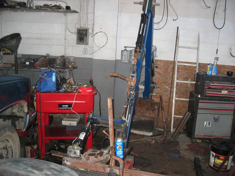

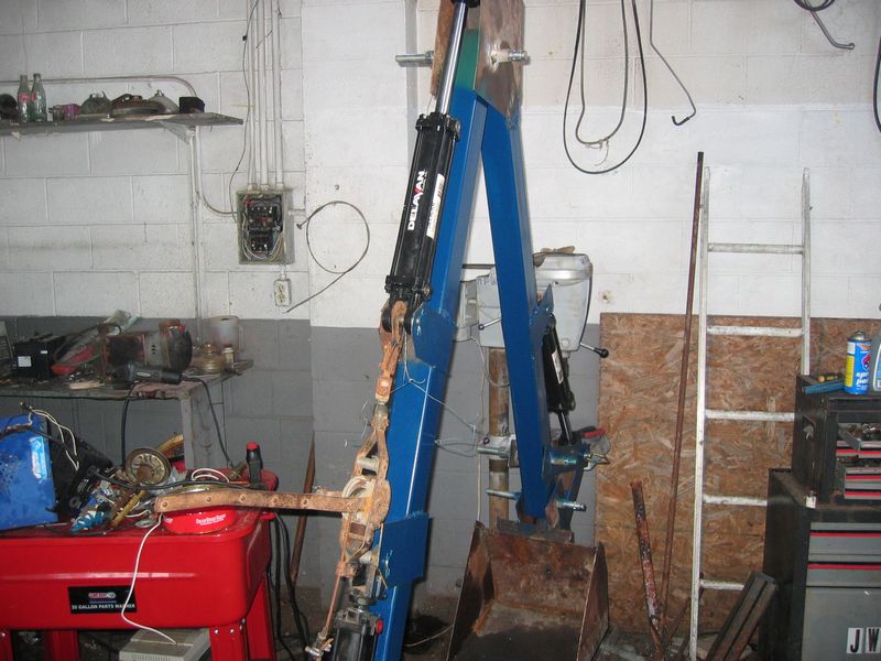

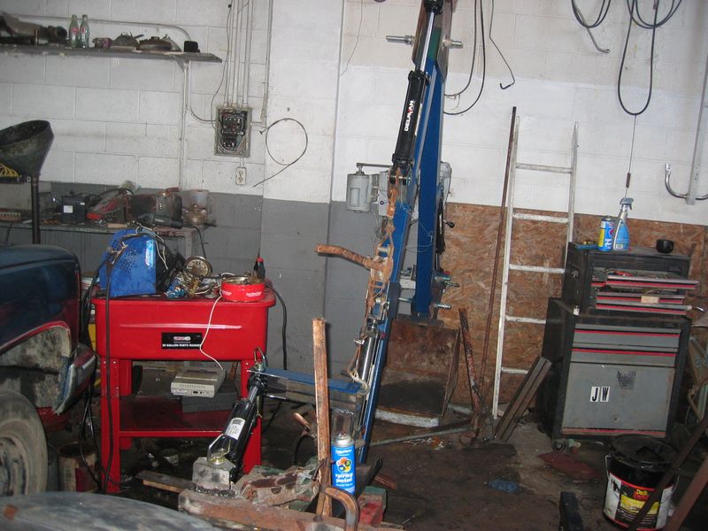

Thanks. I got down to the shop this evening. I took a video but the lighting was bad and the video turned out pitch black for some reason.
But I did take some pics of it with it's blue color and the last cylinder installed.
I can't wait until it's finished. I'm also ready to dig some holes with it. With the progress I'm making. I expect it to be up and running by May or June.
Then I can upload a digging video of it.
I've attached the pics of it I took this evening.
Chad

Why did you make the stick & boom so long ?
Having it that long it is going to put a tremendous amount of force on the mount and tractor and it is going to decrease the available force for digging and lifting.
/ Backhoe update. I'm making progress (Video included)
The tubing I bought came in 6 ft lengths. I was gonna cut them down shorter but decided to leave them be seeing as the cylinders wouldn't have enough room to mount.
Well I did cut the stick down about a ft. The part I cut off the stick was used for the linkage on the bucket.
So in other words. If I were to shorten the boom the cylinders that I used wouldn't fit.
The boom is 6ft long and the stick is around 5 ft.
Chad

the metal those cylinders mount to looks mighty thin for the force applied

I commend you for your interest in building this. I too am a home fabricator and love turning dreams into reality. My shop looks like a small business. Looking at your design I am feeling like you will have a few letdowns. Id love to be wrong. Not being graduated engineering professionals but instead being non trained mechanical engineers we all have our opinions based on our past knowledge accquired in various areas.
I recently bought a Bush Hog 750 backhoe. The specs show that the bucket gets the most force around 3380 lbs with the next being the dipperarm that connects to bucket at around 2244 then last and least is the crane arm closest to the tractor at around 675lbs on my unit. With the bucket rolliing at 3380 lbs I have a feeling the first rock you try to roll out that doesnt move is going to bend your bucked as if it were made of aluminum foil.
Now dont hear me wrong. I think your model is great but in my gut feeling it needs to be greatly tuned. Possibly the length of the arms is going to reduce your power enough that your ability to bend them will diminish. They might flex enough for you to stop before bending. It seems like when working with hydraulics everything always looks like it was built too strong.....well there is a reason for that. There are so many points in the design that will have stress and hopefully its those points that will be beefed up enough to distribute the stress out to wider areas reducing the danger or damage. If you dont want to do any
re-design which Im sure is the case....I would at minimun start welding extra plating onto the sides of most everything you have there. Its the sides that need it not the tops. The tops just basically hold the sides together in place. They dont see much stress. Most of these tractor style backhoes weigh in at 1000 lbs. Interested to see what yours weighs when your done. It might could use some more steel.
:thumbsup: Good luck and I hope it all works great for you and hoping Ive never been so wrong before ..... I would love to come back in here and say... Wow, was I ever off key on this one.
Take care pal, your doing great..... Vic S.

Thanks. I at least finally got to try out some of the hydraulics tonight. :thumbsup: At first I couldn't get no fluid to pump, after trying and trying thinking it was just air. :confused2: I decided to turn the pump around and it worked. :laughing:
All that time it was pumping from the valve side and not the tank. That used pump I bought off ebay for $25.00 really does work. It's got lots of power. I had to basically almost idle it to let the boom down.
I did have one weld break on me though. It was the bottom cylinder mount for the boom. The reason it broke is because I had the come along still attached and I was gonna raise it up a bit to release it. Me not familiar with the controls lowered the boom instead of raising it. Before I could react it snapped it off.
Not to mention, I also forgot I had only tacked welded it in a few places.
I can't hardly get to it with my welder to weld it back in place now so I figure I'll just drill a few holes there and bolt that mount back on.
The only thing I wasn't able to try out yet was the bucket. I still have to get the hoses I need for it.
But I was able to raise and lower the stick, swing it back and forth which worked out great. And of course the boom until the cylinder mount broke.
I also have to grind and re weld the bottom part of the tank. It was dripping hydraulic fluid out a bit due to a flaw in my weld.
I've drained the tank for tonight so I wouldn't lose the fluid. I'll probably go up to the shop tomorrow and fix the tank.

:laughing: Somethings did break on it. So the backhoe is out of service until I get a new welder in a few months.
When I fired it up in the shop things were breaking. The bottom boom mount broke off, the boom cylinder mount broke off.
The mount for the stick cylinder broke. I re welded those up the best I could with my welder. "The welder is a piece of sh*t " it's not putting out the amps it has been.
It held up enough for me to drive it home and dig a little bit.
I'm gonna make it work for a bit with the riding mower so I can dig out the "water line that needs replaced badly". until I can get the parts to rebuild it totally separate from the mower.
