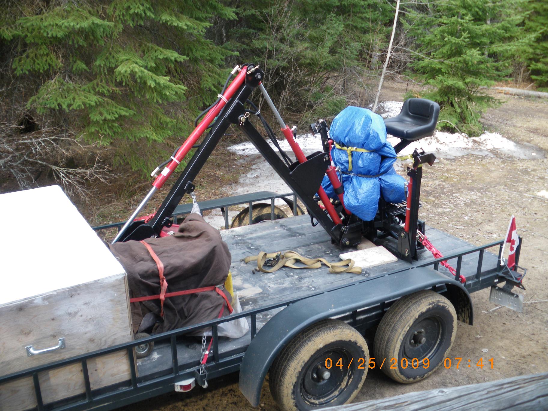

Here's a few pics of the trailer I'm gonna use the axle from. It's the trailer I only gave $10.00 for. I did have to put new tires on it but still $10.00 was a steal.
The trailer is just sitting around and not really road worthy anymore and I don't want to put anymore money into it. So figure why not transplant the axle and use it for a backhoe.
I got the other new rim for it but have to get a new tire and mount it. I pulled that trailer from Cove Arkansas to Turon Kansas with the pickup it's hitched to in the photo. And I had that trailer overloaded too. It was loaded to at least the top of the cab of the truck.
When the weather clears up, I'm gonna go out there and cut the welds holding the bed to the frame and axle and lift the bed off using my dads tow truck.
Chad

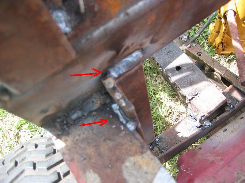

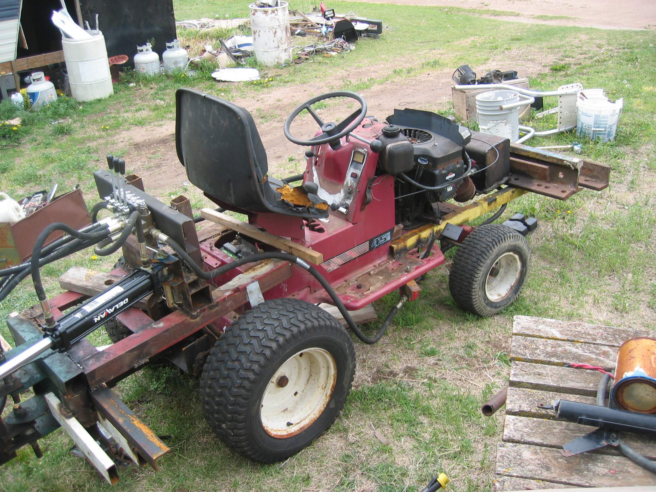

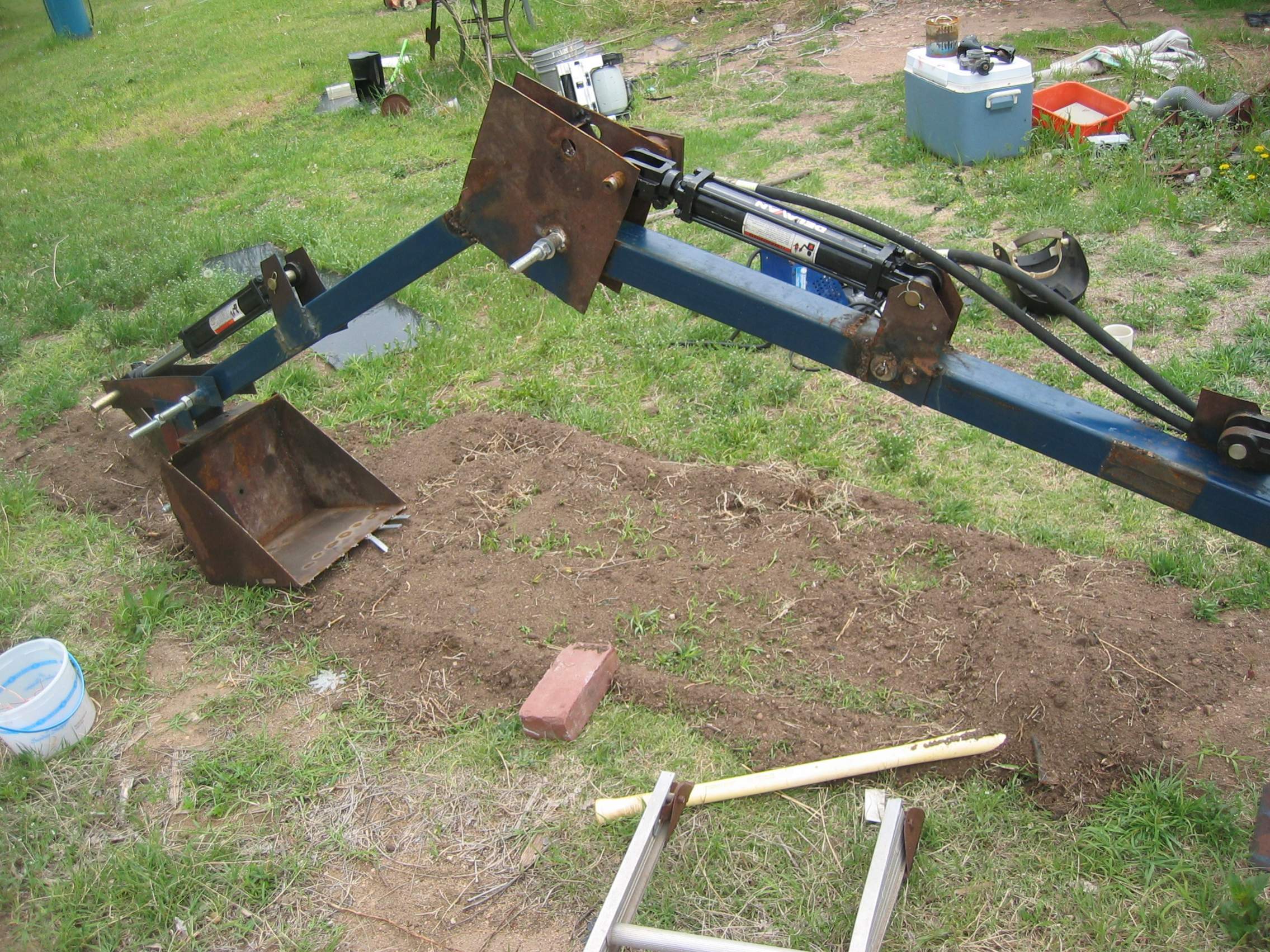

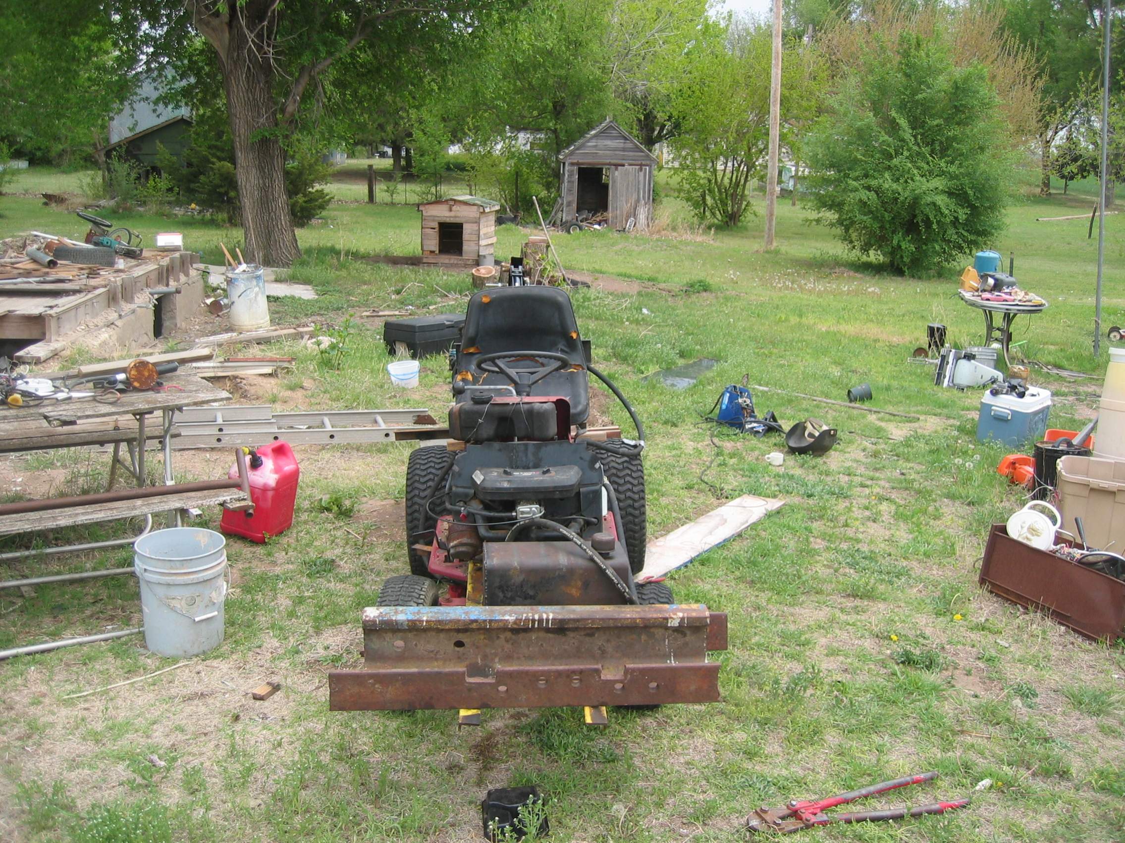

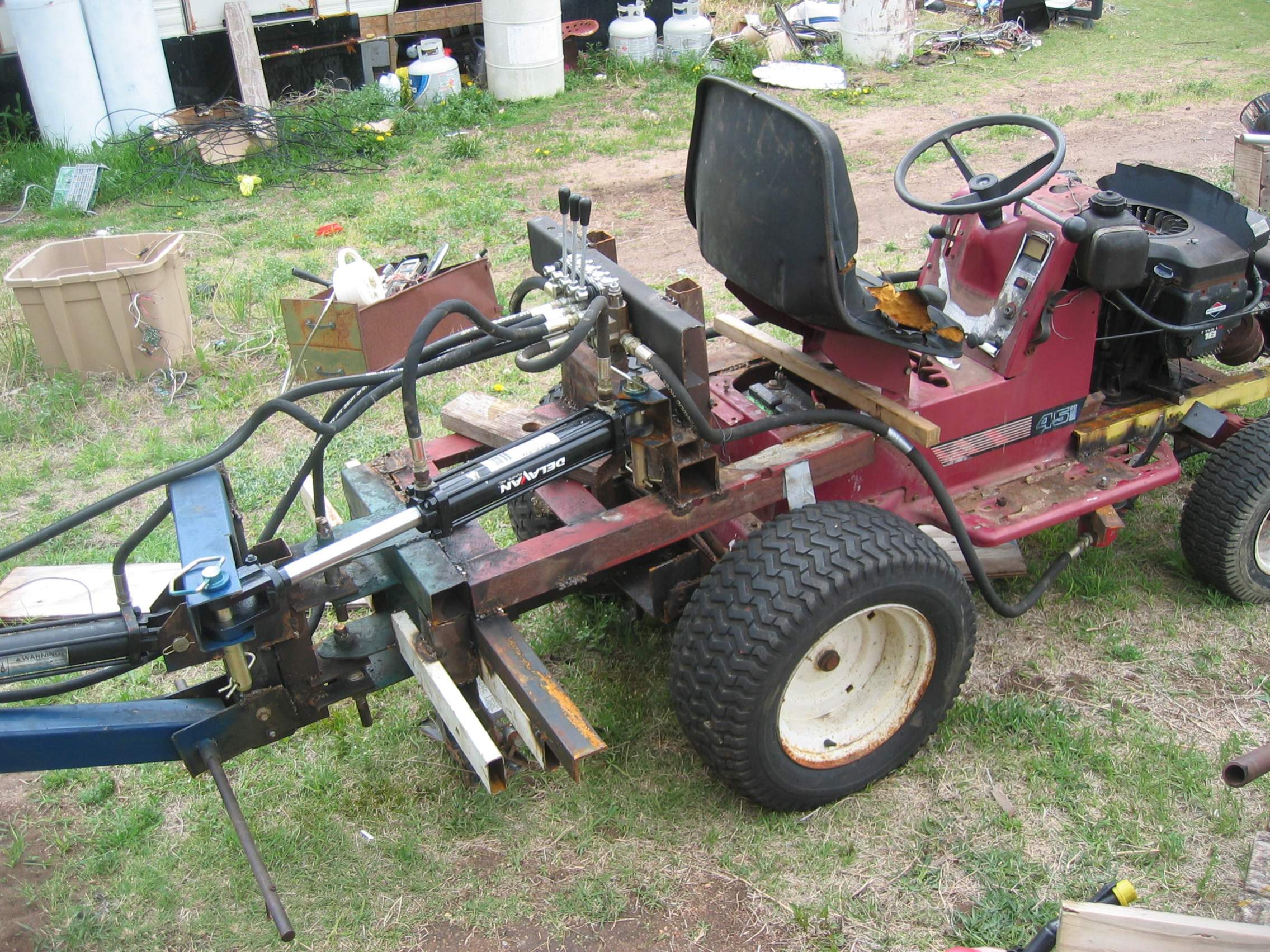

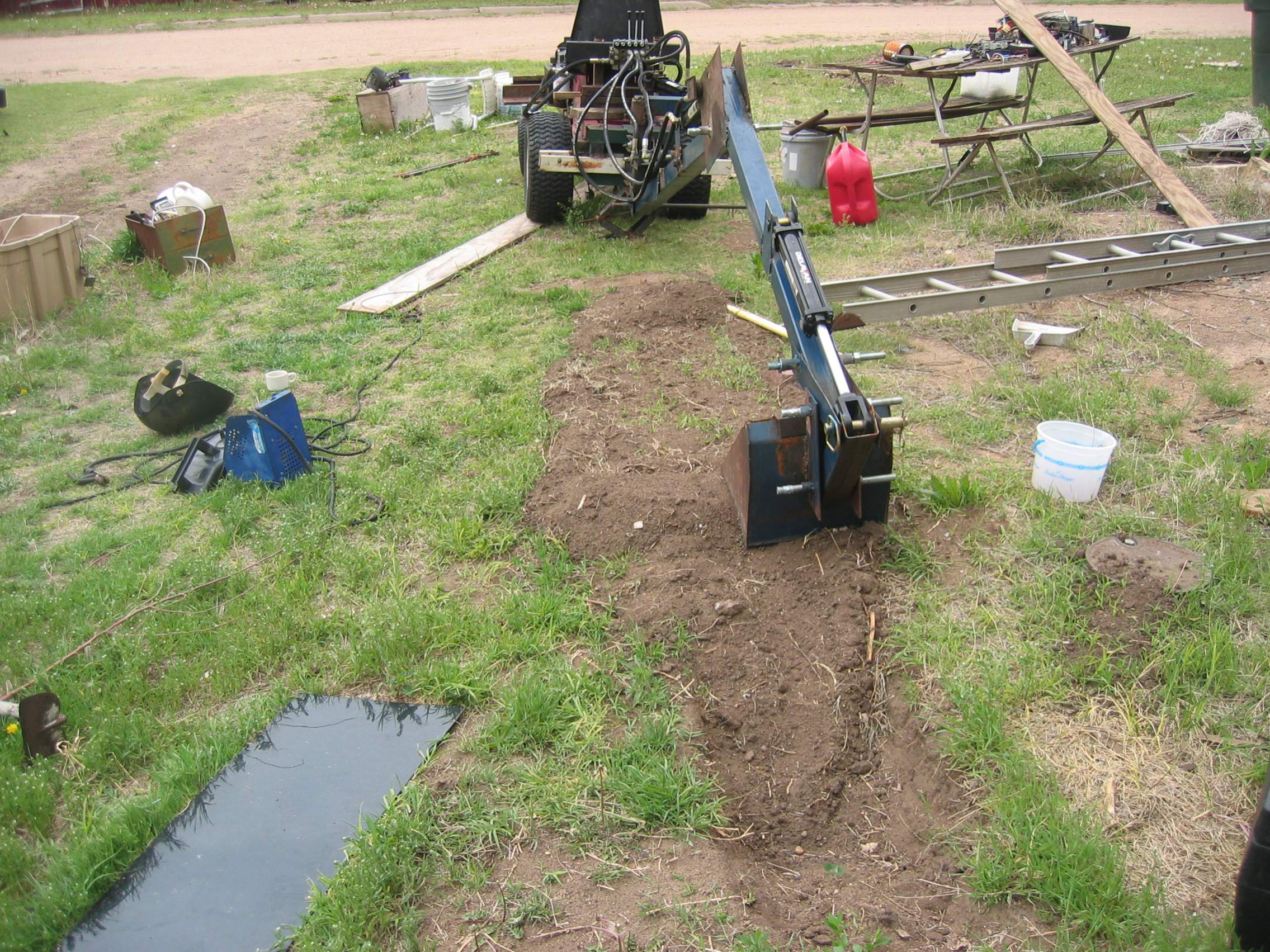

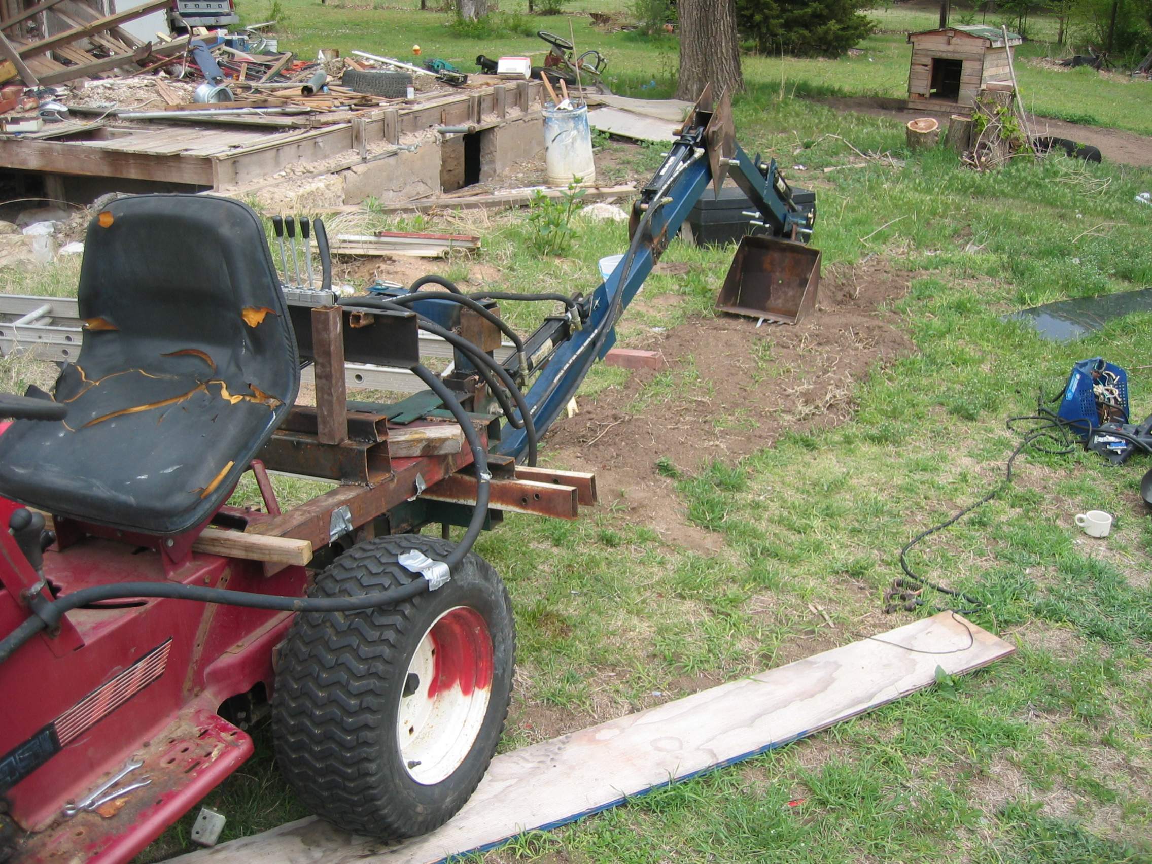

Here are some photos I took today of the backhoe with valve and hoses hooked up. I was able to dig by dragging the bucket, but unable to curl it at the moment until I get the hoses for the bucket cylinders.
I broke some of my temporary teeth off. I'm gonna add some stronger teeth anyway so that's not a big deal.
I thought I would add, a city about 12 miles from here gave us an old fire hydrant with some scrap metal we picked up from them. We were gonna sell it for scrap, but I thought of another idea. We have a puppy who will turn 2 July 5th. I thought I would bury that in his fence for a Birthday Present. :laughing:
Chad

/ Backhoe update. I'm making progress (Video included) #25
I admire your get 'r done attitude and perserverance. You are definately learning things that you will not easily forget.

I just discovered this thread while looking for ideas to help me build a BH for my garden tractor. Chad, your experiences will be a big help for me when I get started. I'm glad to note you plan to keep your hoe mounted on the tractor. Hopefully I will get to see what you do with it in future.
One thing I noticed in your pictures; you don't seem to have stabilizers on your machine. Would having them not have prevented the twisting of the tractor frame you wrote about? I plan to build mine with stabilizers in the back and a dozer blade up front to anchor my machine when in operation

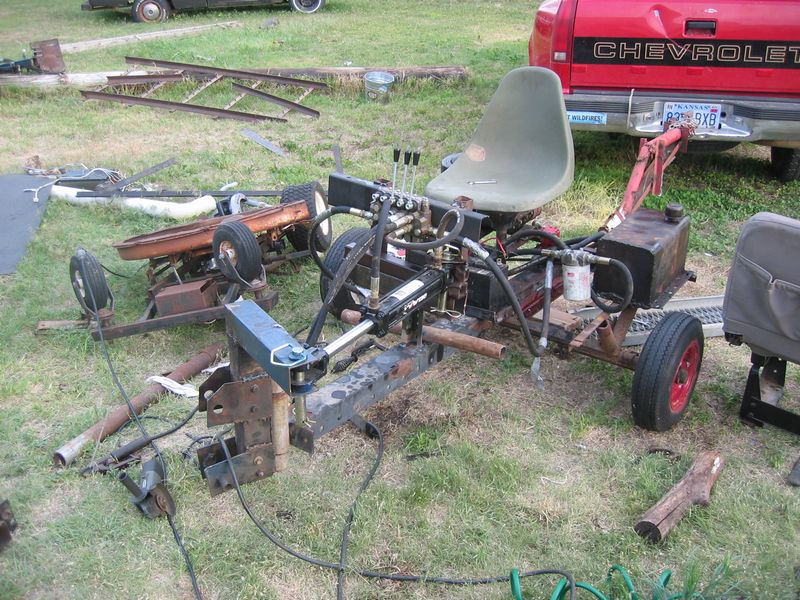

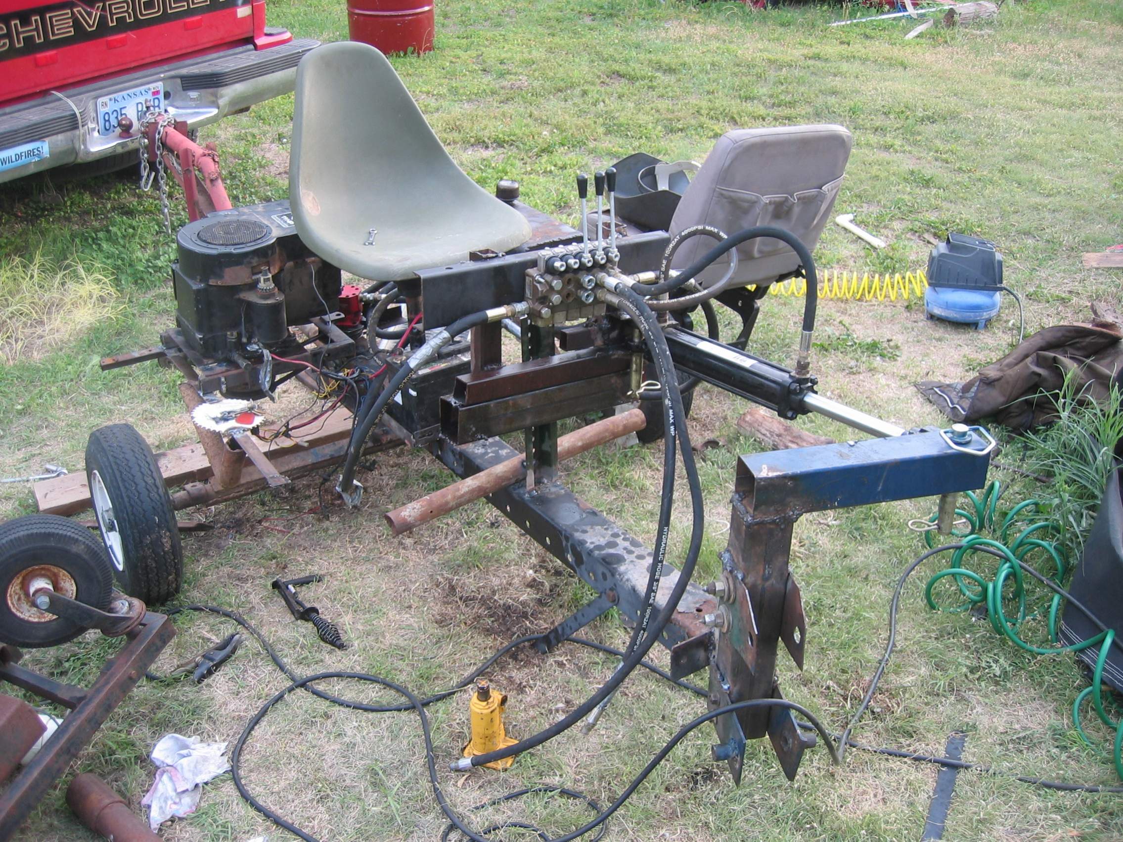

Yep. It's now a towable backhoe. Well almost. I transplanted the battery cables and solenoid to the towable backhoe. I took the engine mount off the old dixon ztr frame and welded it to the back of the towable unit. I then mounted the engine that I had put on the lawn tractor backhoe.
I got the pump mounted, and the hoses almost hooked up.
Bout all I will have to do to get her going is mount the gas tank, throttle cable, mount the boom get all those hoses hooked up and then weld some pipes for stabilizers.
I did almost all this work today. I started around 9:00 AM CT.
This does seem like it's gonna work a lot better. And another good thing, if I need to move it somewhere I won't have to put it on a trailer. I can just hitch up to the truck and go.
Oh and I also redid the pivot for the boom. I used some big pipe and another pipe inside of it. Looks like it's gonna be stronger.
Anyway if it's not raining tomorrow, I'm gonna try to get her done.
Then we can fire her up and go digging.

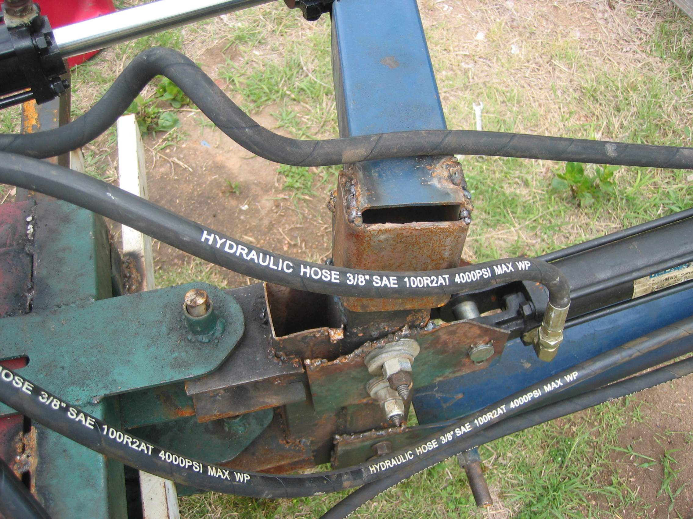

/ Backhoe update. I'm making progress (Video included) #38
I like your towable design alot better ,with the addition of some hydraulic stabilizers you will have a nice solid base to work off.
One thing I noticed is the connection point of the boom pivot to the frame could use alot more reinforcement. That entire length of tube should be welded to the frame with gusset plates and the frame in that area should be built up as well. Keep up the good work and keep us posted.

I was trying to mount the boom, and stick back on using the hydraulics and the hydraulic pump blew a seal at the bottom.
It was a used pump, and I only gave $25.00 for it with shipping on ebay. so I didn't expect it to last to long.
I'm gonna see if I can find a seal kit for it, but if not I'll just get a new pump.
