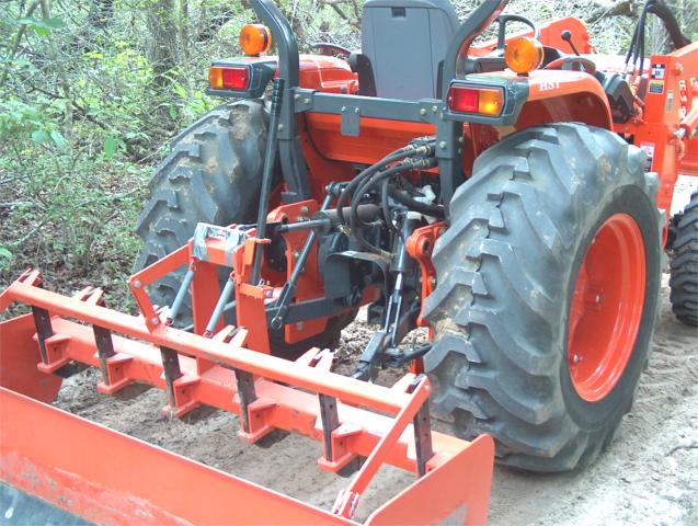

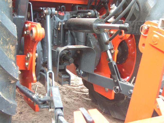

/ Backhoe Pictorial Tutorial - Removing BH90 #24
</font><font color="blue" class="small">( Leroy, The BH frame does not interfere with the 3 point hitch or T&T. See attached photo. )</font>
So I wonder why my dealer told me, and the manual reads, that the 3 point has to be removed, lift arms and leveling arms, for installation of the BH90. I couldn't leave well enough alone and hooked up the BH90 today, without removing the lift arms or anything. I only loosened the stablizers so the arms could float free until I had the BH90 connected.
The only thing I see that could be an issue is the possibility of a stabilizer hose hooking on the end of the lift arms, but that's easy to watch and avoid.
I do believe this is why they cut the frames on the sub-frame and the BH they way they did.
Anyone have any tips on the lift arms when using the BH90 on the back?
Thanks,
Chris
