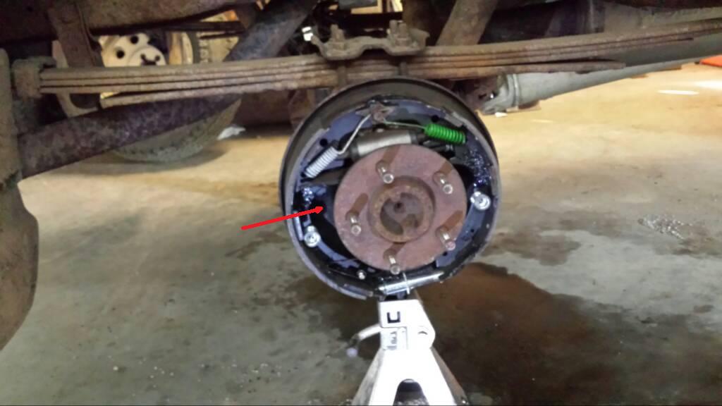

I change the front pads so I decided to put new shoes on the ranger also. Everything is in now the problem I am having now is I can't get the drum on the back wheels now!!! The new shoes are to think it seems and I don't want to start beating it might chip the new shoes. I don't have a E brake because that was a problem last time I changed them so I cut the cable. Do you think it's the new wheel cylinder? Not compressing.

Can you take a picture of one side and post it. Maybe we will see a mistake that you are missing??

Your adjuster on the bottom needs to be turned 90 degrees and moved to the other part of the brake shoe.
/ Back drum help! #15
Yep. Adjuster goes on the vertical framework of the shoe, turn the slots 1/4 turn, not down on the ends of the surface where the pad is attached. This will allow the bottom ends of your shoes to go closer together.
/ Back drum help! #16
Once you get that done, extend the adjuster as far as you can and still get the drum on. This minimizes the painful "notch at a time" adjustment thru the little slot.
/ Back drum help! #17
I looked at the pic and it looks like the E brake lever is engaged (see pic). I know you said you cut the cable but the lever that spreads the shoes looks to be frozen in the engaged position.
As others mentioned, check the adjuster position.
Also, your rear springs are shot. They are arching the wrong direction. May even have a busted leaf in the middle.

Well I moved the star wheel turned it around and I was able to get the drums on. Thank alot! On day I'll buy another truck.
