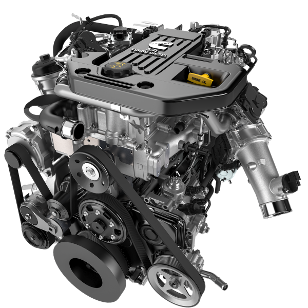

Anyone following the new '25 Rams? I like what I see. Some changes noted.
2025 Ram Cummins 6.7:
The High Output engine is discontinued
CGI block is discontinued and replaced with cast iron (NVH improvements)
3.42 gears only
430 HP and 1,075 ft lbs
New version of the CP4 HPFP
New turbo
Cylinder Head is revised – External injectors easier to service
ZF 8 speed transmission
Grid heater is discontinued and replaced with glow plugs
Oil canister and both fuel filters will be topside
New emissions system
Faster DPF heat (cold start emissions and no intake restrictions)
Dual alternator package is now 400A or 480A, was 380A or 440A
Possibly an entirely new driveline
No difference in cab structure (still a 2010 design)
Other 2025 additions:
14.4" Touchscreen Display (rhz)
Drowsy Driver Detection (xnm)
Traffic Sign Recognition (sjb)
Dual Wireless Charging Pad (cms)
Active Lane Management System (xnw)
Next Generation Engine Controller (nzd)
Pedestrian/cyclist Emergency Braking
2027:
7.2-liter coming for 2027 CARB and EPA emissions
Additional displacement needed for lower cylinder pressures
