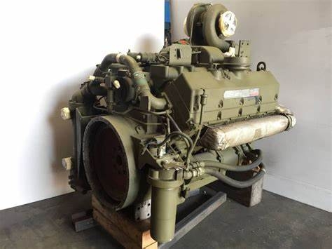

The other great thing about in-line six configurations is they are cheaper to build/buy & maintain.
Inline engines do require a simpler block boring line, with only one row of cylinders.
They get better fuel economy
The examples you know best, might get, but thats not Newtons law. A lot of design factors are involved. Many heavy industrial engines are V configurations.
Their crankshaft is stronger because its supported by more bearings
In a V engine, the same crankpin never gets loaded at the same time by two cylinders. When the left bank cylinder makes compression and power stroke, with maximum piston pressure, the right bank cylinder is making intake and exhaust stroke, where the crank pin only accelerates and decelerates the piston at TDC and BDC.
The spacing between the main bearings usually doesnt differ from an inline configuration (Cummins KTA19 inline 6 and KTA38 V12) they are just staggered the width of a connecting rod bearing...
What matters is if the designers can put enough bearing surface in a given space to get to the required PSI of bearing load.
Cat doesnt seem to have an issue achieving that with the 3516 V16 engine found in their biggest mining equipment..
Since all of us basically run smaller OTR trucks and tractors, why don’t we keep the diesel engines limited to 25-500HP and under 15L in size?
We all know battleships and tugboats and huge mining equipment can have V configuration diesels, but perhaps we keep it to the other 99.5% of the equipment TBN’ers own/operate?
Just keeps the conversation practical and more useful to this group here.
The V-8s and in line six engines on TBN generally run 25-500HP and under 15L in size. Agree????
