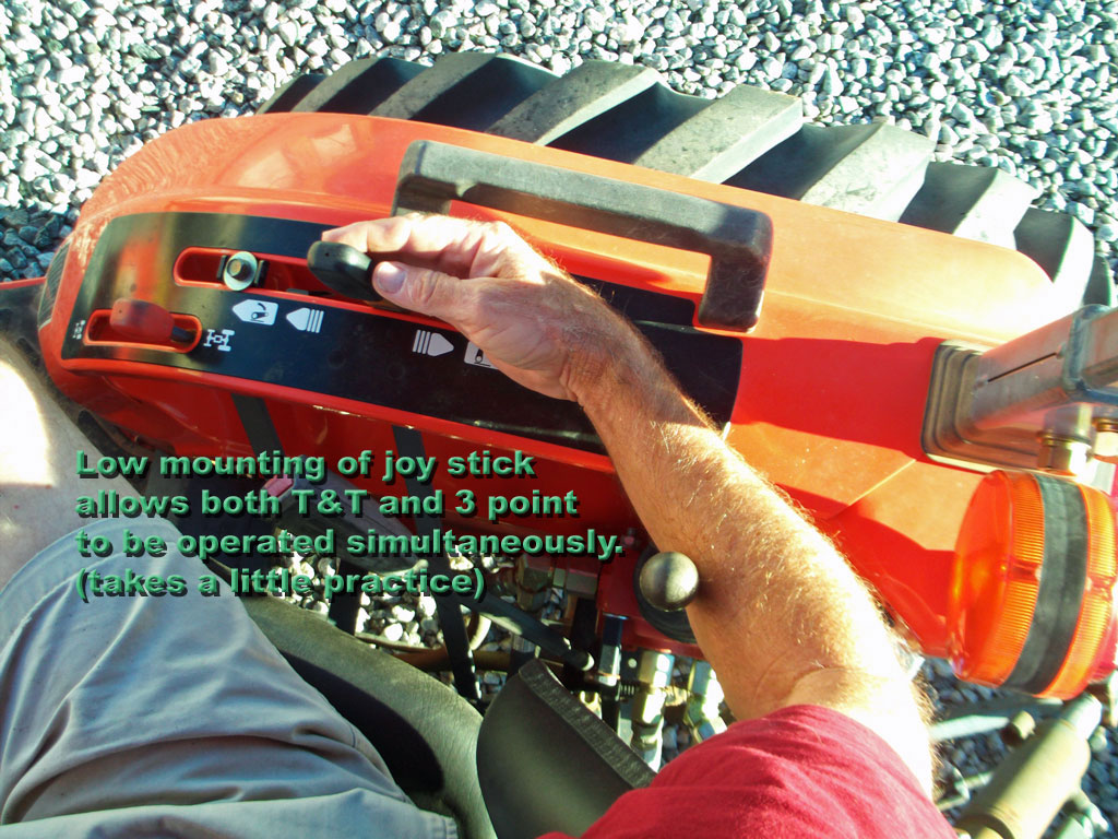

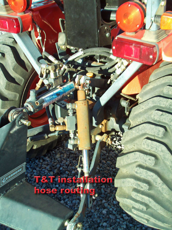

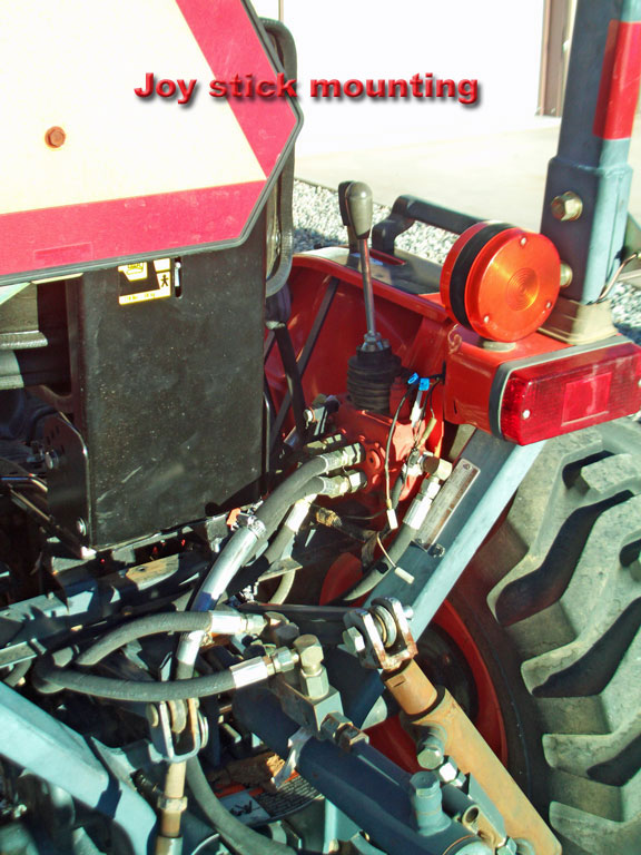

/ B7800 Rear Remote Installation #7
I did the T&T thing about 3 or 4 years ago. It has worked well for me.
