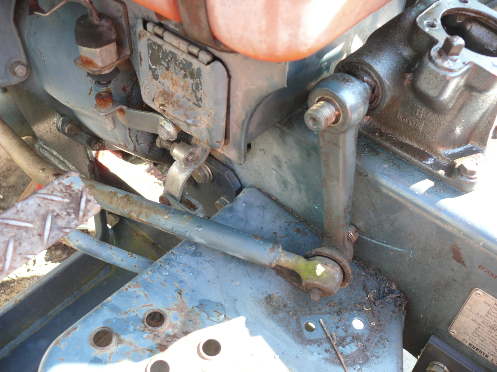

Yep, you got it. So for getting the pitman arm off get or borrow one of these. Make sure the size is correct for the arms to fit behind the round part. Pitman Arm Puller & Tie Rod Puller Attached is a pick of the ball joint you want off. Hit with a heavy hammer where the blue arrow points. You can hit where the red arrow points but you would need to hold something heavier than the hammer against the opposite, like a sledge hammer sized item. I use a 4lb hammer, a few whacks heading towards a solid back piece and they pop right off.

Hey I hit it with a hammer and it popped right off just like you said! Pitman arm puller didnt fit right as you said it might not and I improvised and after using a long handled breaker bar I got it to break loose. It was really in there tight perhaps because of the other problems I found. I am going to try and post pics of the pitman arm which is definately twisted, and the arm knuckle which I cant tell if they are ok or not.
So I am now going to order the tie rod new because its only 19.95 from big orange parts. I found a guy on ebay that has the shaft and thrust bearing for 135.00 brand new he has over 10 of them free shipping. So I will probably get that however he does not have the races and it looks like I need 2 of the same kind of those. as well.
Below is a quote from Big orange parts on items I requested. The shaft is higher price at big orange but it might include the races and seals?? ill find out.
ok gonna try and post pics on another post so I dont lose what i wrote. thanks for all the help...never thought I could even get this far with the repair.
Have you ever taken a knuckle arm off? I was thinking to take it off and see if there is even any lube in there. I guess I would have to have a new gasket if i did get it off right?

Well my jeep broke down and I have not been able to do anything but work on that. I think I will become a plenum plate gasket specialist......any how... the kubota parts i ordered came and of course I need more. The so called complete assembly wasnt that at all. I still have to buy the races....and the pitman arm has been discontinued. I was offered one for 100 bucks used....
The pitman arm has a slight twist at the bottom and I would have liked to replace it so it dosent put unneeded wear on the rest of the steering but i cant pay 100. Heated it up[ to see if I could fix it and it just laughed at me :laughing:
anyway I am going to attempt to take pics as I go so maybe it might help someone else. thanks to all for your help I am sure I will run into problems as I start this....

Finally able to get back on here with update
I have put the steering tie rod and drag link assembly back on. The pitman arm is twisted slightly and I thought I could just flip it around and put the twist in opposite direction however the small hole on the arm seems to be beveled to fit only one way so I will have to use it as is.
New arm not available .... Tried heating and twisting back but no luck

Putting steering rid and gear box back together and now a new problem,,, how do I. Align the gear the pitman arm is attached to and the actual steering shaft worm type gear assembly
I am gonna just try in the center first unless someone has a suggestion
/ b7100 steering box advice needed #34
By guess and by gosh !:thumbsup:
Jack up front so tires turn easily. Center steering wheel. Equal amount of turn either way. Get wheels pointing straight ahead. Place pitman arm on spline.:)
Repeat till you figure it's right.
Make sure the wheel turn limiting bolts are set.:)
