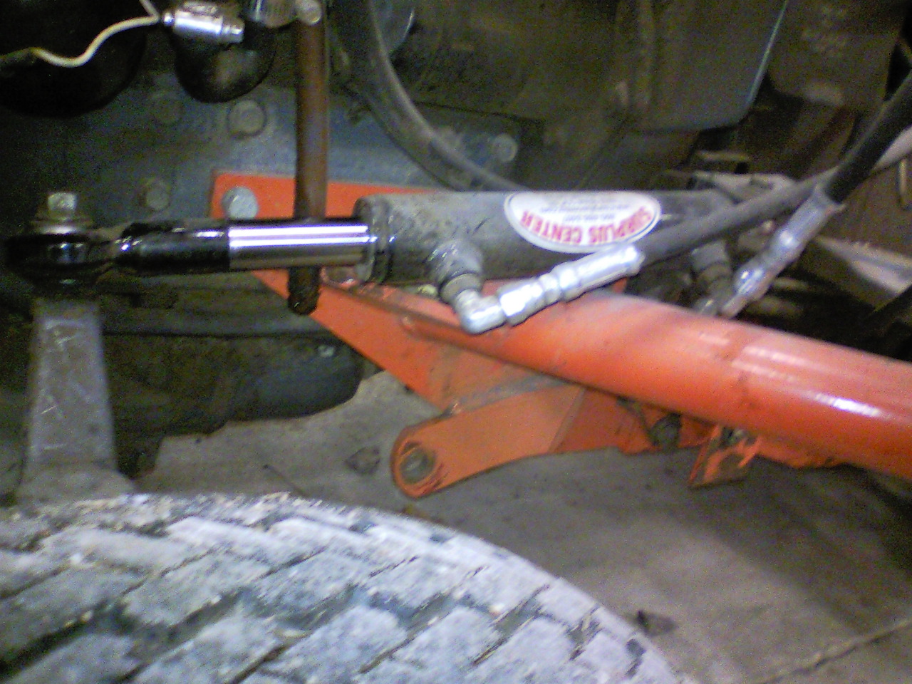

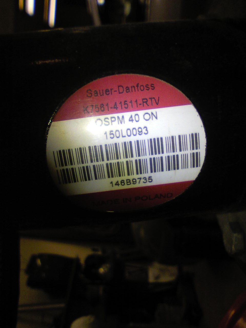

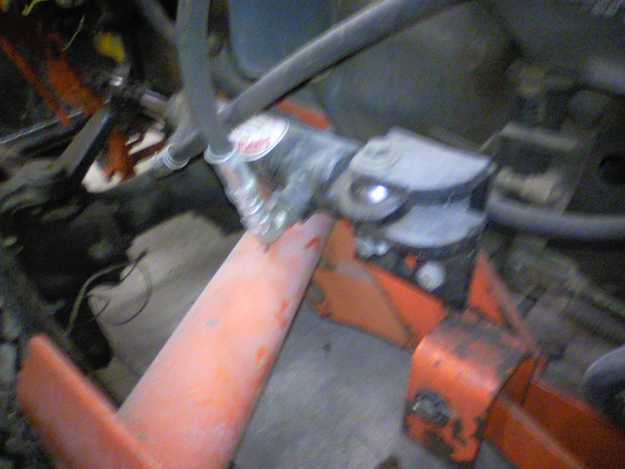

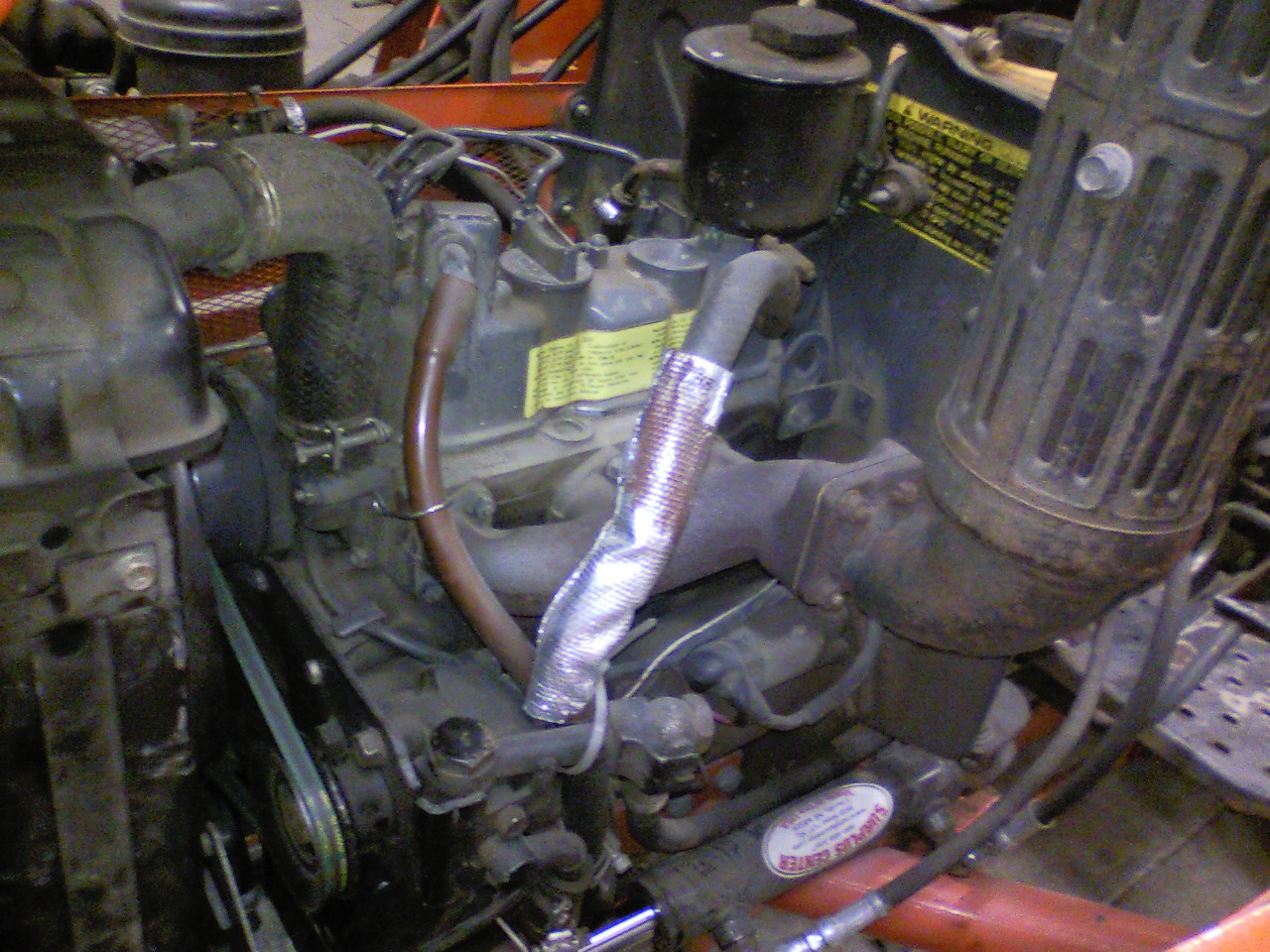

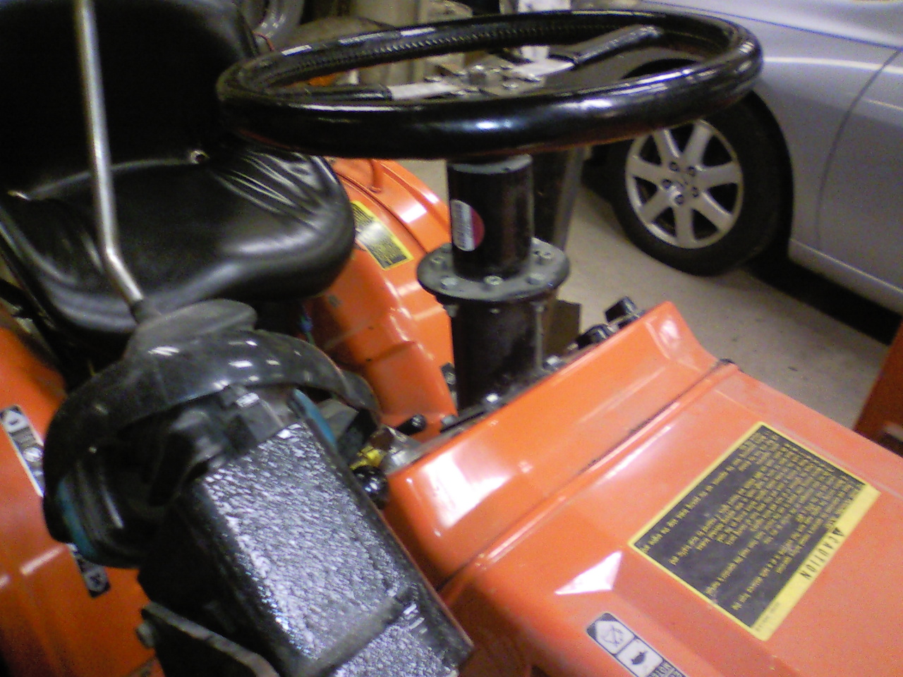

Using the stock steering box with a loader was tough. I too dumped the the steering box for power steering. Now even with a full bucket you can still steer with one finger. The steering column was interesting to make because of the dash. The power steering pump came from a Nissan Maxima. All I had to do was make a mount off the front cover, a new drive pulley and a idler to tension the belt.
Hmm, right now mine runs off the tractors hydraulics which isn't the best way to do it. I've been thinking of using a small foreign car pump but most do not have V-belt pulleys. Did you have to swap the pulley or did you look around until you found a V-belt one? I see on E-bay that older Toyota trucks have a V-belt.

I used a Nissan Maxima pump because of it's size. It used a ribbed belt. I removed the ribbed pulley on the lathe then welded a v pulley onto the hub.
Ah, I guess I could weld a pulley on but I don't have access to a lathe. Good thought though.
