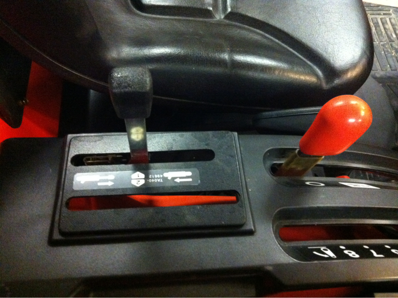

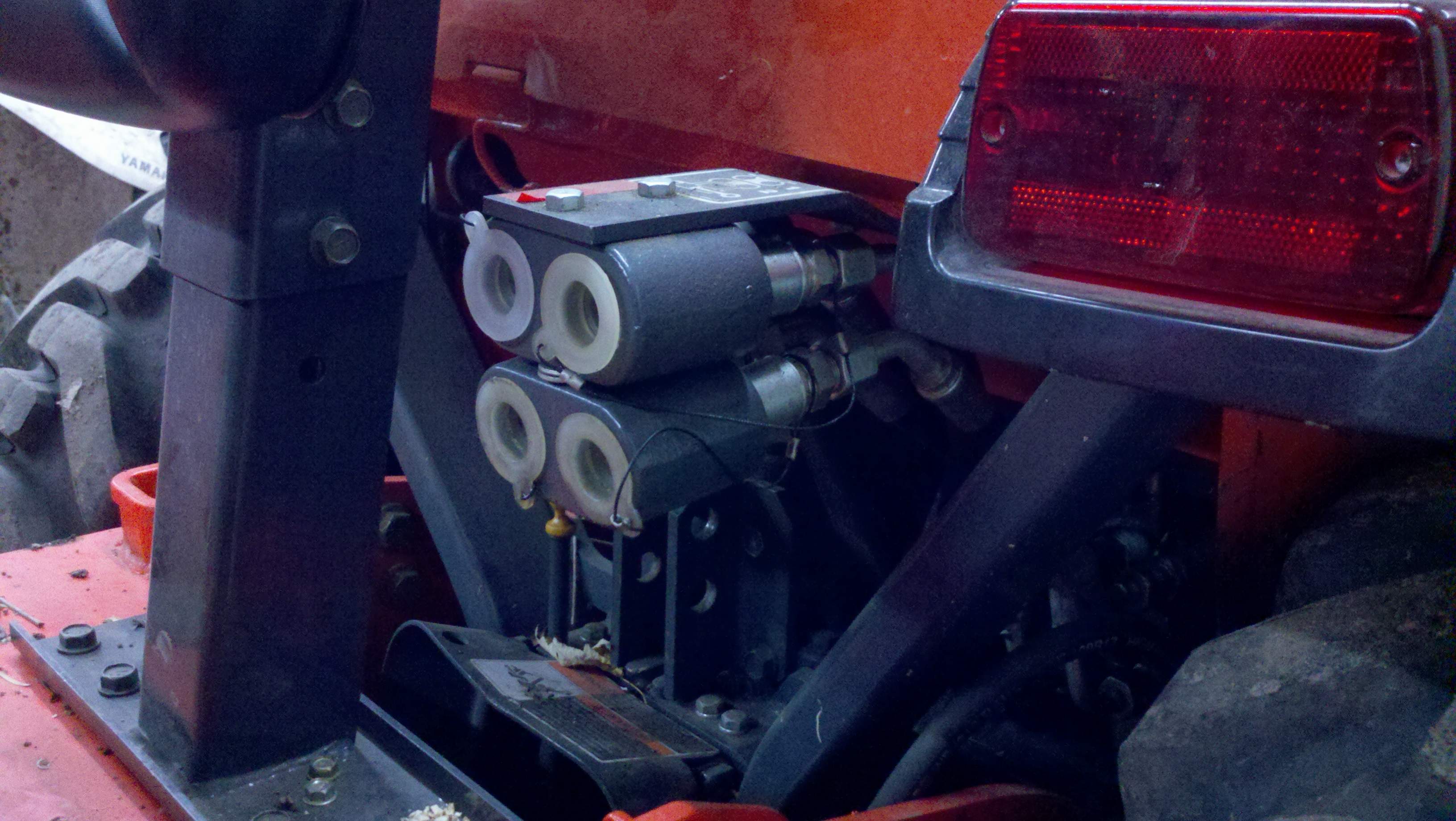

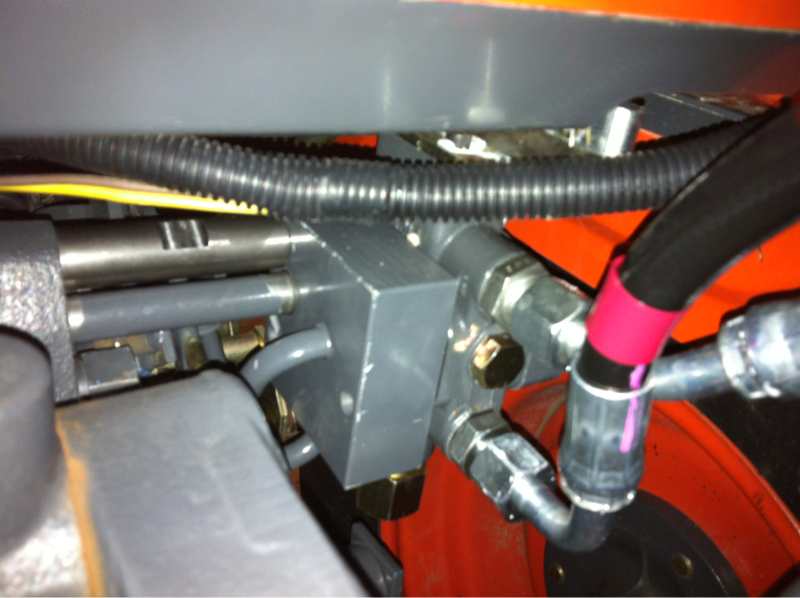

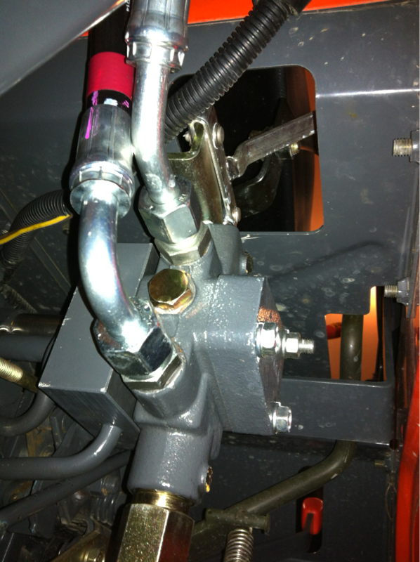

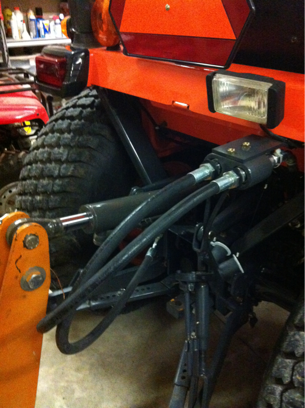

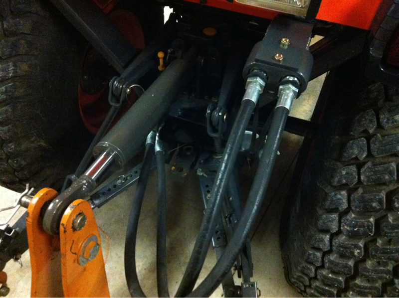

MtnViewRanch - here's the pictures you requested. Let me know if I can help. Thanks!

/ B3030 Rear Remotes #29
psdx, perfect and thank you very much. Lets us all see a Factory Kubota rear remote set up for this size-model of tractor. :thumbsup:
