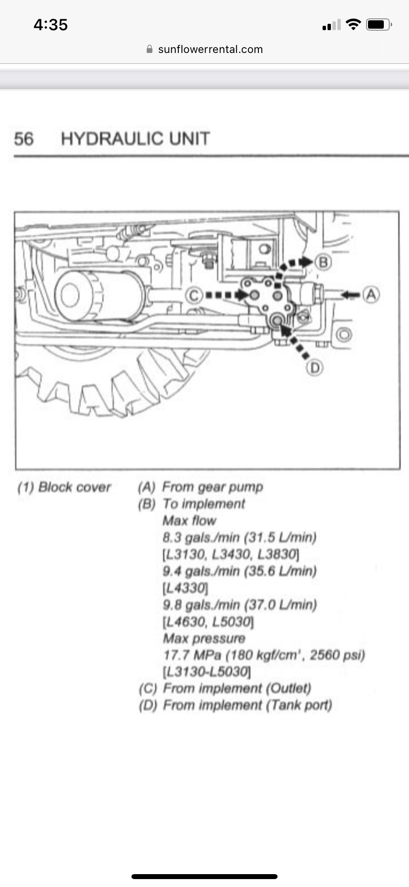

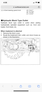

Need to add rear remotes to my Kubota L3130. There is no loader or back hoe on the tractor, and likely never will be.
The two pages of the Operator’s Manual that I have attached below say that I should be able to plug my hoses into the hydro block underneath the right footrest by simply removing the cover. Does anyone here have experience doing this? Seems pretty straightforward. Hence, I am assuming I can attach a monoblock control valve on the fender next to the driver’s seat and run my 3 hydro lines directly to the existing hydro block. Just wanted to
check before I start ordering the necessary parts.

Yes it is straight forward.
Your new control valve needs to be open center and have it’s own pressure relief valve and it needs to have power beyond port with the appropriate sleeve or plug depending on the valve design.

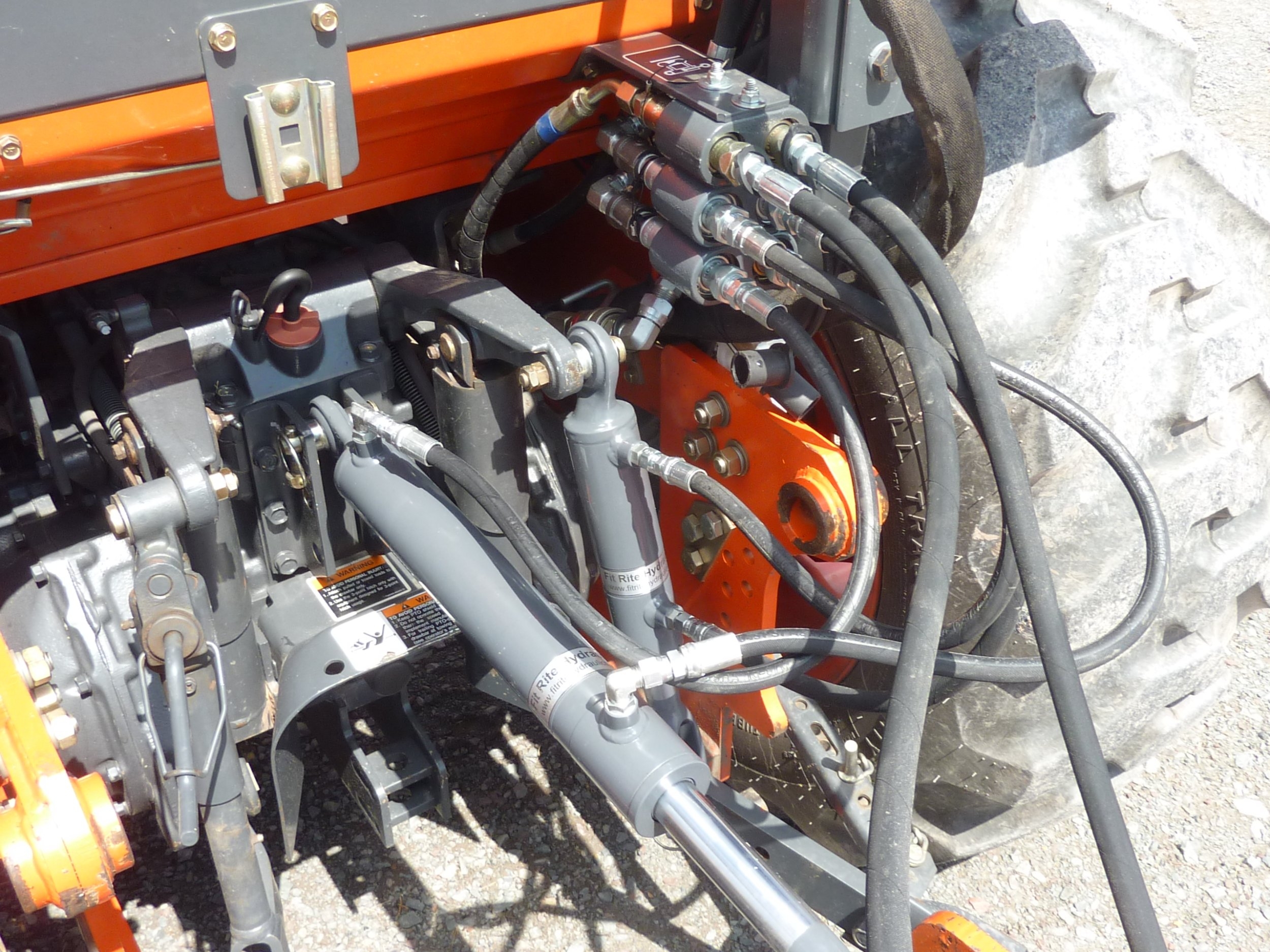

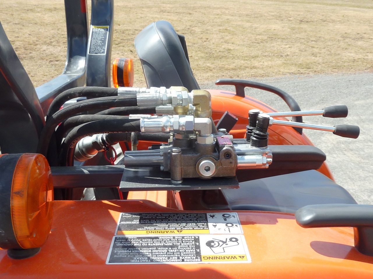

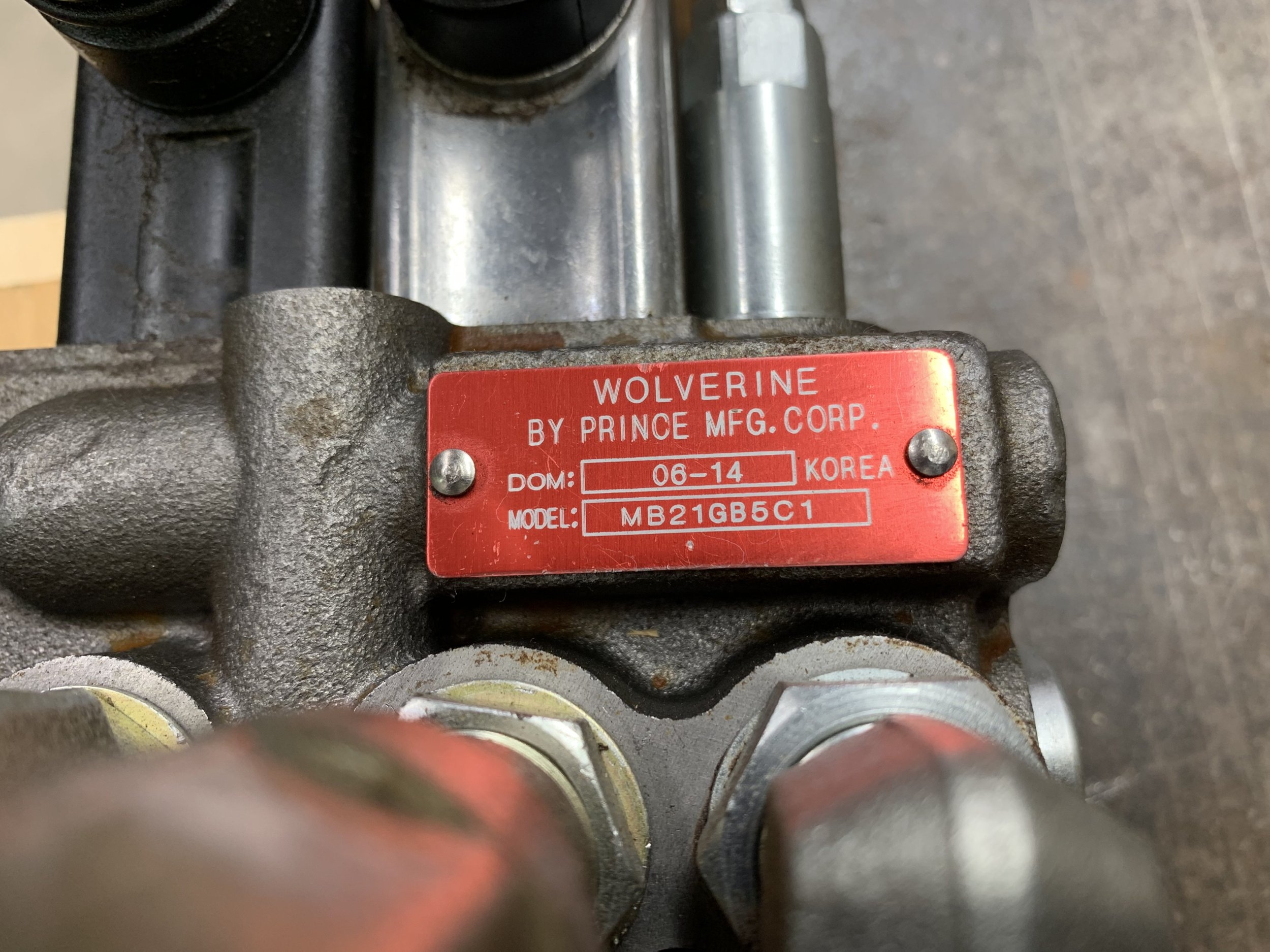

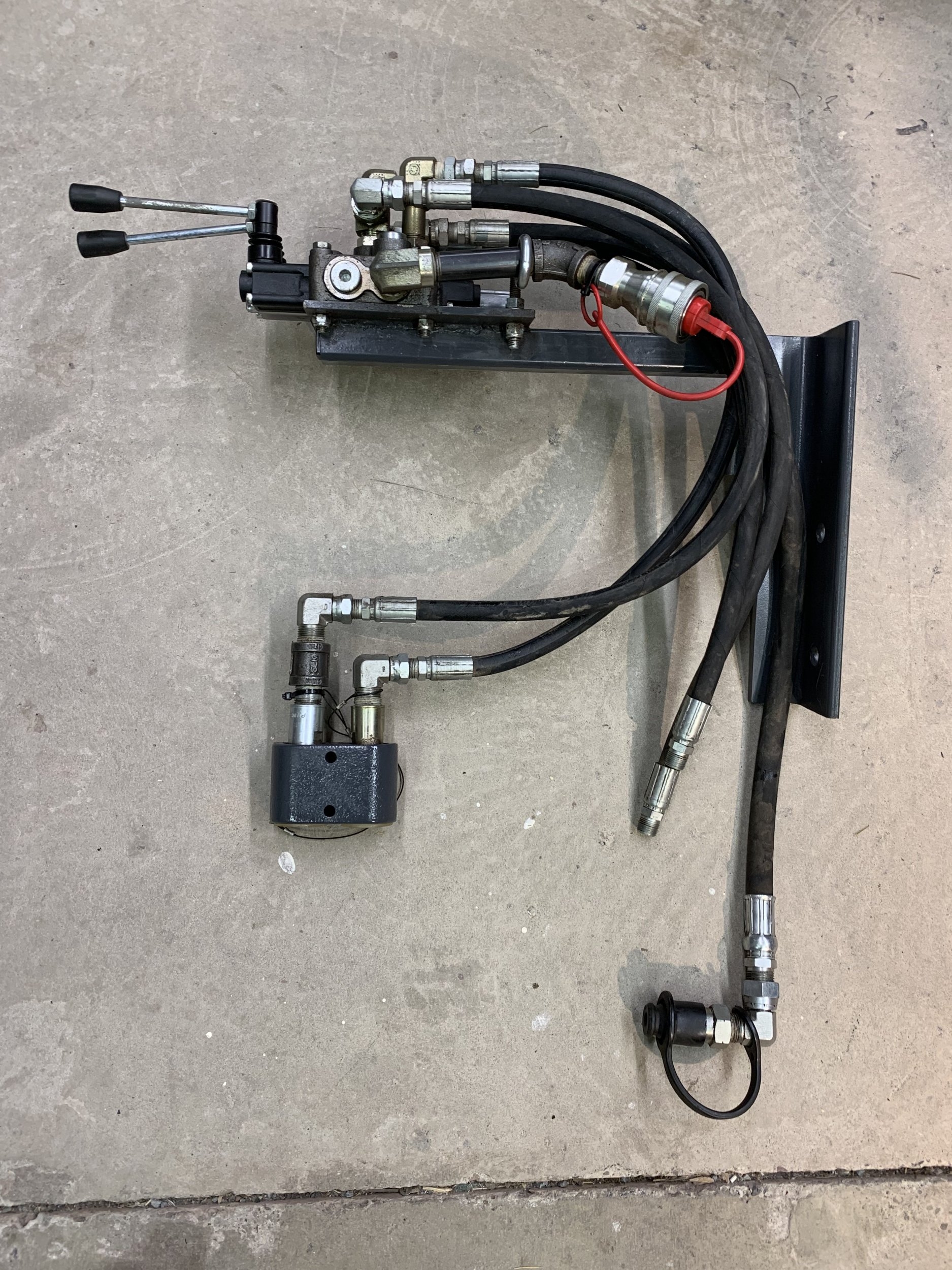

My L3430 was ordered with one rear remote and I added two more for a T&T kit by tapping that hyd. block.
I made a bracket that attaches to the ROPS using existing bolts, no cutting or drilling required. It holds a Prince two spool valve over the right fender:
I added two OEM coupler housings to the stack:
It took around 3 days to fabricate and cost just under $1K

Thanks so much for all the detail, especially the photos. Super clean OEM-style look.
