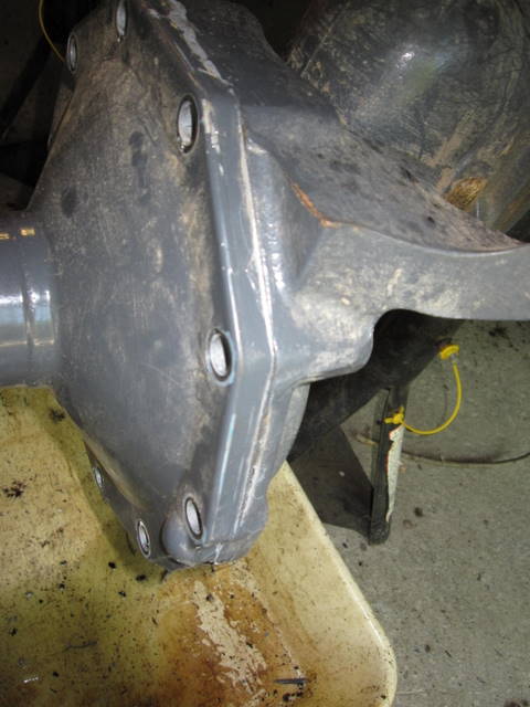

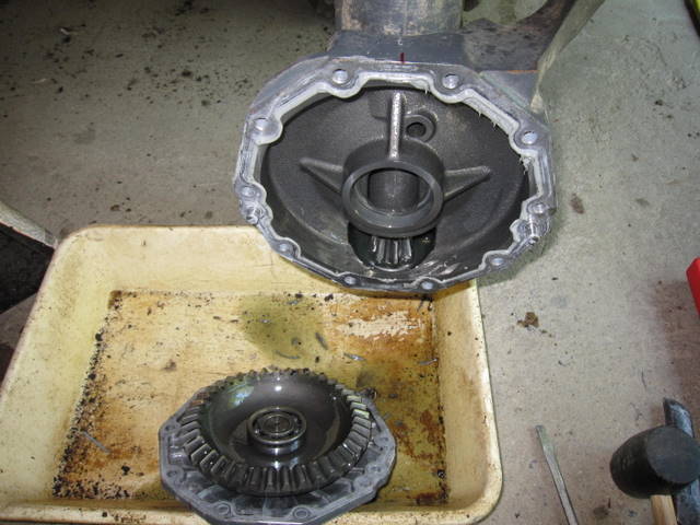

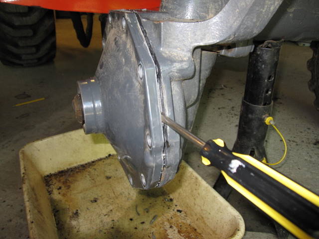

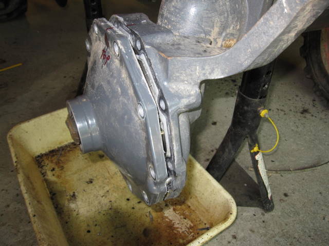

OK. I knew this was going to easily. I didn't notice that there were no stud bolts in the new axle! Now what?

If you have a bench vise do the following.
1. Screw a wheel nut about 6 threads onto the stud so it is almost flush even
with the stud. Make sure you screw the tapered end of the nut on first.
2. Place a large socket over the back side of the stud.
3. Place the hub aseembly into a vise and press the stud into the large socket.
For installation it looks like the stud will fit go in from the back. Just push the stud into the hole enough for the splines to grip then place a large washer over the stud then pull in with a lug nut turned backwards. IF the stud will not fit in from the backside, you can try grinding down a small flat spot on the head of the stud otherwise you are going to have to take it back to the repair shop.
/ B2910 front wheel snapped off! #66
Are they press in studs? If so you might have enough clearance to press them in from the back using a large C-clamp. If so, place the stud in the hole, put the fixed part of the c-clamp against the stud, and a socket over the other side. (so you are pressing it into the socket as you go) Be sure to use a socket deep enough to accept the length of the stud once it's pressed through. You'll need a pretty big clamp and even so it may not have enough force. If that's the case clamp it as tight as you can and give it a little tap with a hammer. Not a lot, just enough to vibrate it a little.
If there isn't enough clearance to perform that operation about your only option is to take it back apart. ;)

The holes on the new axle are threaded. Could I buy some hardened bolts and just bolt on the wheel?
YES... get the correct thread pitch, length and the hardest metric bolt... (you want the hardness, not for shear strength, but in a wheel stud you don't removal of the wheel to damage the exposed threads)...
But you have some on the way so that will take care of it... KennyV
