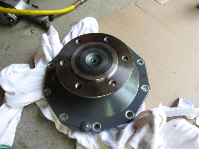

I just lost the left front axle on my B7800 and it looks identical to yours.On my hub the studs are threaded and look like your pic of your new ones but in the parts diagram I have it notes to replace the axle and studs simultaneously. I have my old ones out and they look like new so I think I'll just deprive Kubota of a little piece of my pocket.Was there a noticeable difference in the new versus old axles? If so I think I'll replace both but if not I'll play the waiting game.

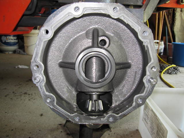

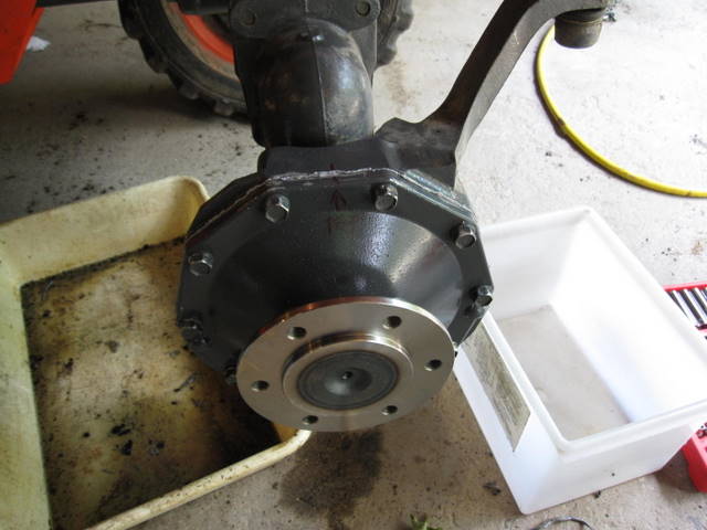

Well in 10 days it will be 3 years since I broke off the RF wheel. Today, I broke off the LF wheel :) Thankfully, I detailed my experience here, because I had completely forgotten what I did to repair the other one. It happened not far from where I broke the first one, way down in the woods. I remembered a suggestion here to lift the axle off the ground with the bucket and chain it to the frame and 3-wheel it out. It worked like a charm! I was back at my garage in 10 minutes.
So, tomorrow, I will take it apart, bring it to the dealer, have them order the needed parts, including new studs, Have them press out the old bearings,etc, install the new ones when the parts arrive, pick it up and re install it .
Let's see if it goes as planned :)

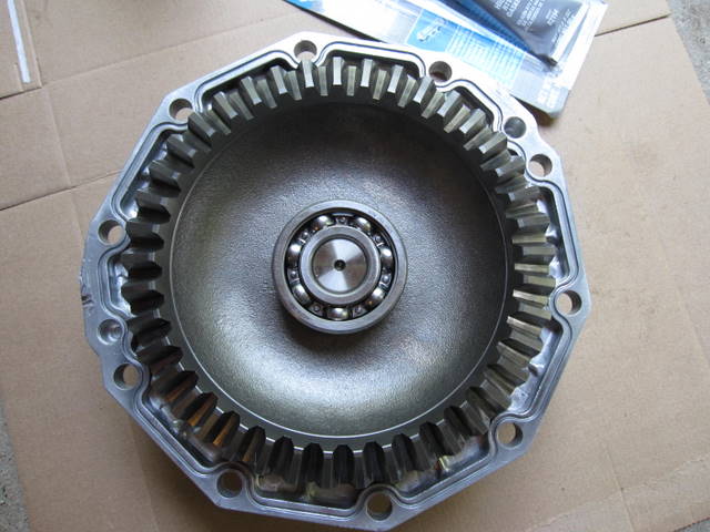

I know what you mean. I brought the bevel gear and case to the dealer to get the parts put in and got to see all of those new shiny Kubotas !!!!!!
I really have no complaints on my B2910, I have asked it to do much more that it is rated for and those axle breaks are the only problem I have had. It now has 1200 hours on it and I hope I can keep it going for another 1000 w/out too much trouble.
I put the axle assembly back on last night and let the RTV gasket maker set up. I'll put the 80w90 oil in today. I am also going to do the 1200 hour maintenance as well and hopefully, be back in business ( is there a fingers-crossed smiley? :) )

Not sure if they still offer the old part number or not, but the updated axle is P/N 32721-57323. It should be stronger than the original which is why they updated them. That P/N I listed is also used on the B26 industrial tractors, so they should hold up without any trouble.
My front loft wheel on my B2910 snapped of while clipping my field. It was a low-stress operation on the tractor. I found that it sheared from the axle on a poorly engineered and executed weld. The axle consists of a flange (to attach to the wheel) and a shaft, welded together and machined afterward to be the finished axle. The weld penetration on the inside was completely machined through, and the weld penetration on the outside was machined back to be less than .050" thickness. There was about .400" of interface with no weld penetration. This .050 of weld is what failed. The replacement axle was similarly fabricated, but at a larger diameter interface, with no obvious indication that the weld on the inside had been machined through. That indicates to me that the manufacturer became aware of this faulty design and took corrective measures for the new part. If this is true, I believe that the factory should have issued a recall and replaced them all for free. This could potentially be a very dangerous situation.
