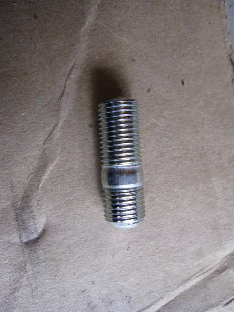

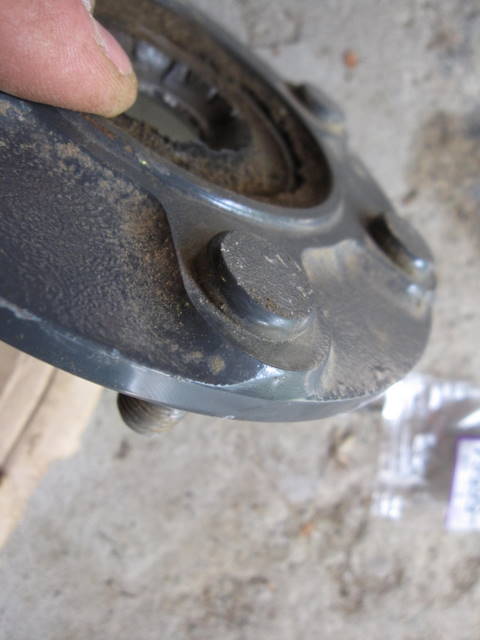

Kubota re-designed the axle hub. The old studs were pressed on, the new ones screw in.

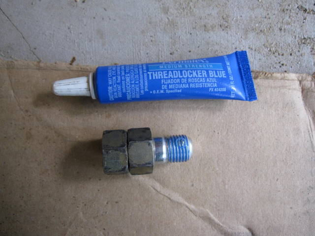

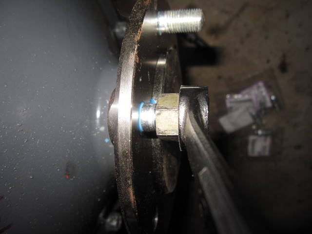

When I do get the new studs, how do I put them on? Do I take 2 of the nuts and screw them all the way on the stud and then screw the stud in to the hub and crank down on the 2 nuts?
/ B2910 front wheel snapped off! #85
That sounds about right. The stud should have a long and a short treaded end, the short threaded end should go into the hub. You might want to put some locktite on the threads that go into the hub, it will keep the stud from coming out if you have to remove a wheel.

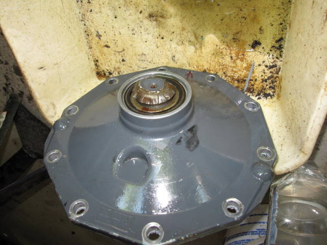

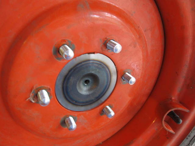

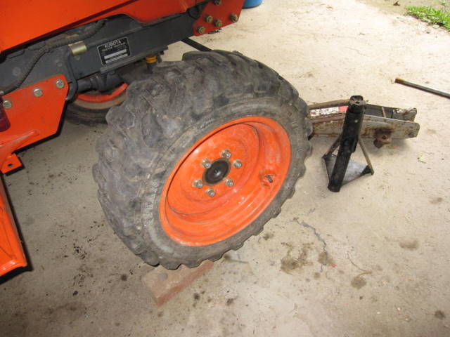

Back in business!
The first pict is one of the new studs. #2 is the old, pressed on stud. #3 Stud ready to go on with loc-tite. #4 Double nuts and wrench to tighten new stud. #5 All studs in. #6 Wheel in place. #7 Finished!

I just had my front right wheel snap off my 2910. Looks like the crack was there for some time and finally failed completely. In hindesight I think it may have shown in the hub surface seen in the middle of the wheel rim. I will monitor the other side or may take it apart and have it mag particled checked.
It really is an easy task. Drain the axle and remove the outside cover with bearings and gear. I supported the gear on 1/4 steel angles and used an air hammer with a brass tip and pushed the stub axle out of the inner bearing. No damage. real easy. I removed the inner bearing and then the shim. Reassembled with the new hub. Hub cost about 180 plus tax plus new seal.

My front loft wheel on my B2910 snapped of while clipping my field. It was a low-stress operation on the tractor. I found that it sheared from the axle on a poorly engineered and executed weld. The axle consists of a flange (to attach to the wheel) and a shaft, welded together and machined afterward to be the finished axle. The weld penetration on the inside was completely machined through, and the weld penetration on the outside was machined back to be less than .050" thickness. There was about .400" of interface with no weld penetration. This .050 of weld is what failed. The replacement axle was similarly fabricated, but at a larger diameter interface, with no obvious indication that the weld on the inside had been machined through. That indicates to me that the manufacturer became aware of this faulty design and took corrective measures for the new part. If this is true, I believe that the factory should have issued a recall and replaced them all for free. This could potentially be a very dangerous situation.
