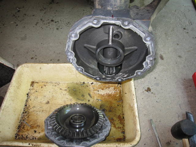

I have gotten the nuts off of the gear case cover but I can't budge it. It is sealed with some sort of sealant. I have tried to get a screw driver in there with no luck and I am affraid to hit it too hard. Anyone have some advice on getting this cover off?
Thanks
I got it... I found a slot to get a screwdriver in and was able to pry it off.
