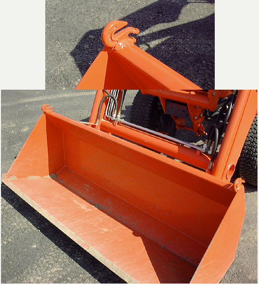

Hi Glen,
According to my dealer the "light duty" wording applied to the 60" bucket is a carry over from another Kubota loader. It's a larger loader used on a larger tractor and in that application the 60" bucket is "light duty" compared to the "heavy duty" bucket that comes standard with that loader. This was an issue for me when I was deciding which bucket to go with and my dealer researched this question before I bought. It was also his suggestion to go with the 60" because the price increase was very small, increased volume, width to cover tracks and identical constuction to the 54".
And again, I owned both buckets and can assure everyone that the construction and material thicknesses are identical. Kubota would be dong themselves and everyone else a favor if they'd edit this wording out of the B series literature. /w3tcompact/icons/smile.gif
Oh, and one other thing. The 60" bucket is not just 6" wider, it's also higher and deeper.
Dave

Dave, thanks for clarifying. However, further deep thinking on this subject (aka daydreaming at work) convinces me that the 54" is best for me. It covers tracks, is at least slightly more heavily built, is more maneuverable in the woods and garage, is better for digging, and is more aesthetically proportionate to the rest of the tractor. The only advantage I see to the wide bucket is if you are constanltly carrying small bales, manure or mulch. Nor do I see any advantage for me in the snow, because the bucket's snow role is subsidiary to the 72" backblade.

I think Kubota's "light duty" nomenclature is really misleading. I've shown no mercy whatsoever in using my 60" bucket and it's holding up just fine. I've got lifting hooks welded on with no reinforcement, I've bullied out tree stumps that stand taller than I do, and carried around every kind of material imaginable. The bucket is NOT just for snow and mulch.
I would get the 60" bucket (oh yea, I did get it) without hesitation.
/ B2910 FEL Bucket Width #26
If anyone needed a heavier 60" bucket, be aware that the pin size and spacing is the same between the LA402 and LA481/2 front loaders - this means a 60" HD bucket from an LA482 would fit. Just a thought....
