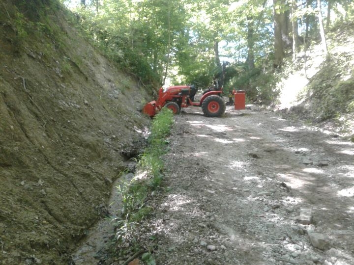

b2650 almost rolled need front wheel spacers
   / b2650 almost rolled need front wheel spacers #41
alexinPA, the difference is traction. You are running the tyres backwards so they clog up and don't self clean.
   / b2650 almost rolled need front wheel spacers #42
I contacted Bro-tek, they are going to do a custom set of spacers for me on a tractor they do not have listed. I am going to do the fronts as well, just to keep the tires in line.

can you swap sides with the rear wheels to gain extra width? or does it already come in the widest configuration? I did this once on a mahindra to lessen the overall width to get down some narrow grape rows. Took some getting used to

Most instances of tractors tipping has to do with inertia rather than balance only/
SLOW DOWN!
It could save your life!
I've been on three wheels to many times, (I have a very hilly piece of earth called home) but at the speeds I prefer, there is still time to put the bucket on the ground!

Ensure your front and rear wheels are installed so they extend the tires outwards the furthest, with or without spacers. Most tractor rims are reversible.
I had 4" rear spacers installed before I dared to hog my hills. I bought them from Motorsport Tech in Reno, Nevada, fabricated of aircraft aluminum, and both were anodized black. I also spray painted them Kioti Charcoal Gray to further prevent possible corrosion from possible future dissimilar metal contact - bolts, nuts, washers, axle ends and rims. Checking their website just now I see BORA spacers advertised (they sound like mine), but I think in 2013 they custom shaped them from solid pieces of aluminum because no BORA logo (they had a bolt hole template for my Kioti DK 40SE already). Motorsport Tech provided quality bolts and nuts. A minor snag was despite the template the holes in the spacers for the bolts were just a tiny bit too small to pass them through. Fortunately a machine shop is close by and they carefully drilled out the holes for a perfect bolt pass though. I painted after the holes were enlarged to get a thin coat of paint into the holes - the boring had removed the anodizing inside the holes.
Loaded rear wheels. Mine were loaded at purchase with Rimguard like Robert's. If you plan on getting spacers and haven't loaded your rear wheels yet put the spacers on first. I couldn't handle removing and reinstalling 700 pound loaded rear tires so I had my dealership do it with their block and tackle equipment.
To the OP's question...I considered also adding front wheel spacers. As many have said front wheel spacers may do little to prevent a rollover because the axle design may allow for it to tilt, causing the center of gravity of the tractor's chassis (heavy engine) to move sideways in the wrong direction. I read that spacers (rear or front) also increase the downward bending force exerted on the axles. For the beefy rear axle it's a non-issue, but for the front it sounded risky. My front axles are already wide (less width than rear stock wheels), and they are full of oil so sealed, and with gearing inside. I didn't want to mess up designed geometry and increase center of front axle downward forces already being exerted.
In the good news category the roll over angle is surprisingly steeper than I thought. For a static situation where the tractor isn't moving and on level ground...with the help of a friend who loves trigonometry we played around with various rollover/point of no return heights for different vertical centers of gravity. Biggest variable is the FEL height and what you might have in it. With a heavy load in the FEL the CG moves forward and that is why one, or both, of the rear wheels will raise off the ground first (which can result in a rapid rollover WITH tractor chassis rotation around a front wheel - ungood!). Side horizontal CG we left the same at 36 inches - tractor's front to back centerline. Here are our theoretical results with my 4" spacers.
Disclaimer - I am not an engineer and these should be seen, as a movie pirate captain once said, "More like guidelines!". But not even that - just some math showing static rollover angles are pretty dang steep with low vertical CG's. Every potential rollover scenario will have its own variables.
Also...I have no experience about when an increasing side load on the "downhill" side's tires might break a wheel rim seal, suddenly resulting in air/fluid loss and a likely increasing of the tractor's side angle, both in the ungood category. I would think jacking a tractor up on one side and getting near 40 degrees would risk it. No way am I going to intentionally allow for a side angle more than 30 degrees. When I've gotten over 20 degrees the risk of the tractor sliding sideways on loose dirt or wet grass exists.
"The static sideways rollover angle for the Kioti DK40 Hydro FWD, with FEL positioned with an empty bucket parallel to the ground, and Tartar 6’ bush hog, 4” spacers and loaded rear tires is probably above 40 degrees. There are no markings to let an operator know where the vertical CG actually is so...best guess for any given situation. I pasted this in from another document.
"Center of Gravity dynamically varies when the rear implement and the FEL are attached. Here are a number of predicted static rollover angles based on a range of vertical height CG’s.

Adding 3” rear wheel extensions and fluid ballast in rear tires of our B26 made a world of difference in stability and traction on our hillside farm.
