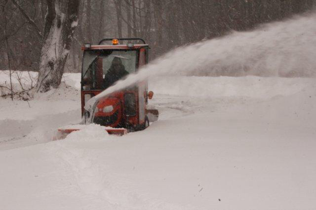

The 2750D is an awesome snowblower. This will be my fifth winter with it. You can see it work here and here. I'm not sure the extra inch in width is worth $900.
The cons - The hand crank is a PITA, at least, on my BX25. It attaches to the joystick and I found that as I turned it, if I wasn't careful I would be raising and lowering the blower. I ended up holding the joystick steady with my left hand as I turned the crank with my right. This might not be such a major problem depending on your blowing situation but my layout required lots of adjustment. I ended up adding a hydraulic rotator.
Another problem, again, depending on your situation, are the skids. I blow exclusively on gravel and the skids were too small if the ground wasn't frozen and wouldn't stay in place if it was; they would allow the blower to pick up lots of rocks. I sheared 6 bolts the first winter. So I made larger skids that actually go under the cutting edge. This keeps the cutting edge 5/8" off the ground and now I might shear one bolt a year. You can see the rotator and skids in my tractor galley.
I thought I would need a ballast box full of weight but this made the front end light which hampered steering, so now I have no weight on the rear. I do use chains but only because of a hill I blow. Hope this helps.

I have a BX2750D on my 2008 B2320. The blower is pretty heavy duty, but there are some signs of strain from small rocks and ice chunks going through the blower. I clear about a dozen driveways each time is snows. It is my understanding that the 51" blower is very heavy duty. I can't imagine trying to operate a rear blower after having a front mount. I find the manual chute rotation to be easy and efficient to use. Don't by the Kubota deflector, you can build one for less that a $100 with a cylinder from Surplus Center. The deflector is the best improvement that I have made to my blower. No longer a need to stop the PTO and get off to adjust.

Here is my b2920 with 51" industrial blower.
http://youtu.be/BBf8zeEyJ2E
As you can see I do get very close to the black car with no issues.
Only broke 1 auger shear bolt over 5 winters of doing up to 35 residential drives per snow fall.
Never bogged down the engine with 51" blower and switched to 63" front blower with no power issues
