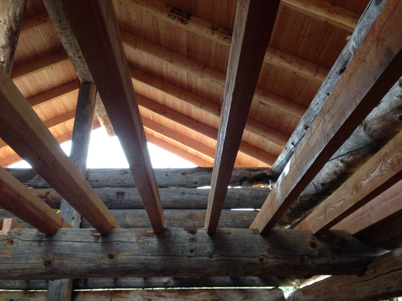

My house flooring is 3/4 plywood on 16” OC joists and then 2x6 on top of the plywood.

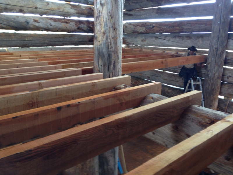

Update. I have about 2/3 of the floor done. Well, not completely done. I still need to go back and put in a lot of screws, but I am making progress.
I ran out of lumber, so I will have to wait a week or so to finish. I have been buying it in increments so it is not laying around long enough to warp and twist.

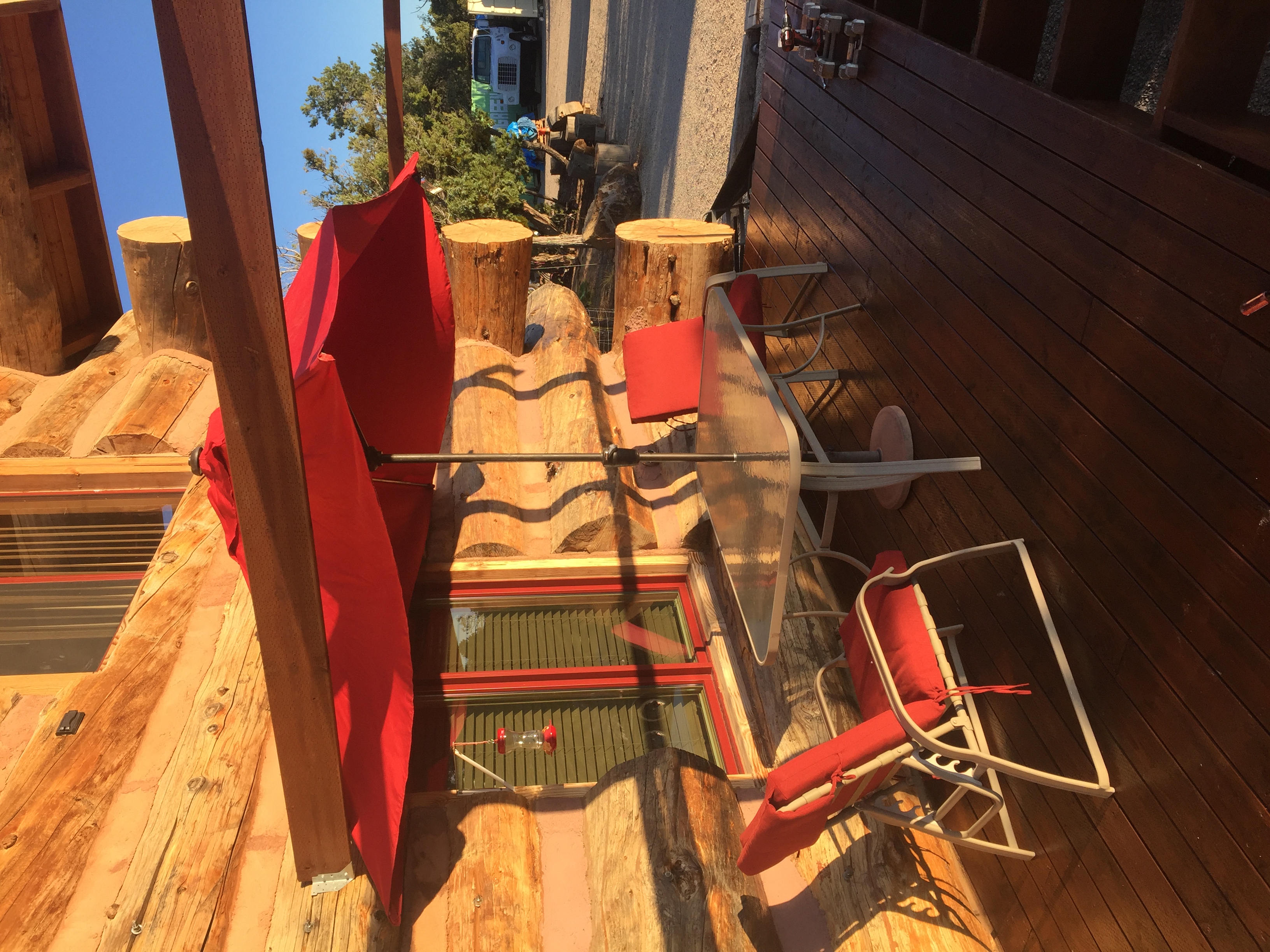

Still have not finished, but my better half could not wait, so we had our breakfast out here.
