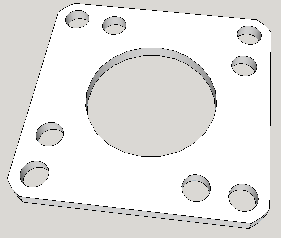

On a good note I think I figured out how to do what I need. I am going to make/find/buy a 6x3/16" steel circle. The bolt holes for both the 4x130 and 4x4 will be drilled, offset from each other. and the center bored out 2.5" for the bearing hub. I will use bolts/nuts to bolt the plate to the wheels, and use the studs and lug nuts for the 4x4 hubs to bolt it to the hub.
Not 100% sure how I will do this, but I have ideas. A local steel shop gave me the idea, because they had square plates made similar, but after talking to them I found out they were done CNC and it would be a $100 fee just for setup, soooo I will have to do it manually, somehow.

OK found a seller on Ebay that sells 6" circles, but his are 1/4" (stronger is better) that they advertise cutting any size shape holes you want. Price for the plate is $10 plus 5 shipping, so I will see how much the hole cutting work is. If reasonable this might be my way out. If not I can order the plates, and do my own cutting.
Then I can order some hubs and spindles and get this show on the road.

If that doesn't pan out, you could use 4-1/2" flat bar, too. Just have to knock the corners off. 18" of it might be cheaper to get than disks.
You might even be able to get away with using 4", but the 130mm circle would be right out at the corners, so you'd have to weld the bolts on, and there isn't a lot of room for the 4-on-4 circle and still be able to get a wrench on a nut. I'd only be tempted by that if I had the 4" bar on hand, I think.

OK I heard back from the folks at Sirius Steel off Ebay. Still working out details, but it looks like $61.50 for the pair. That would look similar your drawing, except it is a 6" diam round plate, .250" thick and the 4 hole sets will be offset from each other, with more than enough steel to hold everything.
I just ordered the hub and spindle sets from Amazon Amazon.com: Pair of 4-Bolt On 4 Inch Hub Assembly - Includes (2) 1 Inch Straight Spindles & Bearings: Automotive for $75 shipped. So that is set.
Making progress. I will have to wait and see how the details on the plates work out. One thing I thought of, was the hub bolts will ALMOST fit inside the wheel opening. I think it would require about a half circle for each lug bolt to clear. Would it hold up to just put heavy washers over the side opposite the hub, against the wheel, then lug nut it? It would not shift up or down since there is no where to go, and since it's not a drive wheel, it shouldn't spin inside the wheel either. Is that a dumb idea? Why?
Also, if I do go the plate route, if I get 1/2 (.500") diameter holes in it for the hub studs, the studs will pass through, correct? I never measured wheel holes, but my 1/2" bolts all measure .490" diameter. Does that sound right?
