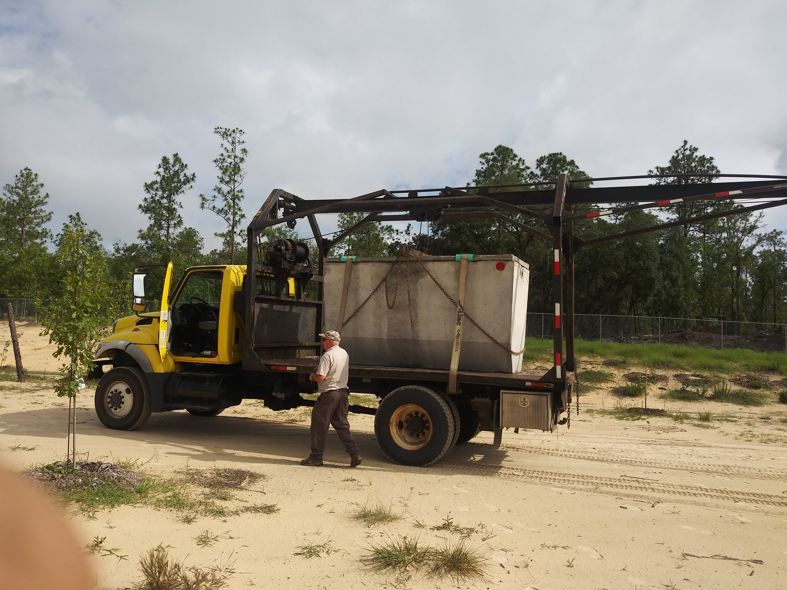

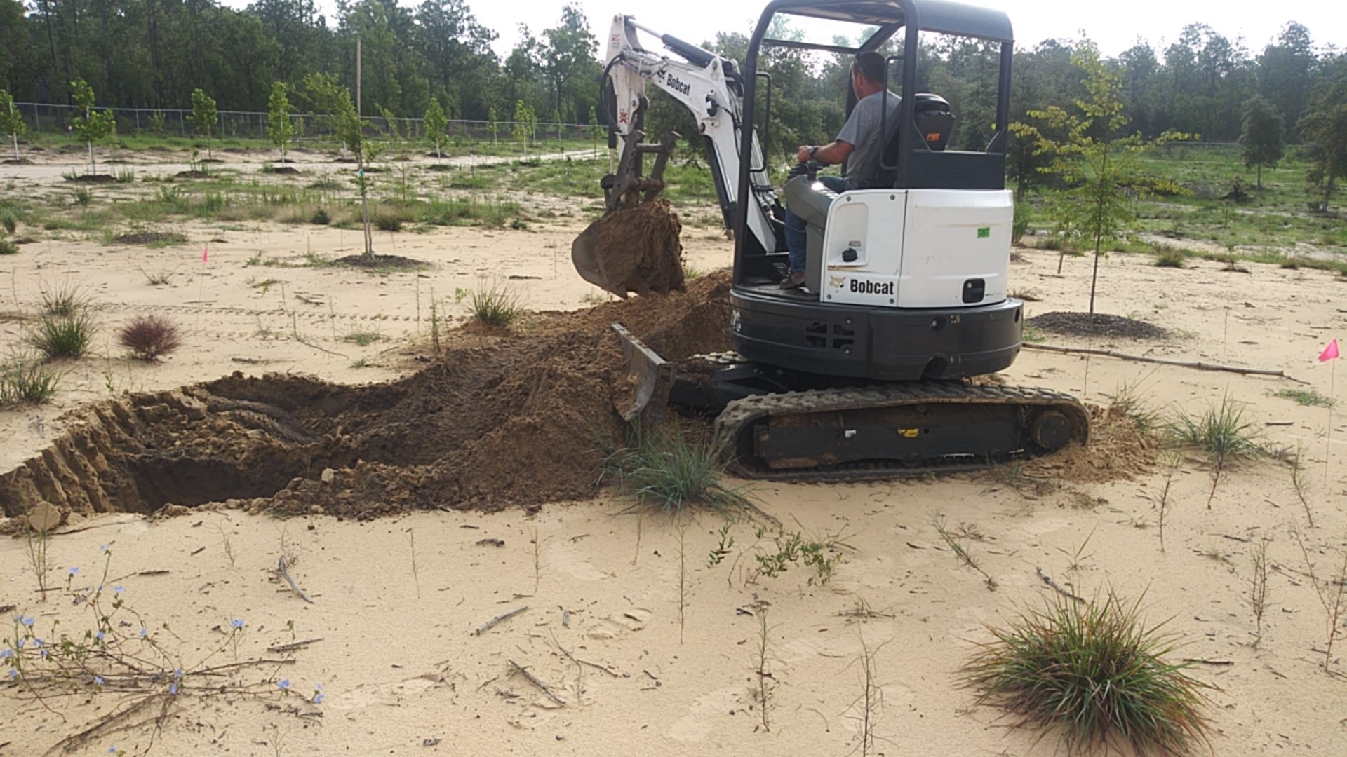

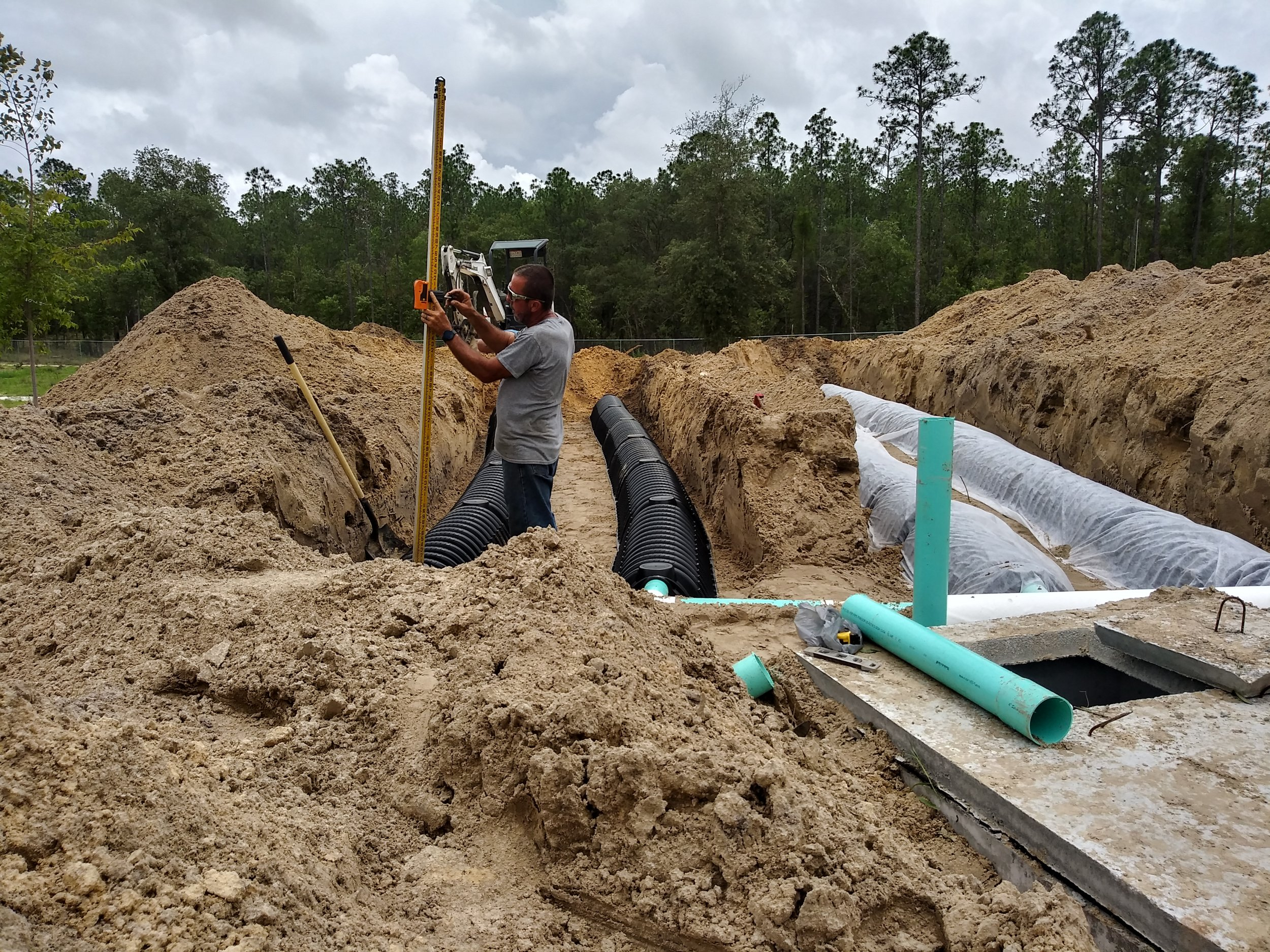

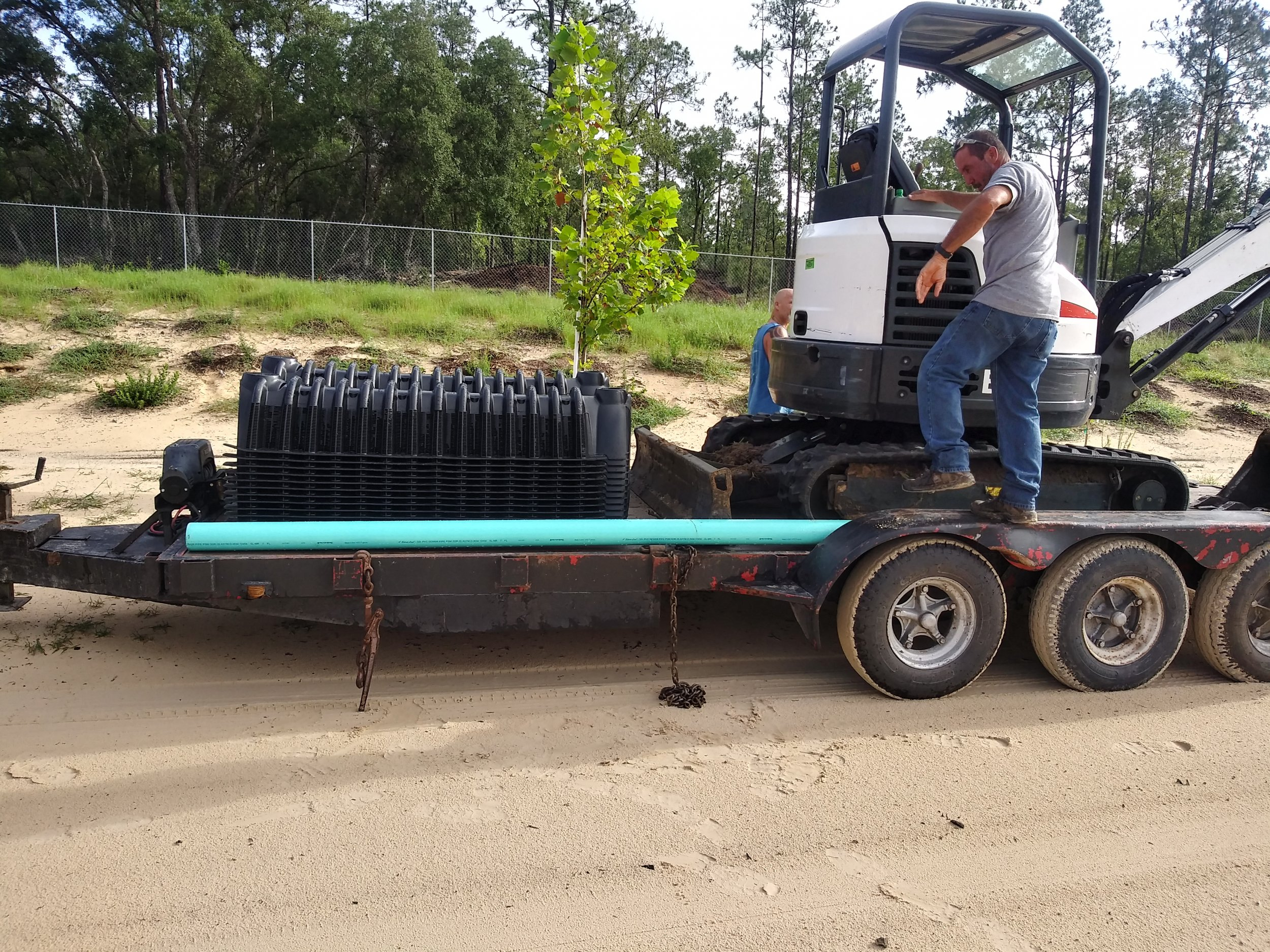

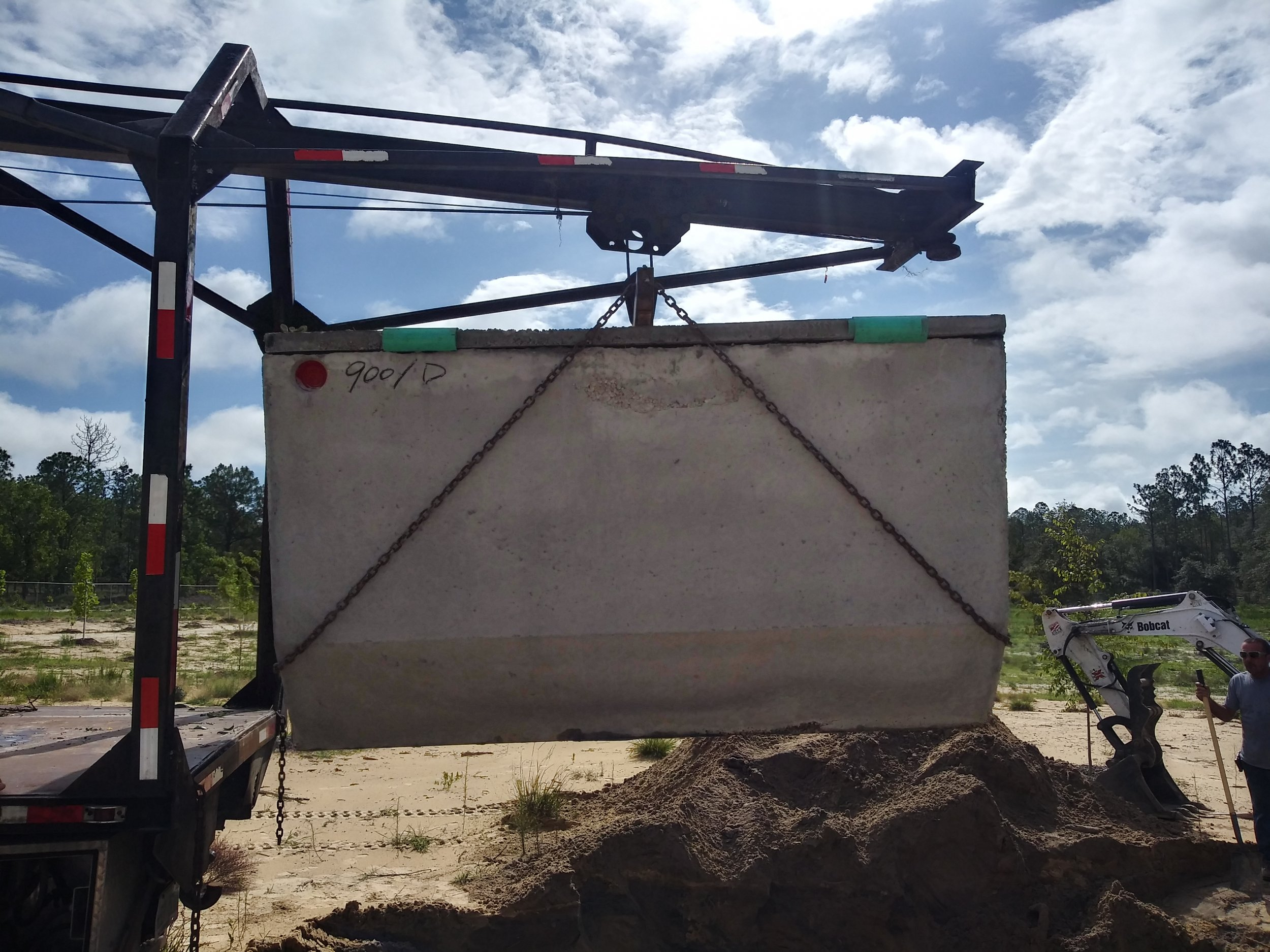

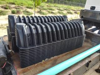

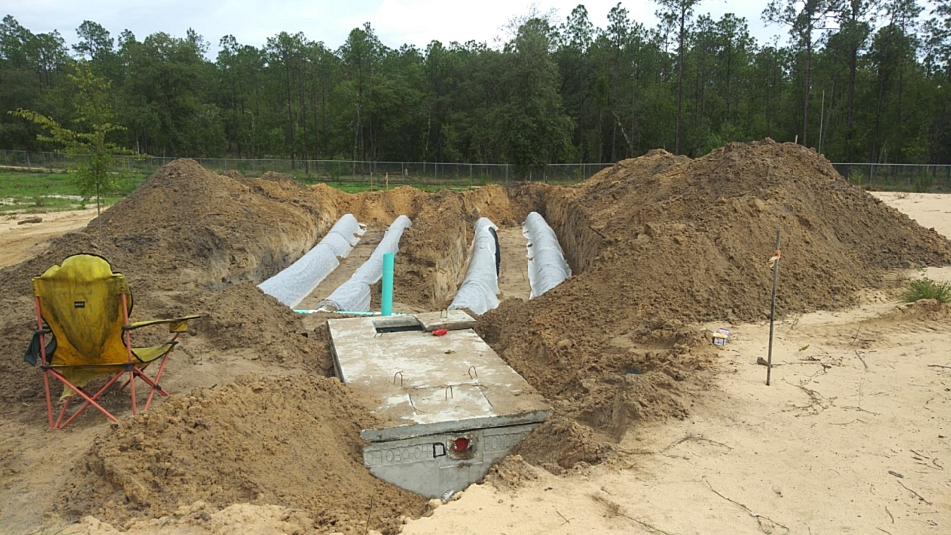

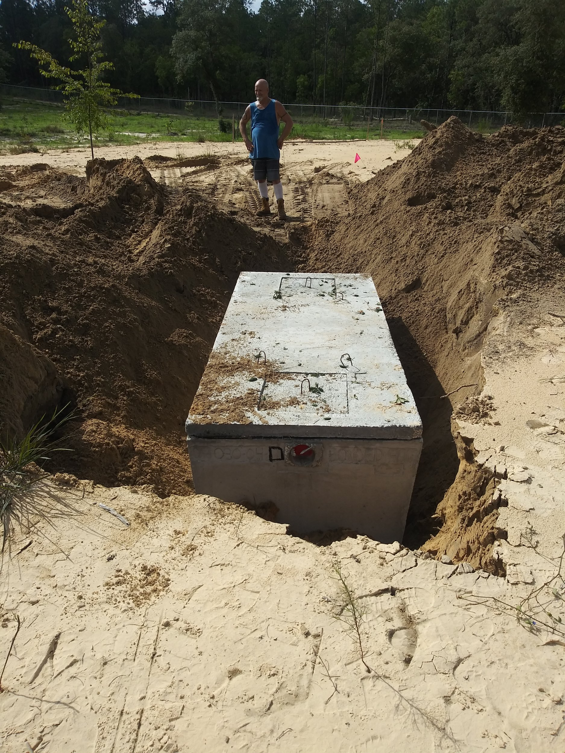

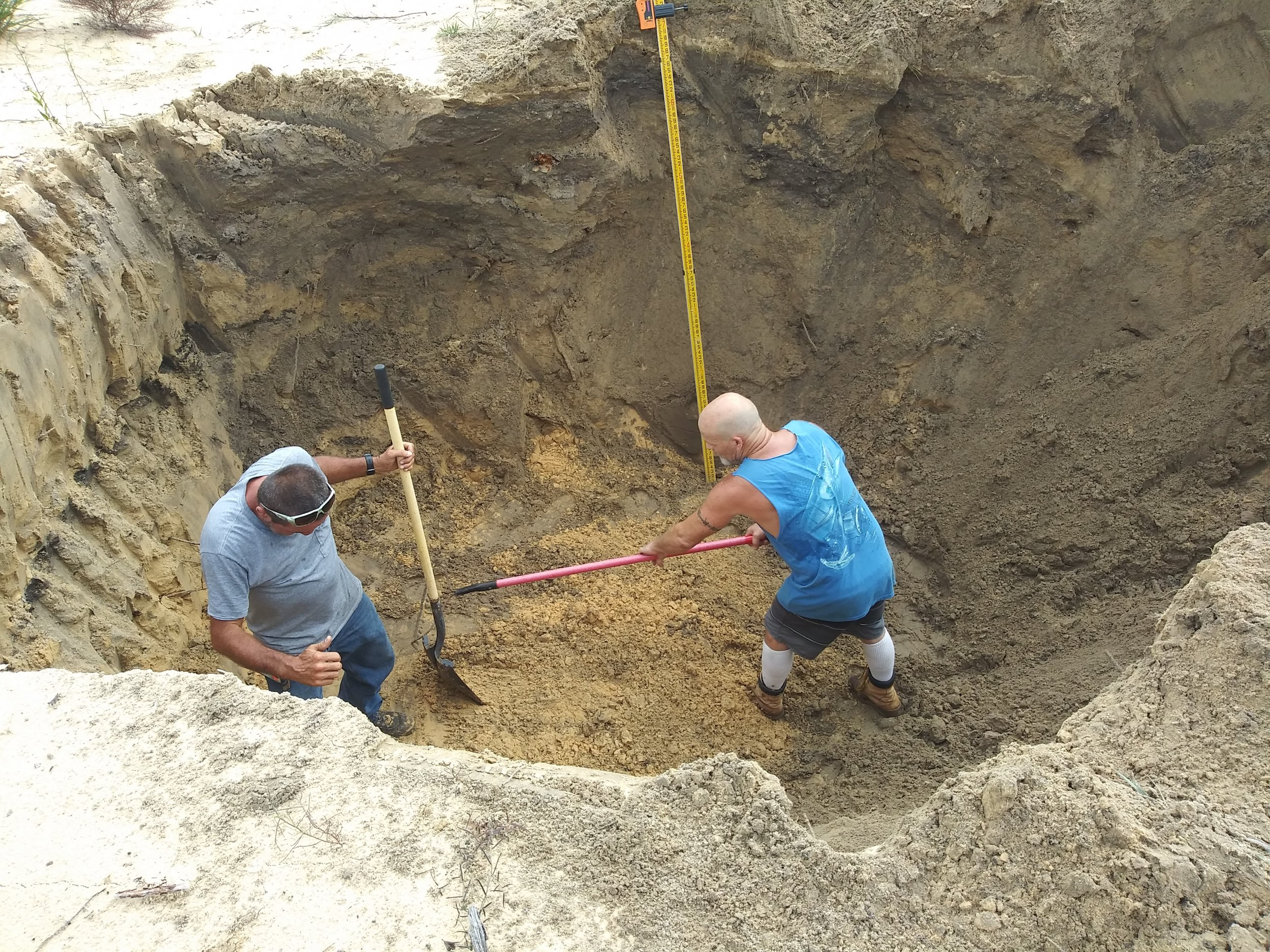

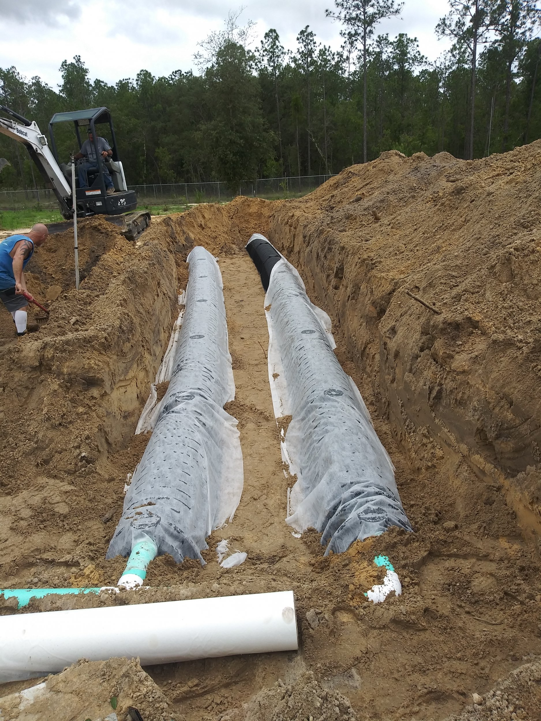

I had my septic done this past Fri and I thought some of you guys might like to see pictures. Only a few hours work for these guys and Im glad that I paid someone to do it
Has to be inspected this week and covered up.
