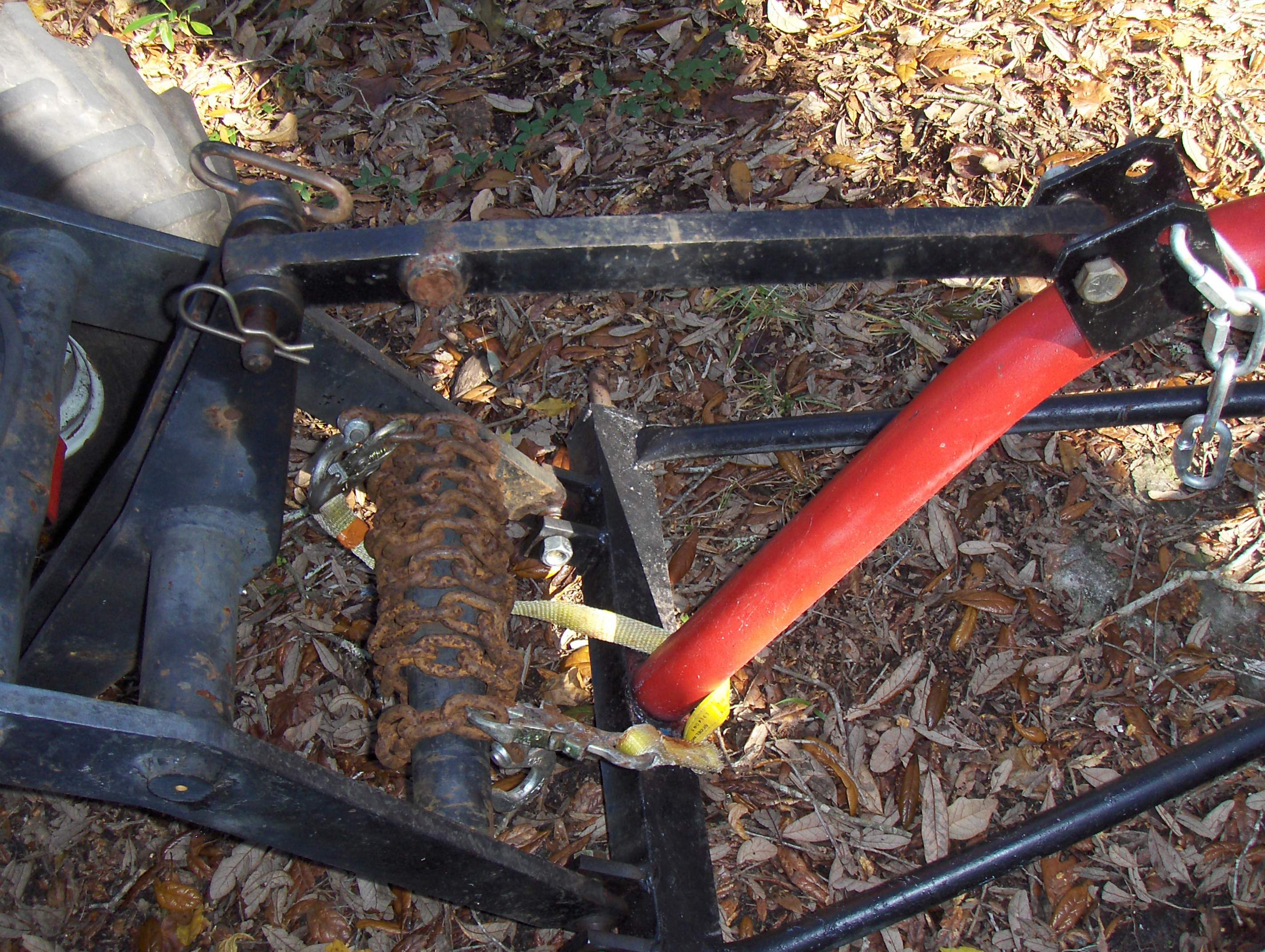

I just talked to Ketih. He recommended to try and repair it. I will try welding the crack and adding some plates. Parts are about $180.

Can you describe or show pictures of how you reinforced it. I am about an hour away from completion, so no big deal to finish. Maybe I should do more than I am. Details of your attempts would help.

Everyone, thanks for the input. I now believe I should replace it, but just for the sport, I gotta try this.
Edit: I layed some parts in place to show what I am doing. I am putting two pieces of 3/8 inch metal (2 inches wide) between the arms and then one on each side of the arms.
Bob,
I don't have any pics. Mine was breaking at the outside of the left one of those two flat arms, facing the tractor.
The first time, we simply rewelded it with a heavy bead. The second time, we added a triangular gusset between the arm and the tube. The third time, we added larger gussets, now on both sides of the tube, two on each flat arm.
When I pulled that pin out, it was BADLY worn (even though we'd kept it greased) and bent/bowed about 3/8" or so in the center. The tube was apparently binding on the bent pin, and the hydraulics were so strong that something had to give...
Very large forces are placed on that single rollover point -- for example if you lift the front of the tractor off the ground with the bucket, that entire weight is focused right there on the rollover, and multiplied by the mechanical leverage involved...

I did not realize this. I have finished and tested your concern and promptly bent the rod a little. I now need to trim some metal back.
I also found another crack to the right of the center arms. I welded that up but did not add additional reinforcement.
I have a feeling I will be fixing this again soon, but let's see what happens.

I cut away some metal from the add on plates to give the rod clearance. It has a small bend in it. Is there any reason I should straighten it?
/ Anyone have problems with the Rollover Link #74
I don't think so, unless it is a big bend. As long as it doesn't rub anything else, it should be O.K. If it starts to bend more, then you may think about straightening it.

Mine bent a little, then bent more in use after that. Tried straighening it (heat and hammers) and was never the same -- just kept bending again.
Ended up replacing it when I replaced the rollover... no problems in the 100+ hours since.

Yes, do it now or it will only get worse. Try to get it as straight and true as you can.
Simple experiment to illustrate the dynamics. Cut yourself a straight stick of green wood about 30" long or so -- 3/8" to 1/2" in diameter. Push straight down on the end of it, with it braced on something solid. It will be almost impossible for you to bend it.
Now, take a finger and bow it in the middle, just slightly -- then press down on the end. It will bend more, fairly easily. The more you bow it, the easier it will bend...
