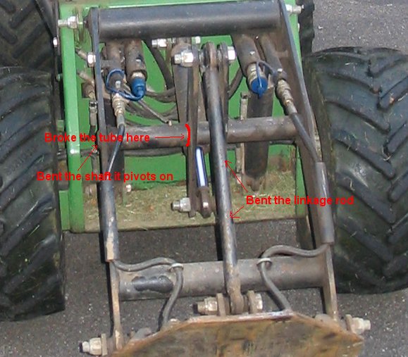

Not sure if we're talking about the same weak points... but I've had to replace essentially my entire rollover assembly on my PT-425.
1. First, I broke the "rollover tube and arms" that pivots on the shaft. It broke on the right side of the upright arms, as shown in the attached picture. We had it welded up twice, adding more reinforcements each time. The 3rd time was past the point of repair..
2. Over time, the connecting rod, that connects the PT's QA hitch to the rollover, bent slightly. Likely this was getting bent as a side-effect of the damage above. Once it began, it kept getting worse. After straightening it out as best we could with heat and BIG hammers, we welded on a piece of angle-iron reinforcement.
3. Then, last April when planting trees, I had a "catastrophic failure" when using the minihoe in shale rock that not only broke the rollover tube again at the same place (3rd time's a charm?) but also broke the shaft inside that it pivots on. I suspect that the earlier problems with the tube breaking had bent it slightly -- but this time it snapped.
Time to call Tazewell and break out the checkbook... no welding would patch this!
I replaced all of them with new parts. The tubing of the replacement part was thicker and heavier duty, though the shaft that it pivots on is the same size, as was the linkage rod... I saved the ugly, reinforced linkage rod as a spare, just in case...
In my case, I think this was caused by putting downpressure on the assembly that it just wasn't designed to take -- especially when using the minihoe...
I don't recall the total charge for the parts -- somewhere in the neighborhood of $200, plus the cost of having the shaft welded in...

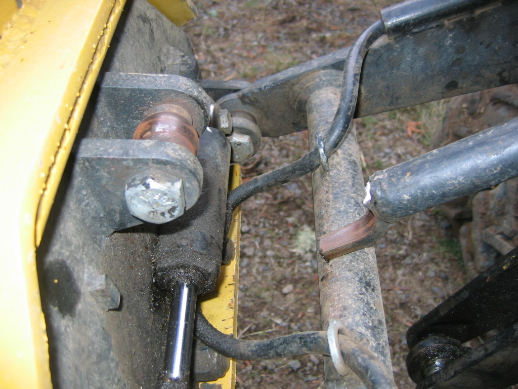

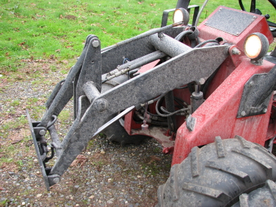

In Kent's picture it is the Linkage Rod. It has 3/4" cleavis on the ends. I am thinking of making them 1" with a sleeve but here we go, spending more money and the wife will kill me for sure
One picture is of the link in good shape, the other is of it broken....
That looks like a swivel eye fittings, and there will not be any twisting action on that rod. At times you will have considerable push and pull on that rod causing stress. You say you have fixed this three times? There is no grease on that eye piece, but should be.
I replaced my complete roll over assembly last year. The roll over tube jammed itself on the 2 in pin and would not move. Even a shop press could not push it out. My connecting thingy is 1 in by 2 in with two holes for different attachments. I have also built some from 1/2 steel and welded them together.

Carl, I think I would cut the swivel eye portion off and weld a piece of 1 in thick 2X2 steel with a 3/4 in hole . If the other end breaks, do the same thing.
I think the stress is caused by the attachments putting to much force on that swivel eye, and I am sure you will be doing the same things you were doing before, so beef up the end piece.
http://img518.imageshack.us/my.php?image=welding0271mi2.jpg
The one in this picture has a tube through each end and gives the pin more support.
