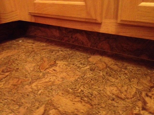

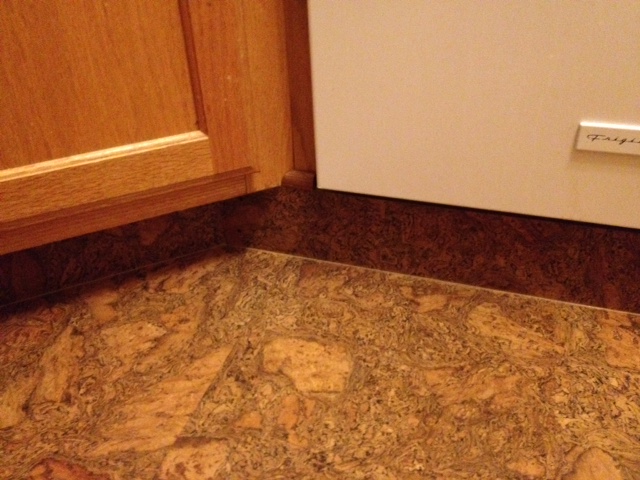

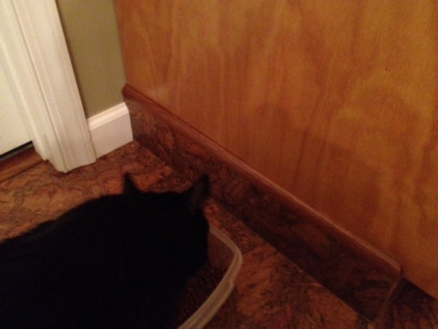

We have Lumber Liquidators Lisbon Cork in our kitchen and dining area -- it's the interlocking 1x3' panels that float. After installation, I put down 4 coats of water-based poly to seal it. The floor has exceeded our expectations. It's comfortable to stand on when working in the kitchen, quiet, and warm. Looks like a million bucks too. I had some concerns about wear since the kitchen is a primary traffic area in our house (between garage and everything else) but the floor and poly finish still look new after 3 years.
One thing I did was to slice up leftovers and scraps into 4" wide pieces and use them as baseboard trim and toe-kicks under the cabinets. That ended up looking great.

I got some oak quarter round and stained it to closely match the cork color. That caps off the exposed raw edge on top. I have some pictures kicking around, and will try to dig them up tonight.

Here are some pics of the cork floor, baseboard, and toekick. I put small clear plastic corner protectors on all outside corners of the baseboard/toekick, attached with clear caulk, but they blend in so well you can't see them in photos.

Nice looking floors - like the way the trim turned out on the kick area and sides.
Also see you have a healthy and growing black cat enjoying dinner too.

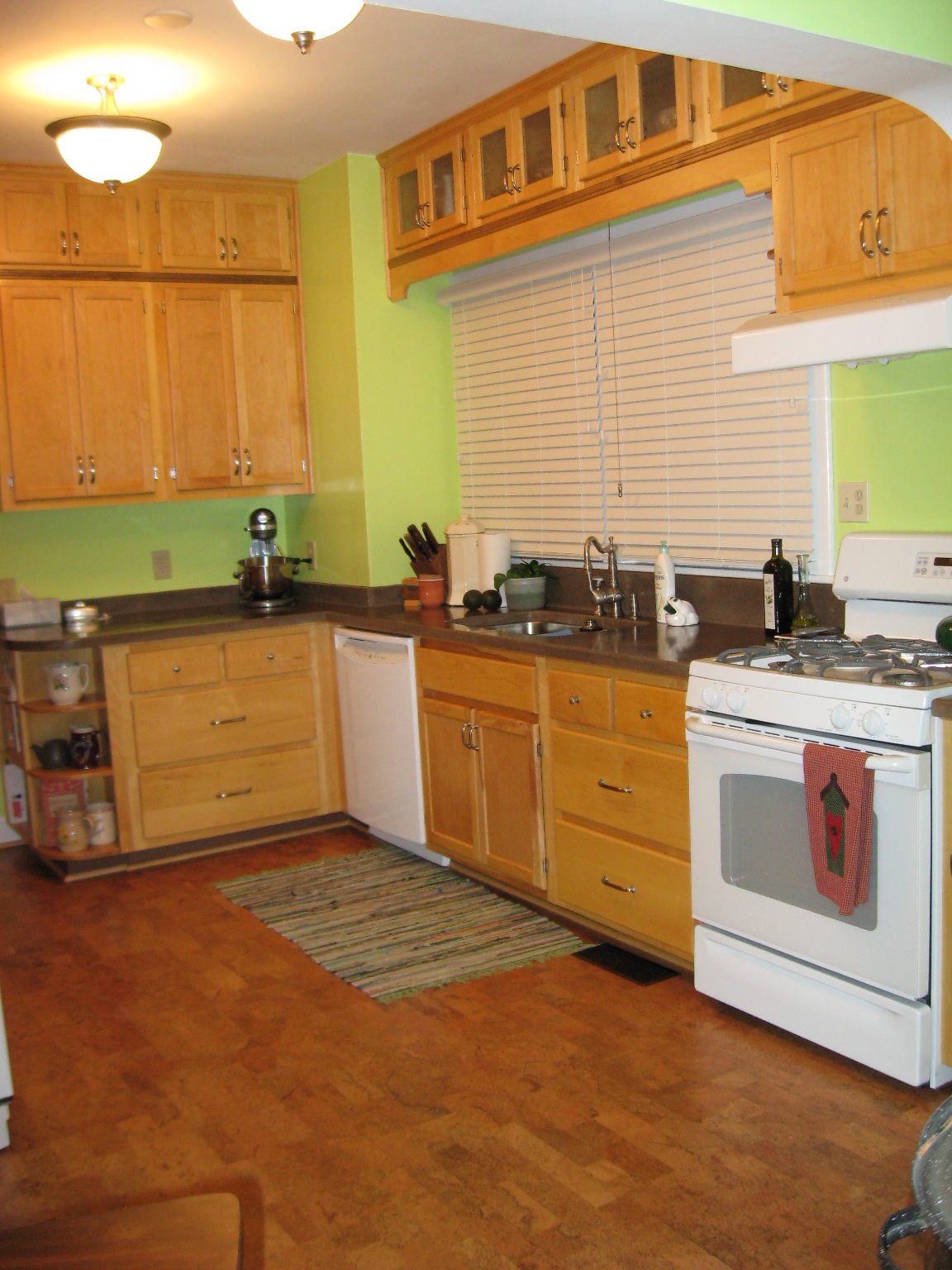

Cork floor is fantastic - very comfortable. We installed a floating cork floor about six years ago now and don't see any wear.
