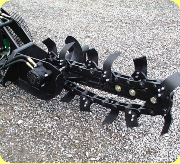

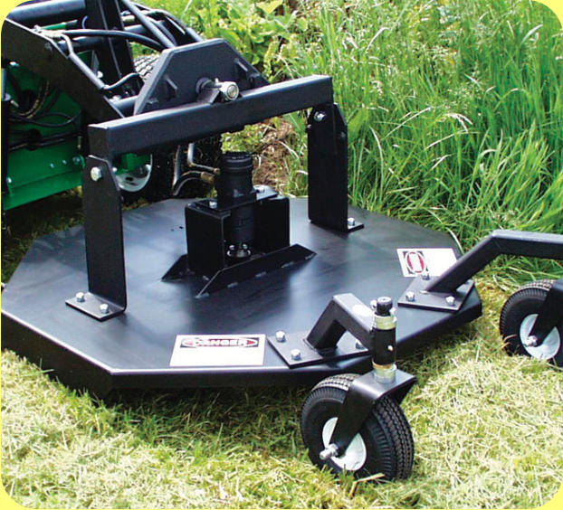

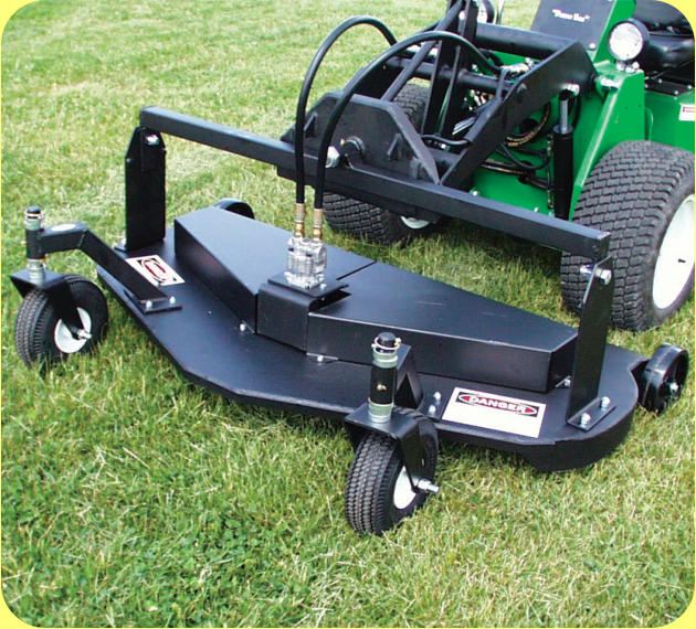

I like to think of the motor displacement as gearing. Tiny motors are high speed/low torque. Larger motors are medium speed/medium torque. Even larger motors are low speed/high torque.
   / Anybody have source for a 540 RPM hyd motor to run tractor attachments on PT? #18
Take a look at the different attachment pictures and compare the motors while thinking about speed...
