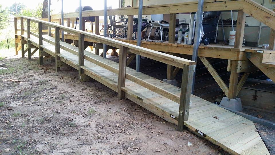

That 1:12 slope for the ramp isn't something to mess around with. This ramp is 1:12 exactly, and the deck was something like 4 feet off the ground. The person living there was in his early 30's and very thin. He couldn't walk at all, so he was dependent on somebody picking him up and carrying him up and down his deck before I built the ramp. His nurses where very concerned about the steepness of the ramp and wanted it to be have less slope, but I just couldn't find the space to make that happen. It has two landings, it goes off the back and works its way to a low enough position that it ends up in the driveway.
With wheelchairs, you never want to push them to their limit. Anything more then 1:12 is dangerous and should be avoided. Just because it's possible to get away with it once, or dozens of times, doesn't mean something really bad could happen.

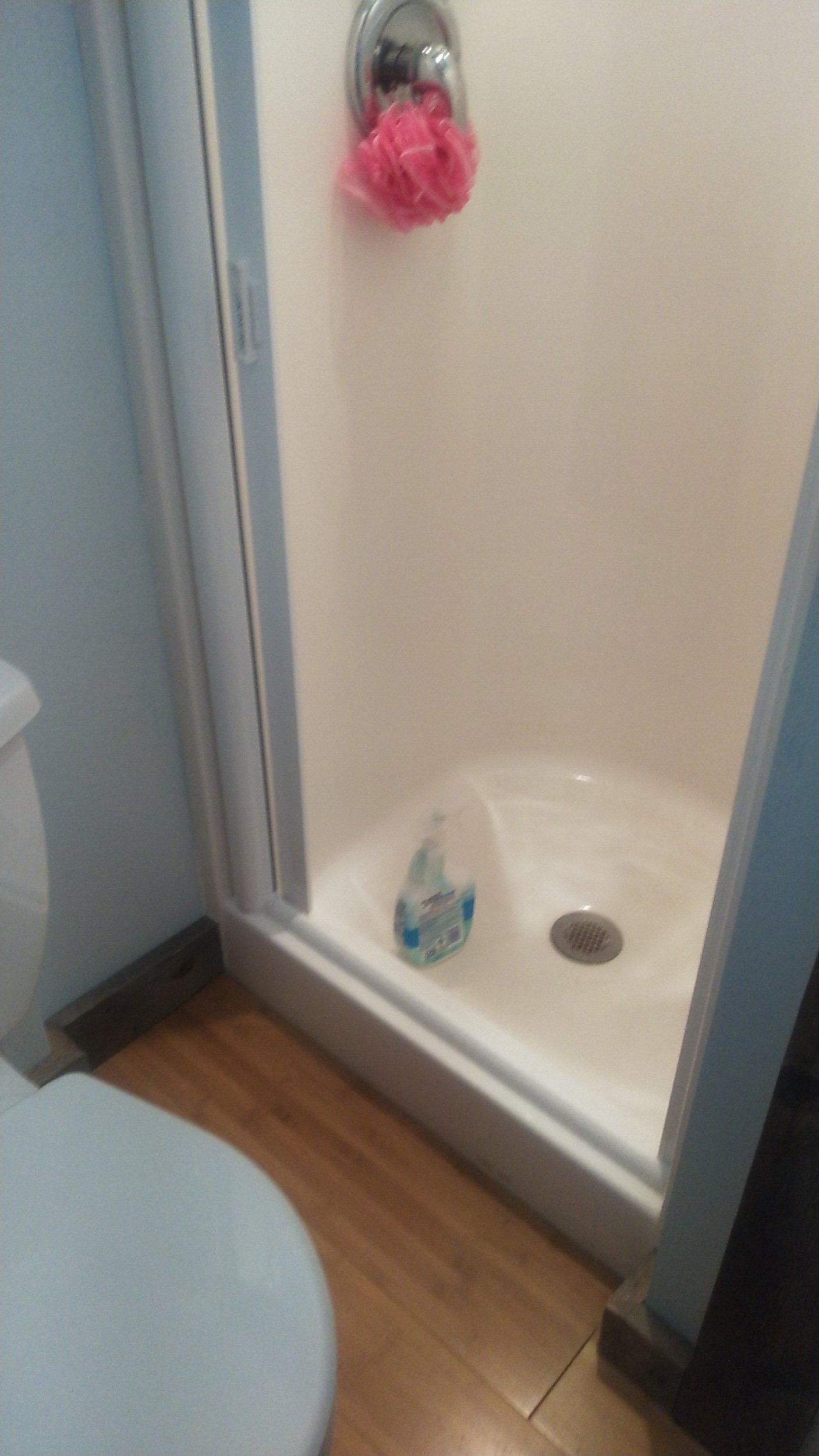

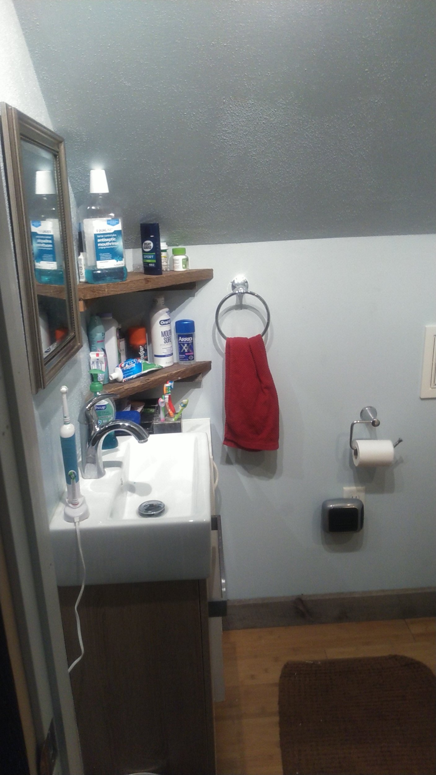

/ Anybody built a Tiny House? #54
Here's bare minimum comfortable functionality I built for upstairs bathroom, using conventional fixtures available readily for a small bathroom for my 24x30 3 bedroom 1 3/4 bath cape cod style cabin. Like I previously mentioned a dormer would have been nice and made layout simpler but chose a different somewhat challenging simplicity, nor did I want to work on steel roof flashing on a 10 pitch roof later on. If you want actual measurements can't get them for you until end of the month, notice how close 28" narrower toilet is to shower entrance probably about a foot. I chose to be able to stand up without cocking my head to one side while taking a leak rather than have a runway into shower. I suppose I wouldn't recommend for disabled or grossly overweight people. Everyone that's used that bathroom hasn't had any problems or complaints with it. Good luck and imo id seriously consider nautilus brand retractable shower doors for smaller bathroom showers especially over any curtain and rod setup, or doors, out there.
