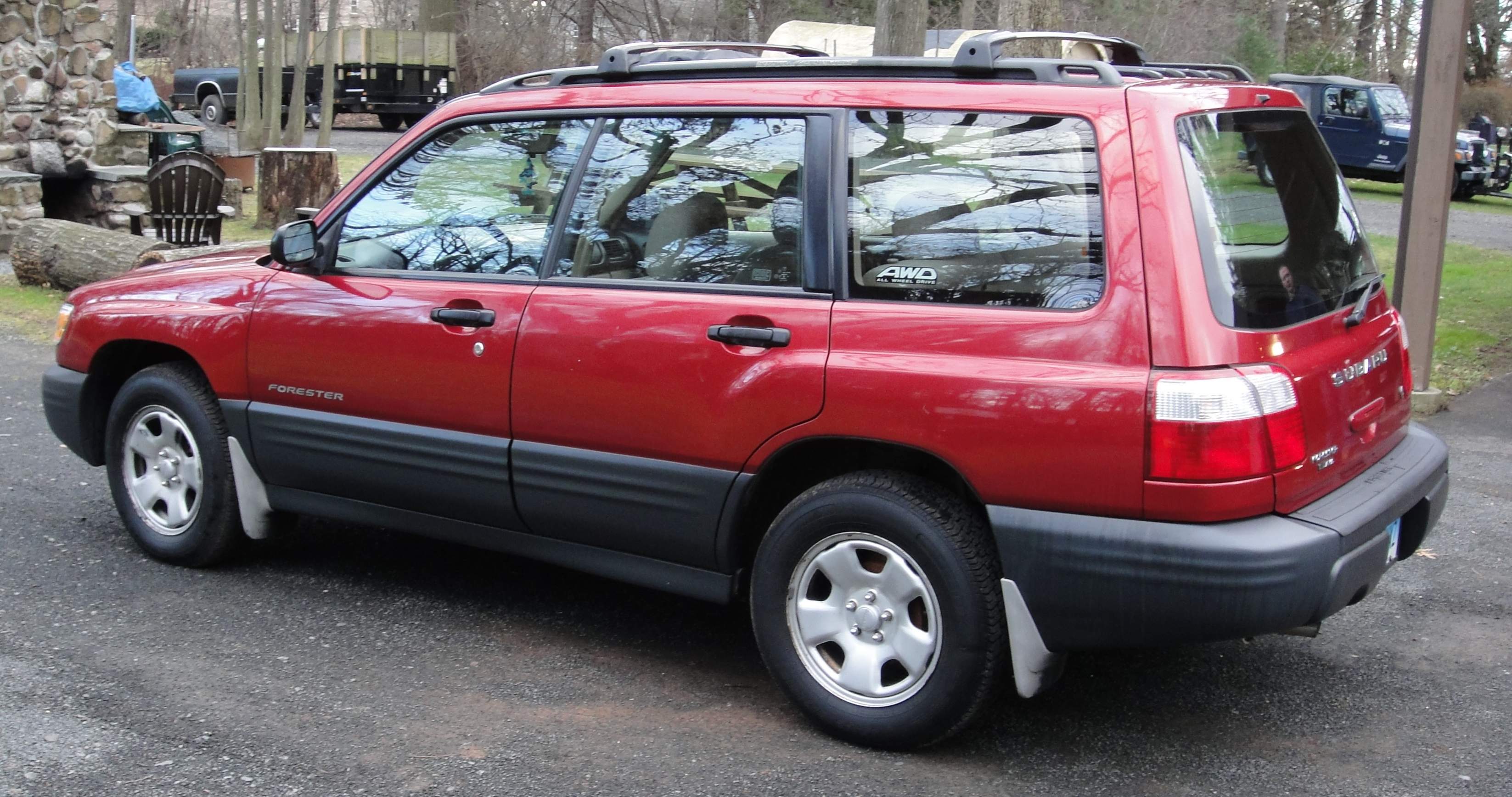

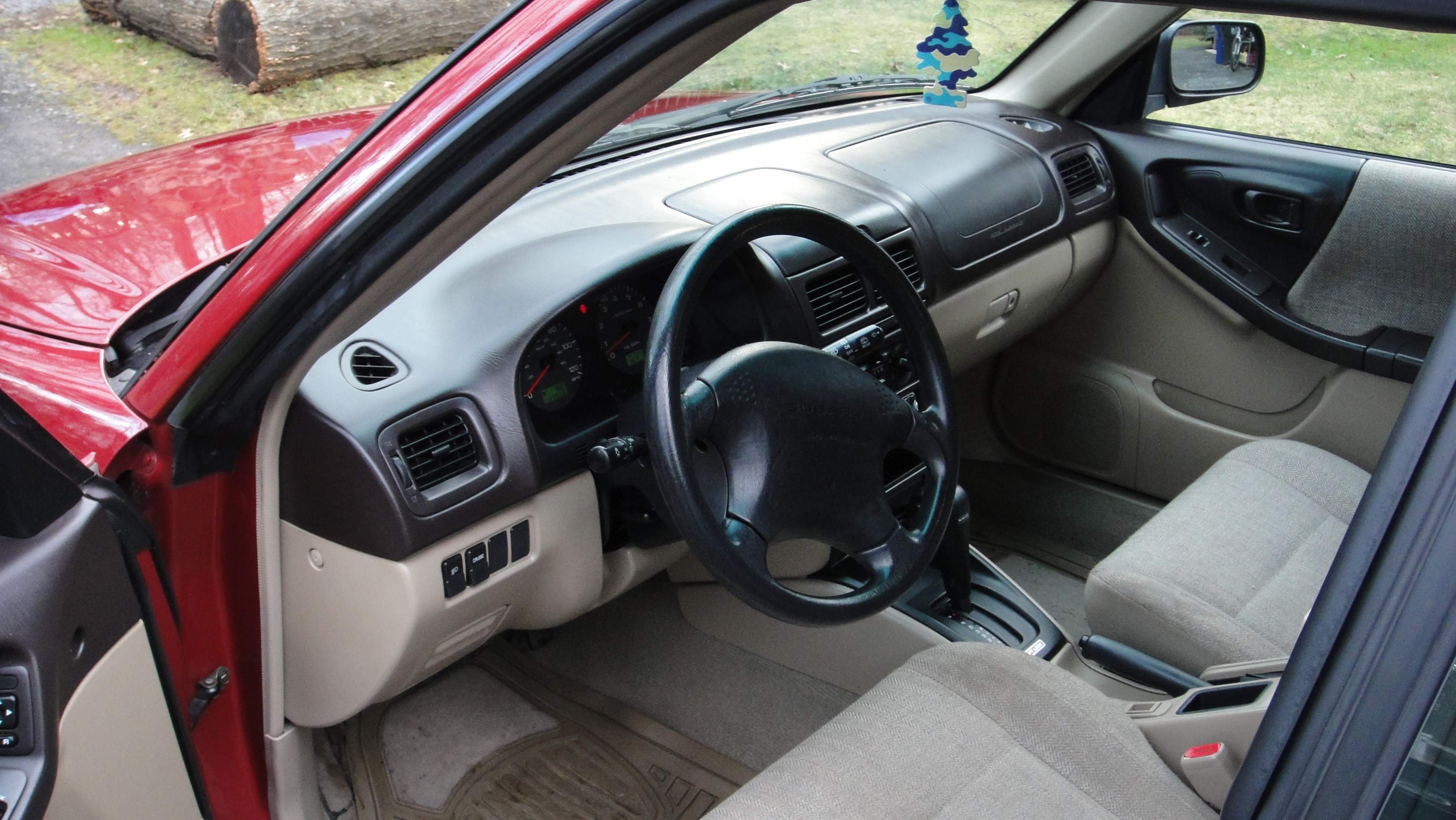

Yeah, I almost walked away from this car, for how it looked underneath, could see it had been sitting for awhile. But after I cleaned it up I think it is a decent deal.
This car looks very good on the outside and inside, but is not to pretty underneath, alot of rust and corrosion. I spray bombed it with anti corrosive PB blaster today.
I did the timing belt today along with the tensioner. The timing belt job is really like painting by numbers, it's that easy.
Fixed a bunch of little piddle stuff, like clock, weather stripping, window washer pump. Removed a mouse nest from the blower fan that was so packed the fan could hardly move, the nest material came from the hood insulation.
The tranny is something I'm a little concerned about, although the owner says he had the fluid flushed and replaced. There is a little evidence of seepage between the tranny and trans-axle, and on the trans-axle where the axle comes out.
Trans-axle fluid looked clean and between the marks, but I could not get the fill plug off the rear differential to check the level. And that was with a breaker bar and a 2.5 lb hammer, also a 1/2" Snap-On impact wrench (only 120 psi though). I was able to loosen the drain plug and I see there is fluid coming out, it looks clean, just not sure how much is in there.
JB
