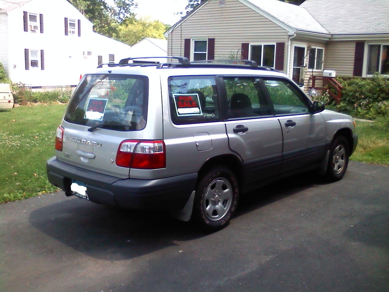

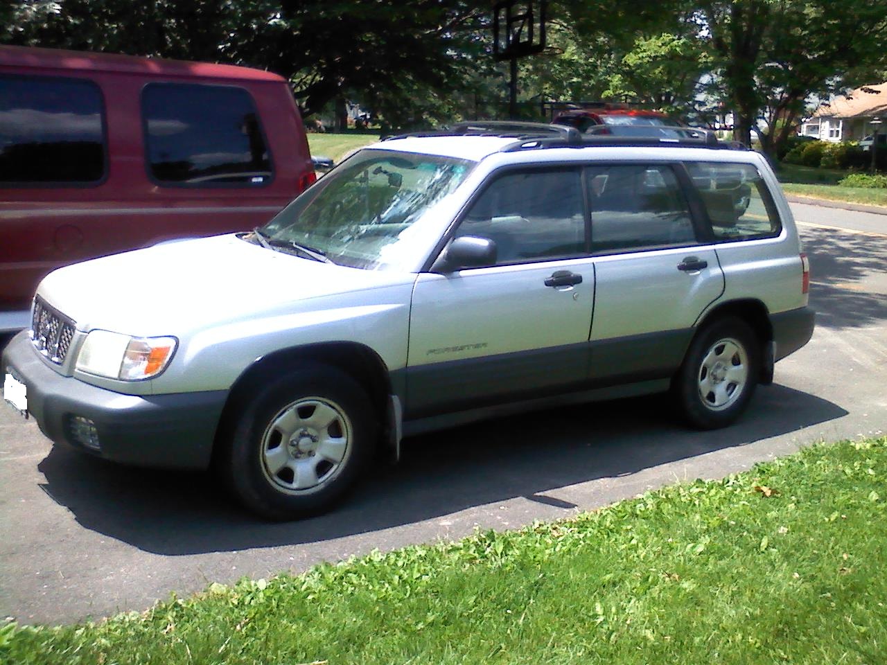

Just like to hear from you on your experiance.
A lady I know has a 2001 forester L model for sale for $4300. I think I could get it for less, or for some barter on home repairs. It's a standard, very clean and tight. only 76,000 miles with a new clutch and some other work done, she has some receipts and one says something about changing axles?
She even has an extended warranty to Dec. 2012. not sure how legit it is but she showed me some paper work.
At first I thought I don't want to go backwards and get a standard, but it is actually fun to drive, and I was surprised at how quick it is even with the ac on.
This would be a 2nd family car, that would be shared with 3-4 drivers. We have a 99 grand caravan that I would replace with the subaru, since no one wants to drive the minivan, it was great with 3 little kids, but apparently not cool now.
I figure if I sell the van, for little additional money I can get a 2 year newer AWD vehicle with 60,000 less miles and get 2 times the MPG.
According to the teen drivers, the forester is not cool either but I'd rather buzz around town doing errands with it instead of the mom van.

Not only do I own one, I am a Subaru tech. The biggest issue with subies are the head gasket leaks; so look under it (especially the drivers side)
If you are a mechanical guy, the head gasket is not a difficult job. Around Oregon a car of that milage/year would be much higher in price.

I would have the cel light read; don't trust what is said. a p0420 could be a o2 sensor, or may be a cat converter. Do you have emissions testing in your area? Are you a rust/salt area? Also notable is wheel bearing issues; specifically rear. on the test drive pay attention for abnormal noise/growling from them.
You NEED to look under it. head gaskets can leak coolant, oil or both. the crossmember will be very wet. But the oil could also be valve cover gaskets.
I would find a independent subie shop do a insp.

Thanks for all the replies, I'm still dragging my feet, I did speak to her yesterday trying to feel her out to see what she needs to get for the car.
She came down to $4,000. with out me asking, which I know is very fair compared to what I've seen for used suby's.
The situation is a friend left her the car in her will and and the sales proceeds goes to her daughters collage fund, So I can't beat her down. and she can't barter for me doing work for her cause probate is involved.
She's a nice lady, I'm sure if it was up to her she would let me work it off around the house.
I did notice that the plastic cup holders were real flimsy, but figured that's how you get 25 MPG, by keeping the car light. Both my Grand Caravan and Grand Cherokee only get around 12-13 MPG around town.
I would tint the windows in back, as it looks like a rolling green house now :) But I did like driving the car, felt very tight, and Like I said I was surprised at how much power it had for a 4 banger, I'm sure that's because of the standard.
She does not have this car on CL or any other advertising as far as I know, she only has the window signs and she lives on a side street, That's why I'm getting away dragging my feet for now. I'm pretty sure if someone was looking and needed a good used suby they would not hesitate.
