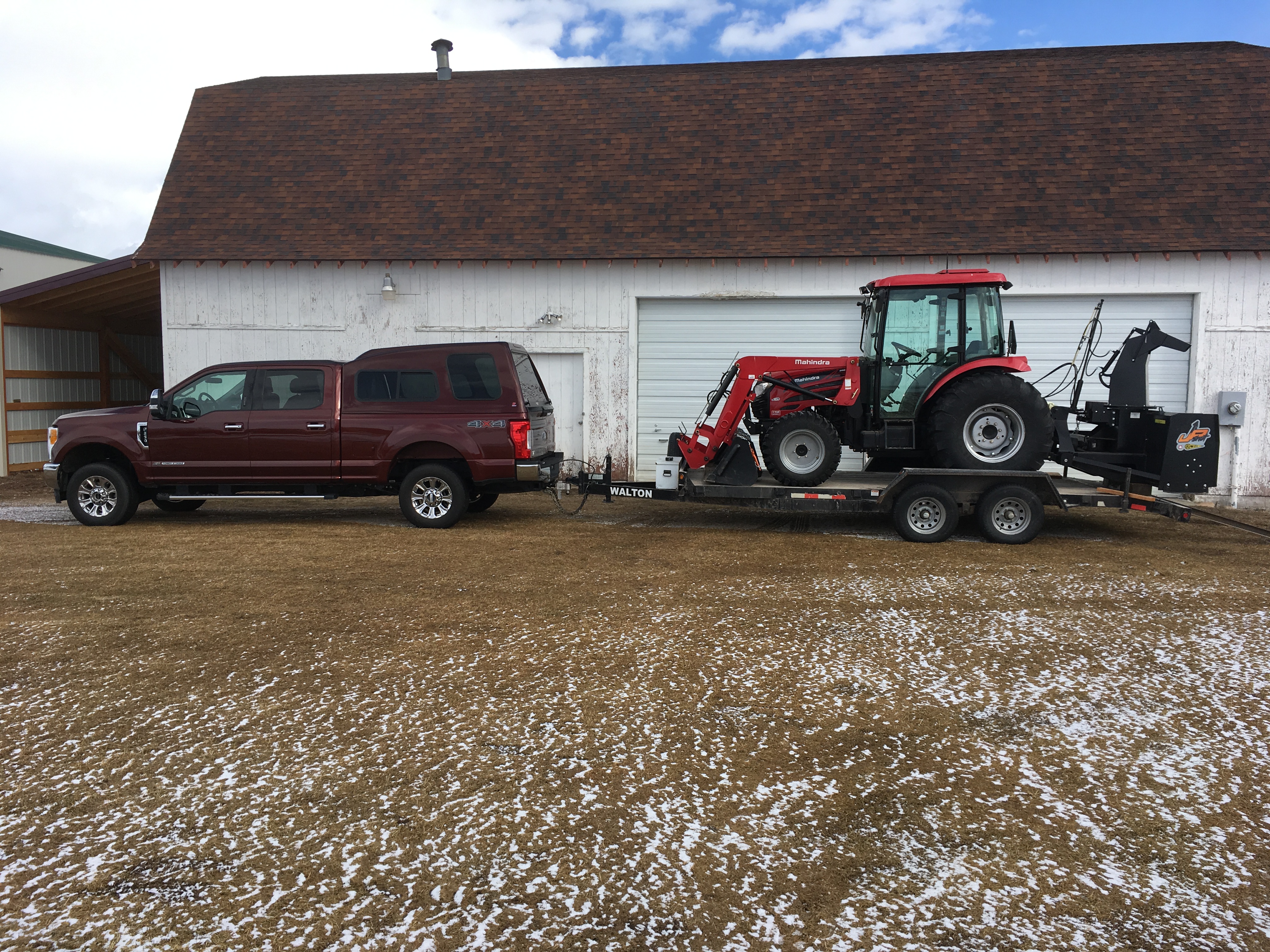

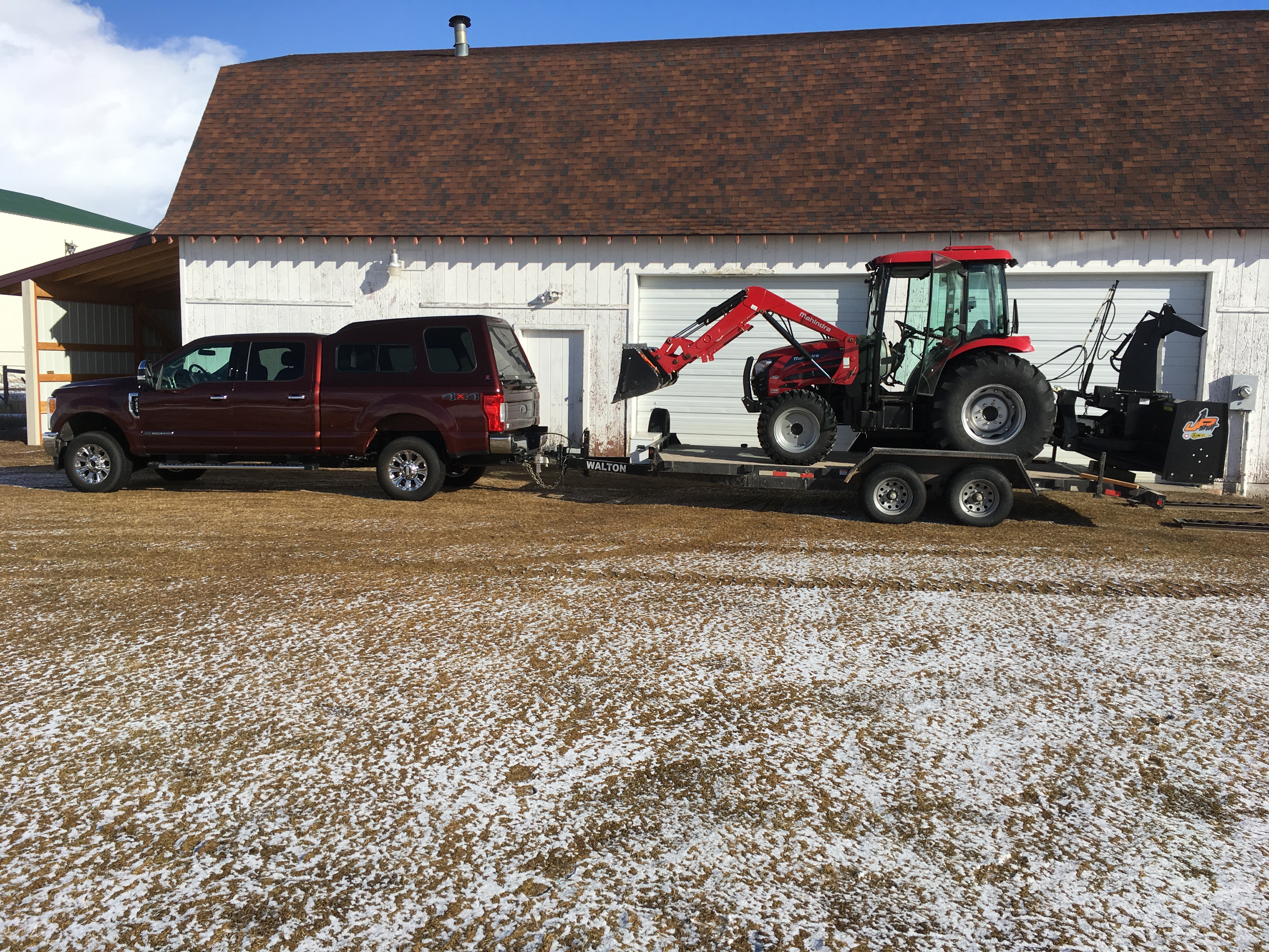

I have been looking for a 10K, 7'x20' car hauler trailer to replace my 7K, 7'x18' car hauler. My current needs require hauling more weight than the old trailer would handle safely. It seems there aren't a lot of these trailers around, at least not used ones. I did run across one, price was right so the owner said he would drop it off so I could try it out to make sure it fit my needs. When he showed up though it was only 18' long but I thought I would give it a try.
As you can see, I tried loading it a couple different ways. I can make it work but I am going to hold out for a 20' trailer. May even just buy a new one.

I would go 22 or 24 feet ,Your setup is pretty long
/ Another Trailer Thread #3
Definitely go longer. I would try backing it on that trailer and seeing how it rode. The new fords have stout hitches. On my 450 it was rated for like 20-22k on the bumper

That trailer looks more like an equipment trailer than a car hauler.
In my opinion, buying a new trailer is the best idea.
You get new decking, new wheel bearings, new brakes, and new tires.
Wiring, coupler, breakaway chains & battery, tongue jack, and everything else is new.
You should specify 16" wheels also.
I bought 20', but should have bought at least 22'.

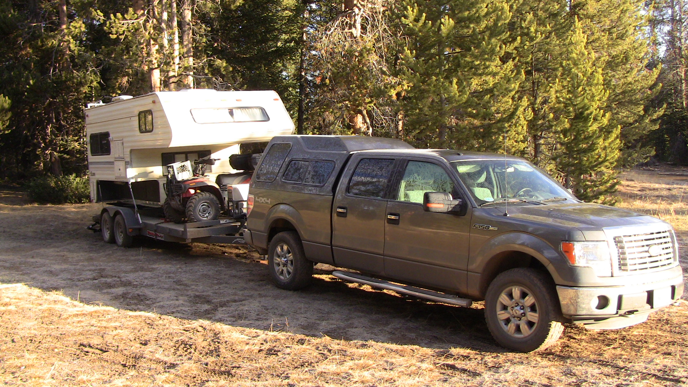

I'm resisting going longer than 20' due to using the same trailer to haul my camper and ATV into the mountains, the longer it gets the fewer places I can get into.
This picture has my previous pickup in it.

I measured it out for backing the tractor on but that will leave quite a bit of open deck in the front of the trailer and leave the bucket hanging quite a ways out the back. The center of weight is just in front of the back tire and what appeared to give the best tongue weight was with the front of the rear rim centered over the center of the axles. I didn't pull it to confirm but I know it won't vary much from that.

If you get a 20 foot trailer look at big tex mega ramp or something the same, That way u have a flat deck to load on . what's the total length of your tractor and attachments

Go longer than 20... it looks like if you don't, you are still going to be stretching your limits. Having to disconnect a bucket to fit it on the trailer will get real old real fast. .. on another note.. I'm surprised how well your 250 takes the young weight of that.. I have a 350 and the trailer weight alone is noticeable when it's hooked up.. I'm going to have to get air bags this spring.

Length as shown with the bucket on is right at 20 feet. With my mower in place of the blower it will be about 2 feet longer.

The mega ramp might work then the deck will be flat to load your camper or the mower will sit flat on the trailer . If you can pull up far enough to fold the ramps down. I have slide in ramps on one of my trailers sometimes fold up ramps get in the way

Suggestion for you, run your chain thru the stake pocket and hook it underneath the trailer frame if possible. It is a lot stronger hook up that way and less chance of tearing or distorting a stake pocket.

Yep... I went 22' so I could do a lot of moving around with stuff. You'd be better if you had some room to center your load not just be satisfied with getting it on there.
