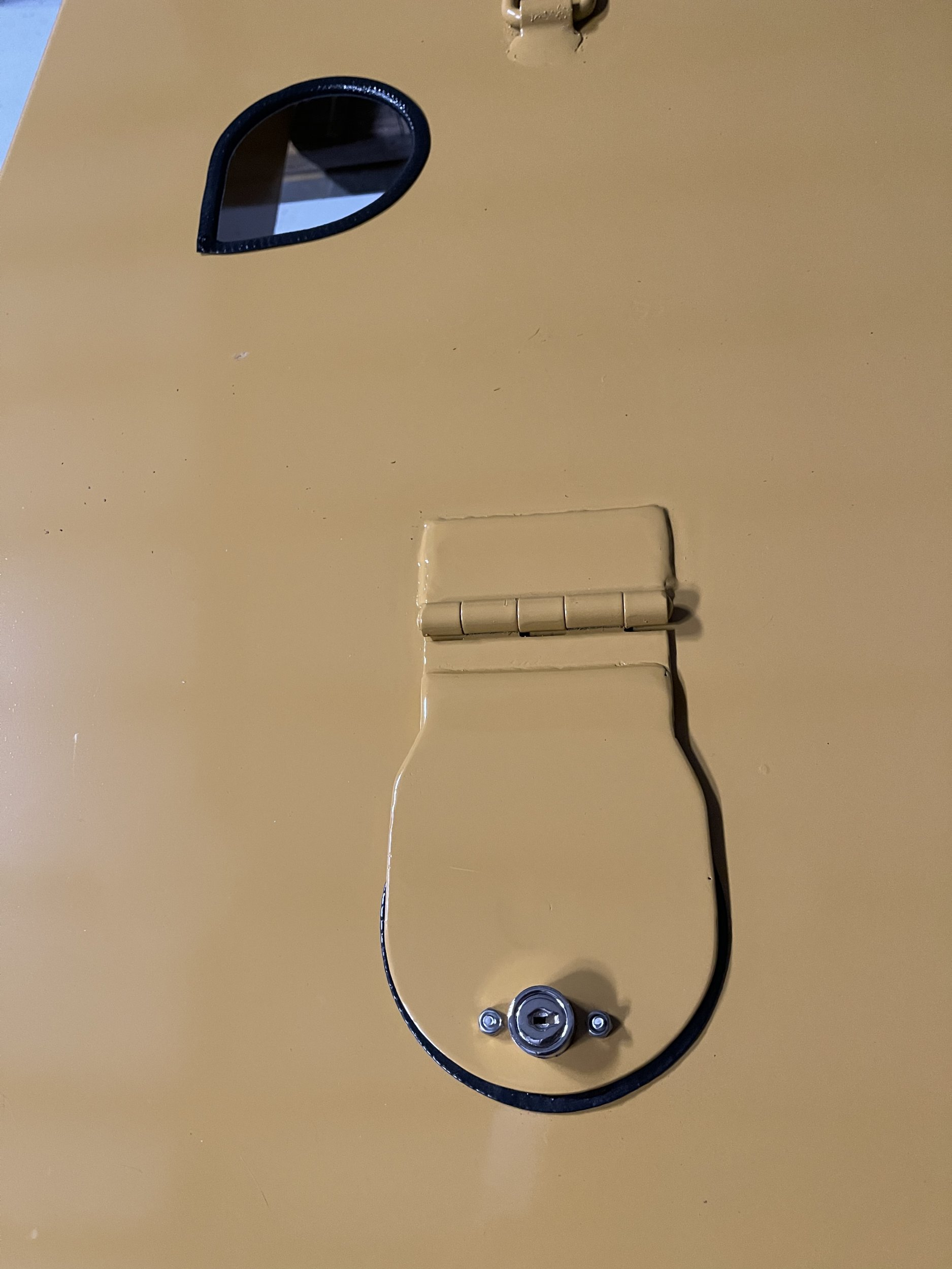

I fabricated a locking radiator access door and adjusted the funny looking teardrop hole for the air cleaner pipe, then I made a removable half circle enclosure around the muffler, all on the hood. Why the teardrop hole? It is part of making my hood hinged. I need to remove the air filter pipe after the pre cleaner is removed. That little area allows me to get a ratchet in there to loosen the clamp.
Next I got a couple stainless hinges and bolted them to the bracket where the hood was intended to be bolted. I had to drill and tap the 2 holes on the inner portion of the hinges. That is the reason for the block of wood back there so I wouldn’t drill the radiator too.

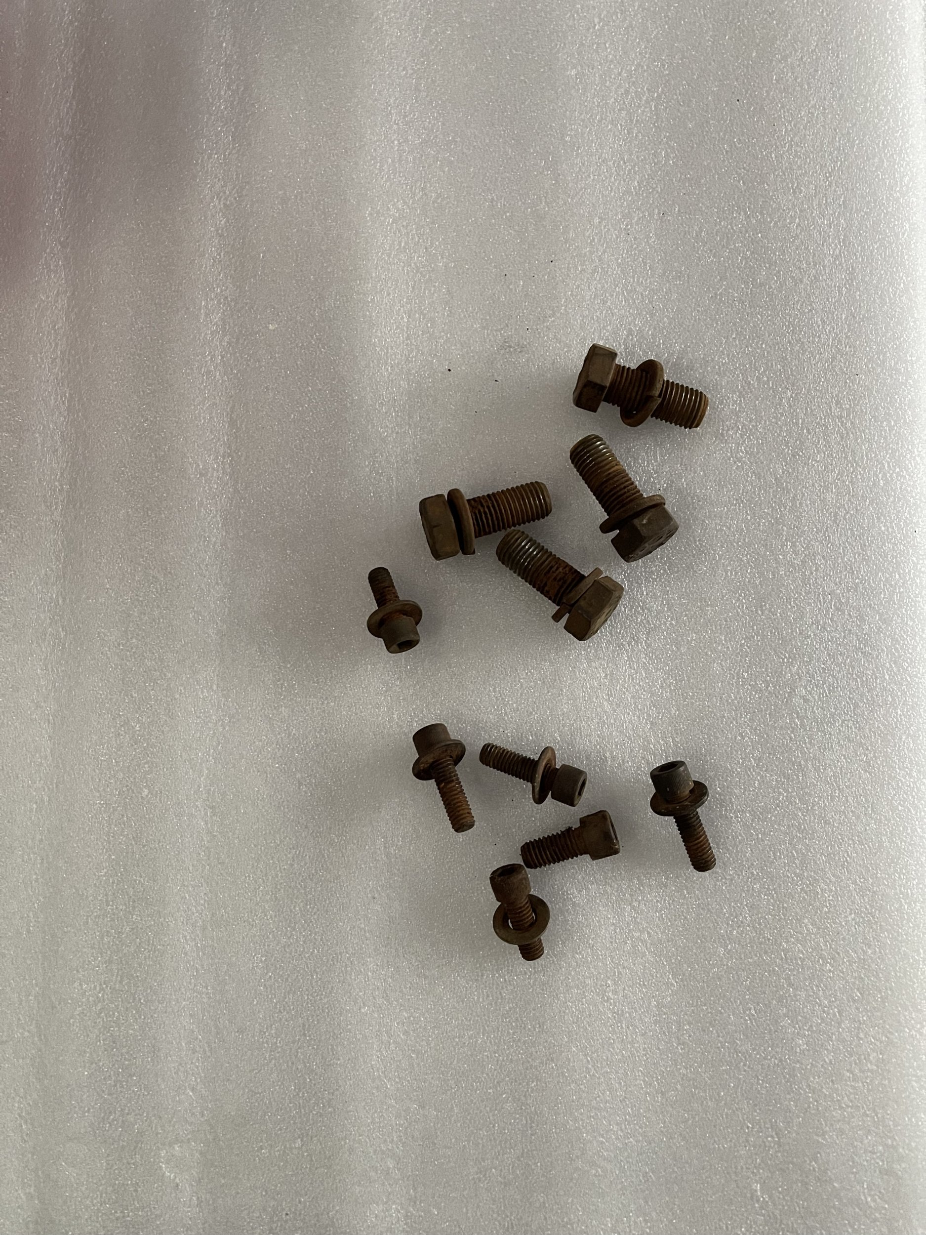

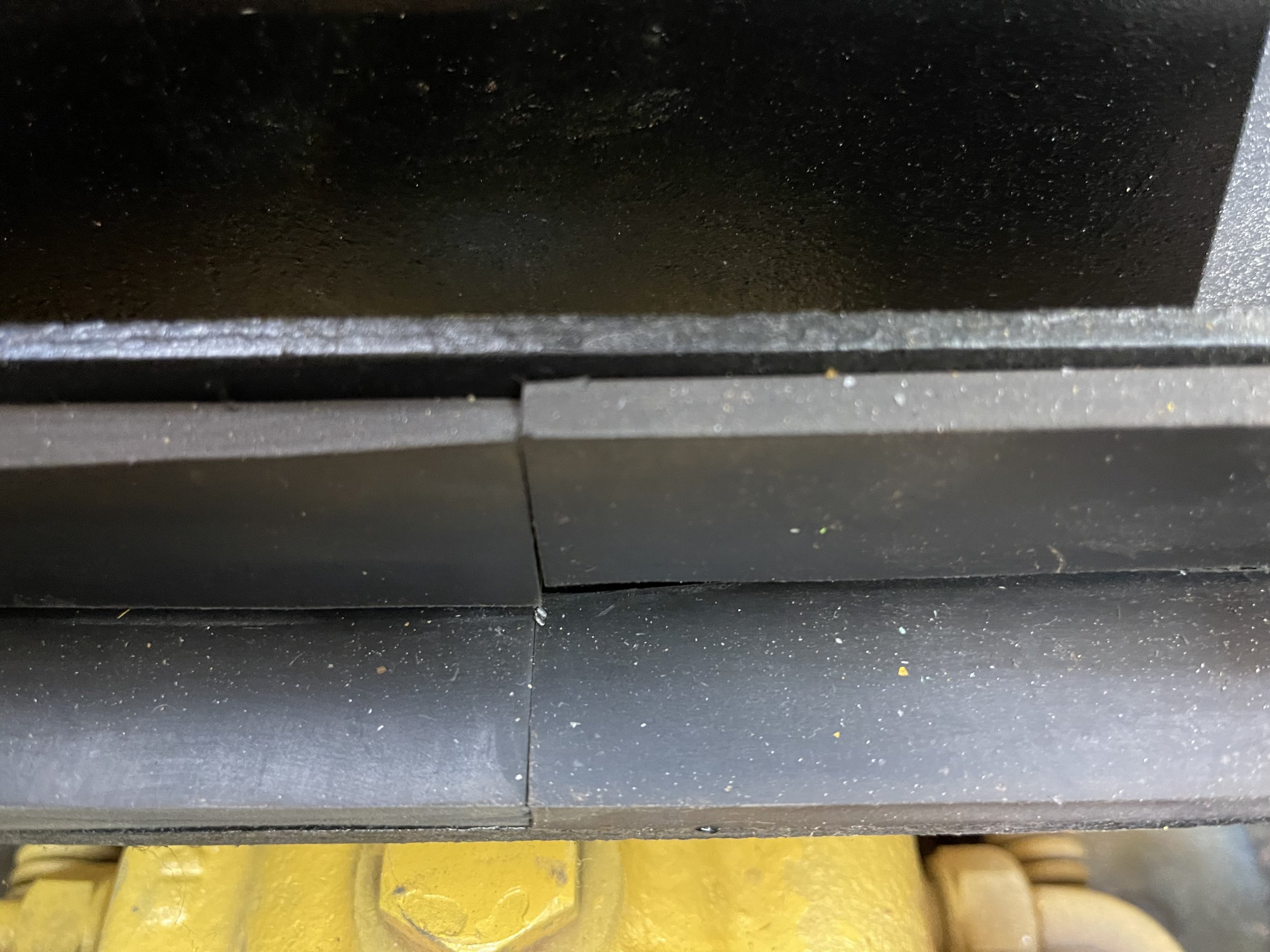

Now I have to do some calculations for size and strength of the gas springs. Oh yes I also put the final bolts in the support bracket. I couldn’t handle the ones with screwdriver slots and painted heads. Also I put some pieces of conveyor belt to seal the air gap around the shroud. The original ones weren’t available and weren’t as strong.

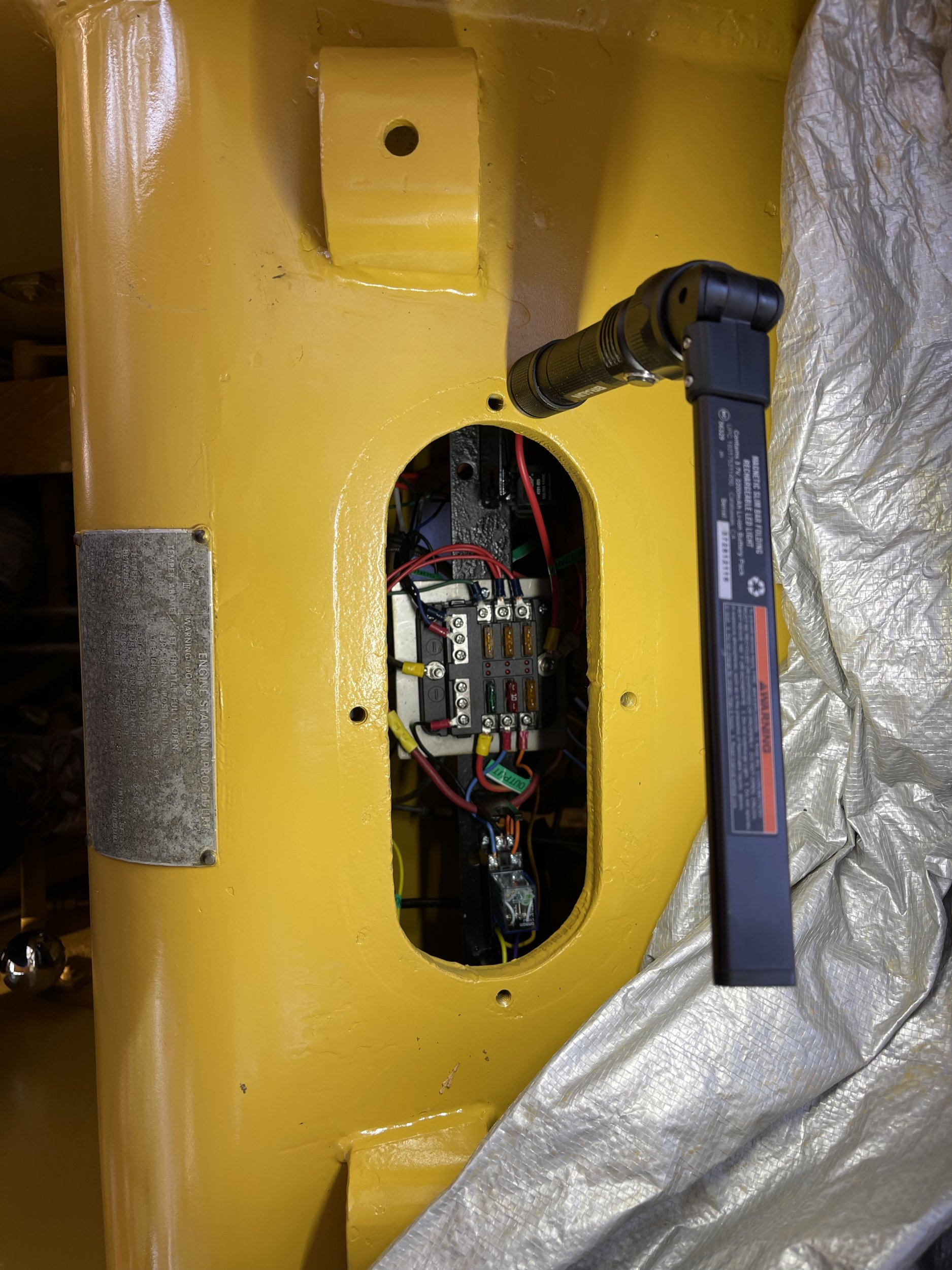

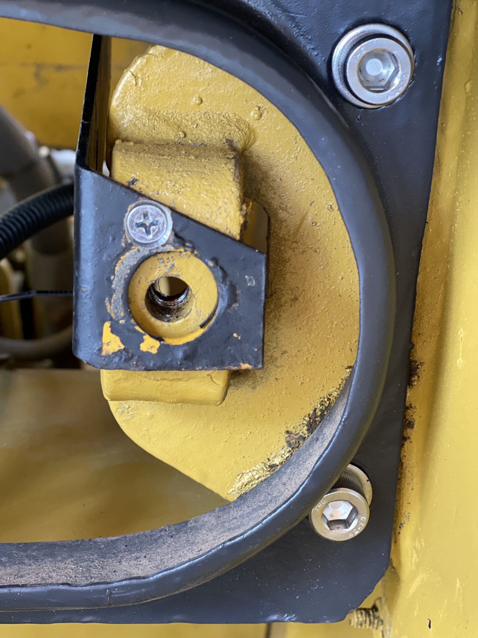

I finished the hood including the radiator access and primed and painted all the parts I made so far. Not a hand rubbed finish exactly but nice enough for the tractor. I made the hinge mounting holes square for adjustment and got some 12mm prevailing torque flanged nuts to use on there.

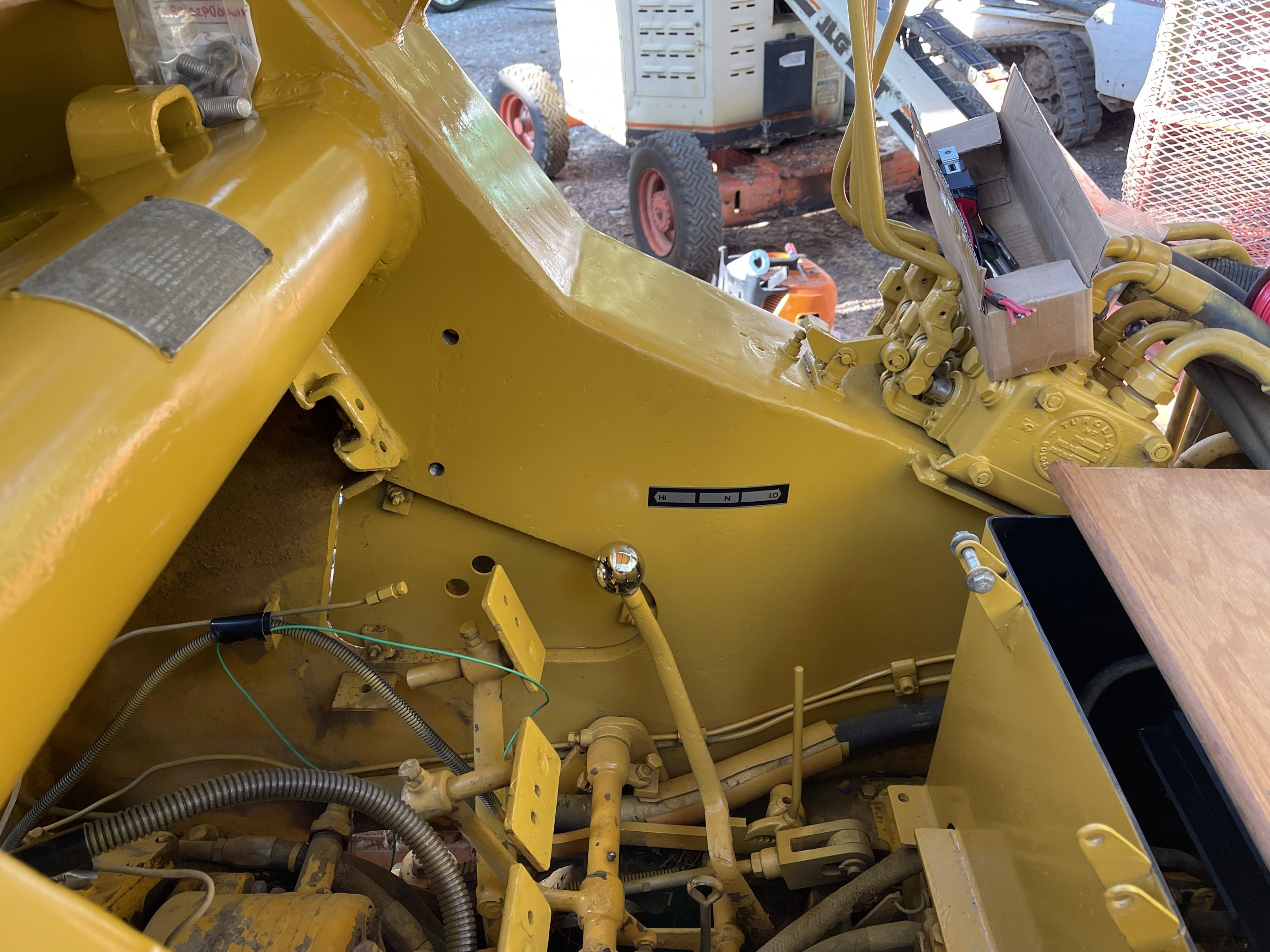

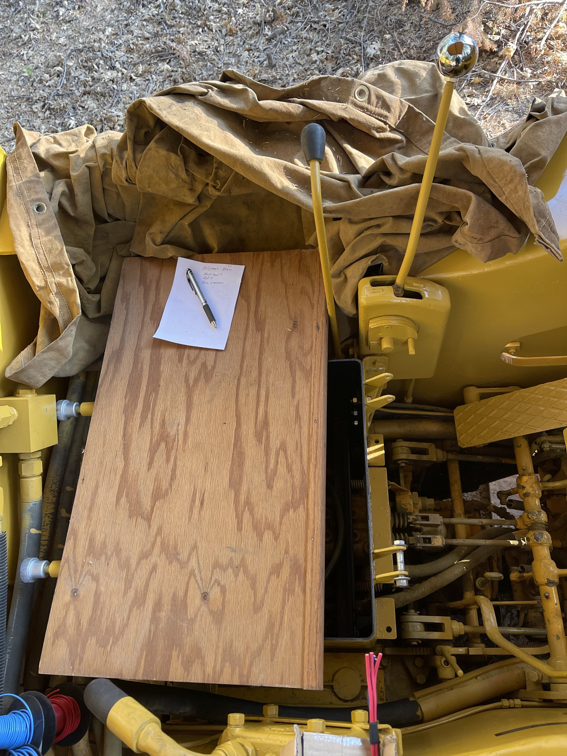

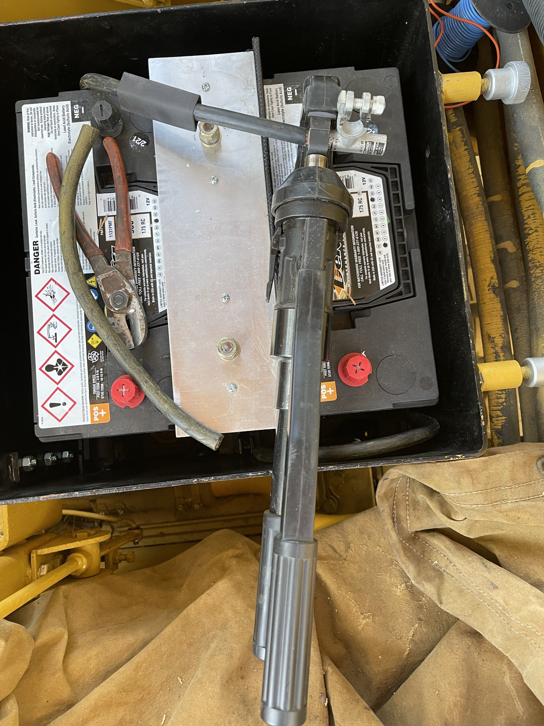

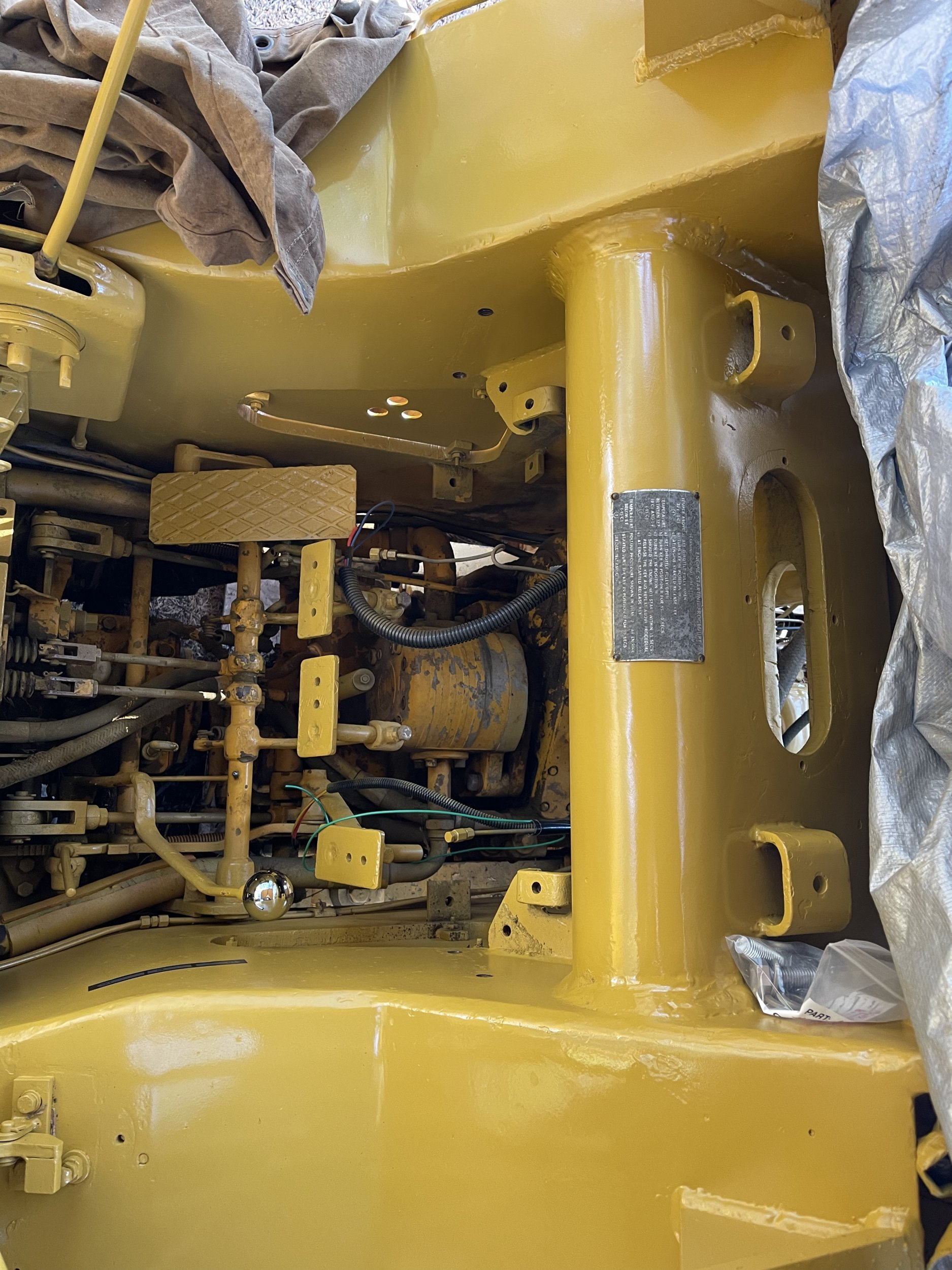

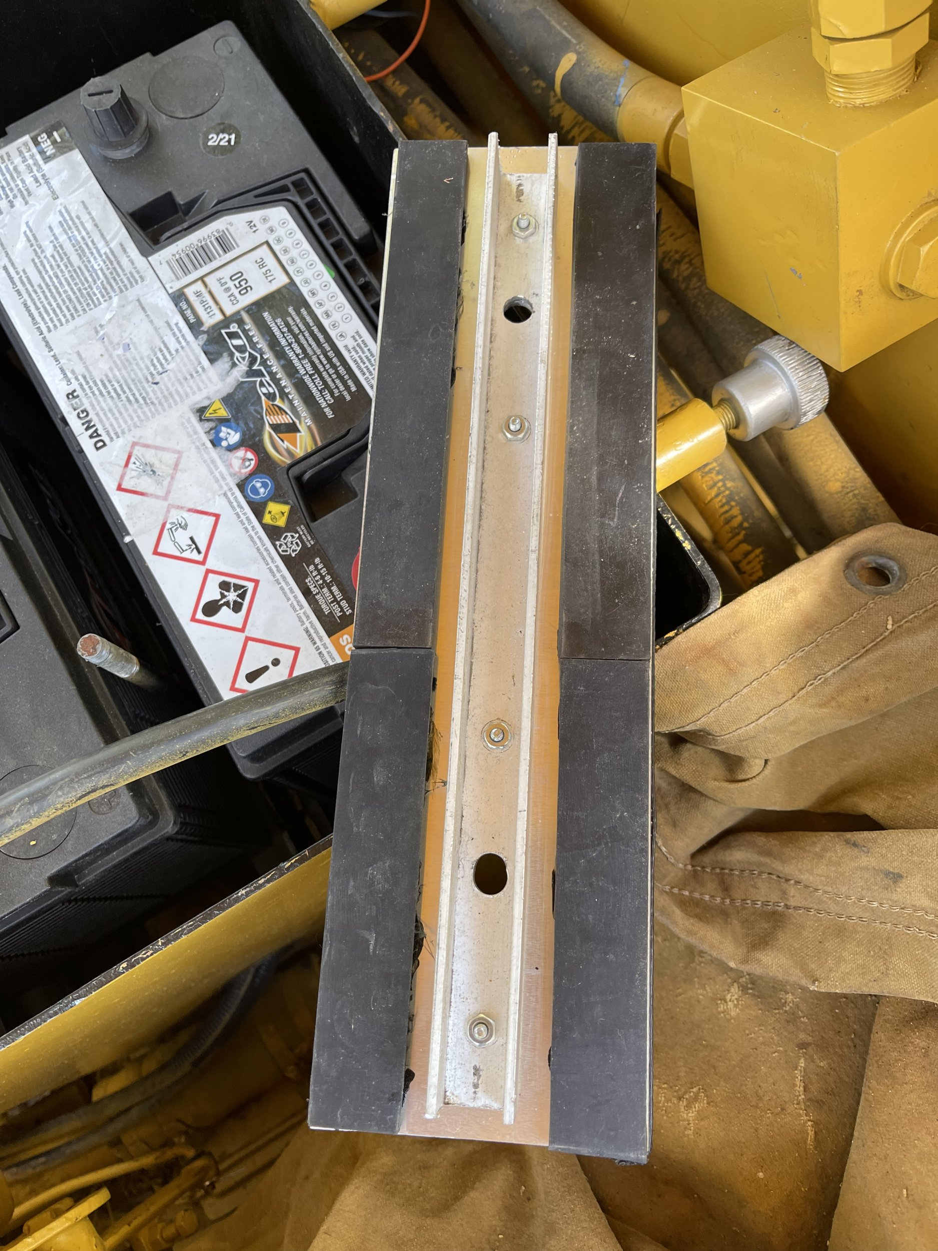

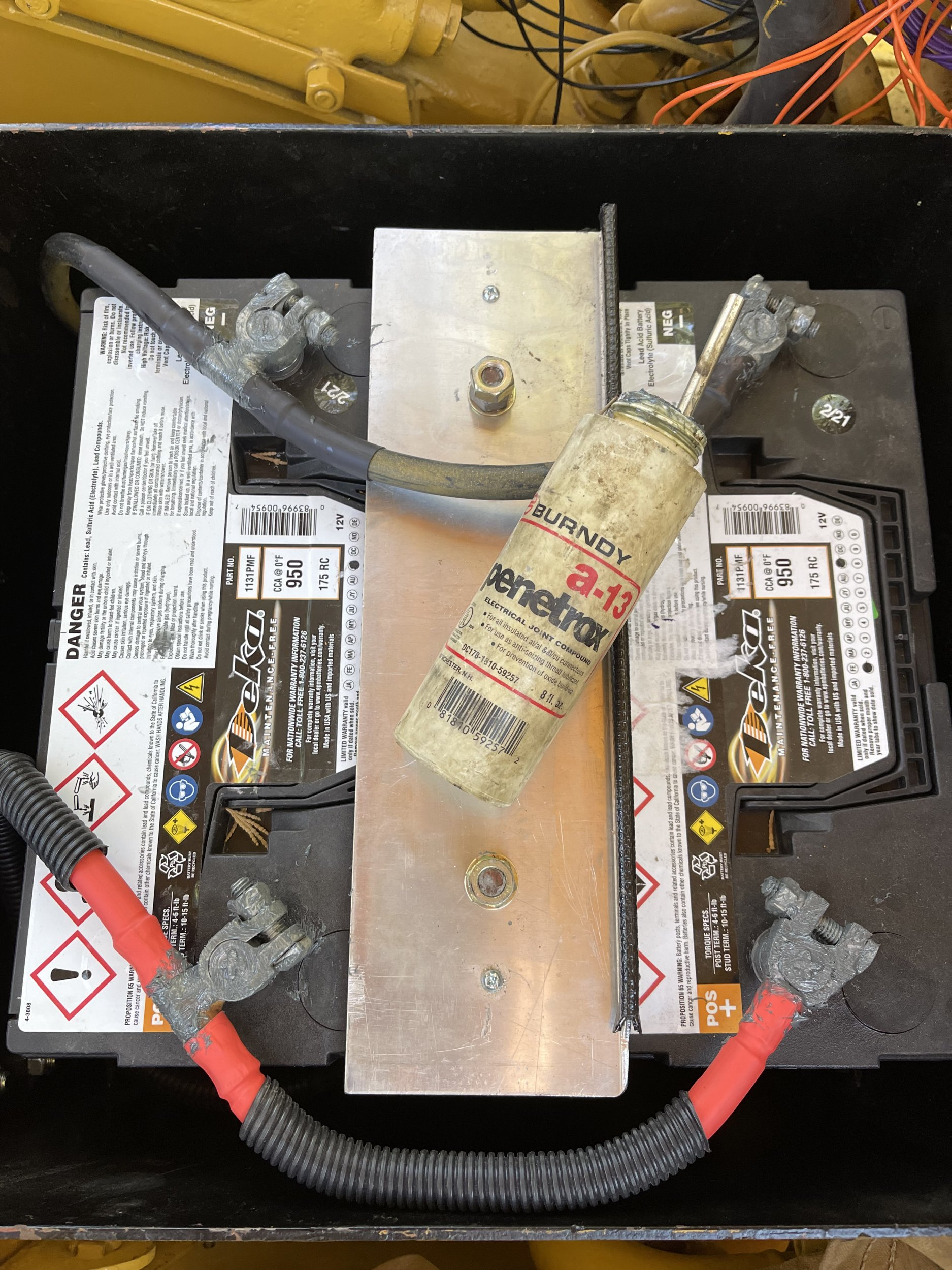

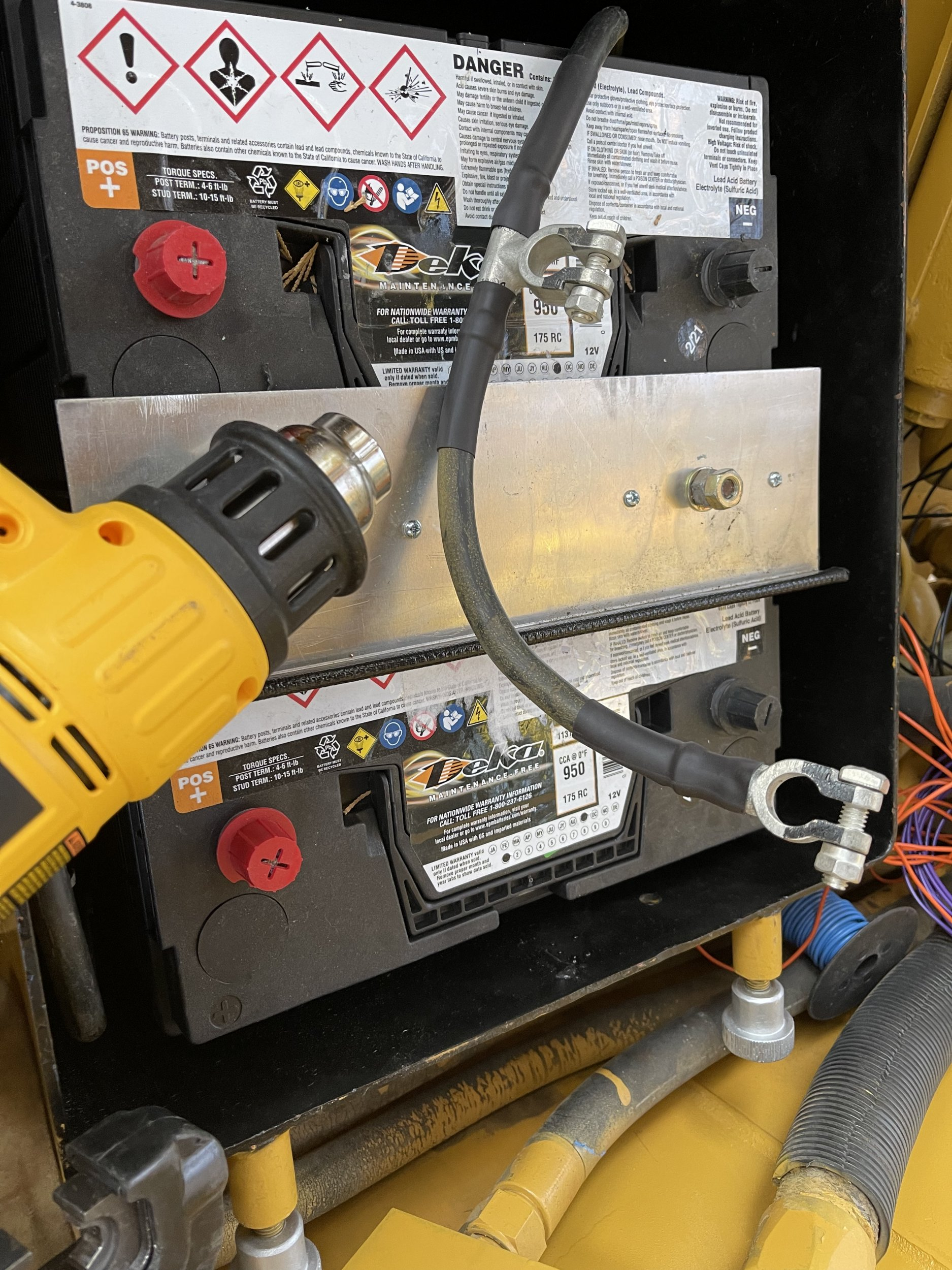

Here is my latest update, I put on the side covers after I fixed a fuel leak on the injection pump. I also did a second valve adjustment now that things are seated in a bit. I made a couple more missing covers and I included a couple pictures to show how I cheat on making bends in 10 gauge when the brake is not nearby. I finished the locking radiator cover too. Next is the floor plate, the last missing piece.

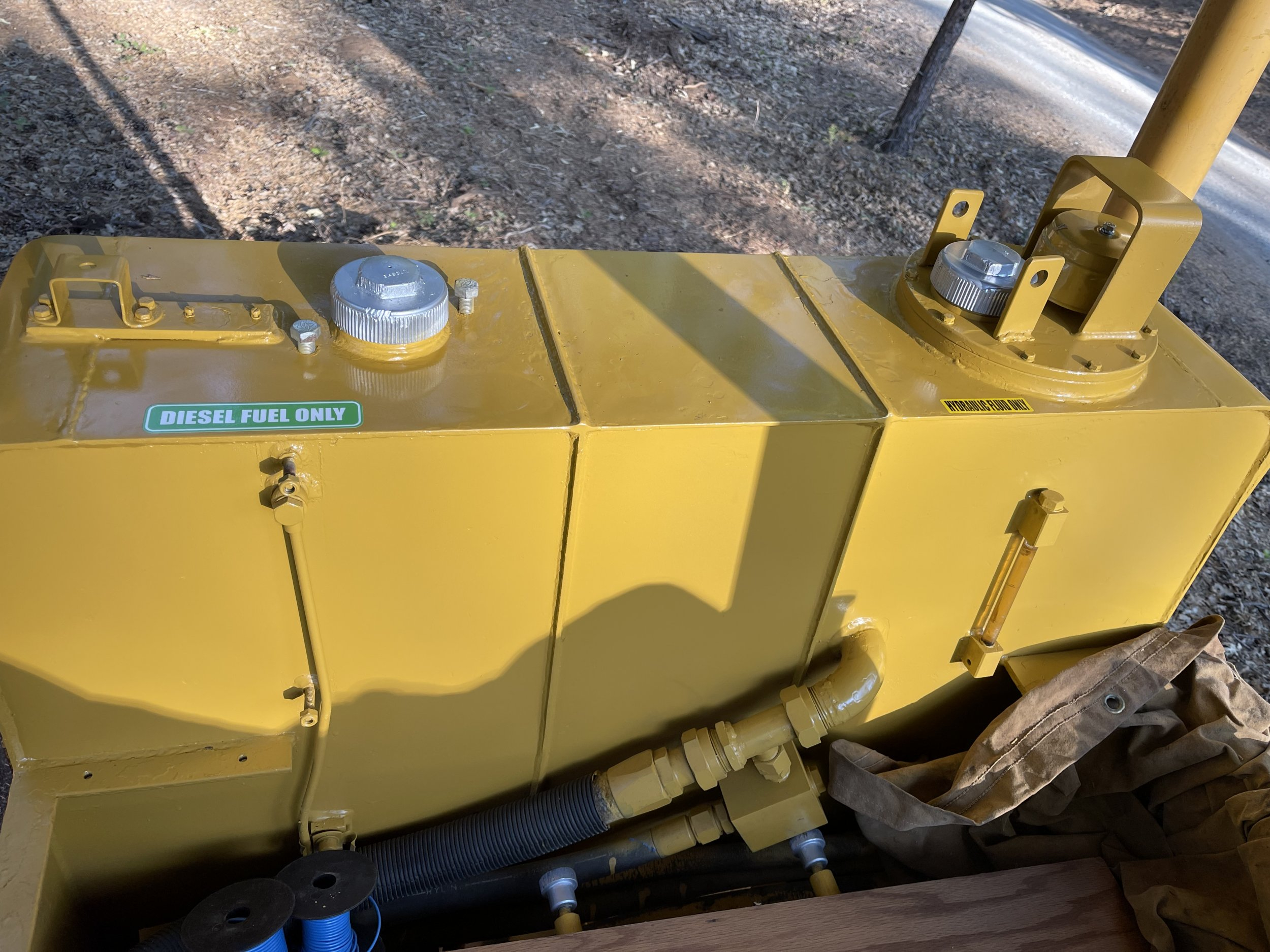

/ Another Restoration Project #99

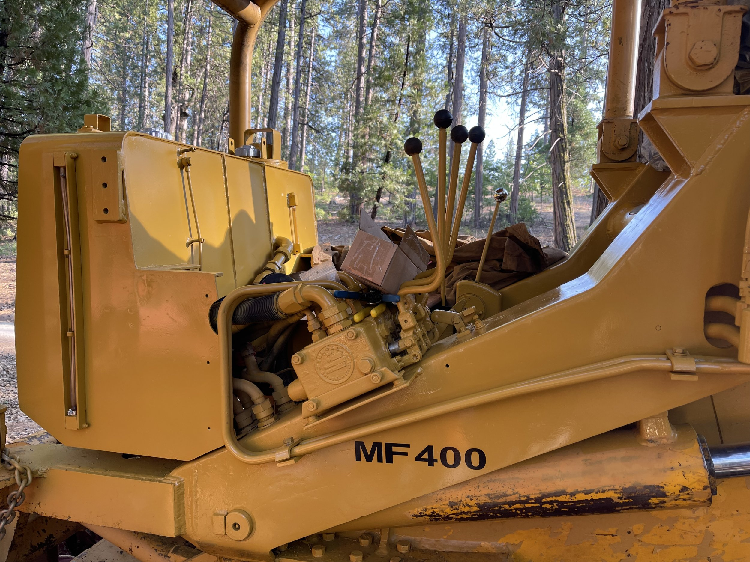

What's the tank behind the seat with the sight glass? I really like being able to see how much fluid is in a tank by looking at a tube.
#100
The side with the sight tube is Diesel, it’s a split tank with hydraulic on the other side. Sight tube on that one faces forward next to the seat.
