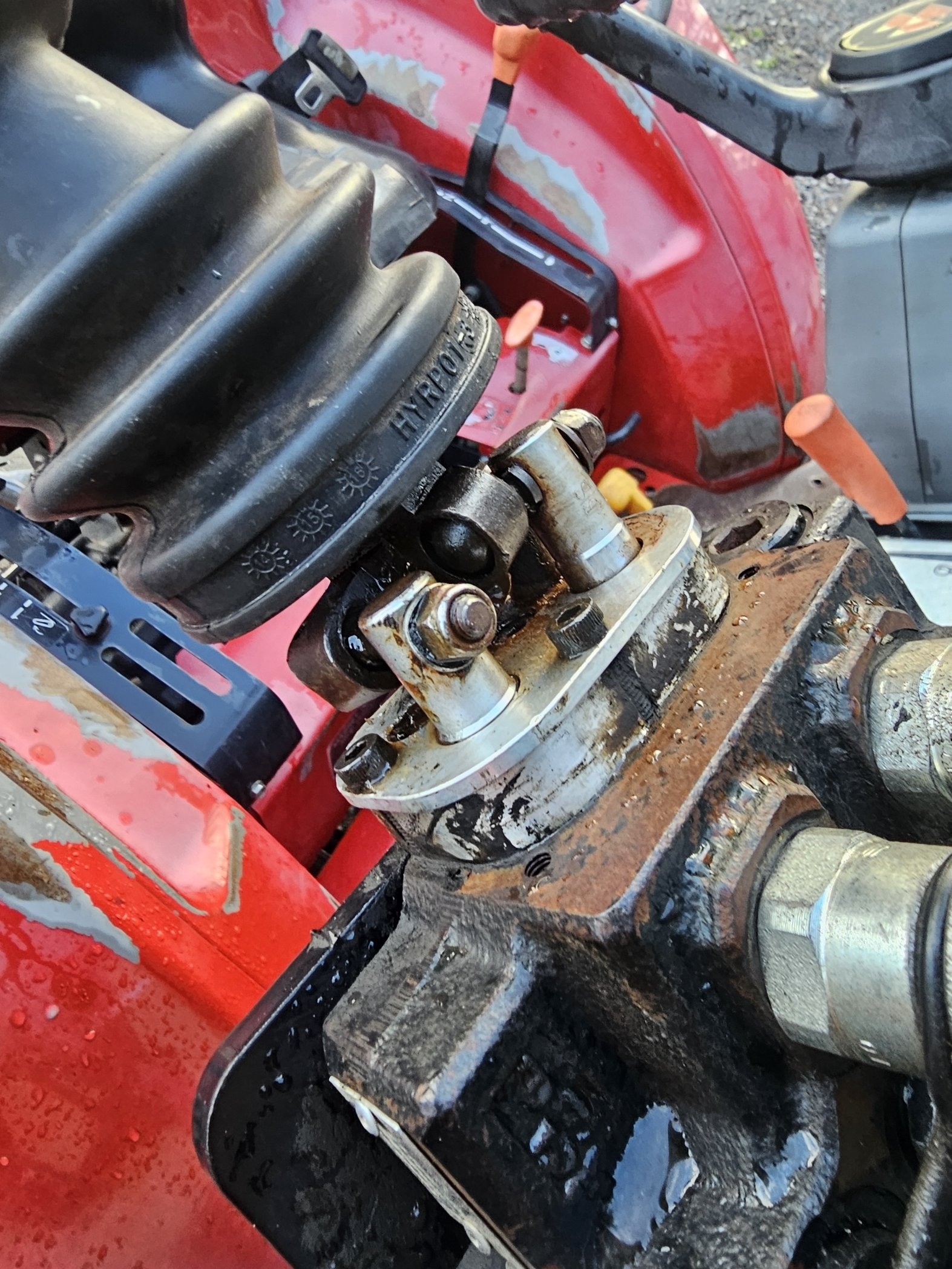

I just bought a Massey Ferguson 1734 with a L105E loader on it. The joy stick for the loader is damaged. Looks like the joy stick broke off ( maybe something fell on it) and someone tried to weld it. They did a lousy job. Anyway up and down works fine but the bucket twist jams when dumping and you need to jiggle it to get it to stop which is hit and miss. When you take the boot off you can see the valve sticks in the depressed position. (Edit to correct mistake}
The valve is a Nimco Controls 14460-2s. Can not find a cross reference for it and it looks like it is not current because I can get no hits on it and when I phoned a local distributor he could not find it.
Can this be fixed? Can I replace it with something else? Massey wants $1808 for a replacement valve which seems excessive.
Added a picture

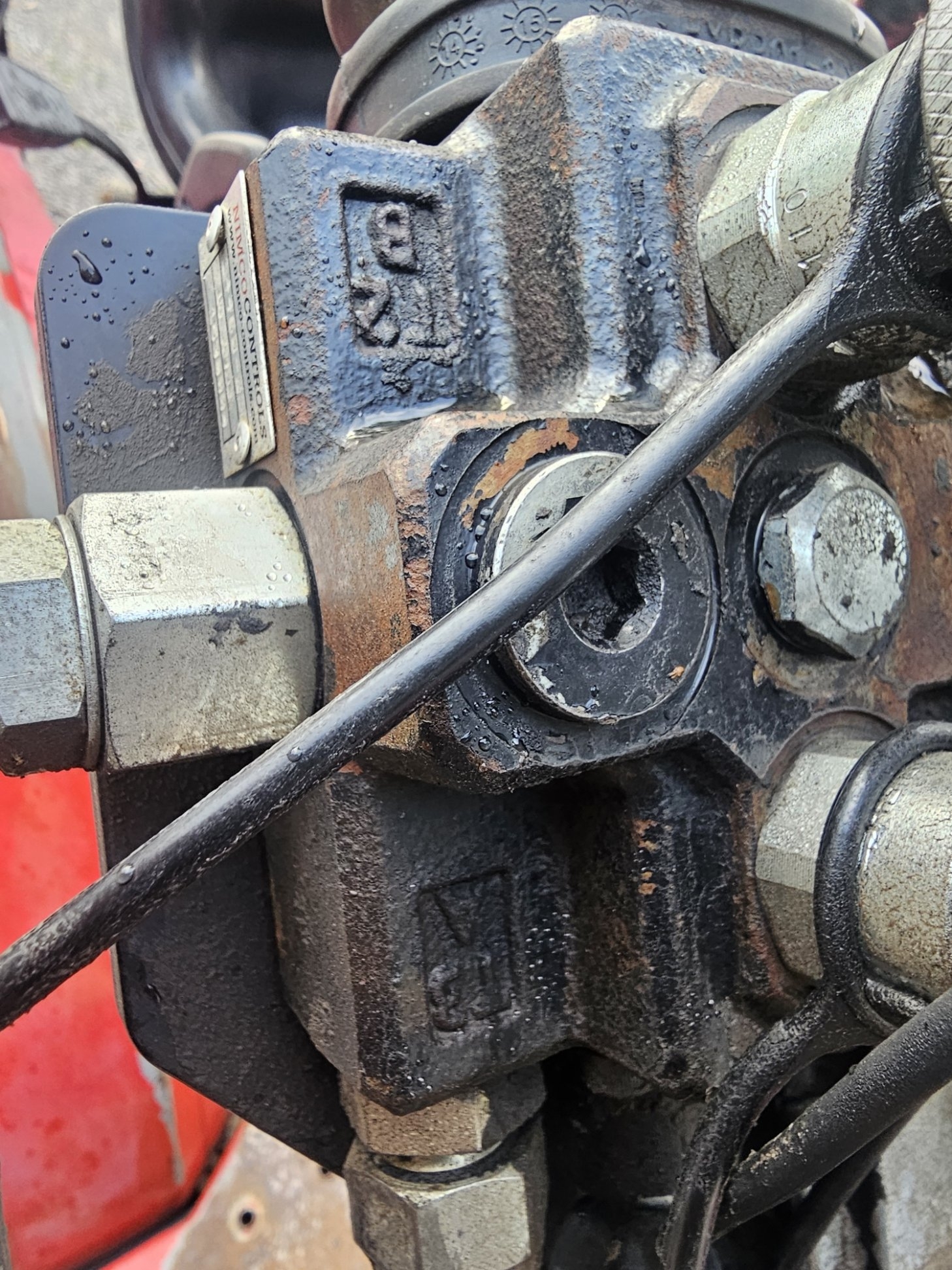

Well other than knowing what hydraulics are and the basics that anyone could pick up just looking I don't know much about these pieces of equipment. BUT I like to learn and understand and I really like DIY.
The valve has 3 connections to the pump on the tractor. 1 is labeled P3P2 and that is on one side of the valve block. This will be pump supply. On the other side of the valve block are 2 hoses, labeled T3A and T2B respectively. I believe these are the return lines back to the tank. I assume from what I have read that having 2 return lines, this valve has a float function. So if that is the case I need to get a control valve with a float function, does it matter which of the return lines is connected to which port?
Looking at the connections I would suspect they are O-ring connectors that use adaptors to JIC to connect to the hoses.

Good start. They do look like O ring ports with JIC adapters, but fittings can be deceiving. The second photo shows (probably) a power beyond sleeve and an adapter. Unless that's an elbow with a jam nut an SAE O ring fitting would not have a washer there. Three lines to the tractor indicates power beyond configuration, not necessarily a float function. A float spool will have a longer cover cap on the end than a non float spool.

I had the pictures at a local hydraulic shop. He wrote the model and serial numbers down and is going to look it up and get back to me. I took same pictures to another shop and he said the same thing as you. 3rd hose is power beyond.
I talked to one NIMCO dealer in the US and he says it is a CV112 block but that they order it as a 14460-2s. 917US + 10% US duties. Payment ahead of time and 15 weeks lead time. I guess the 1460-2s describes the internals.
I would guess that the hose coming out of T3A port is for power beyond. I know people are selling kits to use the power beyond on these tactors and they want 1100 US for them.

Looking at your first picture, just what is broken where?
It looks to me like all you may need is the pin that goes from the bottom of the joy stick into the right hand valve spool. Just replace it with a button head bolt.

The valve jams. It works but it does not return from a bucket jump

Does it jamb because the actuator is broken or is the actual spool hanging up. In your picture it looks like the actuator is binding. and the pivot pin may be bent or broken

Spool is hanging up. The valve works but when you go to twist open the bucket it sticks in that position and you need to physically pull it back to center. Up and down of loader arms is fine.
/ Replacement for a Nimco Controls 14460-2s #20
You might try loosening or even removing the cover on the back of the valve spool. It's not unheard of for the centering springs in there to get gummed up and not operate properly.
