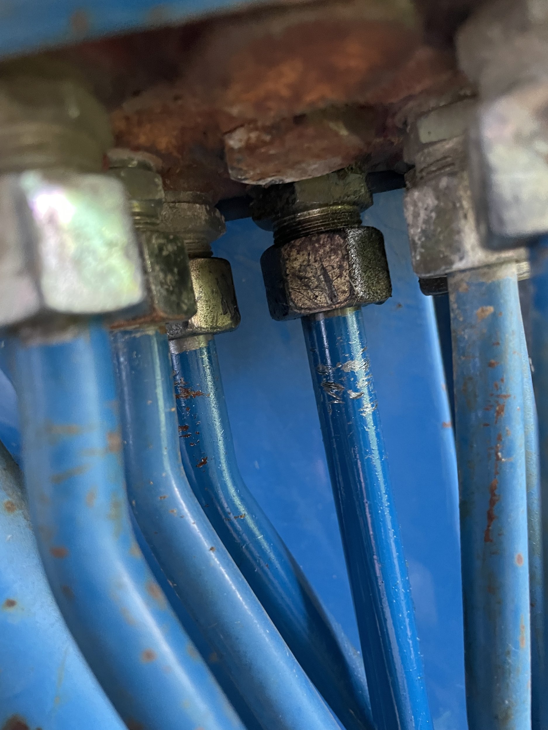

I have an hydraulic leak at one of the supply line fittings to the loader control on a NH 2120. Assume it is a JIC 37 degree flare fitting. Is it reasonable to think that I can stop this leak without having to replace the entire line (because of the flared tubing end)? Has anyone had experience in working through something like this? Pictures attached. You can see which one (or two) are leaking by the oil coating on the line. I can't get to the fittings in question without removing the smaller lines that run to the loader. So there is a risk of having further leaking problems when I go to reassemble these 4 lines as well.

Measure the OD of the tubing, they look like DIN fittings and metric tubing.
If tightening doesn’t work you will need to pull it apart and find tubing and matching fittings avail at the dealer or a good hyd shop.

Agree with wdchyd they do not look like 37 degree JIC.

Tighten it up...
Any idea of what kind of wrench is going to get in there? Seems like a whole forest of fittings and I wouldn't want to remove them all.
And that makes me wonder why one would start leaking... I had a leak like that once, and thought I'd never find it. It turned out to be microscopic lengthwise split in the compression nut that didn't open up until it was torqued down.

Thanks for the input everyone. Tube does appear to be metric. Measured OD at .5925" (15mm).
27mm line wrench is on order. Will try to tighten and let you know what I find out.

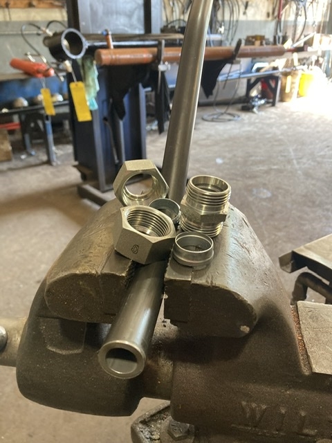

If DIN they will look like this.
Although this tubing is larger (22 x 3.0mm)

Thank you wdchyd. I share your concerns about over tightening. I believe that these fittings are meant to seal with with a specific number of turns. Not sure if that applies only to first install or also to re-install. Thanks also for the picture. Helps to verify type of connector. So am I correct that the DIN connection does not utilize a flared end on tube? If that is the case, and there is no damage to the tube, can I simply replace the nut and ferrules? Alternately, if there is damage to the tube, can I cut the tube and join a new short length of tube using a union connector instead of replacing the entire (custom bent) tube?

You won't know until you get one removed. Heck, they could have welded or swaged ORFS inserts in the ends of each tube for all you know, easily fixed with a new o-ring. Pull a line off and have a look!
BTW, I've never seen a 15mm line size, not that I've seen everything. But metric line would usually skip from 12mm to 16mm, at least in most systems I've seen.

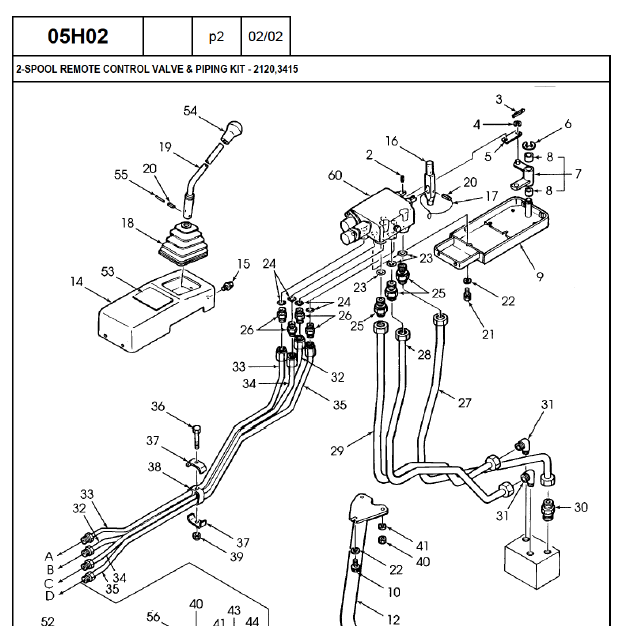

I have the parts catalog for the tractor but unfortunately, the description is next to useless. Parts 27,28,and 29 are the tubes in question. Description is "Pipe-Oil" NH website offers no additional information. Same for Messicks
Actually, that picture might be useful. Items 23 and 24 appear to be o-rings, yet it appears the fittings on your unit have pipe dope on those threads. Pipe dope should never be used on an ORFS fitting, perhaps indicating a prior owner re-assembled with bad or missing o-rings, and tried to incorrectly repair the resulting leak with dope?

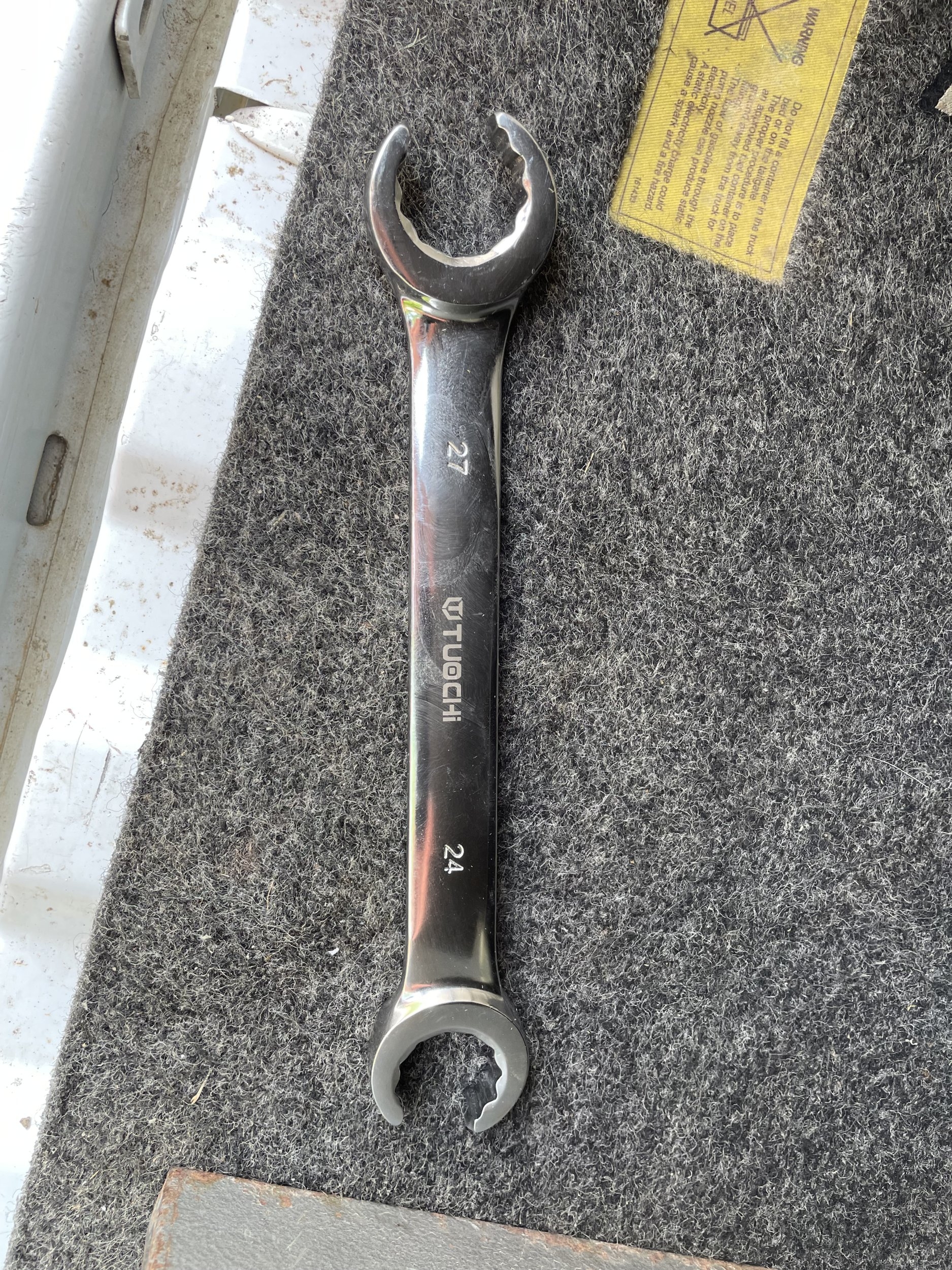

What type of line wrench have you got coming? I’ve been looking at a set of Milton Shockit line wrench sets you use with a air impact hammer or a hammer and punch in a pinch. They look like they’d be the ticket in that exact situation

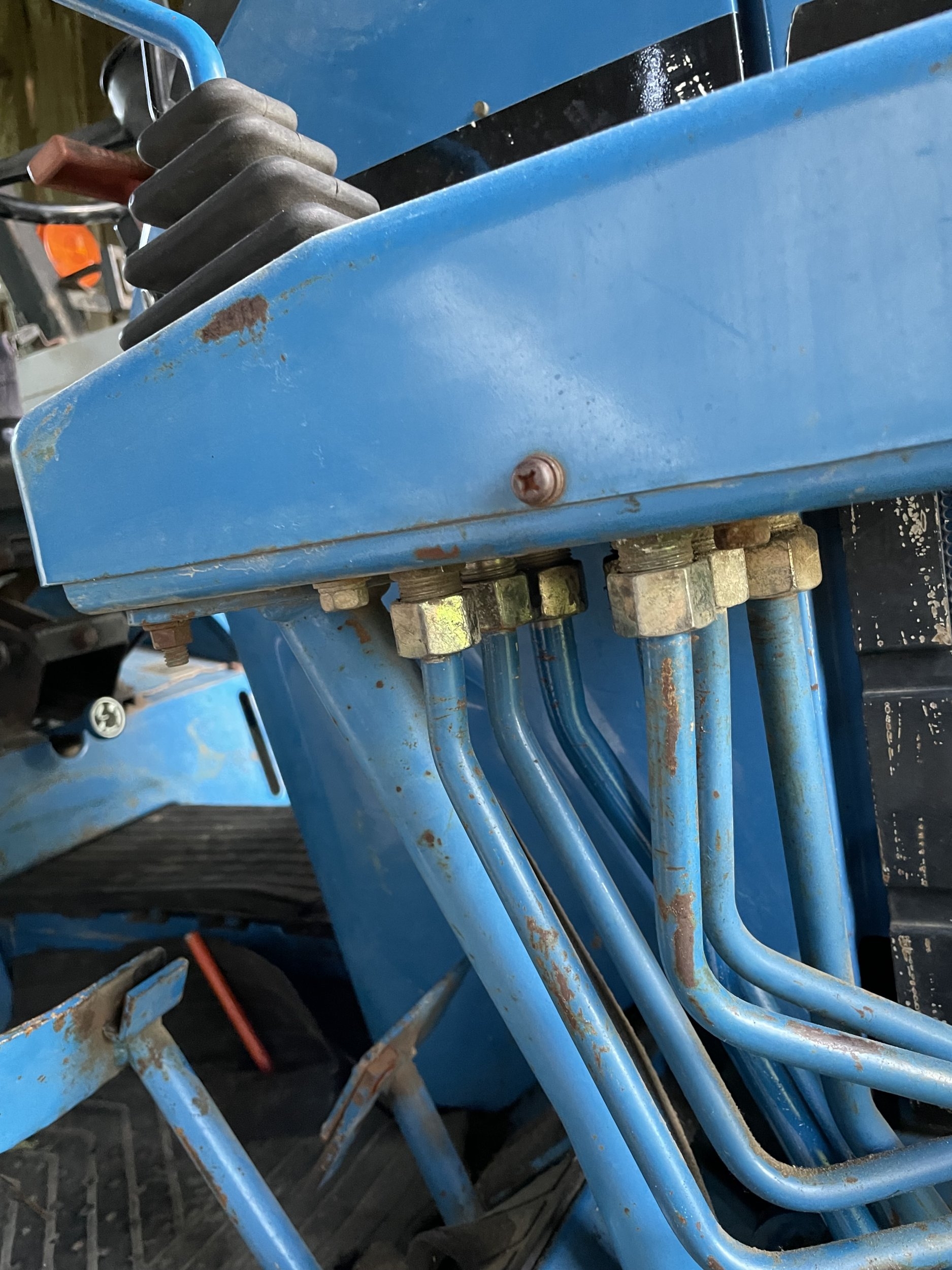

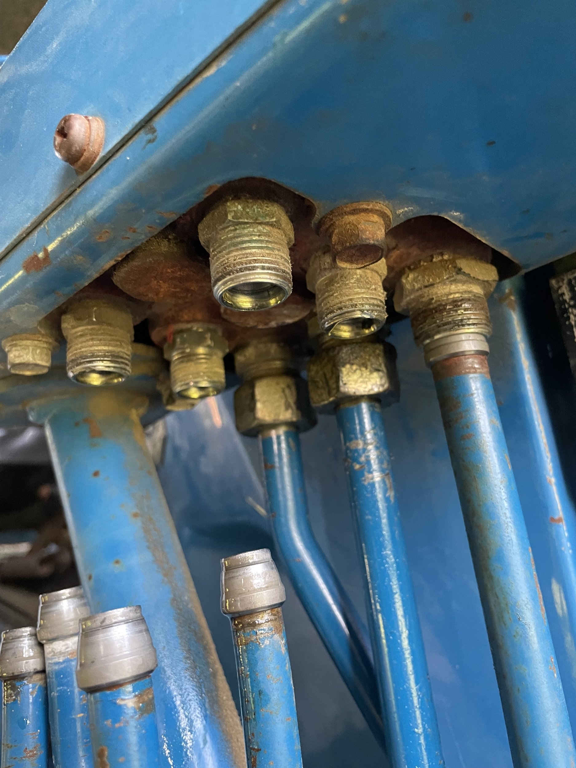

Well, I got the line to stop leaking (at least for now). Had to pull all four of the 12mm front lines and one of the 15mm lines to get to the one leaking. Confirmed that they are DIN fittings. The 27mm line wrench (sometimes called a flare nut wrench) was essential to tighten the leaking fitting. I put about a 1/8th turn on it and then tested it before wrenching any harder. It worked. There could have been work done by a previous owner. Hoping I don't have to do a repeat performance soon but thanks to the input from everyone on this thread, I feel much more confident in tackling it next time. Picture attached for wrench reference. Amazon purchase ($17).
