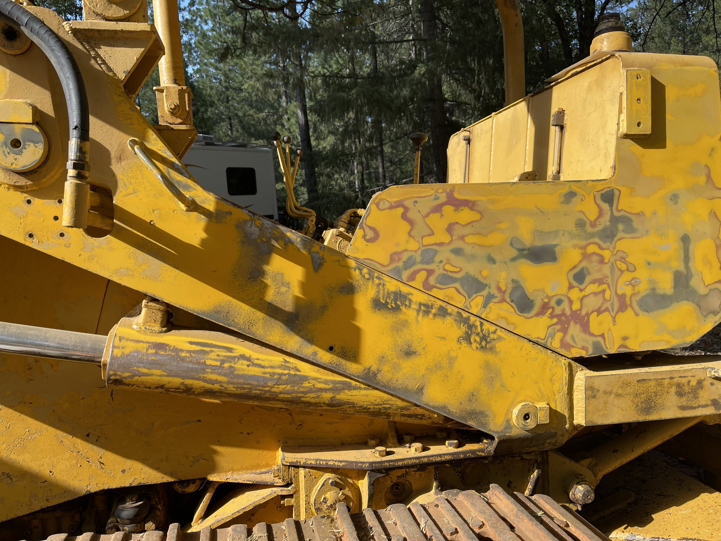

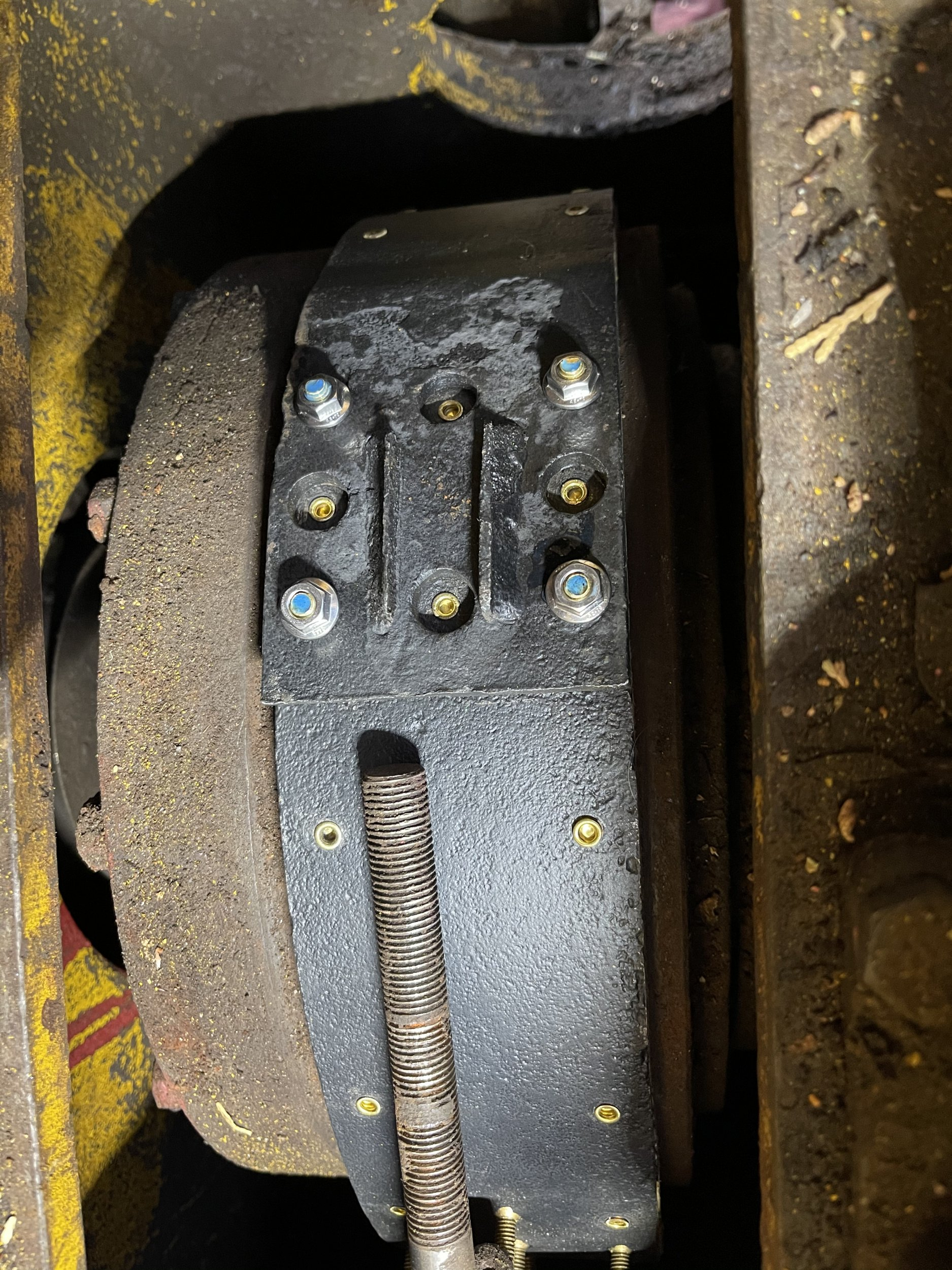

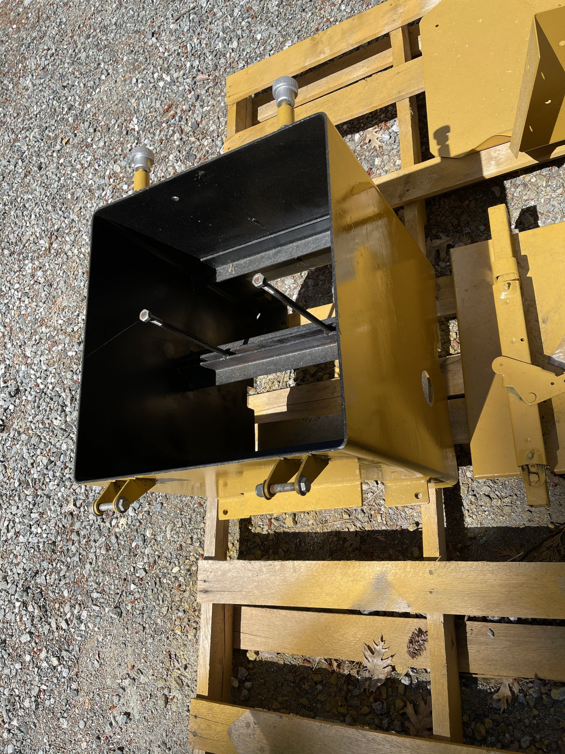

Here is a small update. I finished the paint job except for the hood, side panels, and grill that I am working on. I also glued the “D” ring on the bucket. I removed the clam cylinders for access to painting the bucket and to rebuild them. I am stitching up the upholstery also. I am also making new pins for the clam cylinders.

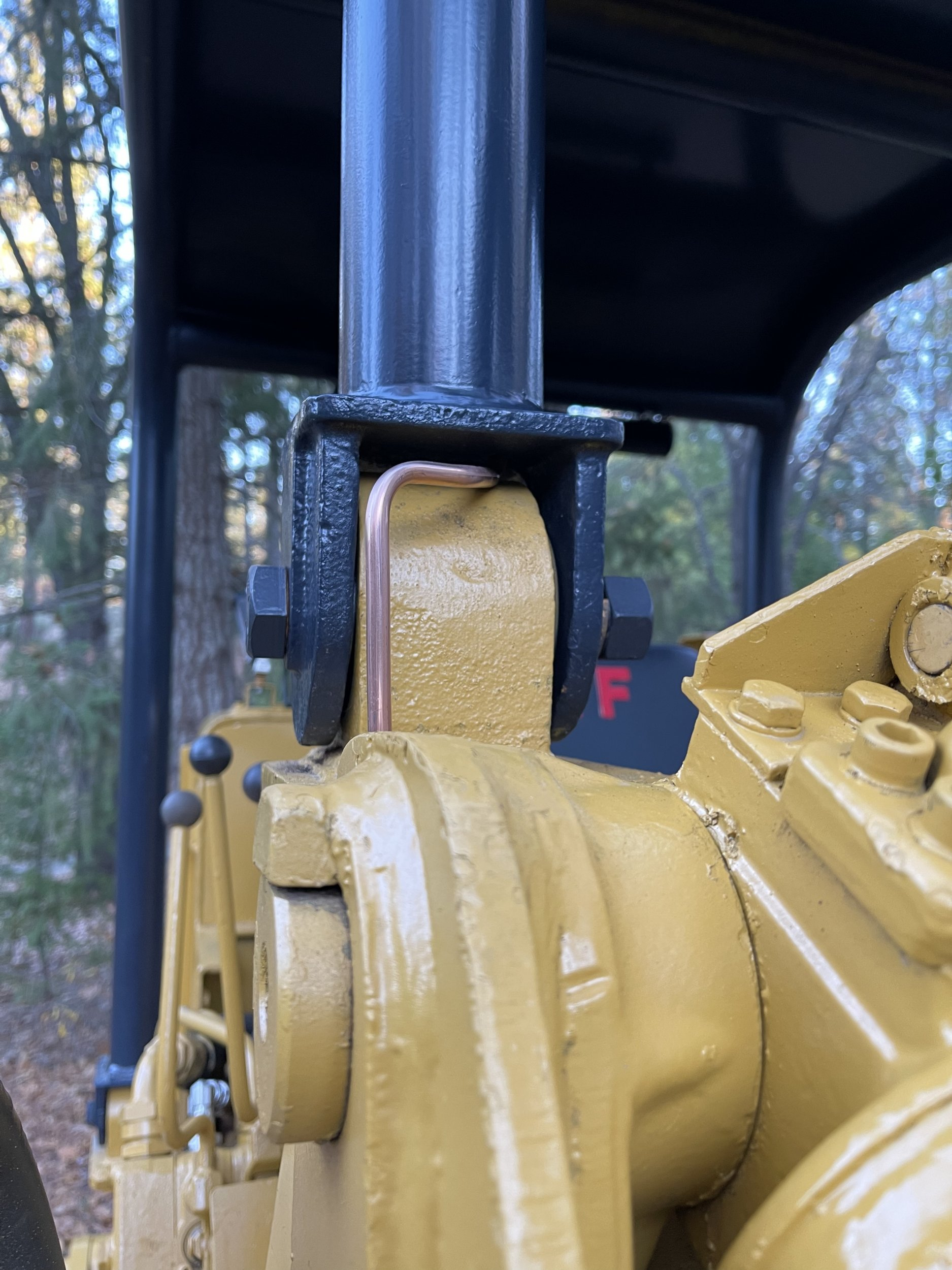

Another small update. Got busy on the seats and the lights. I ran the wires through some copper coated steel tubing for protection. I also made the backrest 4” higher than original and added the letters to make it run better. I also used a higher density foam in the seat than the backrest.
