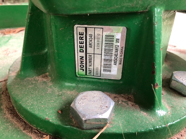

So you guys really haven't found a box that will just mount back up on the JDMX6 cutter? I have the same issue, cutter has less than 100 hours easily. I priced JD and that's not going to happen and I found the same gearboxes at the Green Part Store for the exact gear box for 891.00 and a new version of that gear box for 891.00. My issue is I dont want to put this kind of money in something that I don't even know if the casting problem was fixed. I did find the shaft kit on ebay and that vendor told me he had sold over 1000 of these kits to fix the MX models. JD has not responded to me at all on this matter but you would think they would want to at least admit there is a problem. I will most likely buy a USED bush hog that looks like it want last because those usually last forever.
From your pictures, I see you have the made in China gear box. I thought only the made in Spain gear boxes were the problem MX mowers. Now I know there are not any "immune" from failure MX mowers.
How can you tell?

Post #158, picture 3, the tag says "Made in China". The made in Spain gear boxes have "Spain" cast on the gear box.
I couldn’t see it on my phone sorry

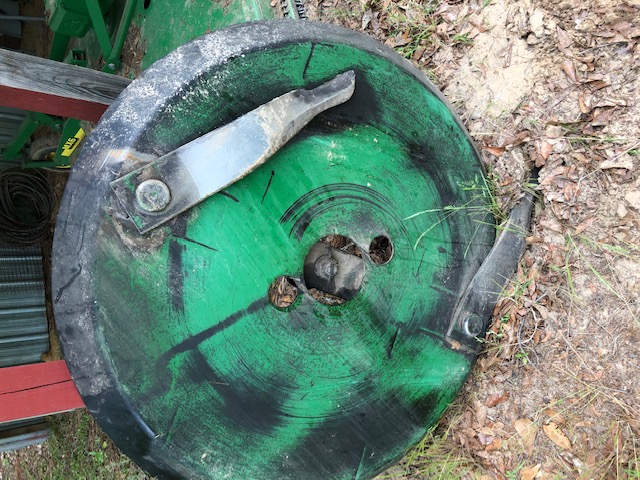

I hate to revive this post. I was aware.of the problem. And hoped.I was immune. I was cutting overgrown dog fennel and ragweed. The pics is after I flipped it over in the dirt, other wise it all would have been clean metal. Broke below and above the c-clip groove. I'm looking for a solution that doesn't include John Deere. It's an older model, but I haven't put more than 50 hours on it, granted some of them hard hours but slip it h was always properly adjusted, even on the loose side because those replacement disks are a lot cheaper than a gearbox. It looked brand new when I bought it. serial# W00mx6x017219
I broke one of these a few years back. That had a made in Spain gearbox which is supposed to be the better of the two. I think the other box is made in China or Mexico. I also bought one of those MX6 decks with a broken shaft in it. I found a replacement for it on EBay. I sold that one and bought the made in Spain deck only to shear the shaft just like yours a few months later. I replaced that one with another new gear set from Ebay. That was a few years back. So far it has been good. Looking at your shaft, that has been cracked for awhile and worked itself back and forth until the very center oval area let go. Look on Ebay for a new gear set. I read about another gearbox that can be fitted to work on these mowers. It will take modifications. I believe the entire box is cheaper than a gear set. Just Google MX6 gearbox substitute or replacement.
I replaced the shaft, but by the time got parts and got it all back together was told could have purchased a new aftermarket gear box for less. So far has had no issues after several years of use.
