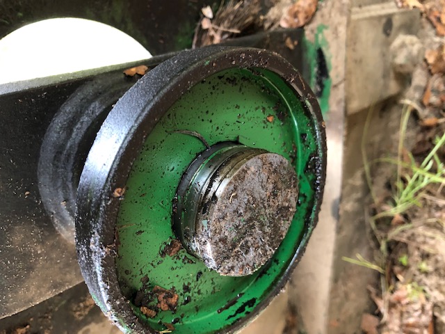

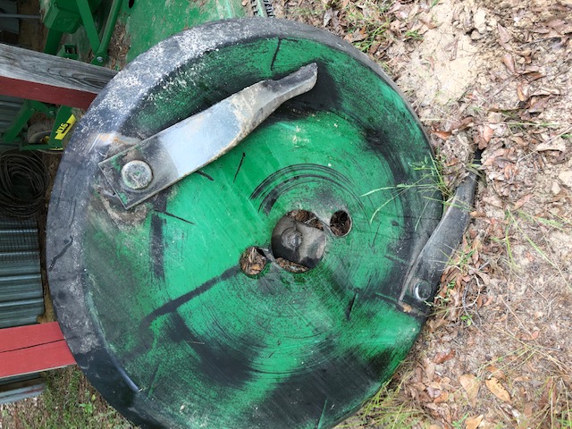

Right at the snap ring--predictably failing for the better part of a decade now, with ZERO support, but they still manage to sell them. Comer is still making the same box with the bolt pattern shifted--so as not to be a direct replacement for Deere's. The company strategy seems to have shifted to entrapment from brand loyalty--what with the proprietary software and made only to fit part vendor requirements.
I picked up a Comer LF227J. The lower casting is the same mold, the upper box and gearworks are significantly heavier--rated for 150 hp vs 90, still 1.69 ratio, but required a lot of work to do. Being told by the dealer my best option was buying a new unit instead of the new gearbox and stumpjumper (2.5k vs 1.5K plus shop time)... I bought a MIG welder, gearbox and driveline instead... now the **** thing looks like a cat on a roller skate, and no more green attachments will ever go to this former customer. If these were Pintos--someone would have been in court--possibly jailed by now... Thank you for reminding me how little regard this massive company has for its smallest customers.

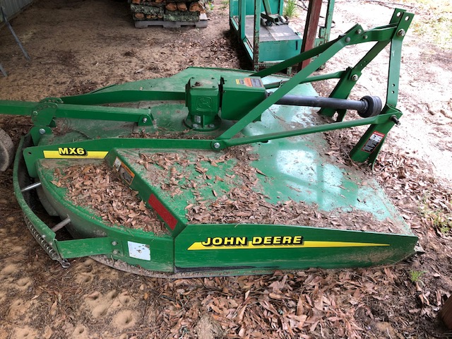

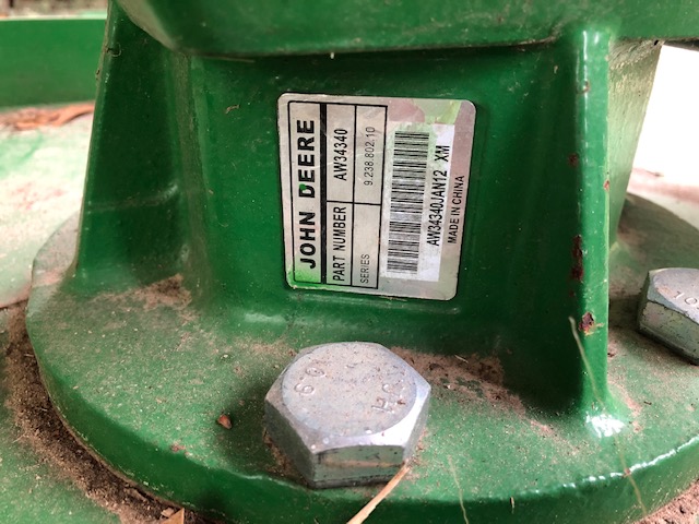

Thanks for heads up. I looked up the part on JD Parts and see there appears to be two different versions of the Bevel Gear. I believe mine is the Spanish version. If I can replace the broken part and get another 14 years out of it I will be better off repairing.
JD is probably twice the price of what I paid for my gear shaft. There should be a tag on your gearbox stating where it is made. From what I recall my top gear slid over the sahft on the China made box. I think the made in Spain box was one piece. I'd have to look at the parts again to be sure.

My gear box is a DE19104. If I understand correctly I will still have to dig into the gear box to see if is a DE19106 13 Tooth or DE19304 15 Tooth. Once know for sure, should be able to replace just the Bevel Gear and possibly the related bearing, shim, snap ring, seal and cap hat if none of it is salvageable. Sound about right?

Was able to get gear box off of cutter and take a look in box. Counted 13 teeth on lower gear so that would clear up which gear is needed. Never attempted a project like this and pending cost may be better to replace. Any videos or guides on how these pieces come apart? Looks like there is still a piece to separate on the stump jumper. IMG_7417.JPG

Found the parts and got them ordered this morning. Will update as the repair progresses.
/ Another MX6 Brush Hog Failure #151
Picked up cutter this morning. Got to mow with it this afternoon for couple hours. So far so good. The gentleman helping work on it was a little concerned with the fit and tolerances on the gears, but seems to be running ok.
Wound up finding output shaft gear and input gear for around $500 on eBay, had to order shim kit from JD for around $100 as gears were binding without them and paid gentleman helping $200 for his efforts. $800 an back working. If had it to do over, probably would purchase a new gearbox and just replace old one. Repair guy does a lot of work replacing decking and gearboxes on cutters and brought up good point could have had a new box with new gears, bearings, seals, etc... for what I spent on the gears. If this set runs another 14 years I will be satisfied and will just replace the gear box.
