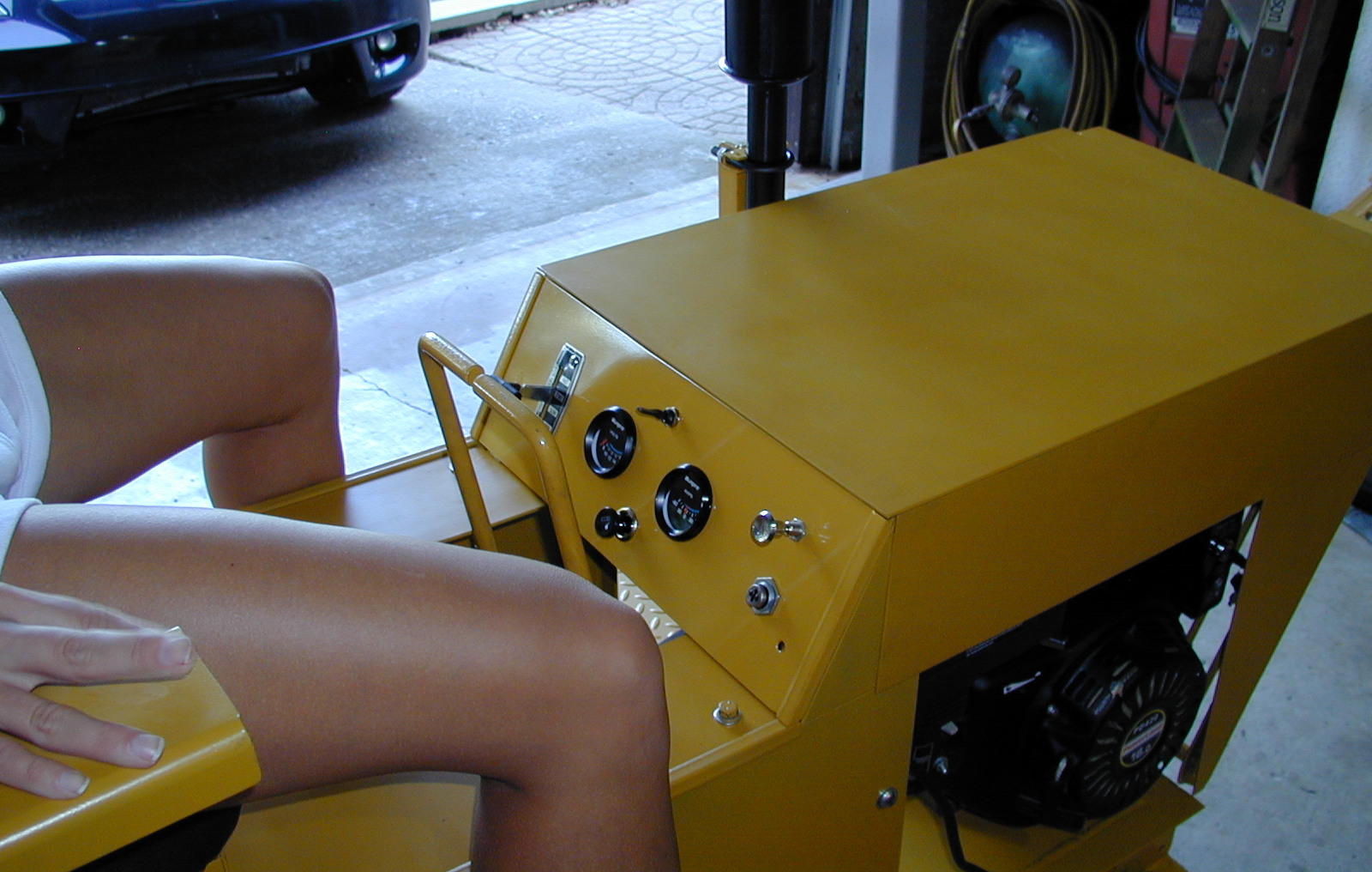

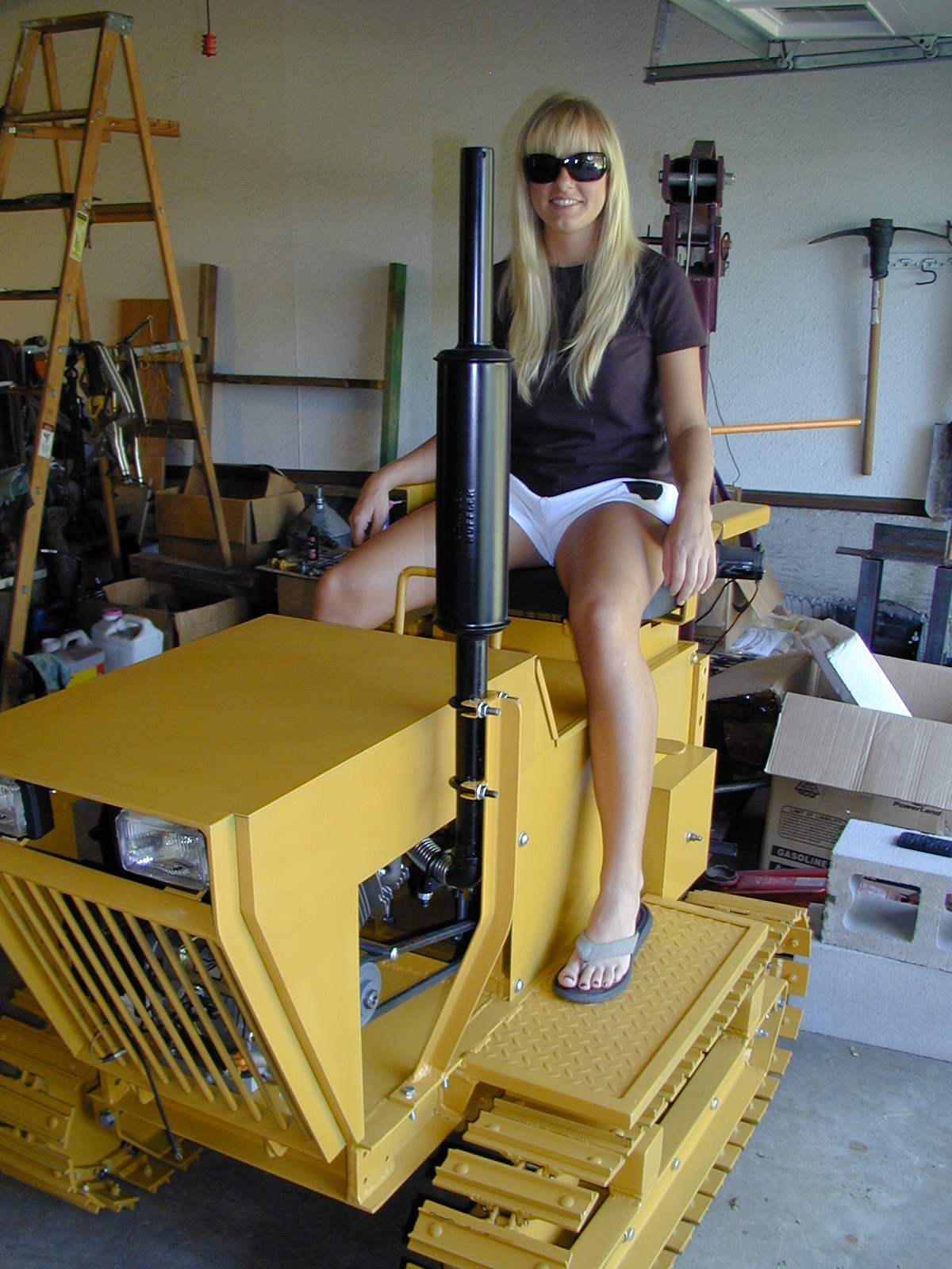

Just a few days away from taking it out for a spin ! I plan on putting it up on blocks and running it so that I can observe all the moving parts. Maybe I can catch a small problem before it becomes a big one. Does anyone have any experience with track tension ? Advice would be appreciated ! I don't have a video camera but hope to get one for my birthday on November the 8th ! Any advice on what inexpensive camera I can buy so that a video can be posted on "You Tube", would also be appreciated !
Also, I need more tutoring on listing multiple quotes. I don't see the check mark on the lower right hand corner that can be toggled on and off ! I guess it's just some of my Polish heritage shining thru :eek:. I had a comment for the fellow who implied that the multiple belt driven units were problematic and became obsolete when the transaxle units were introduced. I did some research and found that when the hydraulic driven units came out in the 1990's, the transaxle units became obsolete. Struck re-introduced the belt driven design in 2002 to sell as their least expensive machine and today markets the all-belt "RS1000" along with their hydraulic driven units. :confused:
One of my daughters stopped by for a visit yesterday afternoon and I asked her if she would like to pose for a photo shoot on my latest project. The results are below...

...One of my daughters stopped by for a visit yesterday afternoon and I asked her if she would like to pose for a photo shoot on my latest project. The results are below...
Seems very well proportioned (speaking of the dozer, of course).

It looks like the control levers might be a little on the short side, you might be hunched over while operating. Have you tested it for comfort?

Have you thought about a belt guard on that primary belt?
..So that wasnt the photoshoot for the commercial sales brochure... ;)
