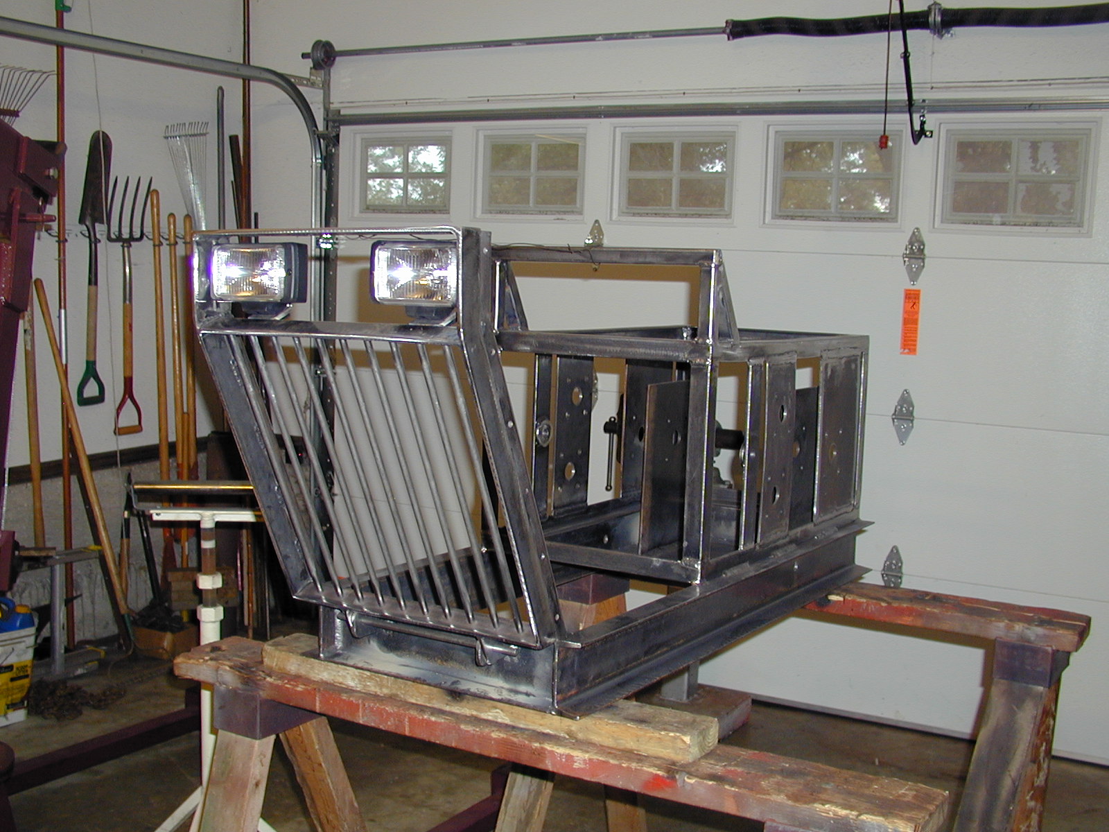

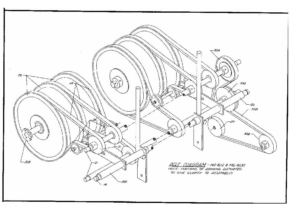

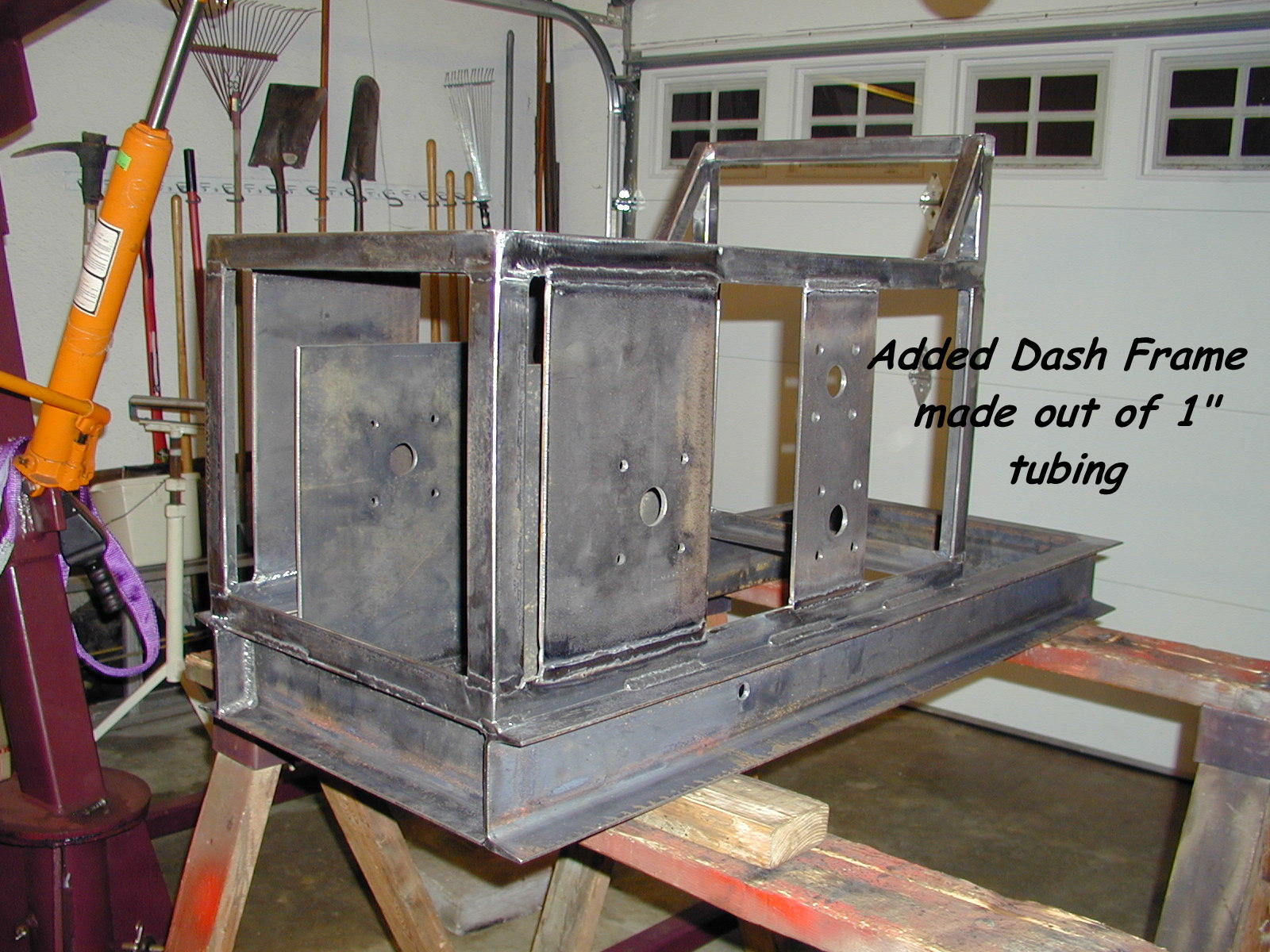

I decided to build a mini-dozer utilizing the old Struck belt & pulley transmission design and building the body and track from my own design.

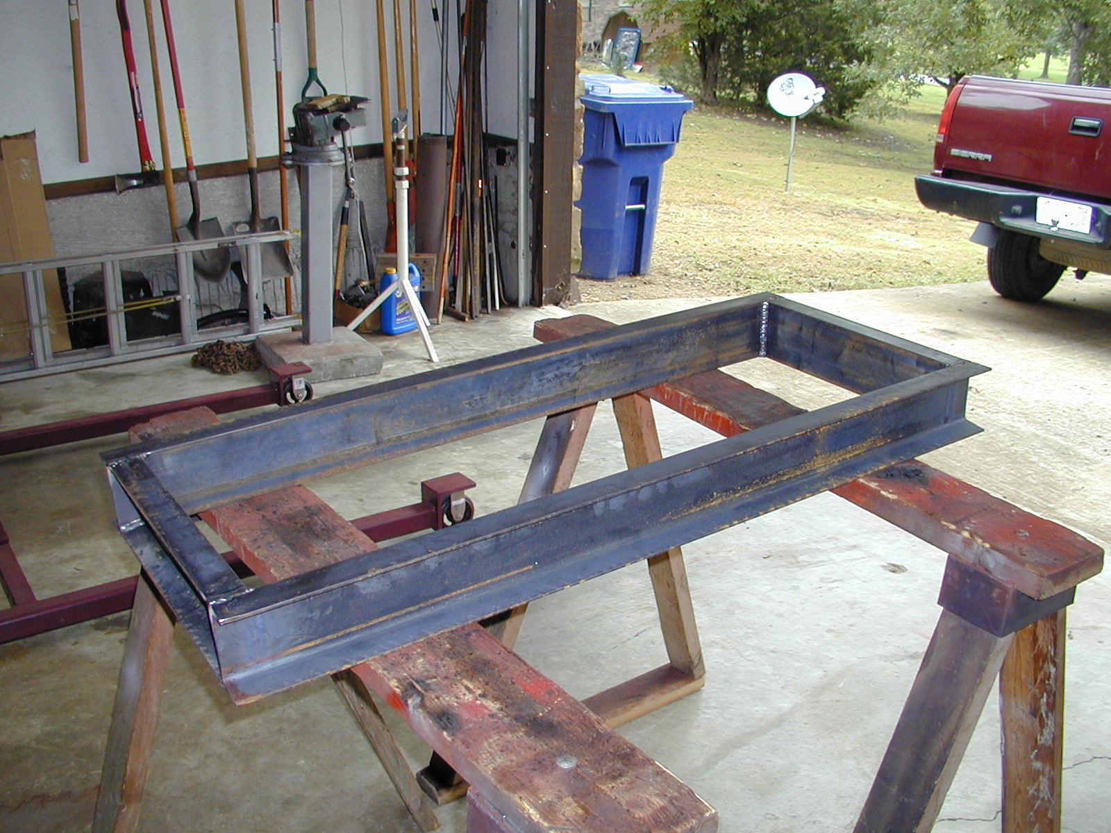

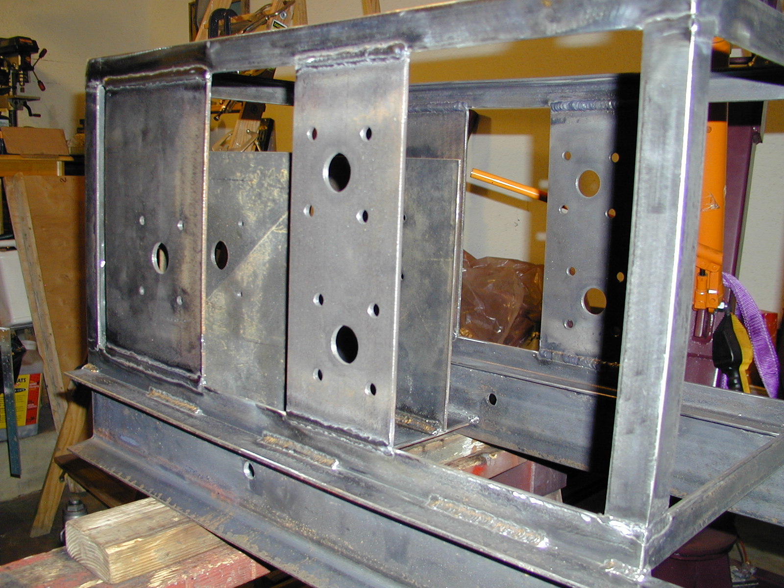

I started from scratch making a frame from 4" channel and 1.25"x3/16" angle.
I framed a dash board from 1" square tubing and a grill from 1/2" rods and 2"x1/4" bar stock. I added bearing supports from 3/16" plate.

Whoa, don't drop that on your foot! Looks like something that could do some real work.

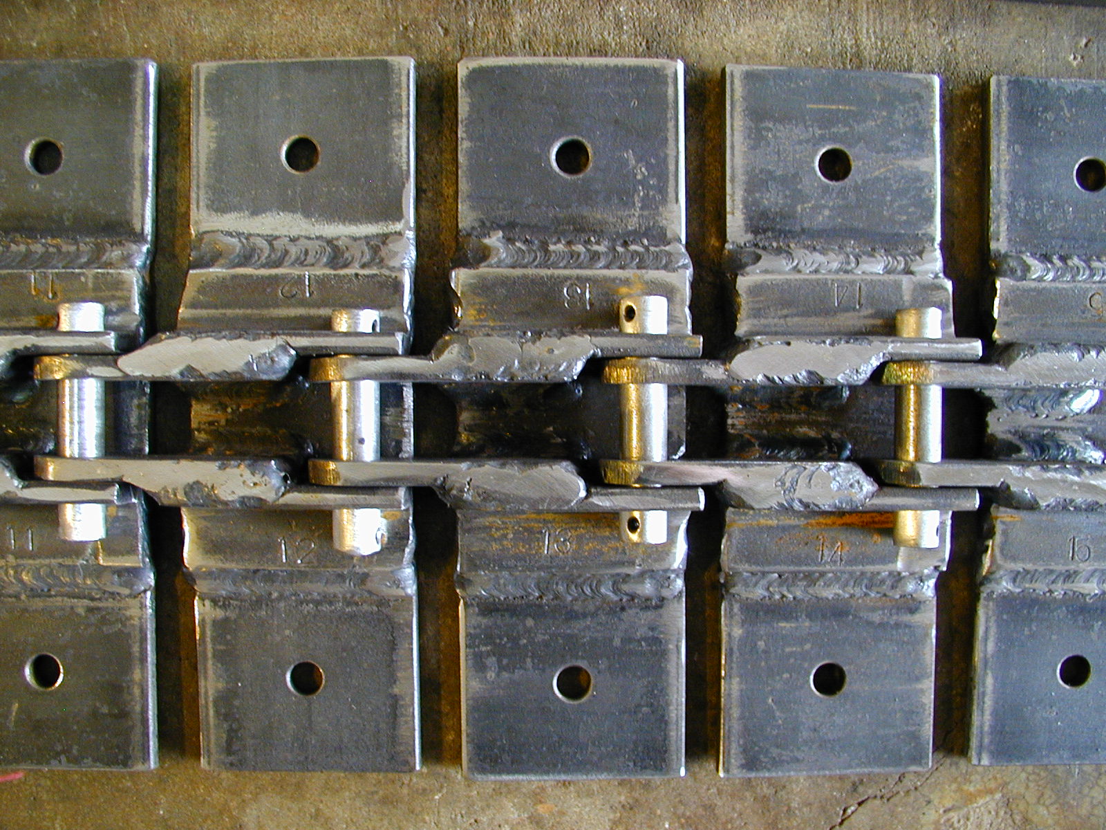

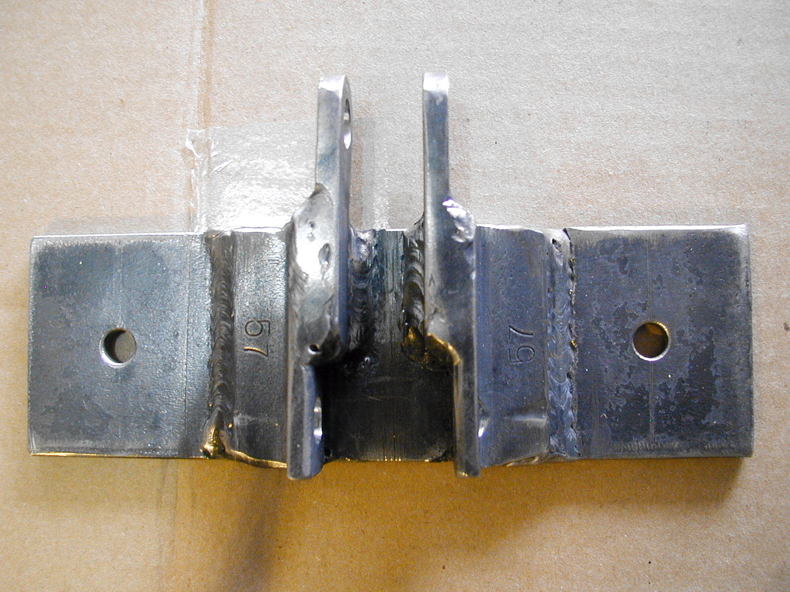

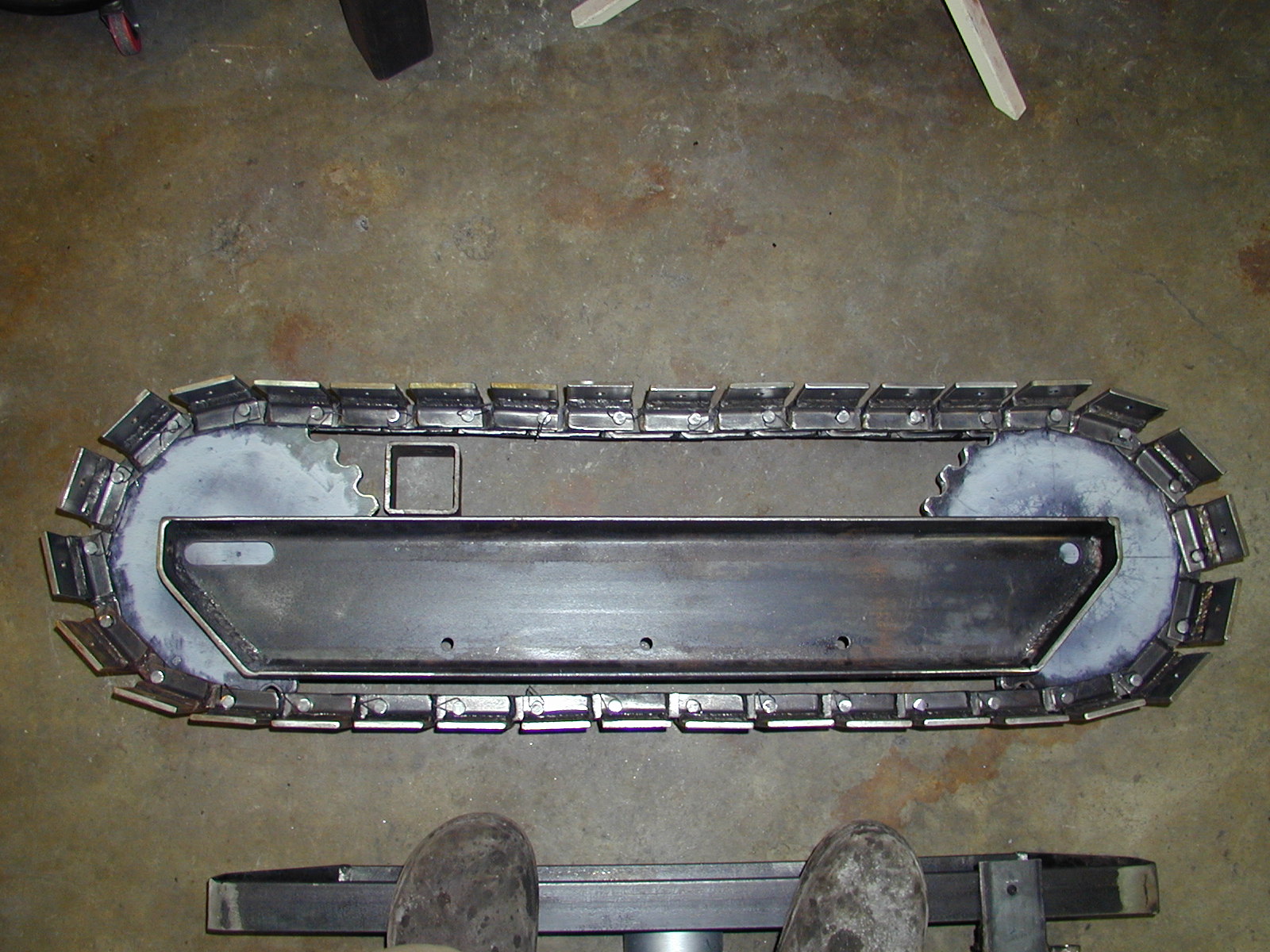

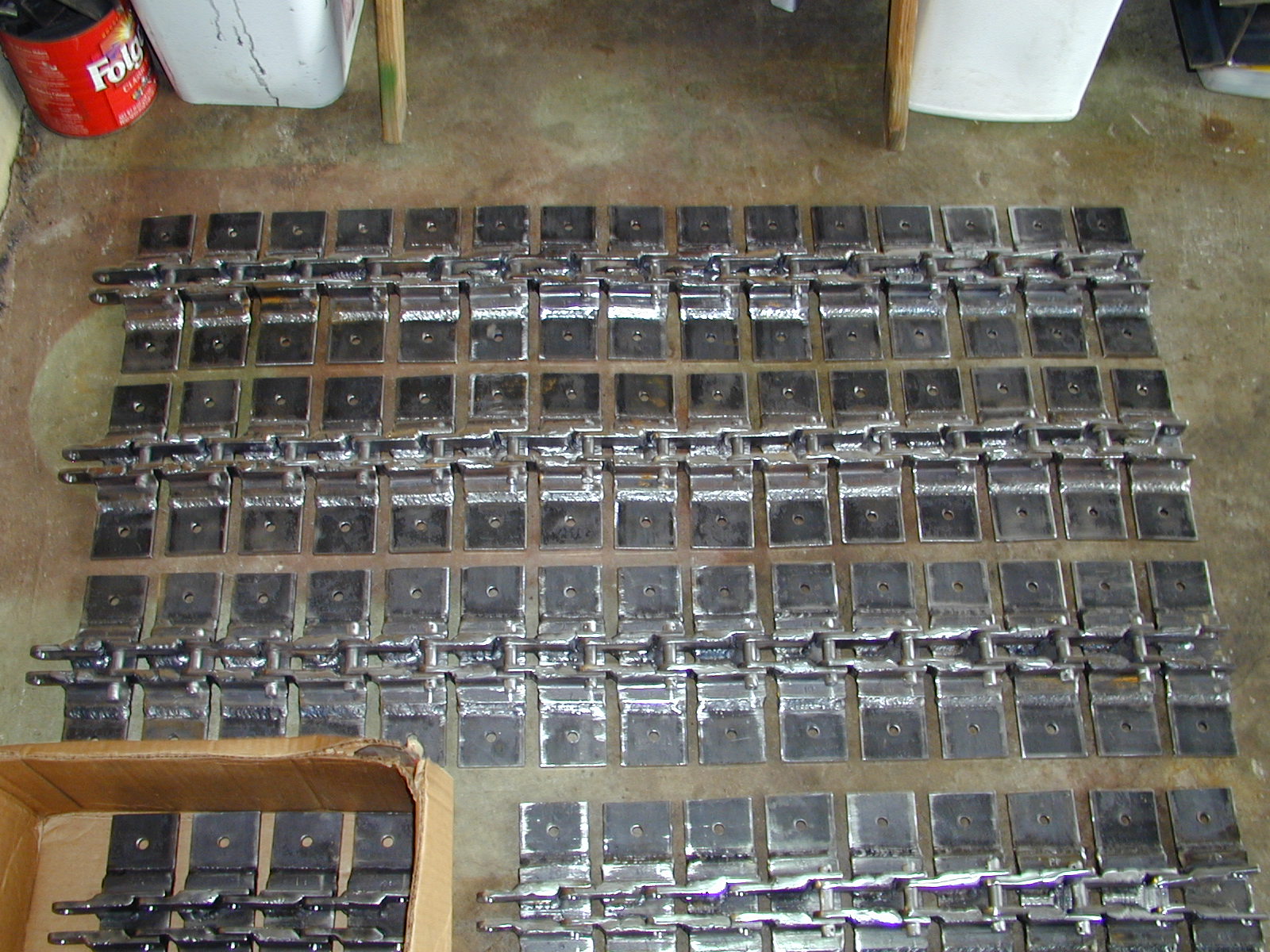

I am working on the track segments next. I got the idea for them from someone from the "Machine Builders Network" who built an excavator.

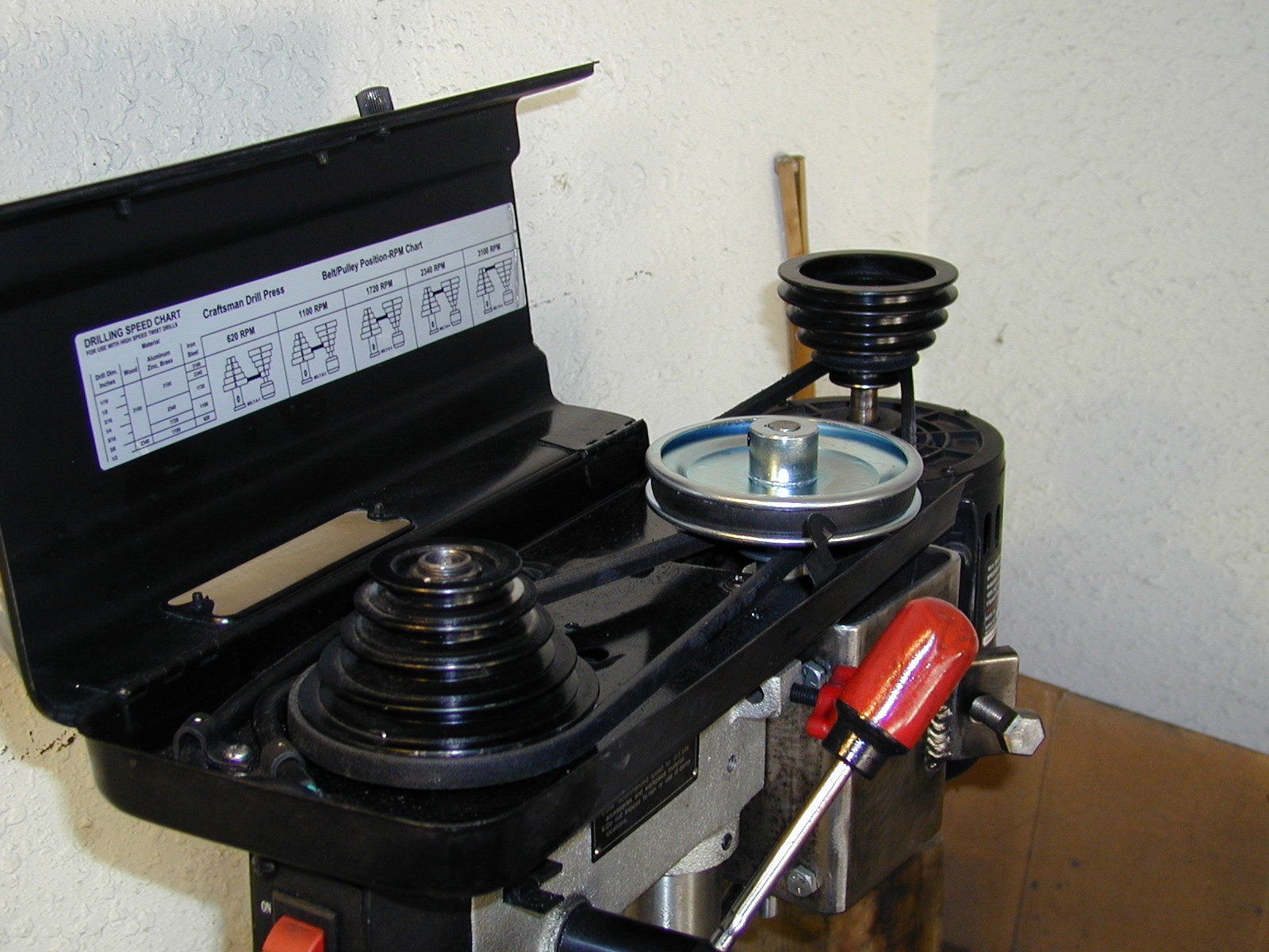

After that, I need to slow down my drill press so that I can drill a lot of 7/8" holes through 3/4" plate for the track sprockets. I got the idea on how to slow down the drill press from the MBN also.

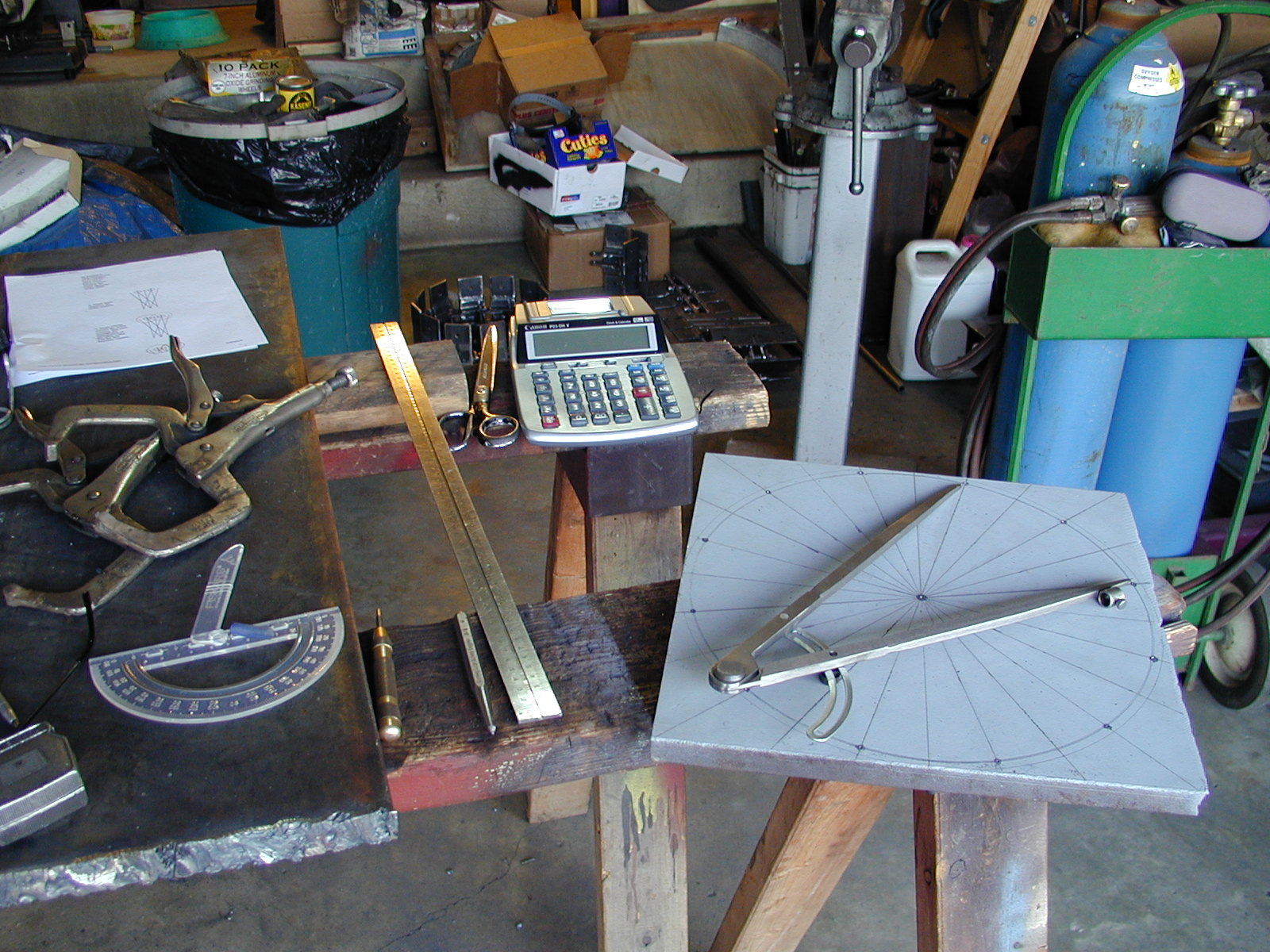

Thanks for your comments...I'll be sure to flush the engine...etc.
The iron worker idea would work I guess... I just don't have access to one.
The one that I used years ago seamed to distort the metal when trying to punch a hole that size. Also, I found it hard to hit the mark right on.
I was quite amazed as to how well the Harbor Freight drill bit cut once I slowed my $99 Craftsman drill press down from 620 to about 150 RPM. It stopped stalling and the shavings curled off of that 3/4" plate just as thick as could be!

Wow!:thumbsup::thumbsup: Now I see how I can convert my El-Cheapo Canadian Tire drill press to drill 1.5" holes without smoking.:(:( I use bi-metal hole-saws and drill up to 1/2" material. I'm surprised I have not burned out the poor little motor on that thing. With a step-down like that, I should be able to extend the life of that rig by a fair margin.:cool:

Question how many track pads did you make per side? Looks great!!:thumbsup: Loren
