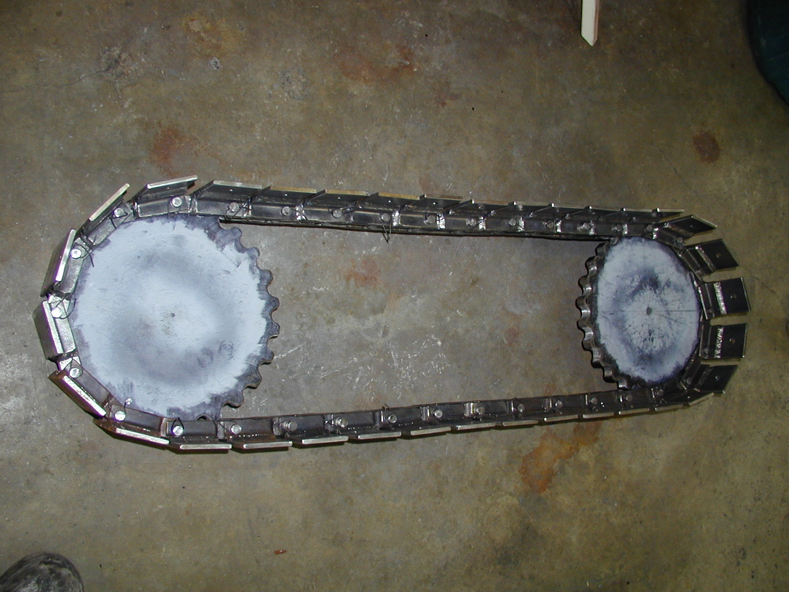

You are an artist! That being said and believe me I'm no expert but do you think the tracks will hold up to the torsional forces? I guess what I mean is the fact that they are only riding on the center 3/4" sprocket. In my thinking if you run over a small rock and tilt the inside or outside a lot will the track still remain true?
Great job so far.
/ Another Mini-Dozer #24
Man that is very impressive! I'm tagging along for this one! Do you anticipate any wear issues with the sprockets not being hardened steel?
Very nice work so far! Btw, what kind of welding machine are you using?
#25

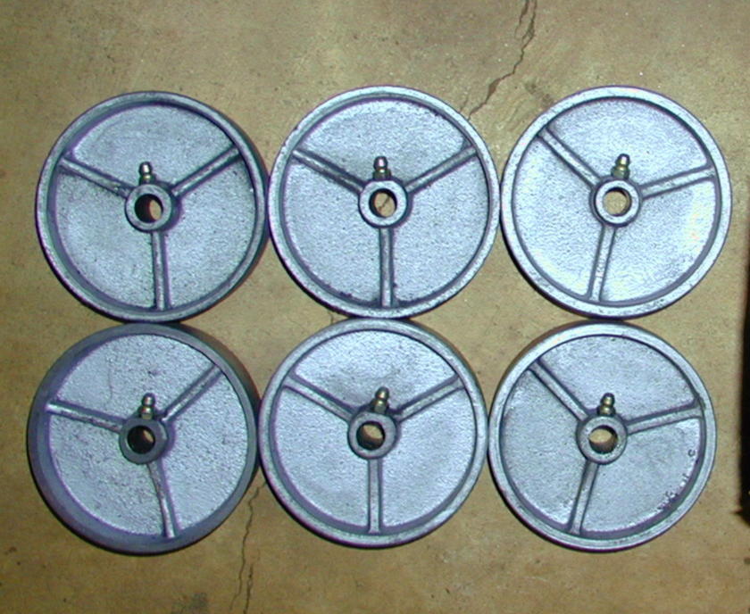

You are an artist! That being said and believe me I'm no expert but do you think the tracks will hold up to the torsional forces? I guess what I mean is the fact that they are only riding on the center 3/4" sprocket. In my thinking if you run over a small rock and tilt the inside or outside a lot will the track still remain true?Great job so far.
I really havn't given it that much thought. Its going to have three bogey wheels per side but they are riding on the center of the track too.I guess I could have a problem with that. I noticed that the old Struck units didn't have any bogey wheels at all and the track shoes were made from 10 gauge material. I wonder how well they performed. The new models have double sprockets on them as well as bogies so I'm guessing it must have been somewhat of a problem.:confused3:
I think the bogey wheels should stradle the drive link part of the chain. This could be done with 6 wheels per side or 3 wheels with a groove cut in them. It may throw a track if you go over a rock or something... :(
Answer: I'm not too worried about it. I figure the track will be the big problem for wear though I have case hardened the areas on the track feet that surround the pin holes.
Answer: It's my old Lincoln 225 amp AC stick welder that I received as a graduation present in the year 1974 ! :D

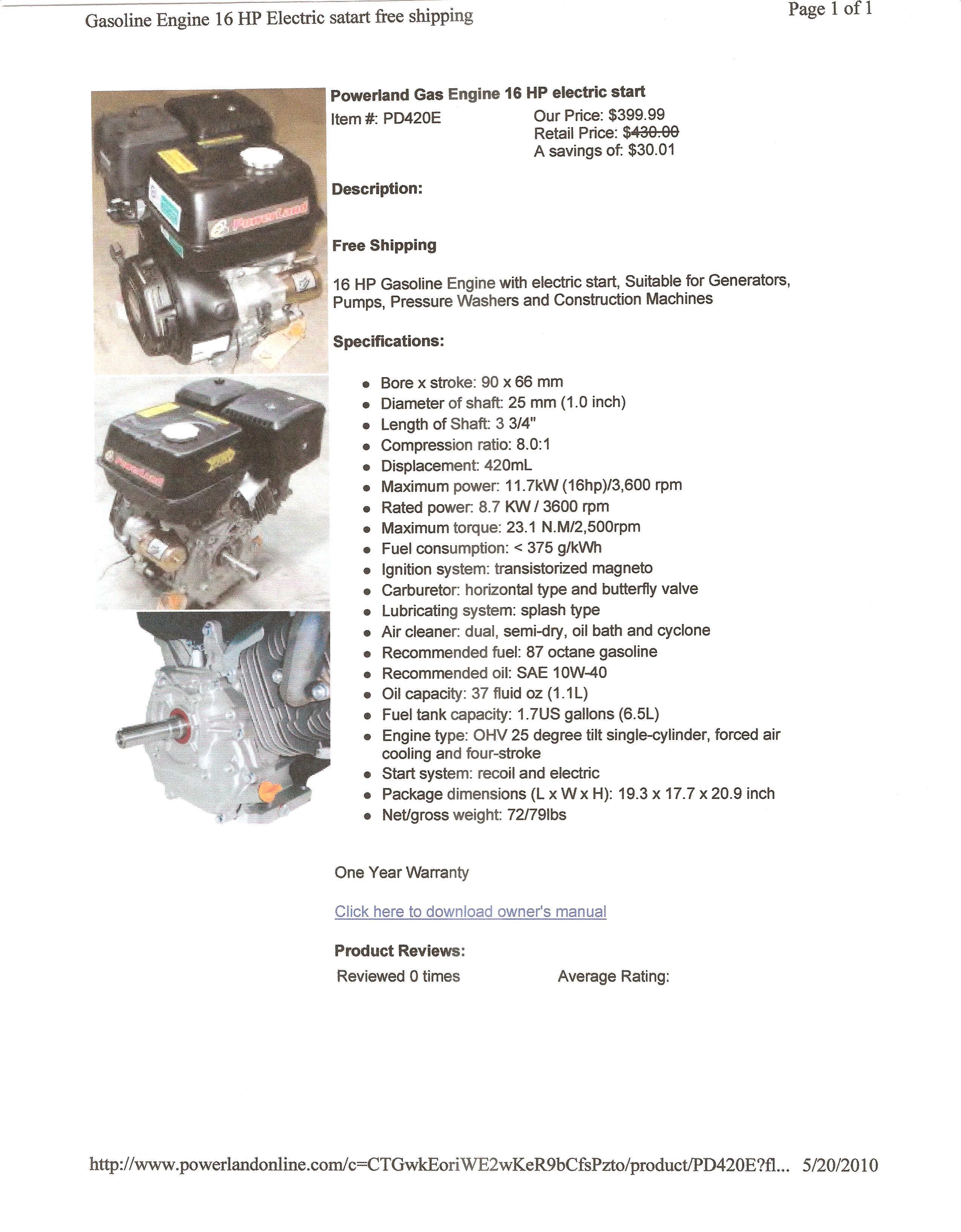

Is 16HP going to be enough ponies?[/QUOTE]
If anyone needed access to a CNC laser or water cutting system, it's you. Did you look into having the parts cut that way?
The "MD" line which Struck sold back in the 60's/70's (and whos transmission I am copying) was offered with ones choice of 3 engines: 7, 12, or 16 HP.
I didn't consider those cutting systems because I figured it would be out of my price range.

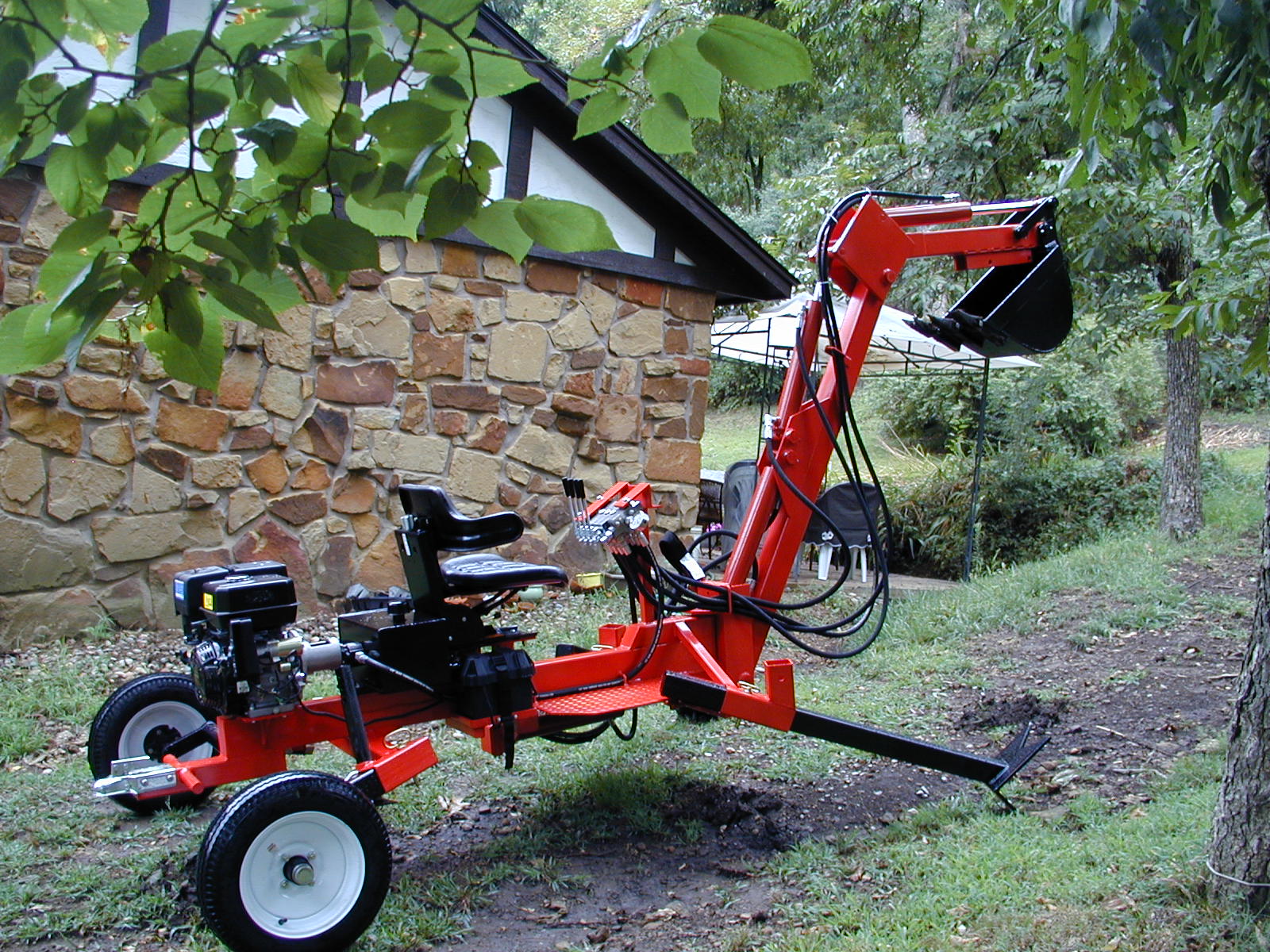

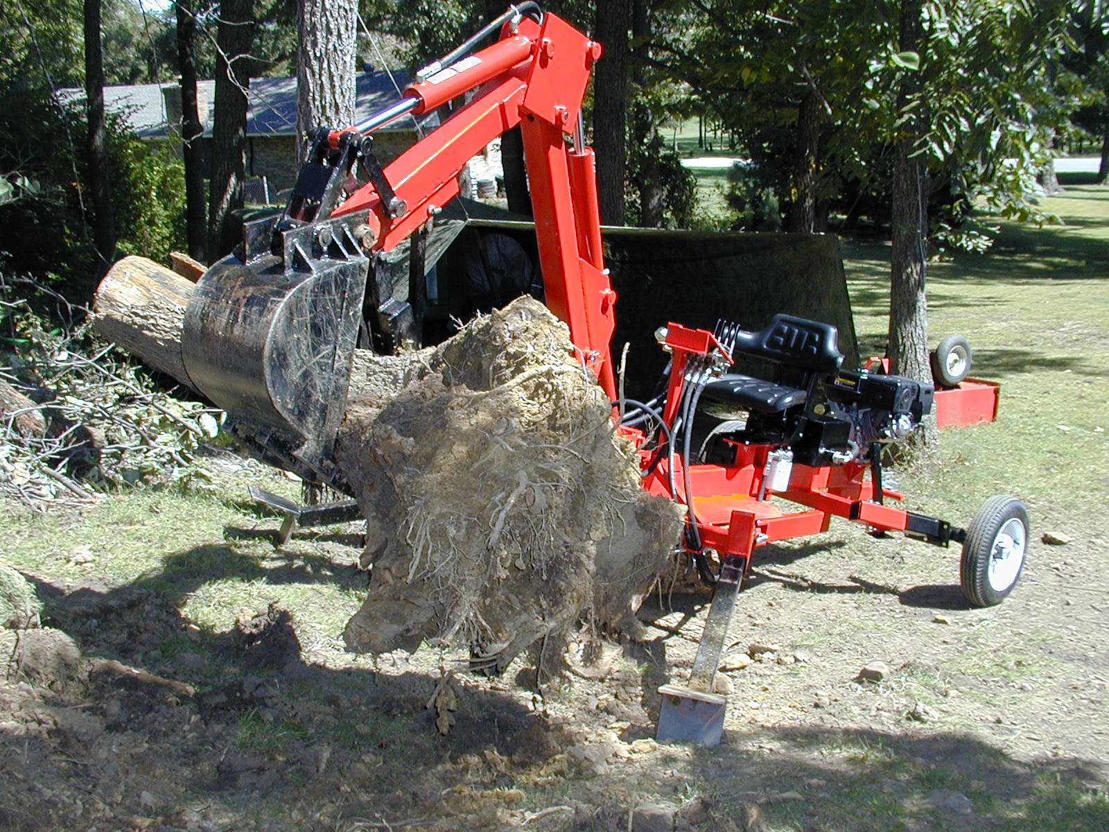

I got quite a bit of experience with hole saws when I built my "Ground Hawg" back hoe a few years back. I didn't have my drill press rigged up to run at low rpms (620 was the slowest) and I had trouble with it sawing crooked if that makes sense. In other words, the sides of the hole would not be perpendicular to the surface.
I wish I would have known about cooling with water, I did have a big mess to clean up every time.

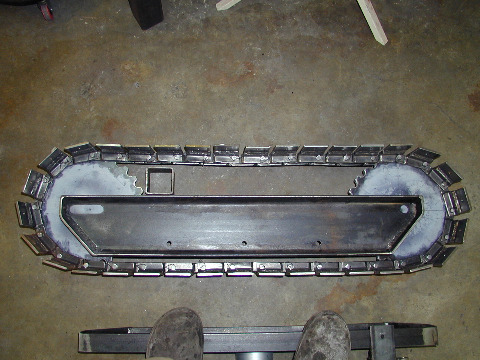

Question how many track pads did you make per side? Looks great!!:thumbsup: Loren
34 per side. Thank You.
Today I got a little ahead of myself and started welding before I had all of the figuring done. I didn't allow enough room for the front sprockets to adjust all of the way backwards.:ashamed: But after a few modifications, I think I'm OK now. Also, I welded the hubs onto the sprockets.
