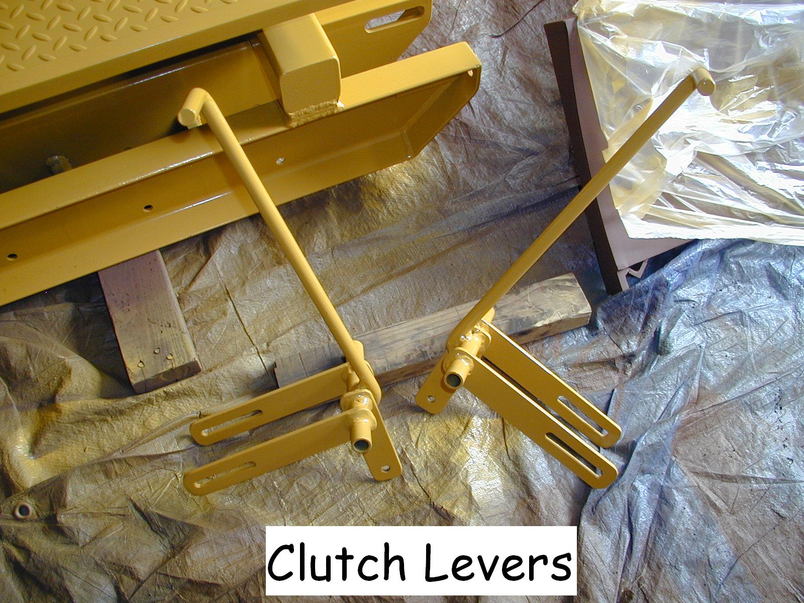

It looks like the control levers might be a little on the short side, you might be hunched over while operating. Have you tested it for comfort?
No, I need to finish up a few more things, like for example, the wiring, before I test run it. My daughter said that the somewhat sharp corners on the top might be a problem for my legs (they are ultra sensitive because of the skin graft harvesting they did there when I was burned). I am thinking of making some foot rests that would raise my feet up about 6", thus making some clearance between the machine and my thighs.

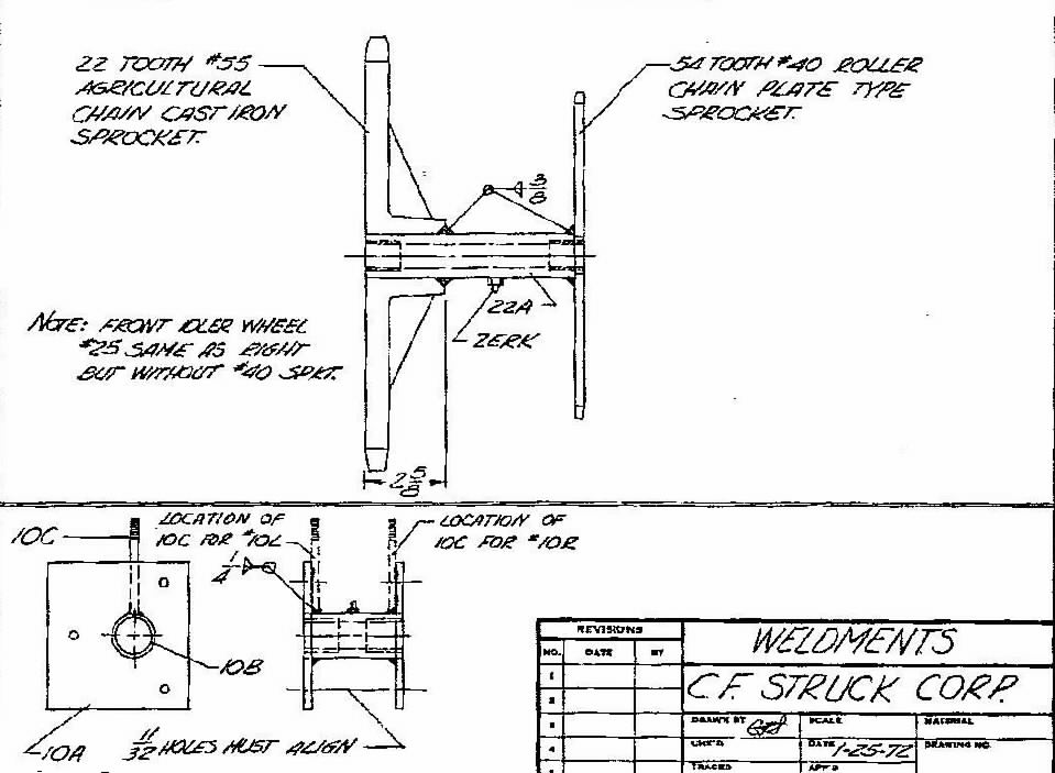

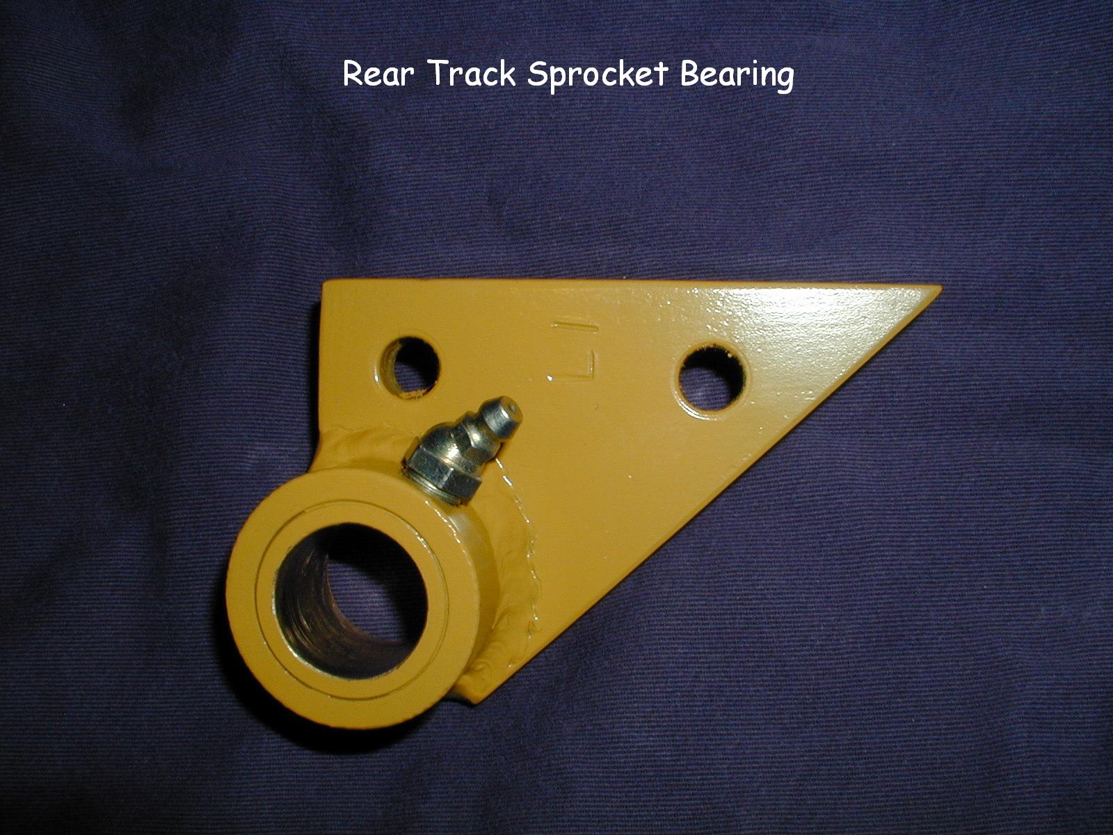

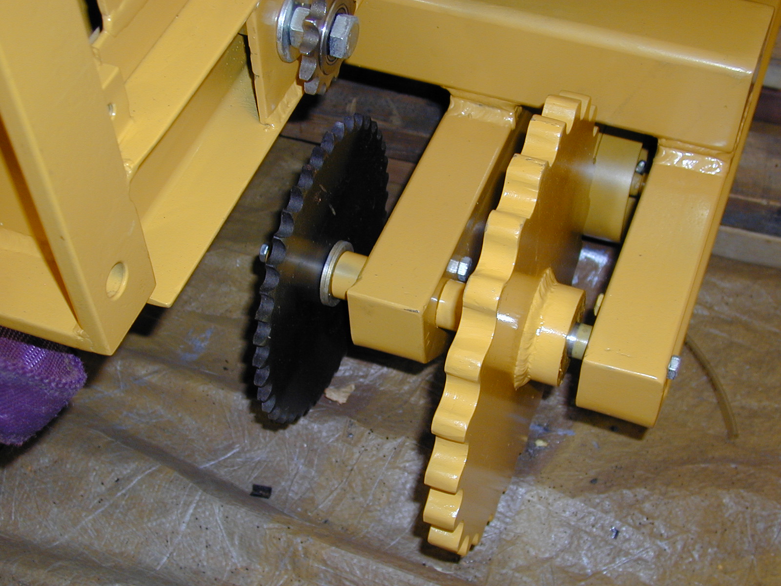

Well, I took it for a "off-camera" drive today. It was quite a scary ride, kind of of like ridin' a wild bull ! All in all, it failed miserably ! :( The speed is about twice as fast as I'd like it to be. The steering was very jerky and when I either started or stopped, the machine would tilt either forward or backward respectively. I think I may have made the wheel base (or in this case, sprocket base) too short! :eek: Of course this was without the blade on front nor the box blade on back. Having them on might help to prevent the problem somewhat or make it worse, who knows! Then to top it all off, before I made it back to the garage, I sheered a key off on the left drive assembly. So, it looks like back to the drawing board for me! I would appreciate any thoughts on the matter. :anyone: I know I am having major thoughts of installing a roll bar! ;) The photos below shows my sprocket setup (keyed to shaft) versus Strucks' (sprockets integrally welded):
