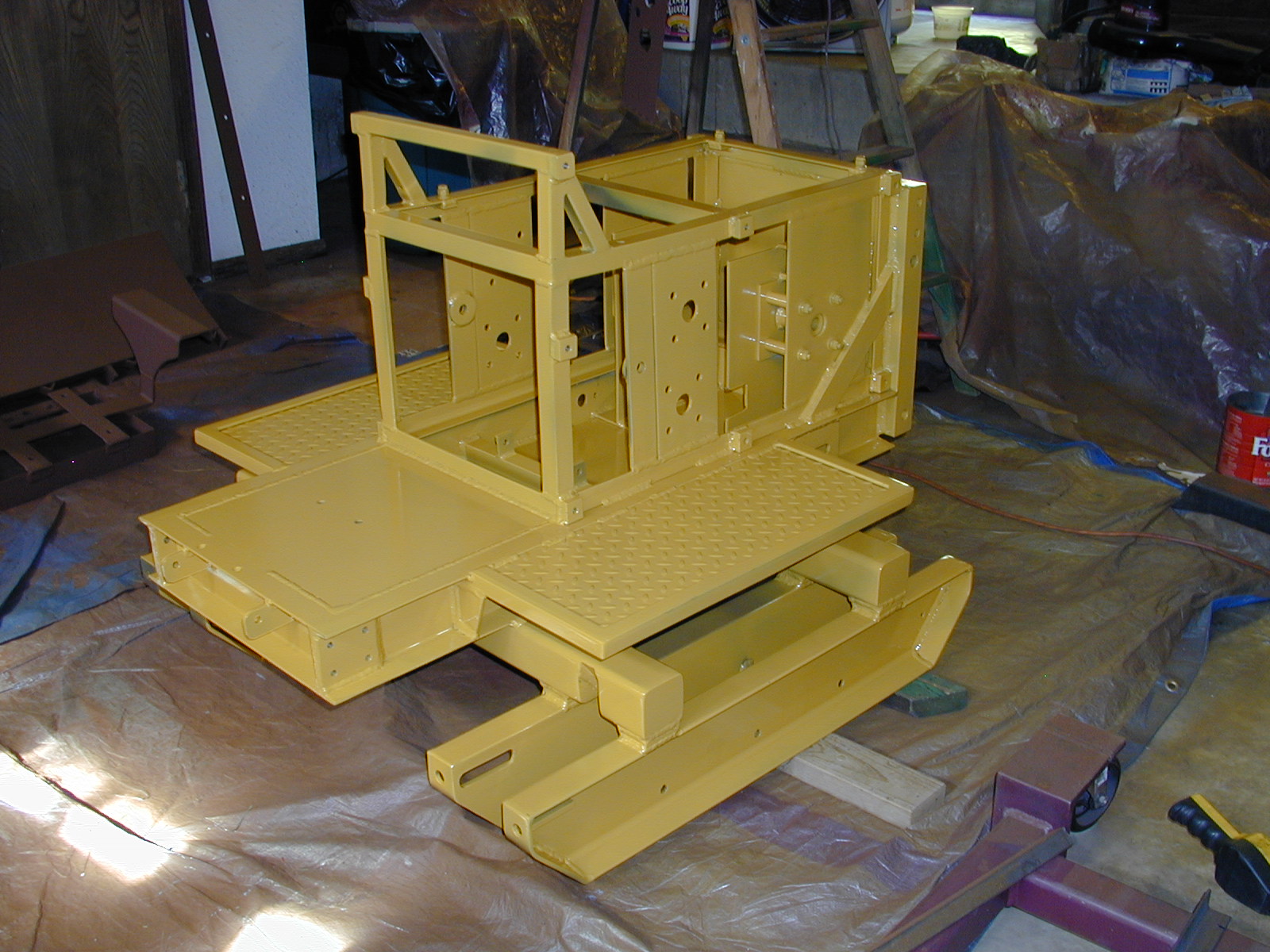

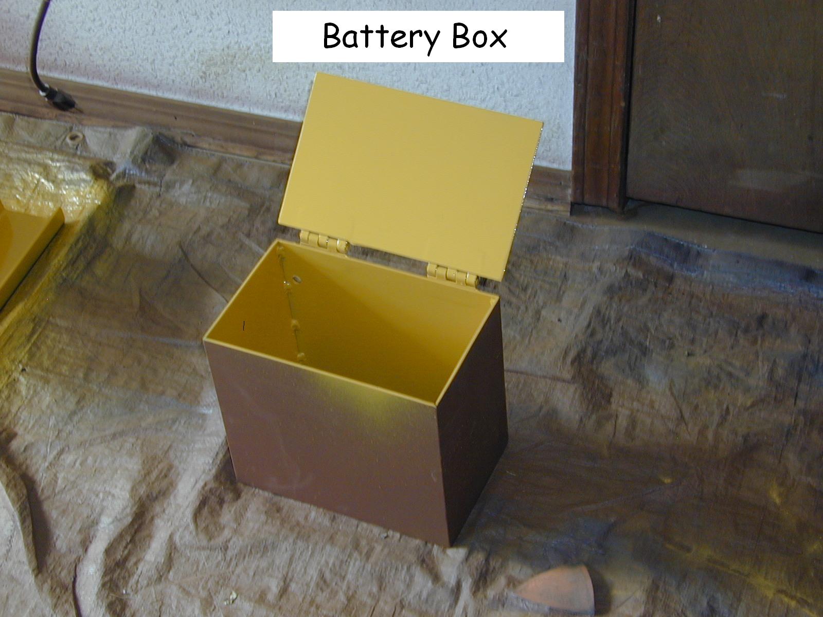

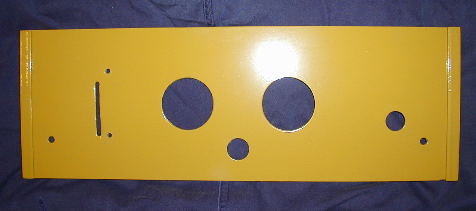

I don't mean to interrupt you fellers but I thougt I'd give a progress report on the mini.:) Over last weekend I got most of the sheet
metal cut and welded together (the sheet metal is 11 gauge, not 12 like I said earlier). This consisted of side panels, top & bottom
panels, battery box, chain gaurds, seat bracket with tool storage tray and dash board. Also, I finished up making the clutch levers,
tension pully linkage, and belt keepers. The last few days I've been cleaning & primering the individual parts. I sprayed Cat yellow on
a few of the smaller parts like the clutch levers and the inside of the battery box using a spray can. I hope to paint the initial coat
of yellow on the larger parts in the next few days using the compressor and spray gun.

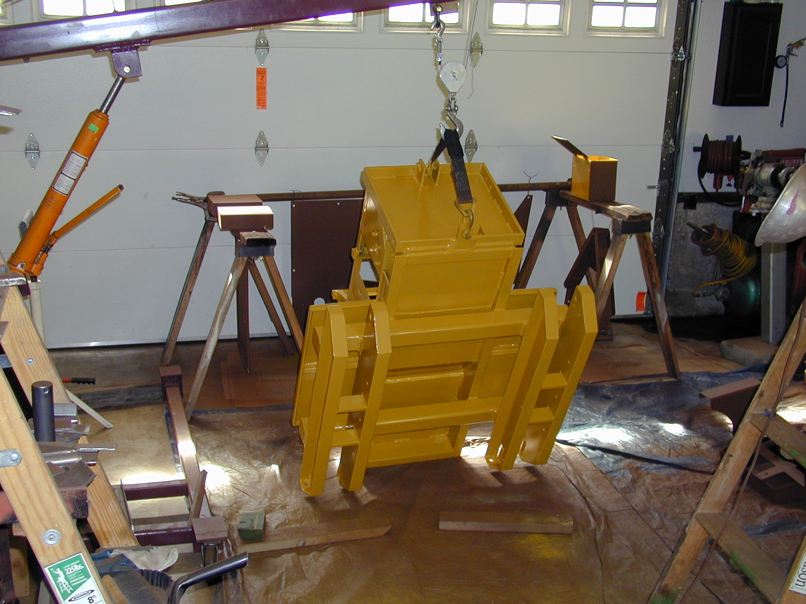

One standard lawn mower battery will do just fine. The same one that starts the engine & powers the lights. The actuators look like they have 18 gauge wires on them so amp draw must be minimal. I purchased them from Northern Equipment but I don't recommend them to anyone.They are too slow and barely have enough power to raise and lower the box blade that I made (see photo).

The last few days , my garage has had a cloud of yellow mist billowing from the doorways....

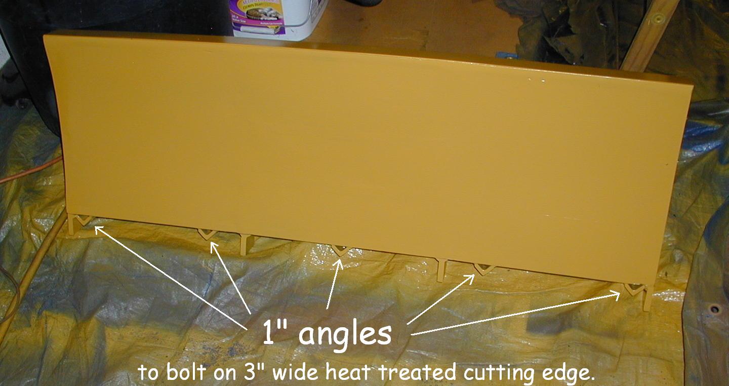

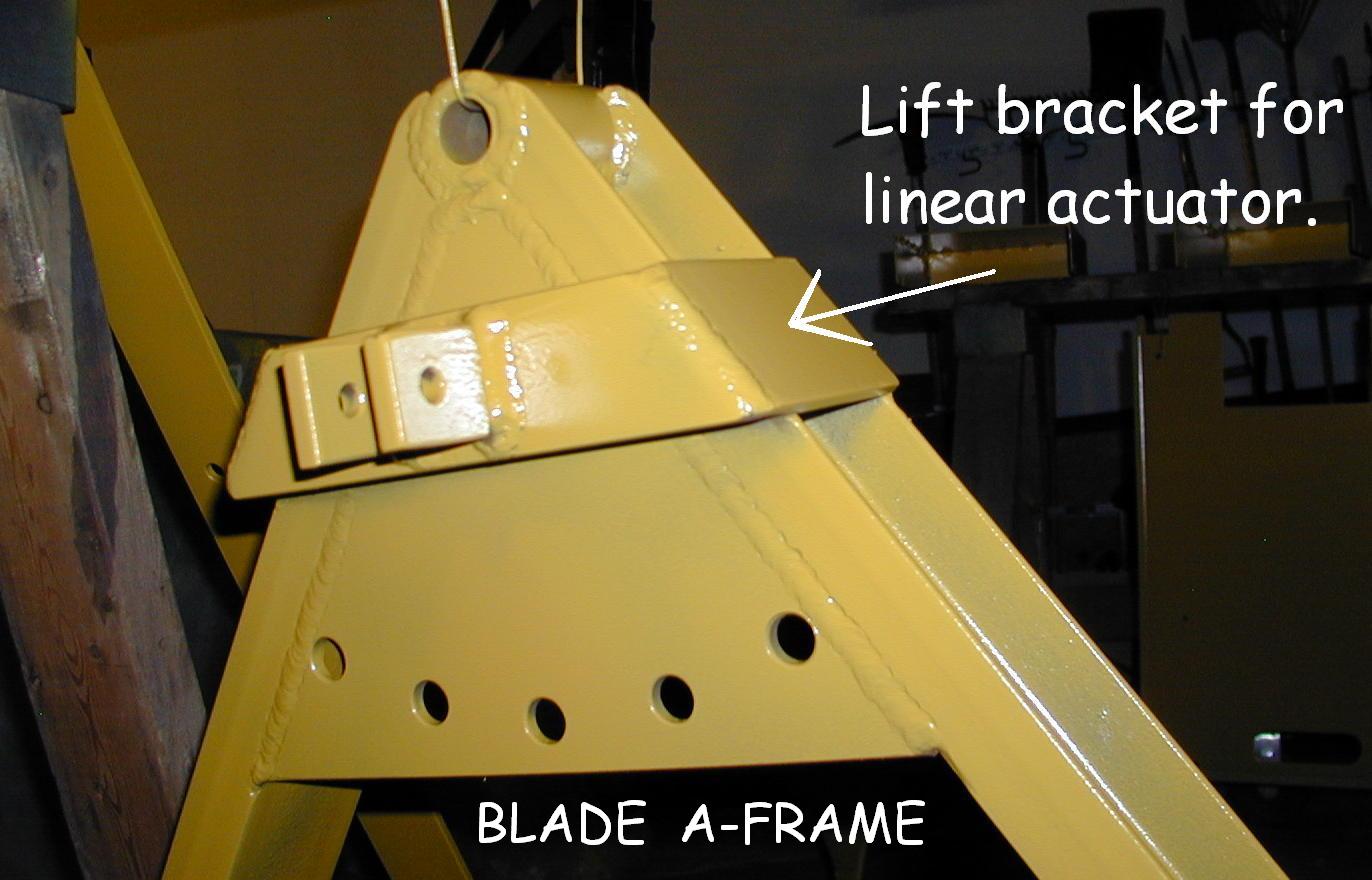

I don't know if you're asking if anyone was clear on what I meant by: "a yellow mist was billowing.." or are you asking if I'm going to put a "clear coat finish" on it, so I'll try to answer it both ways. What I meant was, I was spraying paint the last few days and when I do, I usually manage to really fog up the place. Being a novice painter, I suppose I am either thinning the paint too much or I've got the pressure turned up too high or both. The other answer is: If it performs like I hope, I might just put a clear coat finish on it later.

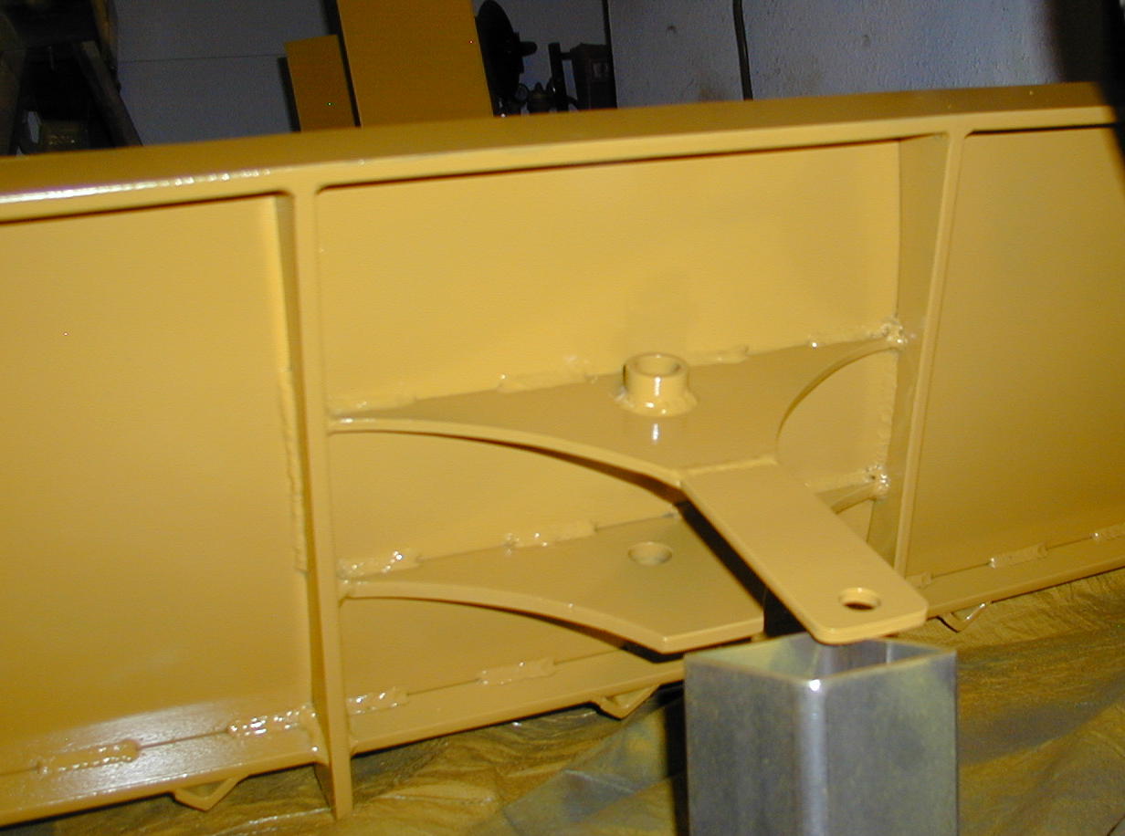

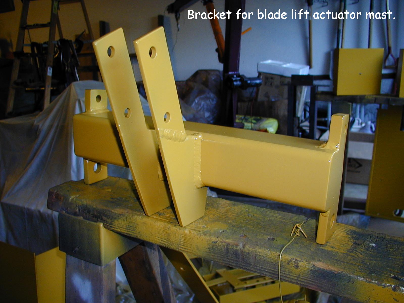

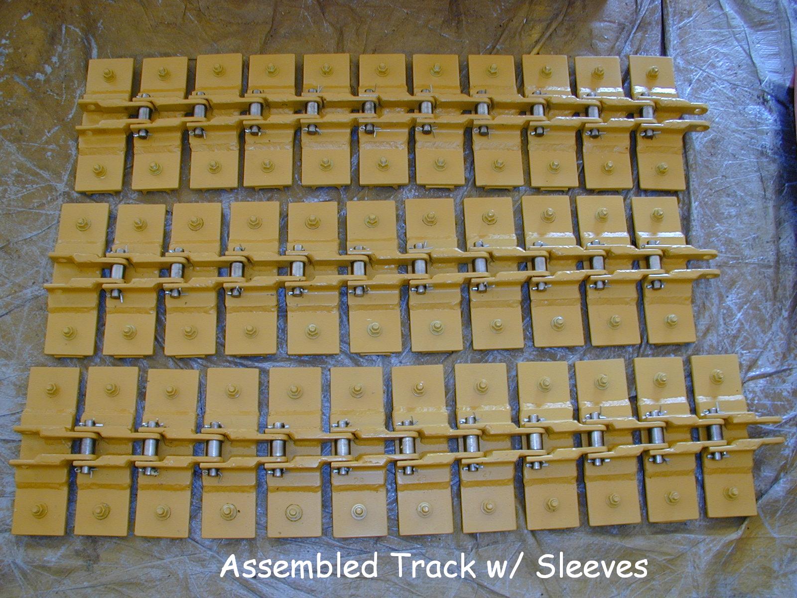

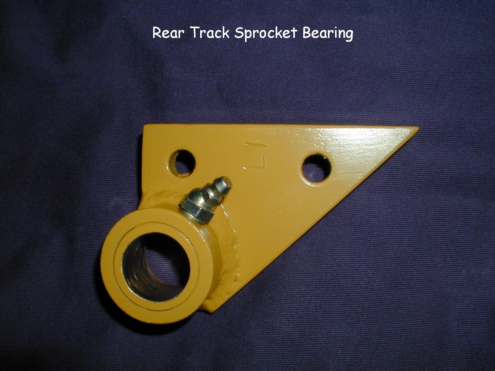

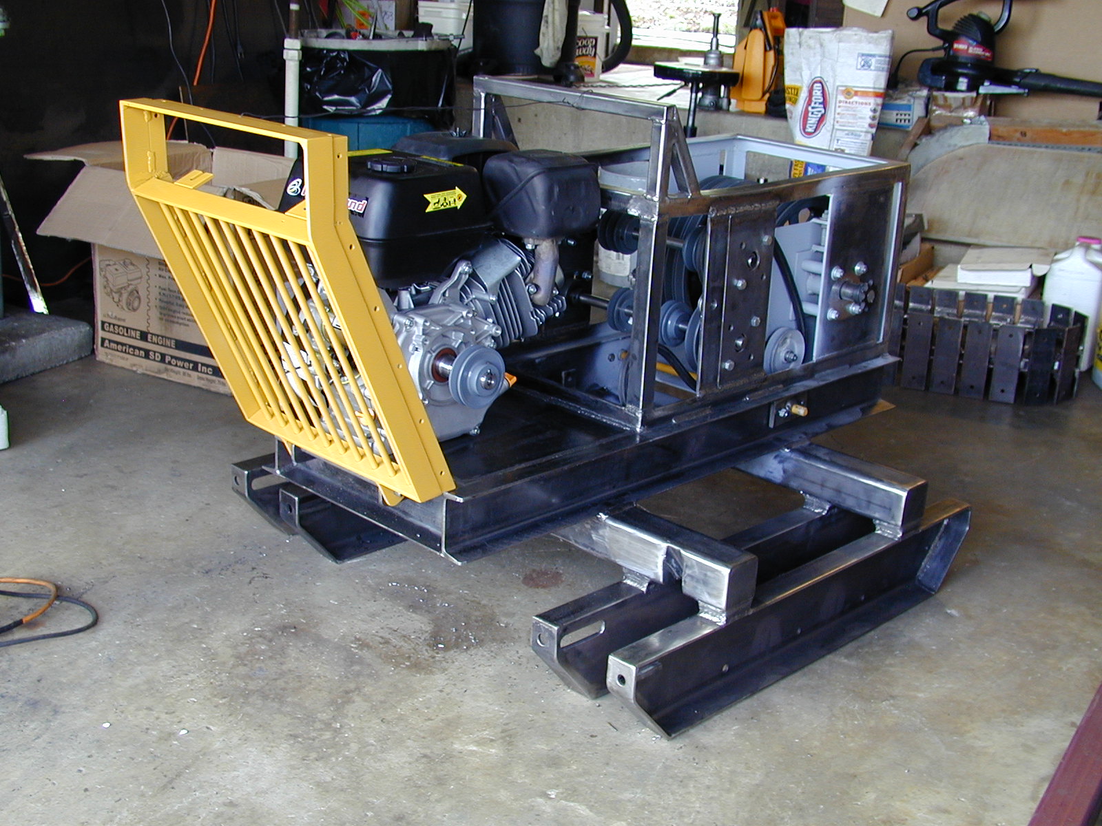

A few more photos.... note that final track assembly has rotating sleeves on pins to help reduce friction and extend life of track (no, they are not heat treated at this time :( ).
