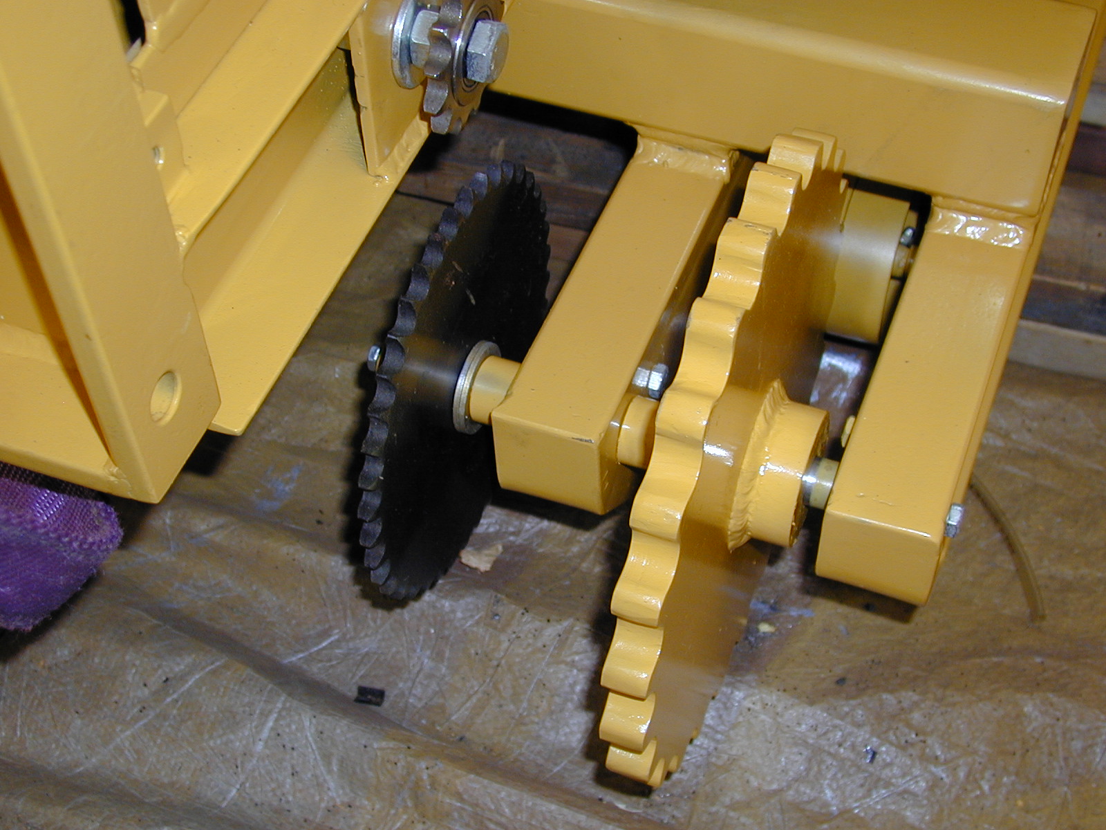

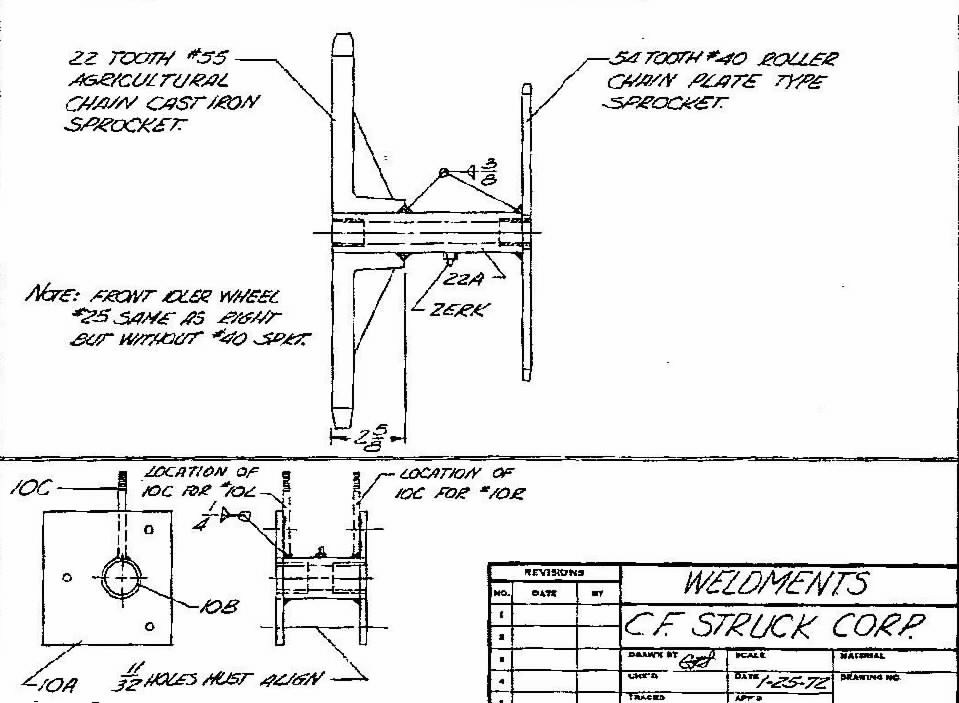

Well, I took it for a "off-camera" drive today. It was quite a scary ride, kind of of like ridin' a wild bull ! All in all, it failed miserably ! :( The speed is about twice as fast as I'd like it to be. The steering was very jerky and when I either started or stopped, the machine would tilt either forward or backward respectively. I think I may have made the wheel base (or in this case, sprocket base) too short! :eek: Of course this was without the blade on front nor the box blade on back. Having them on might help to prevent the problem somewhat or make it worse, who knows! Then to top it all off, before I made it back to the garage, I sheered a key off on the left drive assembly. So, it looks like back to the drawing board for me! I would appreciate any thoughts on the matter. :anyone: I know I am having major thoughts of installing a roll bar! ;) The photos below shows my sprocket setup (keyed to shaft) versus Strucks' (sprockets integrally welded):
